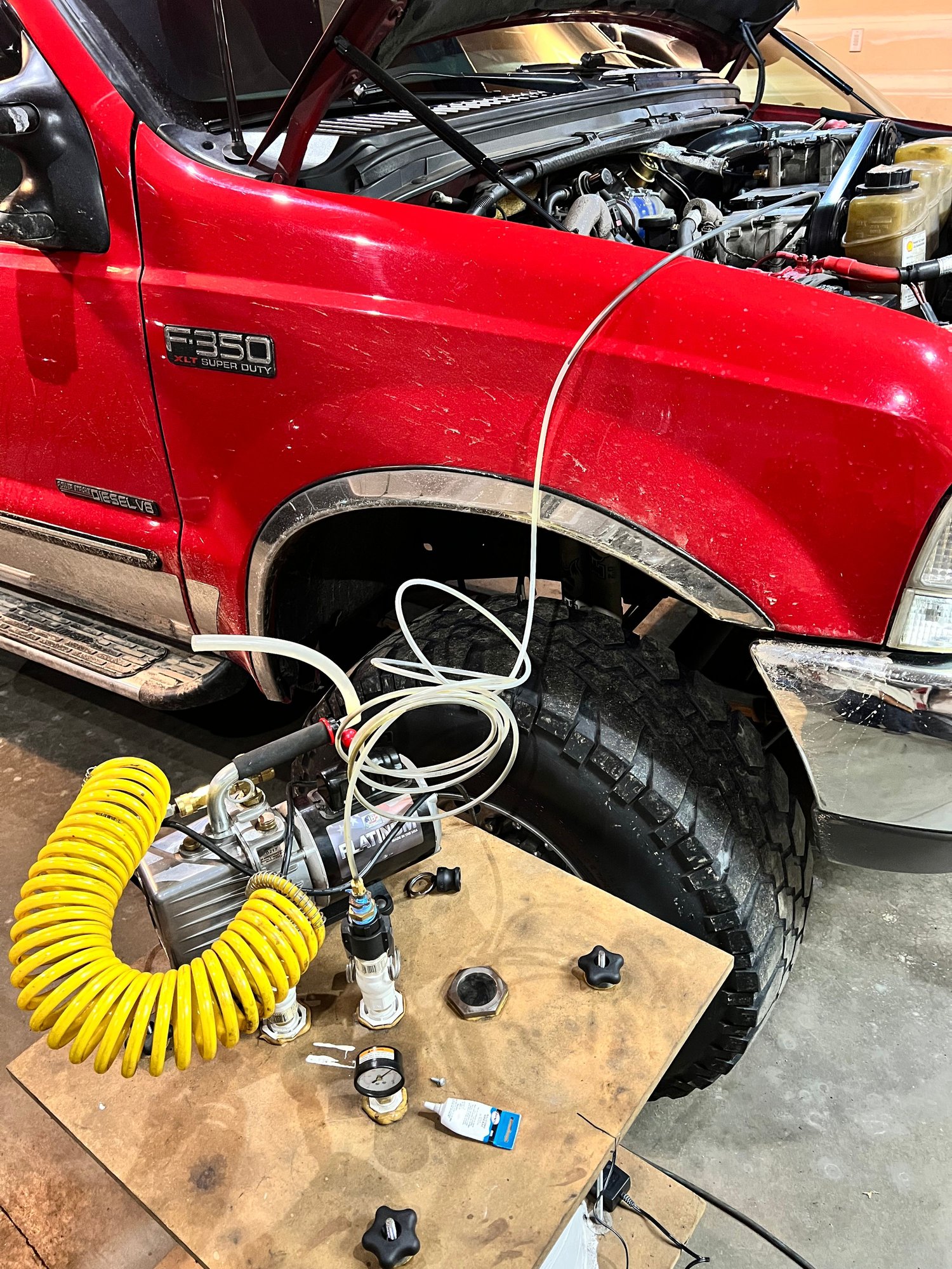

Originally Posted by F350towing
Thats funny. However if you ever go to Mr Lube that is exactly what they do for transfer case and diffs instead of removing covers.
You mean like this?

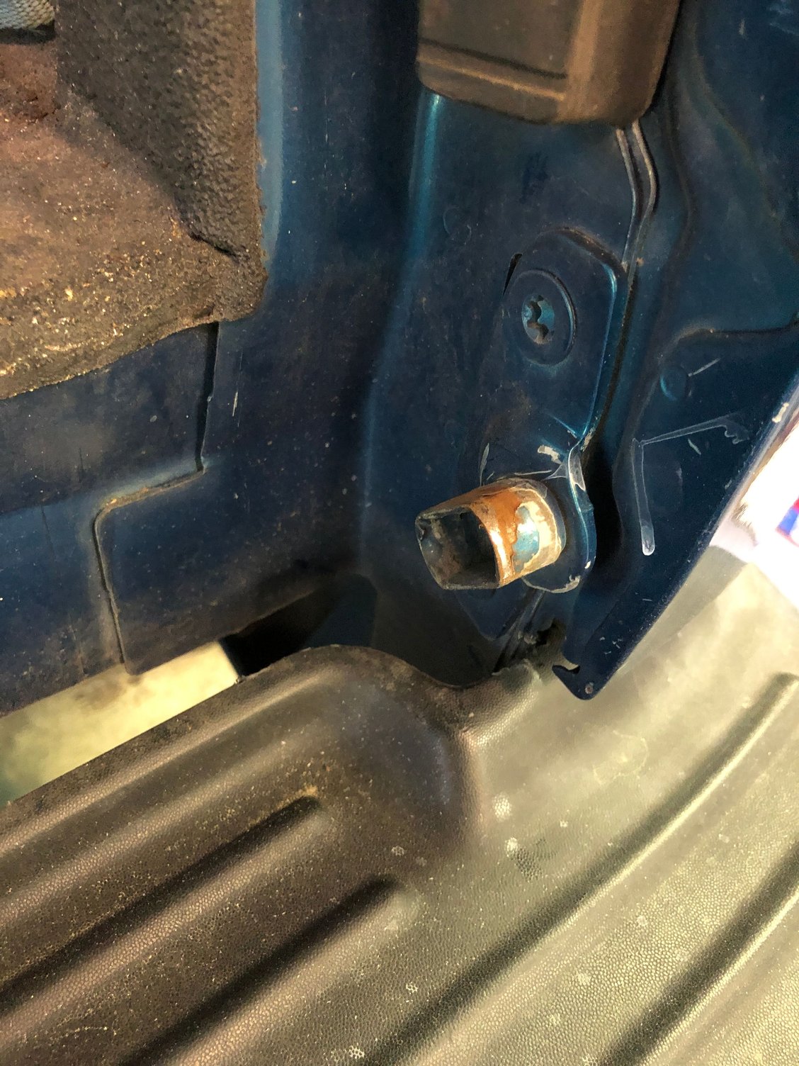

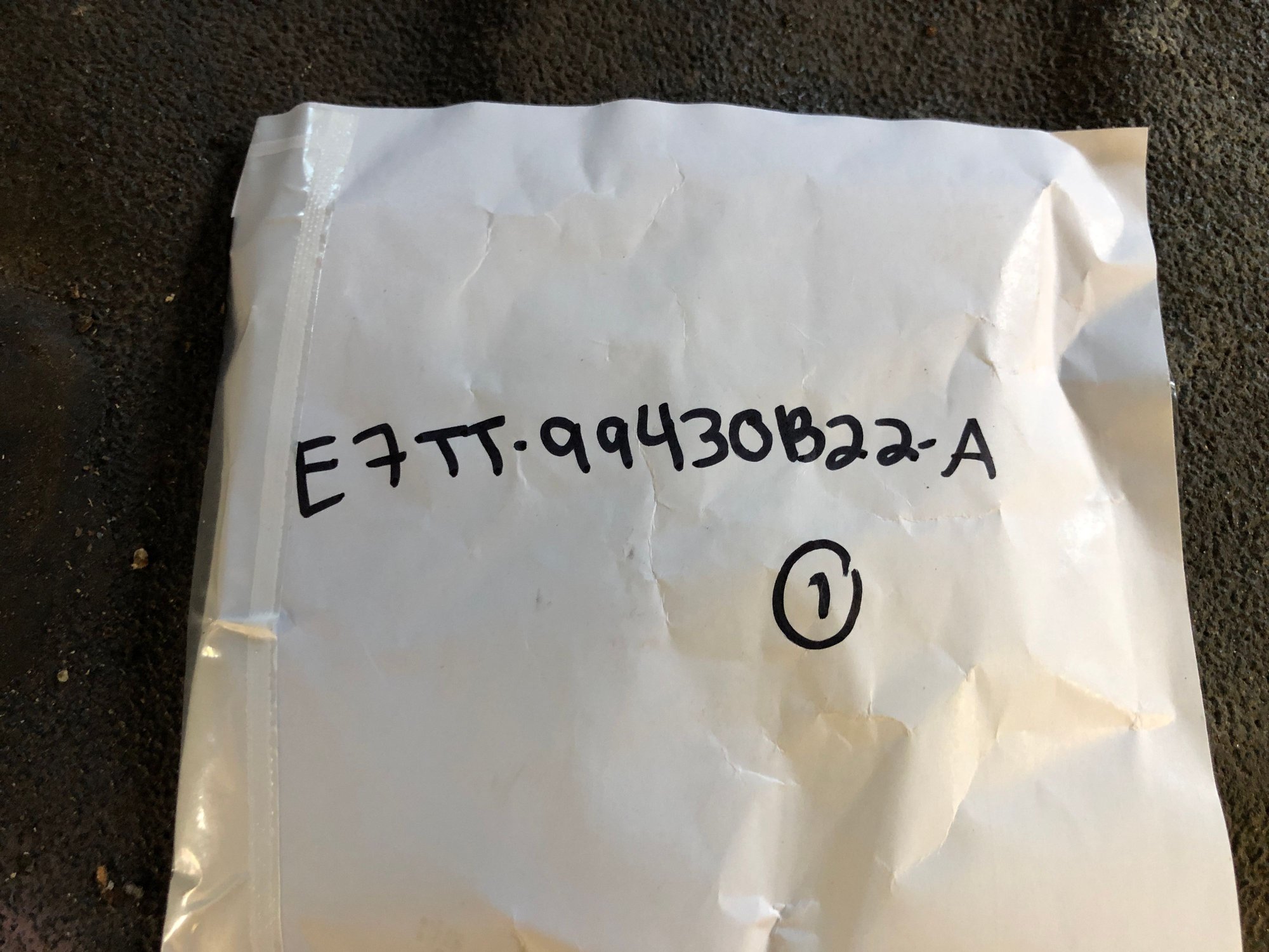

Found the cause of a clunk sound when hitting bumps.
Tailgate hinge bushing was gone.
New bushing installed.
Looks like it’s been gone for a while.
Just in case anybody goes looking for this part.
I decided to go directly to Ford for this since the Amazon reviews for the Dorman where less than stellar.

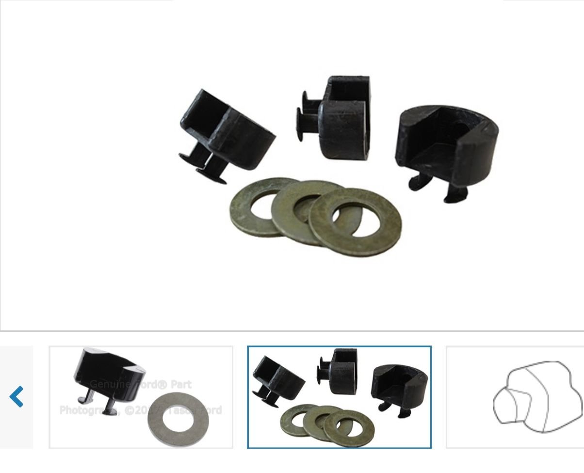

That bushing looks like a perfect candidate for 3D printing out of a better material.
Not sure what’s available for printing material but this is somewhat flexible.
There are two tabs that lock it into place on the tailgate. One of the complaints about the Dorman was these tabs weren’t flexible and snapped off when trying to install.
