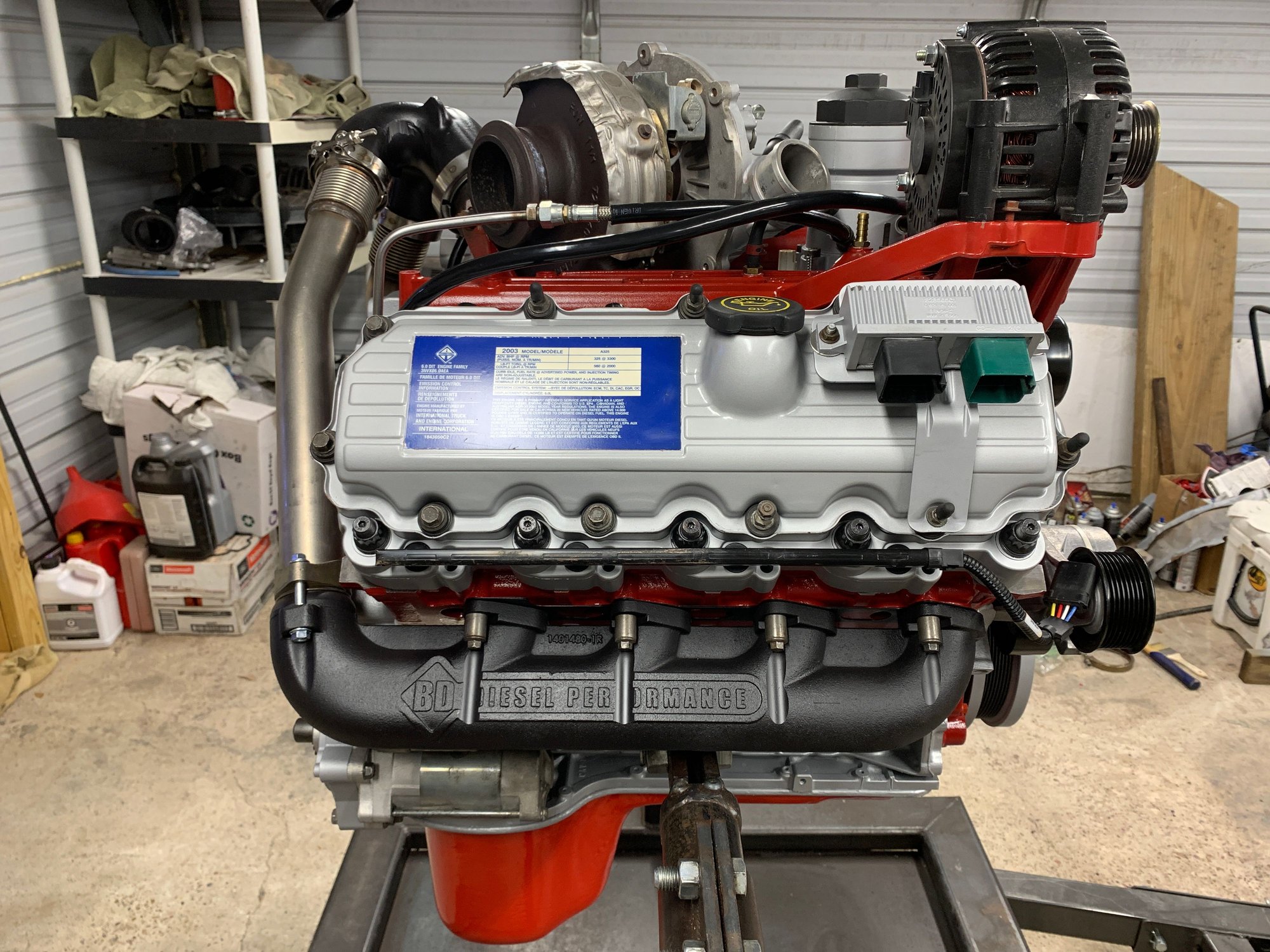

No, I just have it mocked up for right now, I’ll pull most of it off to keep it low profile going in. That damn oil pan makes it have to go up a foot more just to clear the crossmember. Too bad the crossmember can’t be removed and installed after sliding her in place...
I’m going to wrap the up pipes and collector real pretty and leave them in one unit like I do the other y-pipe. It will go in last and be nice and lined up where it needs to go and I’ll make reference marks with my punch at the joints. I got my harmonic damper bolts today and other than the IPR screen kit and oil pressure test port adapter I’m done with parts for now!
She’s just about ready!!!
