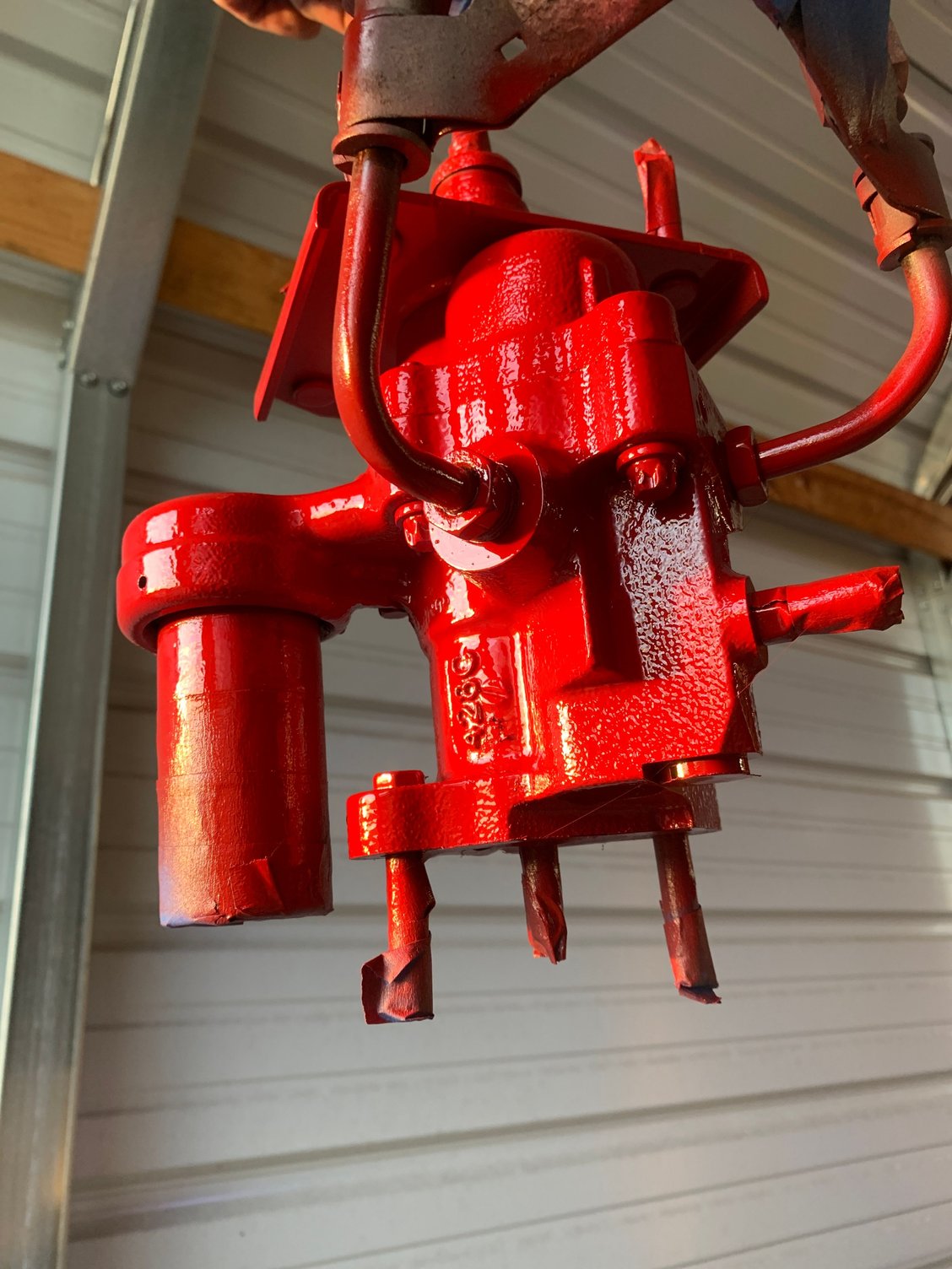

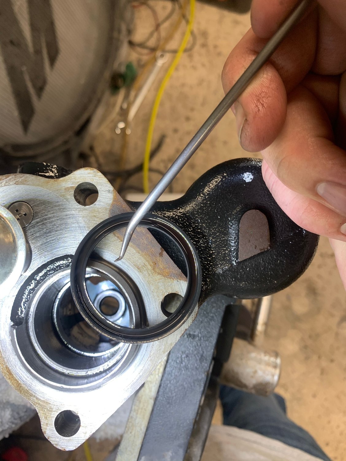

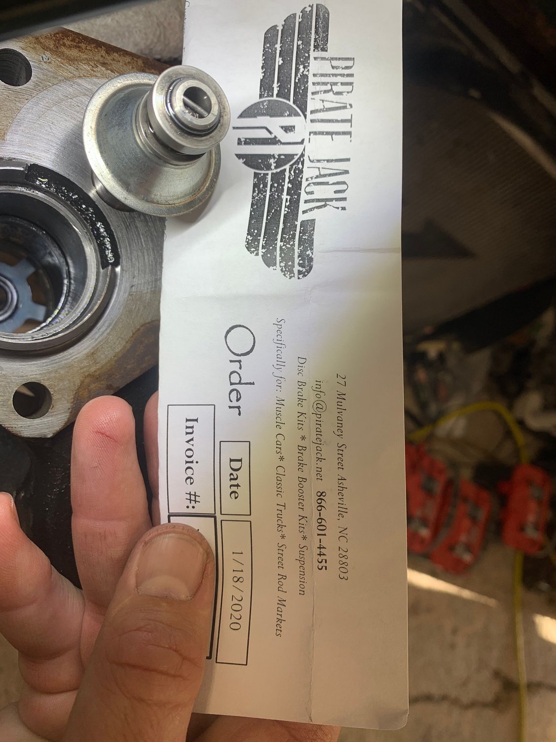

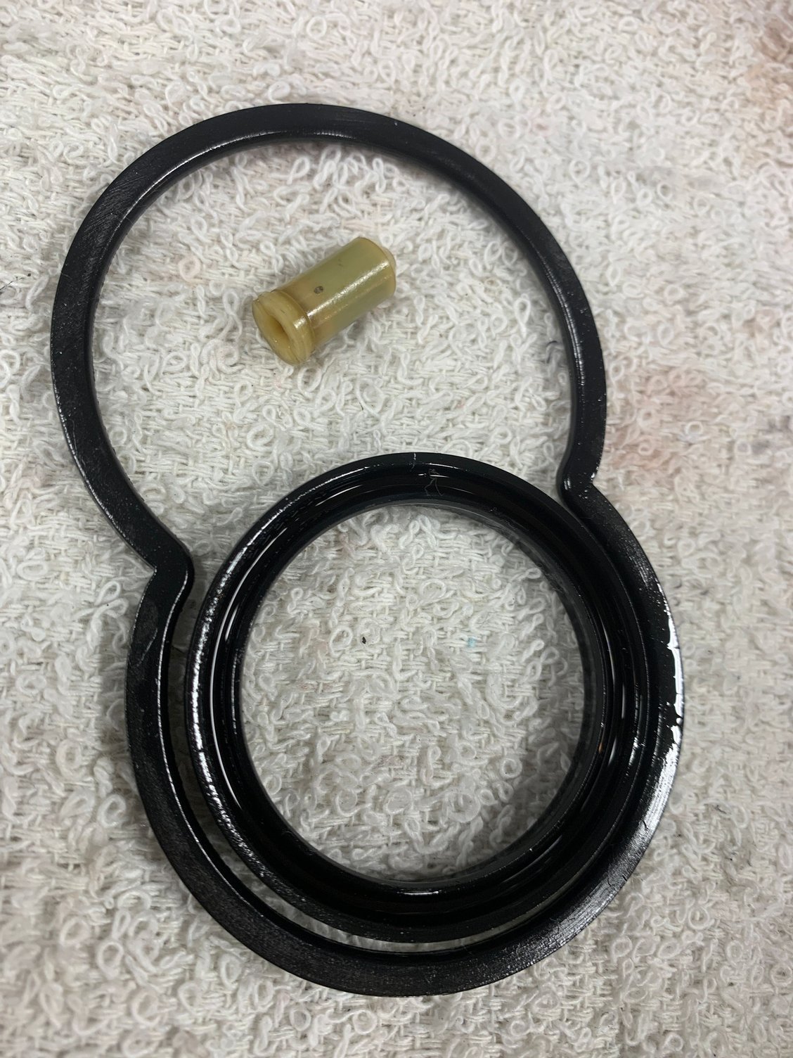

Tomorrow I will install my Blue Top steering gear and wait on Sweeting’s hose kit to arrive.
This International Red enamel should add at least 5 horsepower...
Main piston seal removed
Main piston seal installed
Pirate Jack contact information for the hydroboost rebuild kit.
Parts I swapped

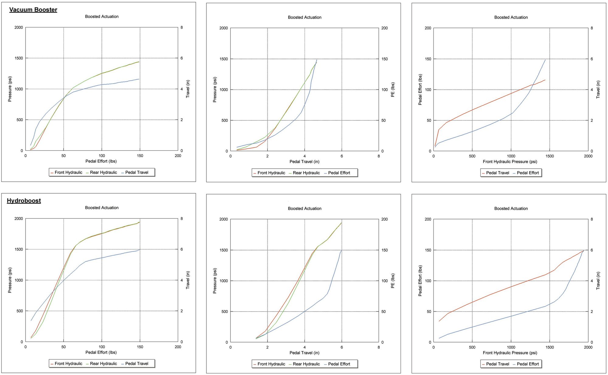

Nice find and great info. I'm still not sure if I want to try the rebuild or buy new. RockAuto has the Motorcraft for $280. I did see on Sweeting's website they sell Bosch and say they can generate up to 1,200 to 2000psi at the calipers. I wonder if that is better than the Motorcraft?

Originally Posted by JJ1101
....... they can generate up to 1,200 to 2000psi at the calipers. I wonder if that is better than the Motorcraft?
Stock, in a normal panic stop you create 1,600 psi and more at the calipers with a hydroboost Superduty. A vacuum boosted Superduty, not so easy.

In a panic stop, NHTSA has recorded off-the-street people (not test drivers) pushing 200 lbs on the pedal. Even at 150lbs on the pedal, the FMVSS limit, a hydro gets you 500psi more than a vac. No brainer which vehicle is better to have in a panic stop. With an F-350 loaded to GVW, we routinely generated tire skids at about 60lb pedal effort, warm brakes to NHTSA's targeted brake temp.
The consumer, and that includes this community, often likes a lower pedal effort than stock. And the easiest way to do that is to buy brake pads with a higher coefficient of friction, Powerstrop Z23 is the easy way to do that. Pads, not rotors. Z36 is getting up there.
