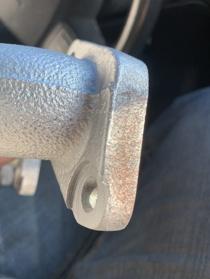

Looking at your pics and description it looks and sounds like your Cerakote guy needs to use his knees and bend down when he's spraying. Looks like he never sprayed that end and what you wiped off was basically overspray of the coating. Spraying for years I'm very aware of guys making that mistake.

I think you nailed that one, Pete. If you look at the pic, the same plane of the flange showing color, it's also in the bolt hole what's not fully coated. Dry spray.
I’m going to be childish and say that I mentioned that earlier...haha. I know exactly what he did. He was in a hurry to get the weekend started and he just resprayed it without media blasting it and he missed that spot completely. They were hanging on hooks from the mounting flange hole on that end and he must have had them hanging high and just halfassed it. Either way he’s doing my new pipes for free too and they will be done right or I’ll get my c-note back!

Eek...but I bet he coats the whole part too! I was looking at them again earlier and little rust spots are bleeding through all over and one flat side of each flange is barely coated. I’ll have him try once more...
