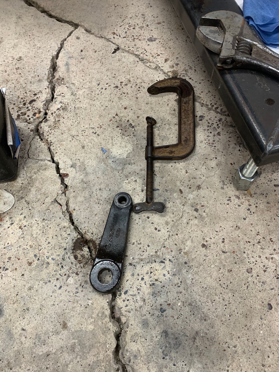

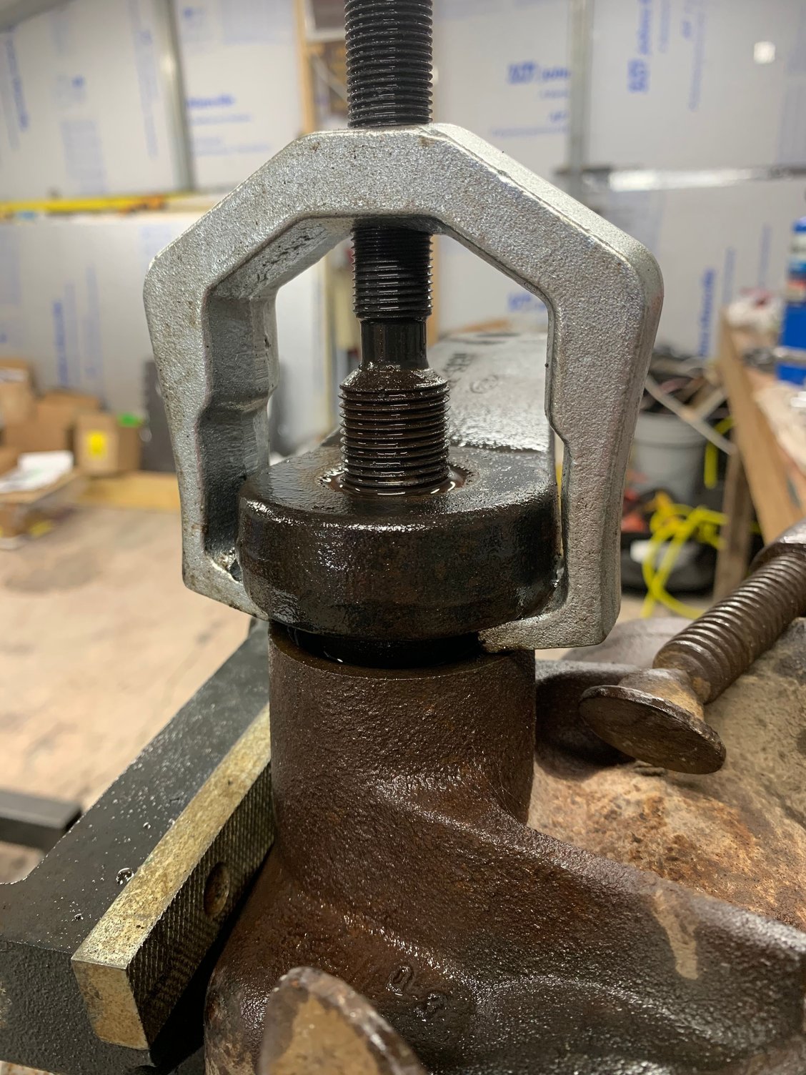

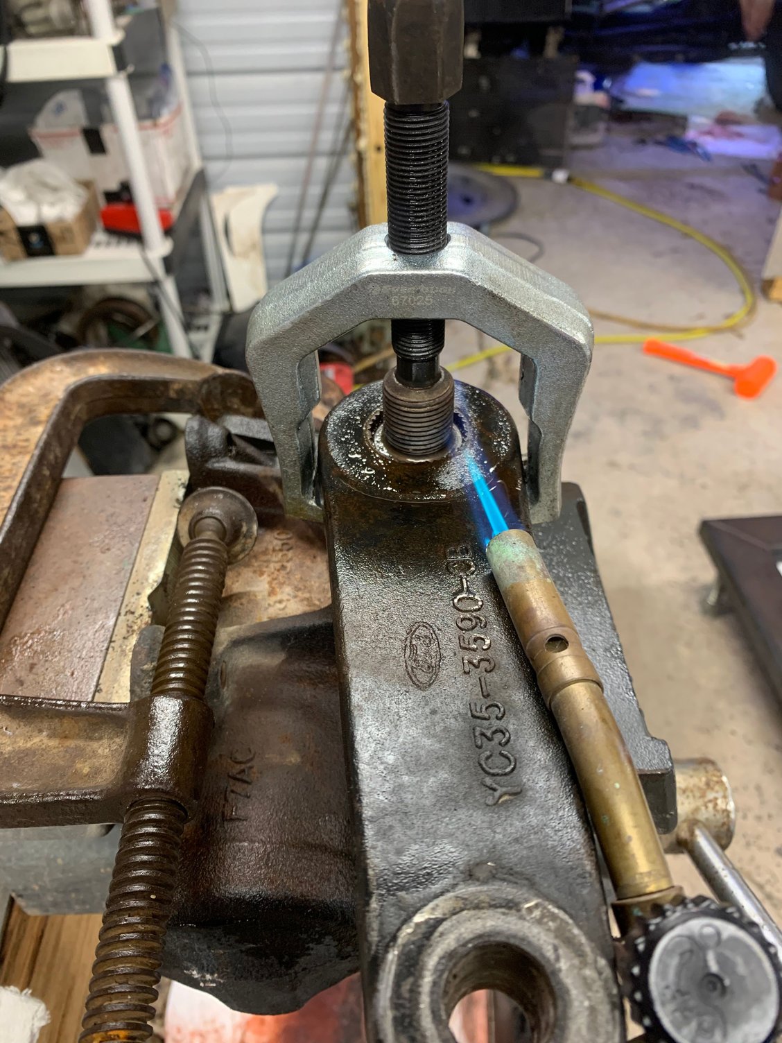

17 years installed had this sucker stuck like chuck!
Little heat, pressure and penetrating lubricant
Finally popped off and almost took my arm off, it sounded like a gun shot. I honestly thought I broke the puller.
Puuuurty!

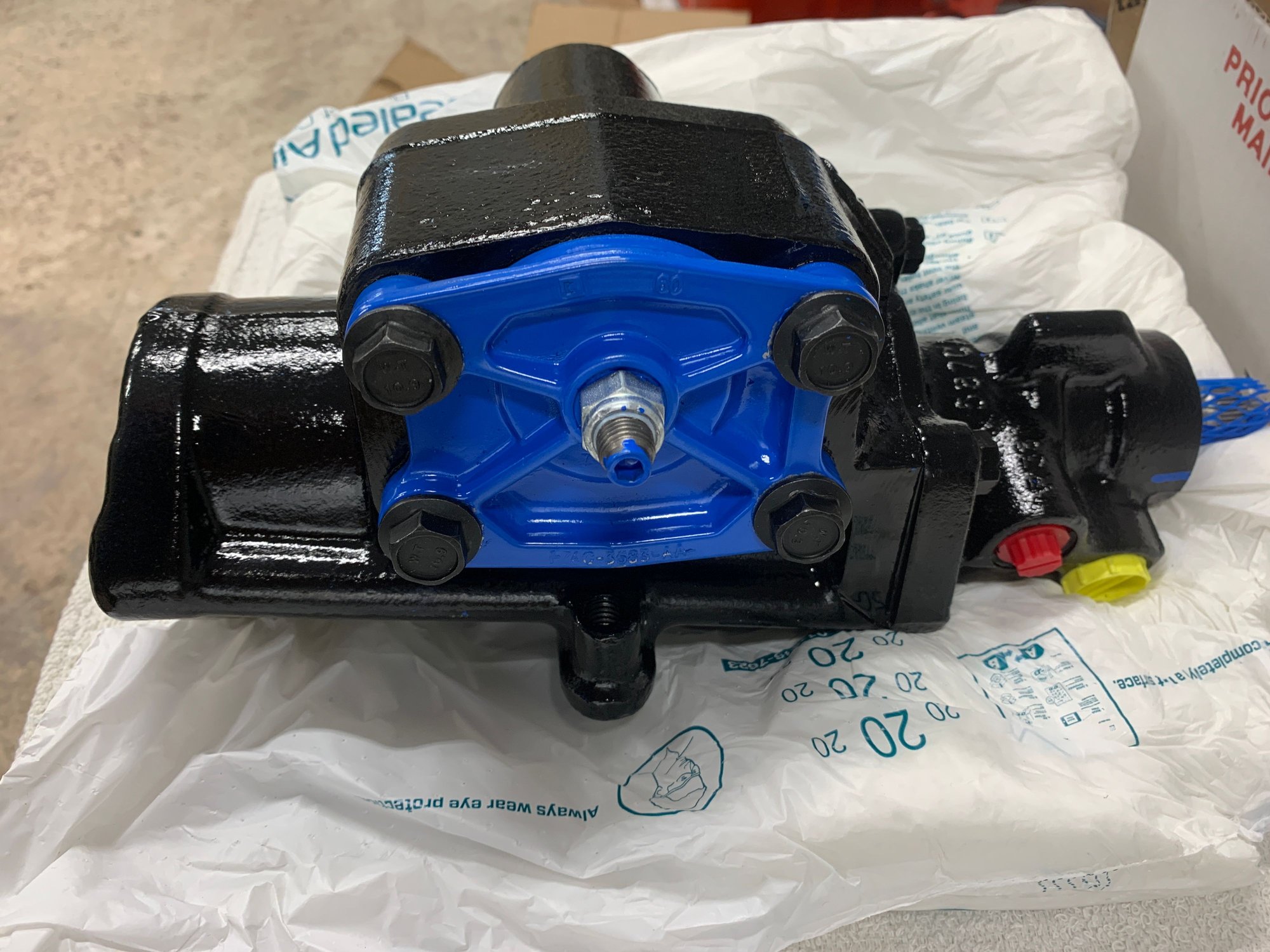

If the fittings are no larger than the existing ones I’m sending it back for a refund. I’m already aggravated that they took almost three weeks to get them to me and his excuse was he was waiting on the fittings from their supplier. If I do go back with the stock hoses do I need to replace the entire hose? There were tiny black seals that came out in pieces while removing the lines from the steering gear ports. I have a ton of viton o-rings of all sizes but these look like a different profile unless it’s just from being compressed so long.
