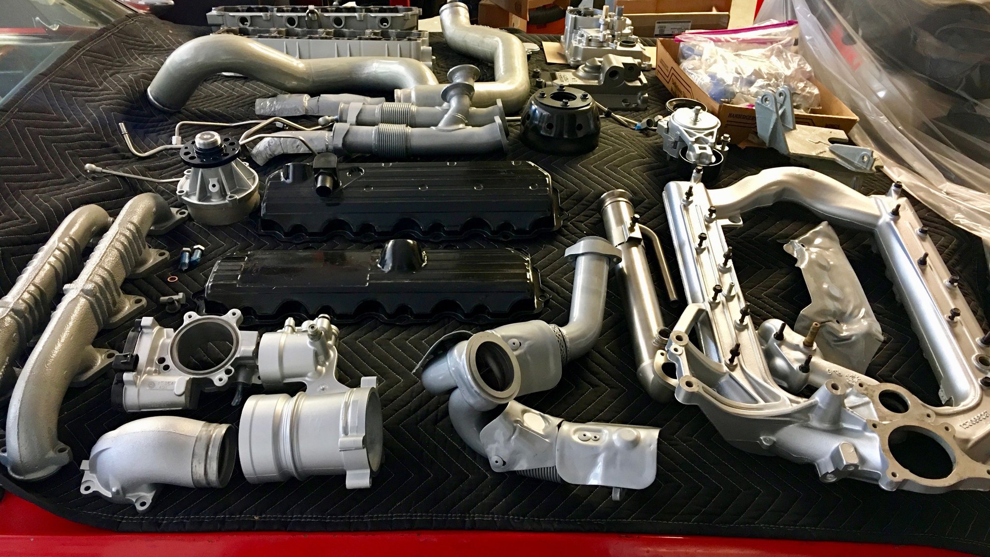

What grey did you use on the valve covers? I’m not looking forward to repainting the valve covers, but not happy with the black I painted them. They are a little rough from the reman shop.

I sanded with 150 grit, wiped with laquer thinner, VHT Flameproof primer then three top coats of VHT Flameproof Flat Aluminum, a coat of VHT Flameproof Satin Clear then baked in the gas grill just 30 minutes on 250 so I didn’t screw up the inside epoxy or the label. It’s very durable. HTM101 used the same on his engine build.

Hartwig, I used 500ºF engine paint and 2000ºF pain on the manifold, and turbo too. For me Duplicolor engine 500F on most parts, 2000F Rustoleum on the exhaust parts w/clear. Barbi'd as high as I could get them.
The problem for any time I have ever done cast exhaust manifolds that have been used is the rust coming back. Blasting, dipping, whatever, if there is a molecule of oxidation left it will regrow. I expect some on these manifolds.
I removed the VC label, didn't care for it. But with the hits they took at CAT, gloss shows everything up. To the point I was thinking hammertone.

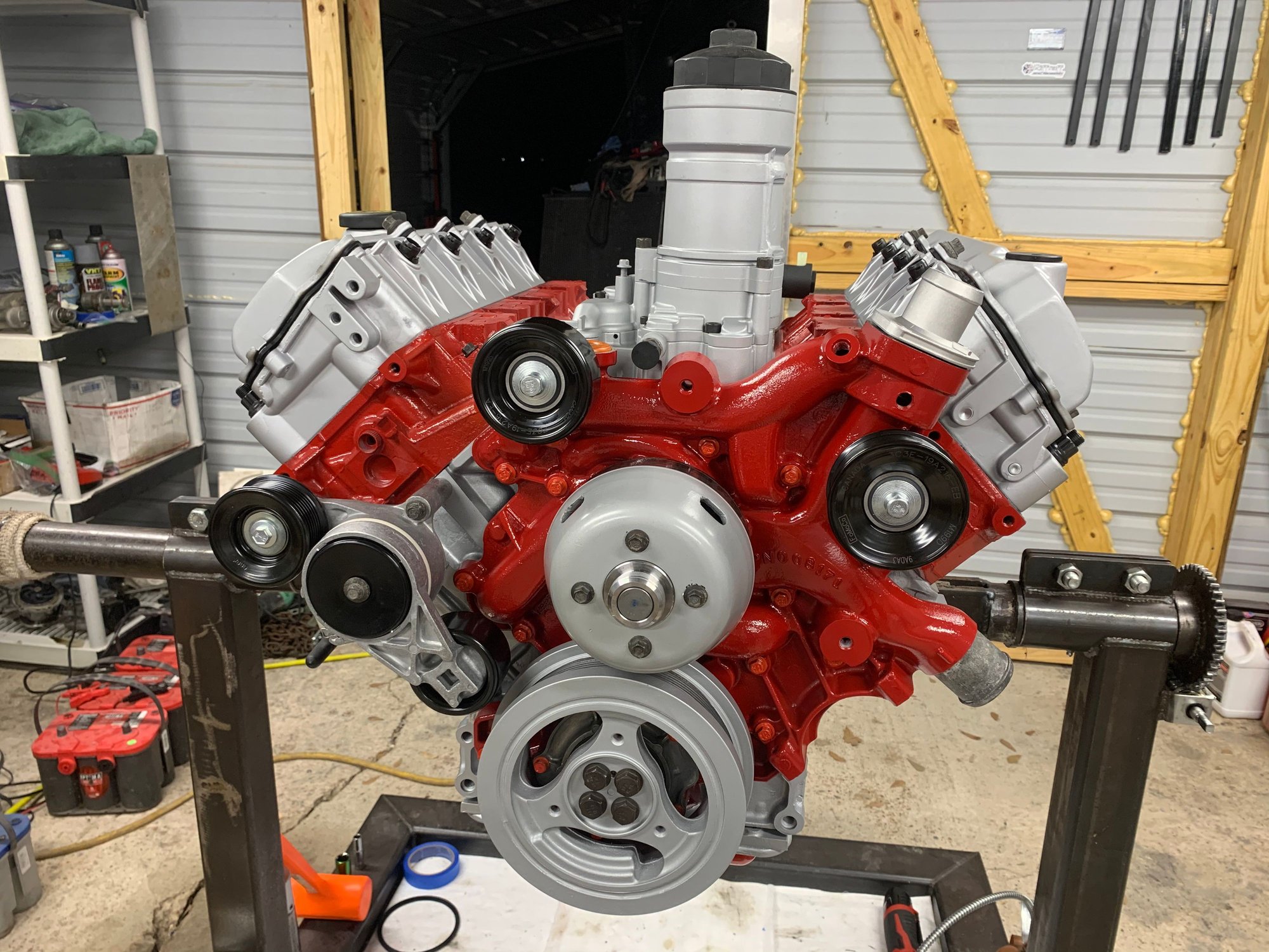

Old Feb 15, 2020 | 07:28 AM
  #113
SmackDaddy's Avatar
SmackDaddy
Joined: Sep 2016
Posts: 3,941
Likes: 240
From: Texas
I think the cerakote guy is either half blind or half assed...I took the manifolds to him to prep and re-coat and he left them outside for me to pick up because he was leaving early for tge weekend. I got there and everything looked good until I saw the spot again. I don’t think he even media blasted them because it’s the same spot. I’m buying new Motorcraft manifolds and having him coat those so he’s starting with fresh material.

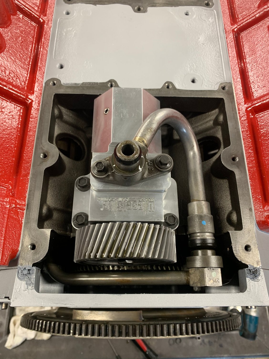

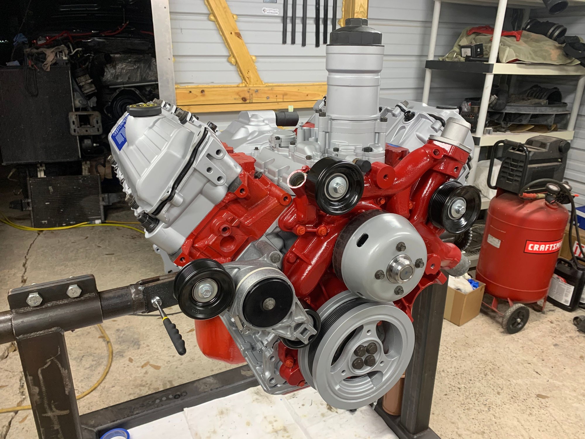

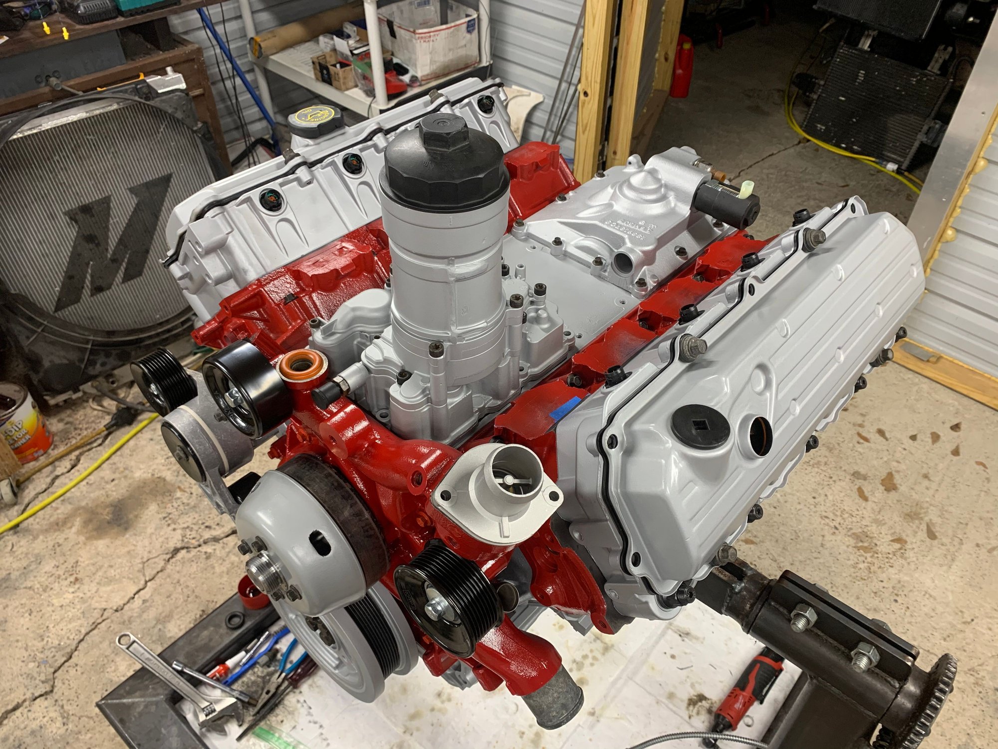

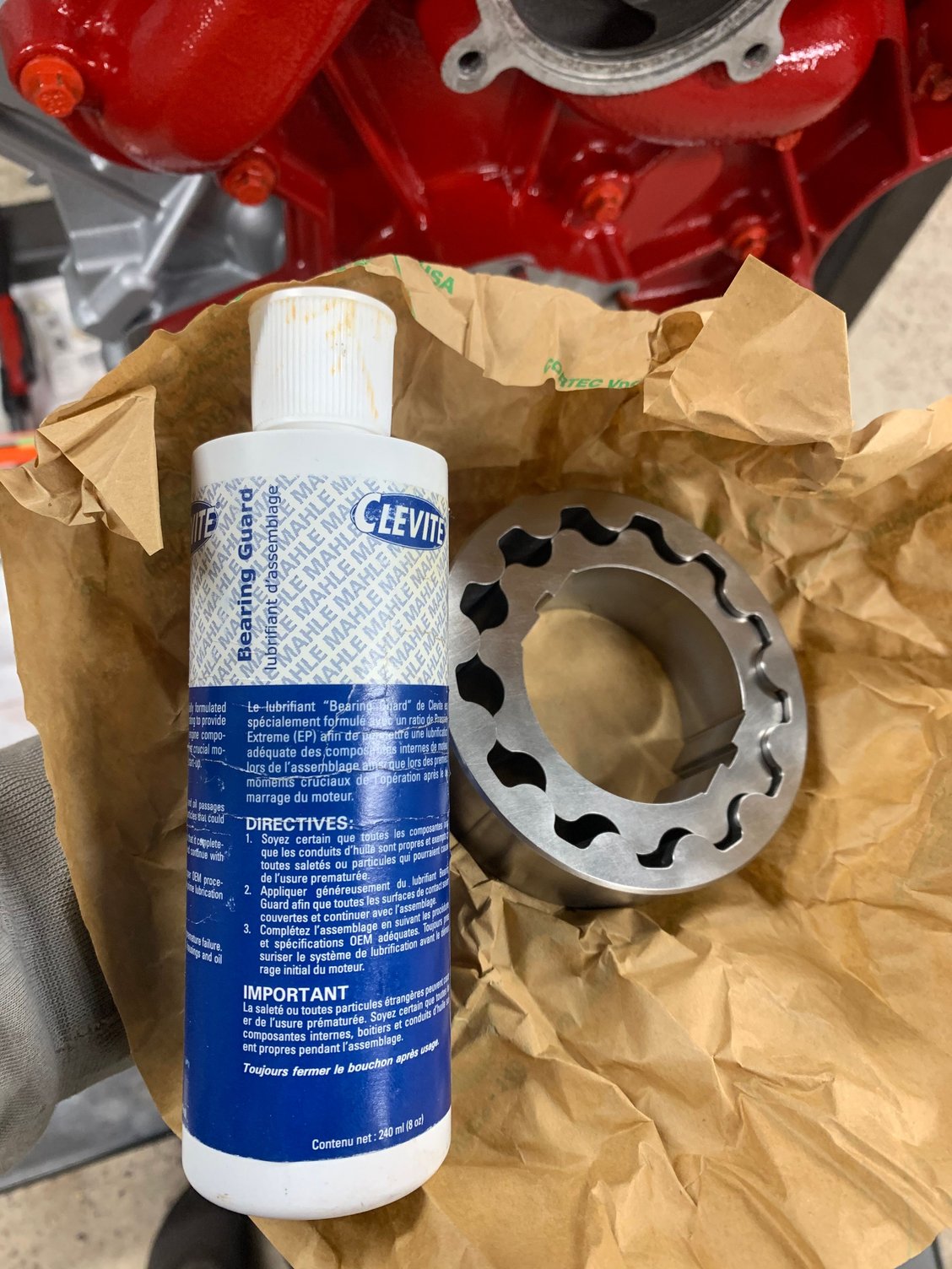

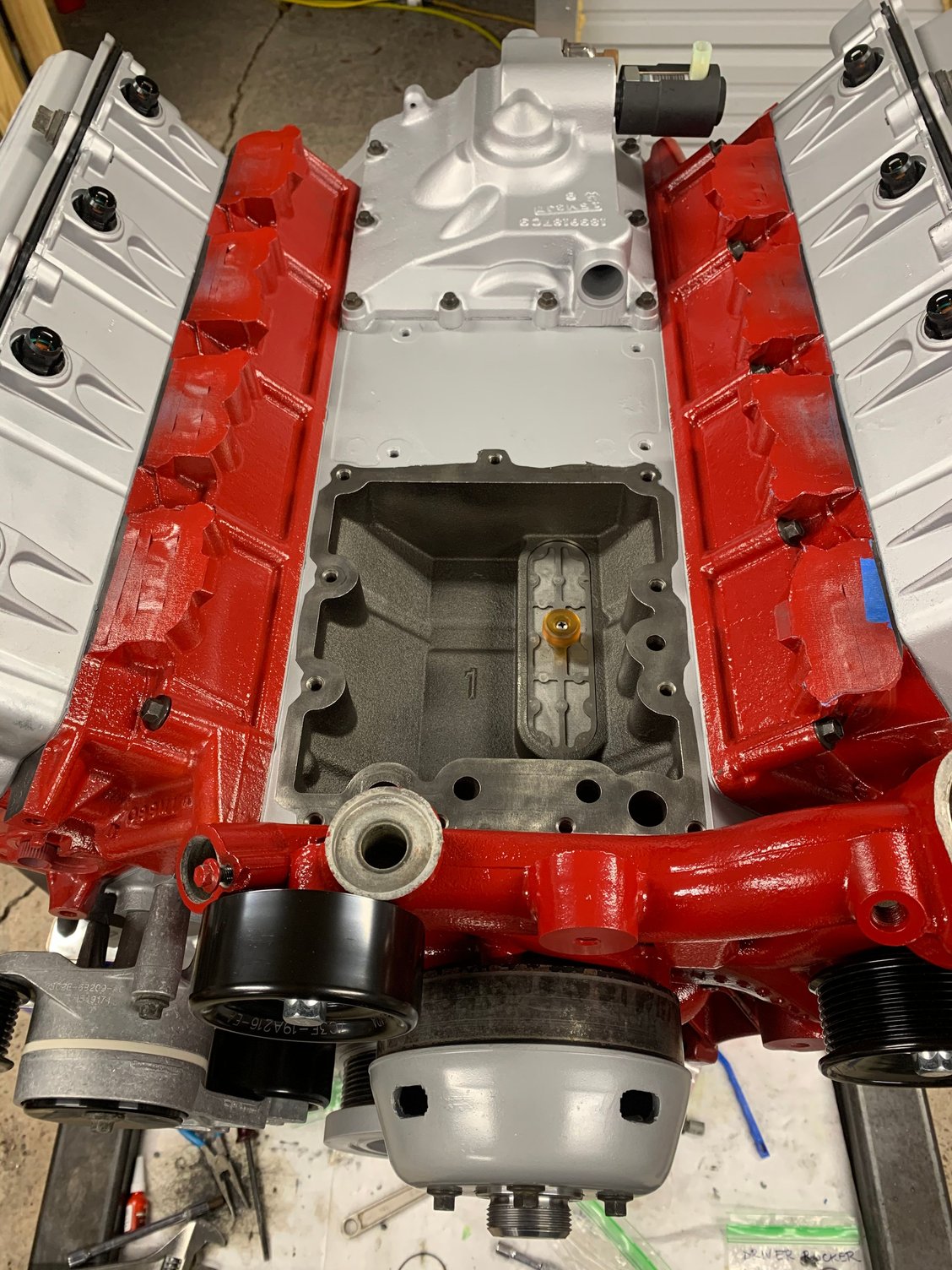

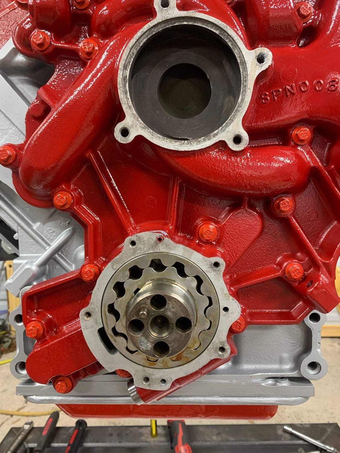

I got the oil cooler manifold, oil filter housing, exhaust manifold bolts/spacers and radiator brackets painted and heat cured. Front and rear covers and seals installed, new low pressure oil gears installed (yes I forgot to paint the LPOP cover). Today I’ll mask and paint that and get the oil cooler rebuilt, HPOP/cover installed and finish dressing the engine. I am also going to drill and tap heads for coolant return lines again

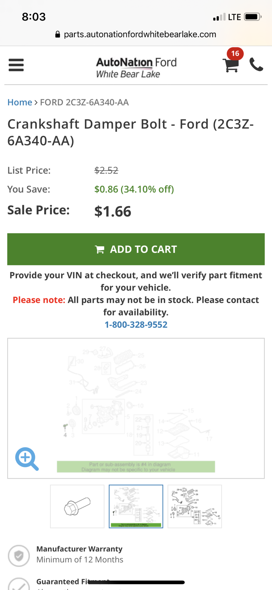

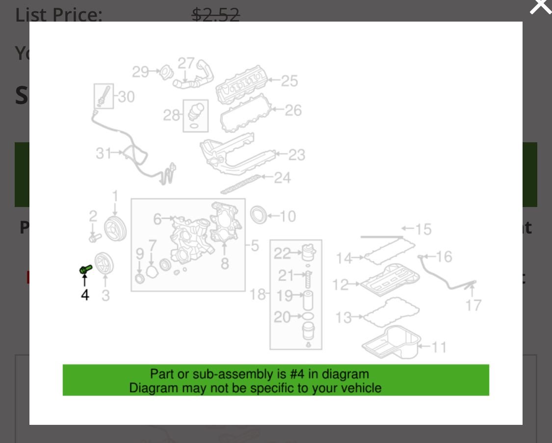

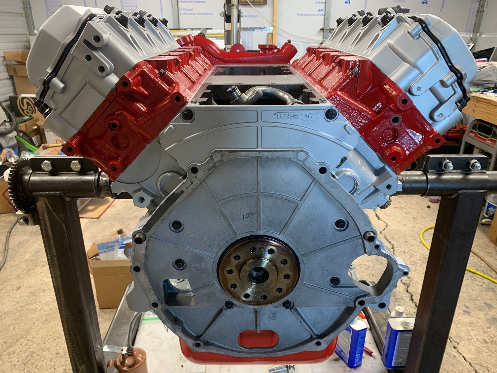

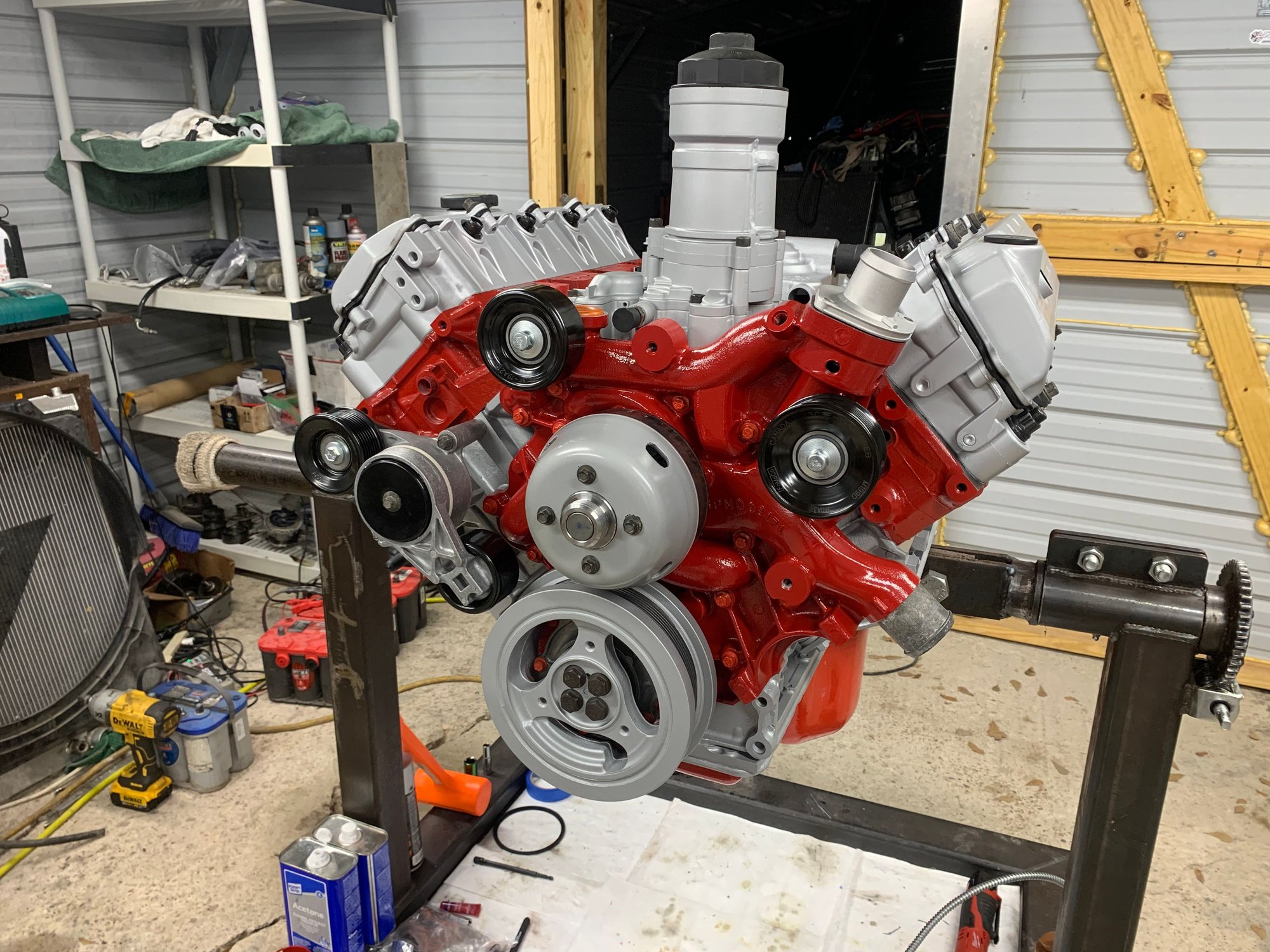

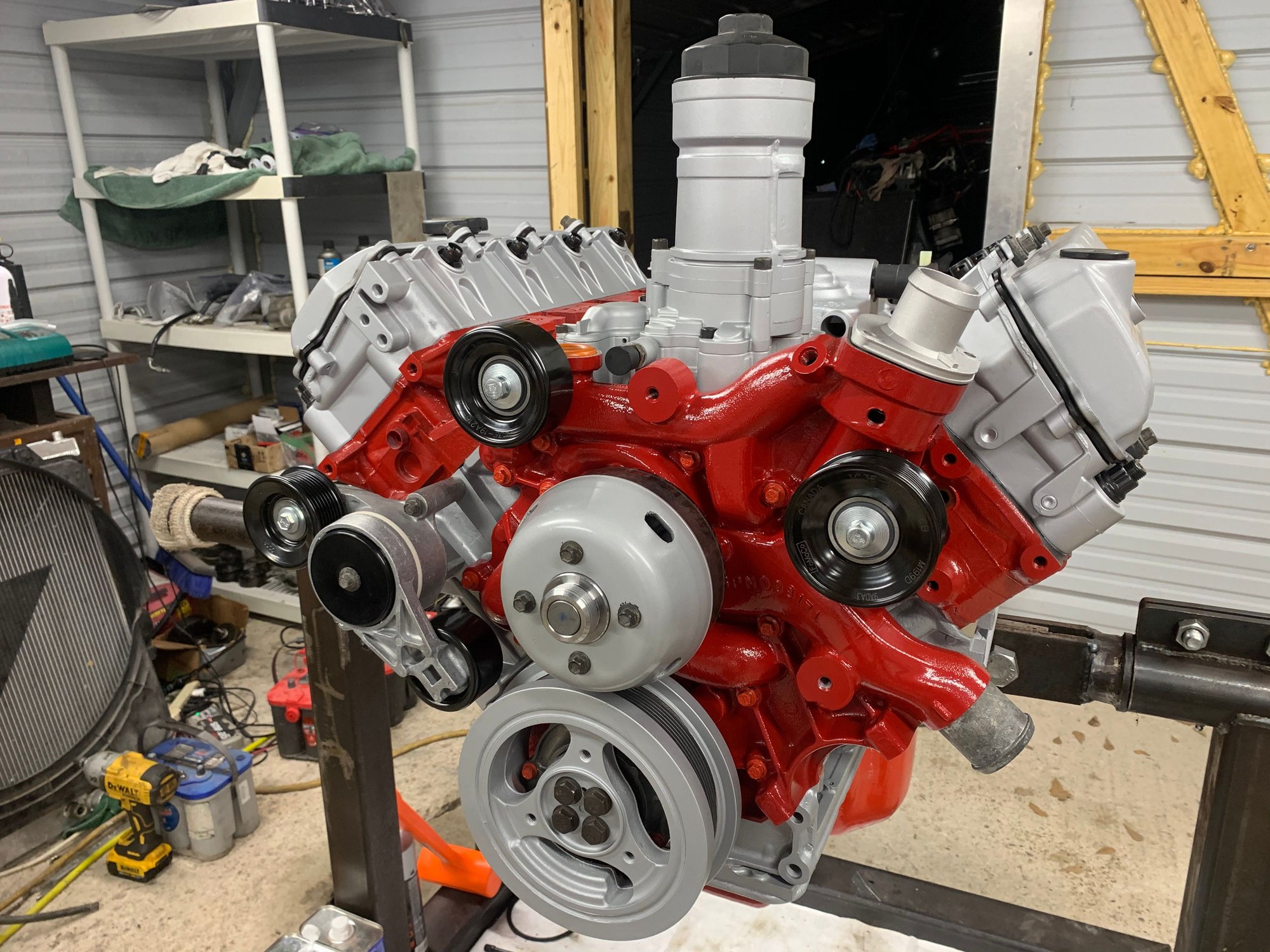

Jack, do you know the part numbers for the crank damper TTY bolts? I did not realize they were torque to yield and really don’t want to wait a week for ARP bolts for $37 from XDP. No one else has them with quick shipping. I found a thread on here from 2017 with several part numbers and the first one is in the photos in the next reply. What about flexplate bolts? I read a few threads you chimed in on about them having Loctite. The service manual doesn’t mention new bolts or Loctite.

The flexplate bolts are reusable, but I think I bought new. They are deep in the box if I did. They are not torque-to-yield bolts.

I cleaned them up, put a little Loctite on them and torqued them down. The local Ford stealership ordered damper bolts for me and they’ll be in Tuesday. I can install those any time after the engine is nestled back in her home...
