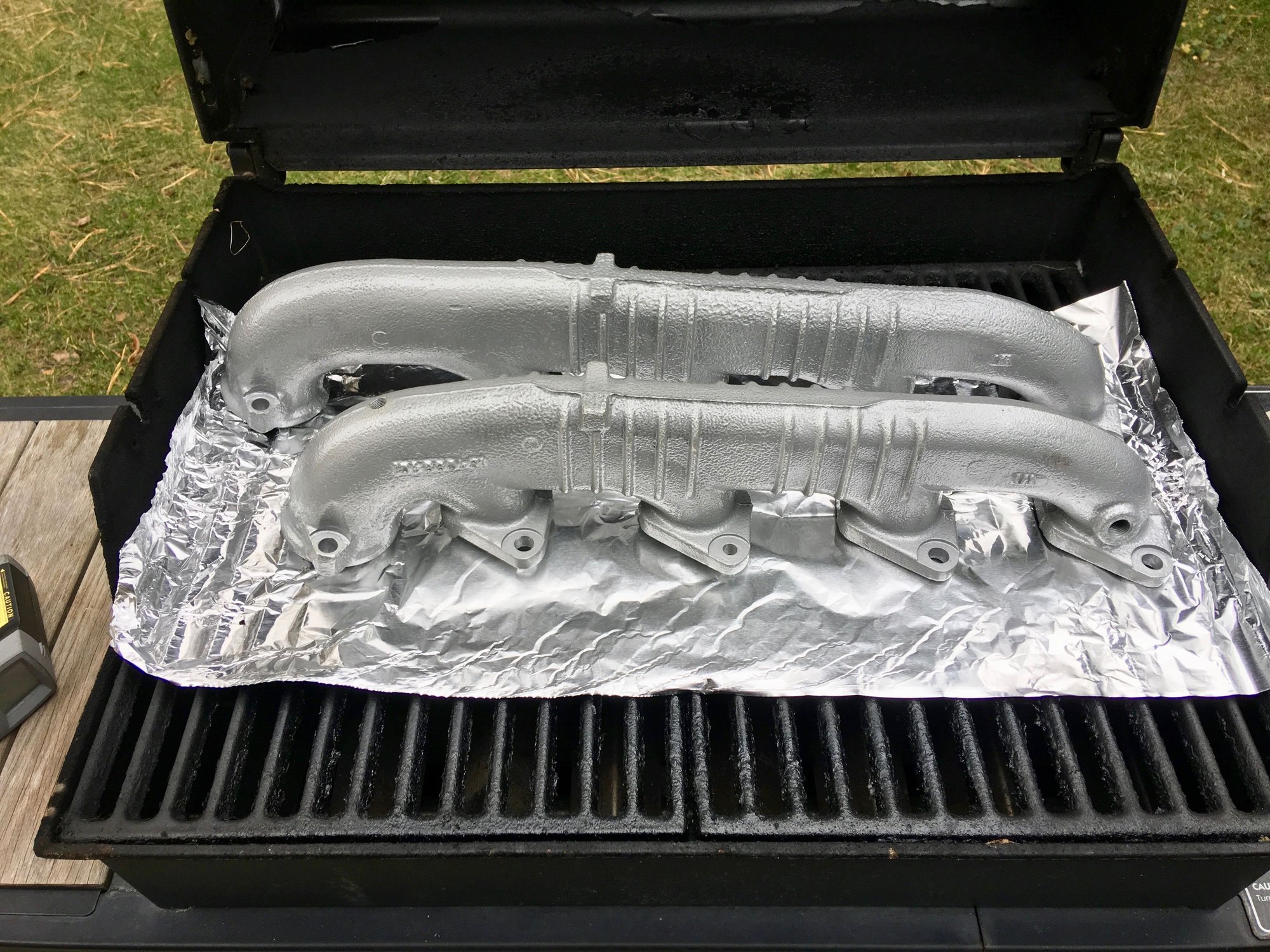

Looking good SD. I'm still amazed that color is aluminum. I'll have to get a can of the VHT and shoot a test panel.
With the exhaust manifolds, if the rust through is only down at that end you could submerge the end in Evaporust for a day and see how it comes out. If OK, then get the guy to recoat. Evaporust typically leaves paint alone unless there is rust under the paint.
I wasn't planning on doing a video about the manifolds, but what they looked like, the first stage of de-rusting, no second stage pictures, but the final heat curing.

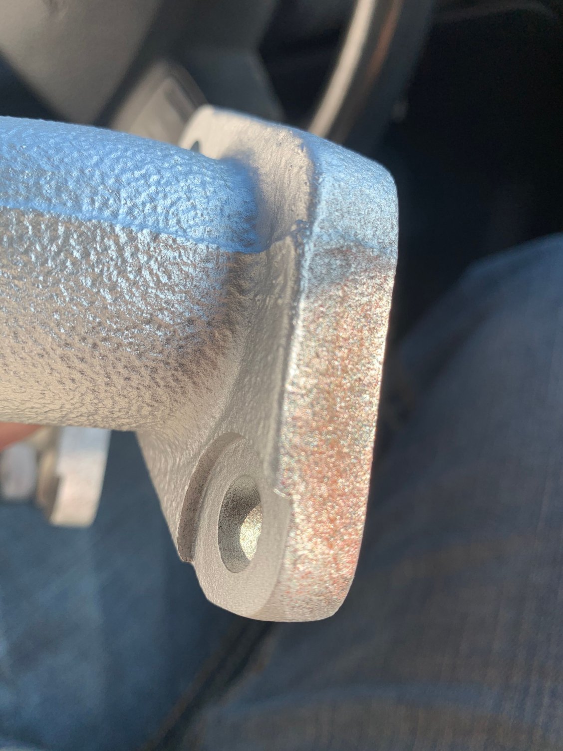

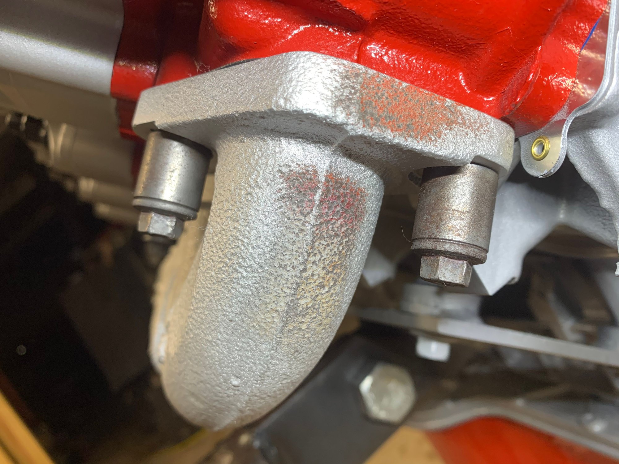

Jack your manifolds look great! On mine the end that has the red color showing through isn’t rust, I think it’s primer. The first time he coated them I had them on the shelf in my shop covered with towels for about three weeks and just the other day I had them installed and saw what I thought was a smudge of oil or something so I grabbed a new dry white terrycloth and wiped it and the coating just came off in that one spot. It wouldn’t rub off anywhere else. I removed them and got a better look at the tiny rust spots coming through. I think he just did crappy prep. Friday he supposedly media blasted them again and recoated and I picked them up that afternoon and noticed that same spot was there. I honestly think he just coated them again without blasting and missed that spot. He swears he’s going to get it right Monday or he’s buying me a new set of manifolds and coating them for free. I paid $100 for the Cerakote on the manifolds and he powder coated a new Dieselsite intake elbow and powdercoated my CAC pipes again so they matched. His powdercoat work is awesome, I had them done last year and they just had a couple of places where I chipped the finish working under the hood.

The first photo is the day it rubbed off, the second is yesterday when I had him recoat them.
Yessir, VHT Flameproof Flat Aluminum. It is pretty flat but has some nice super fine metallic silver to it but really changes to like a pearl grey after the Satin Clear top coat and baking on the gas grill.

Since it wasn't in your sig, I wasn't sure ....
Seeing it with your own eyes is more telling. You've done so much work in prep it would be frustrating.
You bring up the point of why I don't Powdercoat things. Chips in paint I can fix easily. But, that's me.
Those manifold stayed in the barbi for months after curing, but it's still not the same as high-heat use. If mine develops rust it won't bother me. The original plan was not to do any painting, just flip the motor and be done with it. I just hate working on dirty stuff, and if I have time on my hands I'll fall back.
