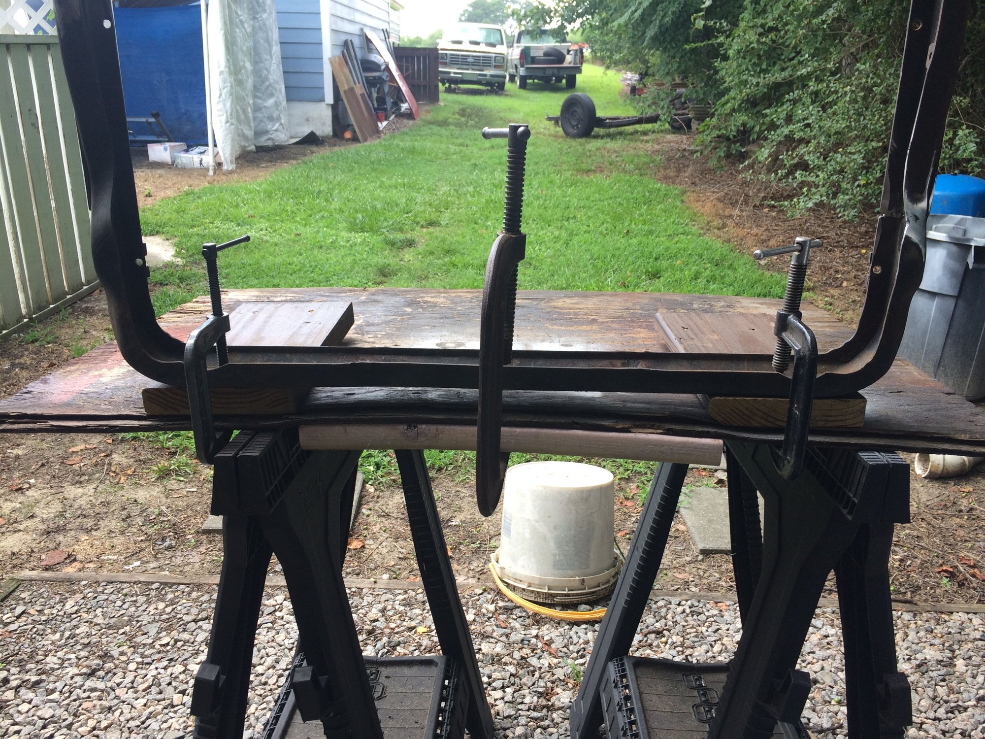

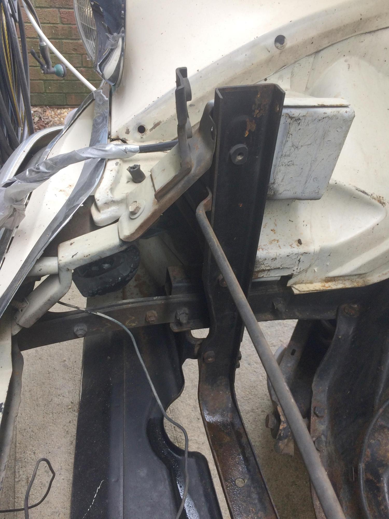

I can't remember if I posted anything about this before, but I had a rough time getting the radiator support out of the Studebaker. After removing all the bolts, it was loose enough to wiggle around but it still wouldn't come out. I tried to "persuade" it by putting a jack underneath it and raising it, but all I succeeded in doing was bending it upwards and raising the car! Turns out, there are 2 "ears", one on each side, that are connected to the frame. You have to remove those bolts, which by the way also serve to mount the inner fenders. There are brackets on either side of the ears that prevent you from getting in there with a sawzall or a cut-off wheel. According to guys on the Studebaker forums, you essentially have to disassemble the front end to get it out. It's one of the first pieces installed when putting the car together. Another one of those "great ideas" from Studebaker that lead to their ultimate demise? Well I decided it was easier to cut it apart and remove it, then cut off the ears and weld it back together than it would be to take the whole front end apart, so that's what I did!
The ear prevents you moving up or down, the piece in the front and the chin piece on the bottom prevent you from sliding it forward, and the inner fender piece prevent you from sliding it backwards.
It's a pickle, I tell ya!

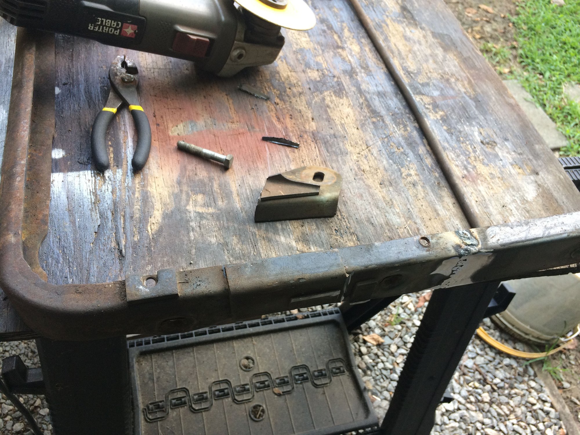

Cutoff wheel is out, about to be the moment of truth.
The point of no return! You can see the 2 mounting ears that caused me so much trouble.
Welded back together and cut off the ears.
You can see I cut one side below the ear and the other side above it, this was so that each piece would only have one ear and could therefore come out by sliding it inwards.

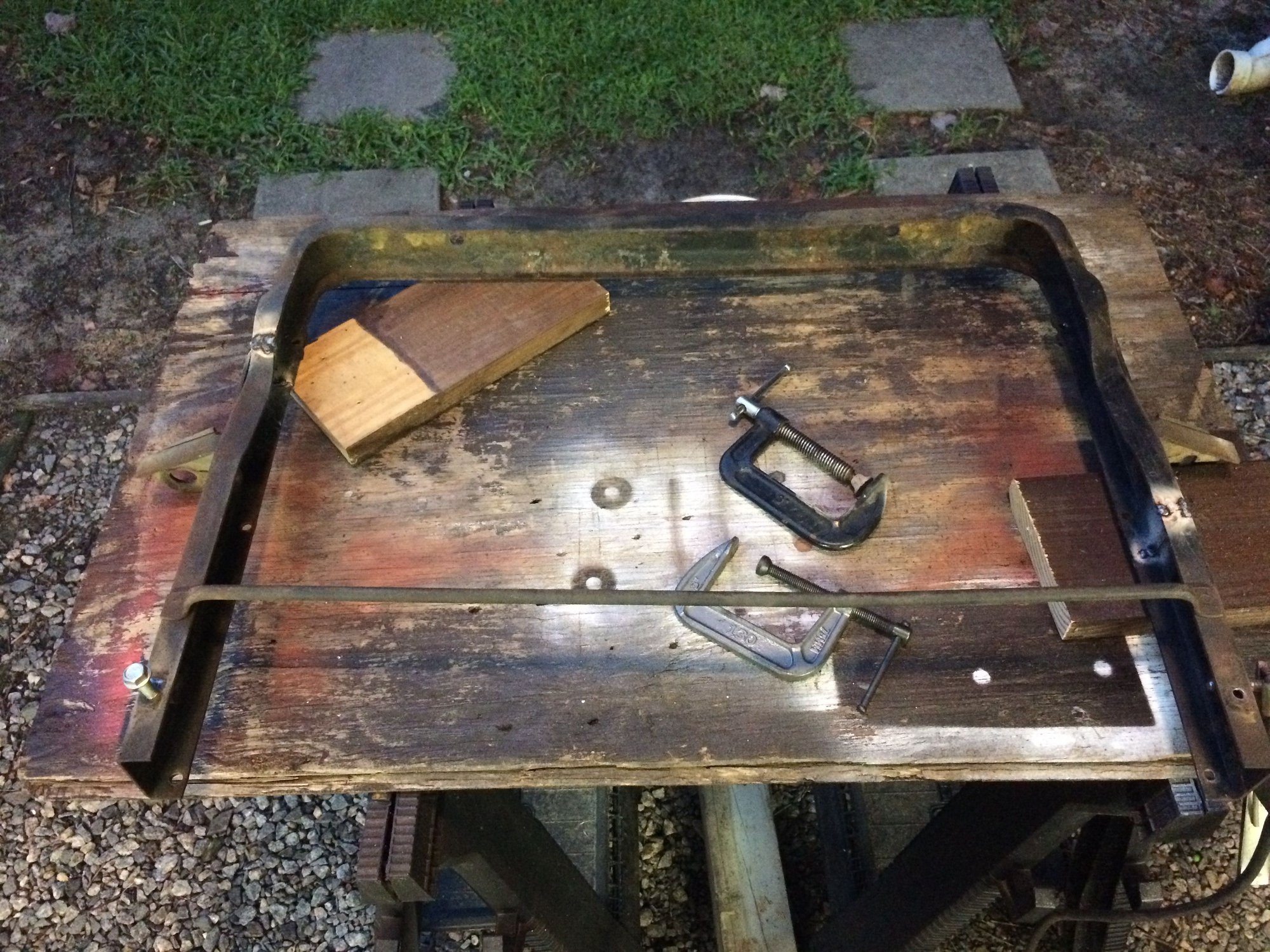

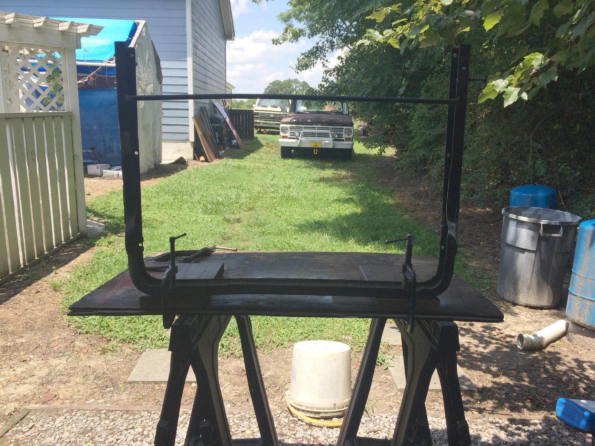

After stitching it back together, now I wanted to address the bend in the bottom.
This was all I could do with clamps, even after adding a little heat from my torch. It helped a little but it would always go back once I loosened the clamps.

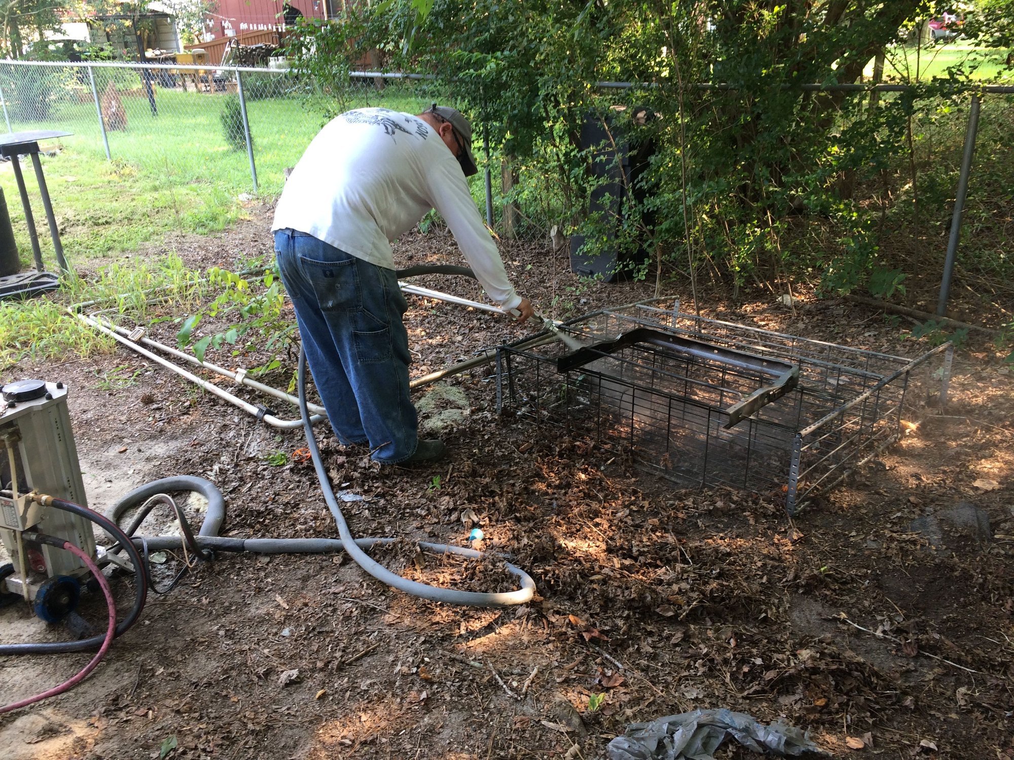

I brought the radiator support along with a bunch of other pieces to my friend Jeff, he sandblasted them and then sprayed them with black epoxy primer.

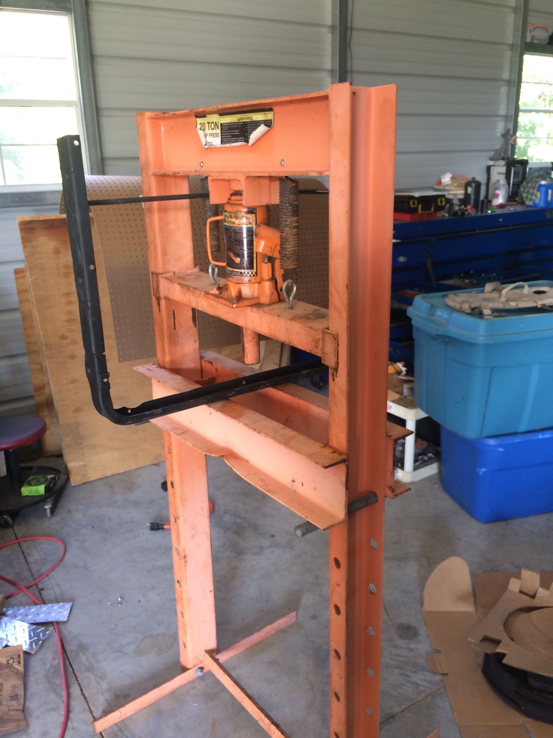

Wesley helped me straighten the bottom piece, using his hydraulic press. Did each side maybe 1/4 inch and then the center.
Tada! Nice and straight. Next step will be to paint it black.
Just in case anyone is curious, yes I did test fit it and was able to get it in, but only from the bottom! It won't go in from the top. I swear for a minute there I thought I was going to have to cut apart again to get it in place

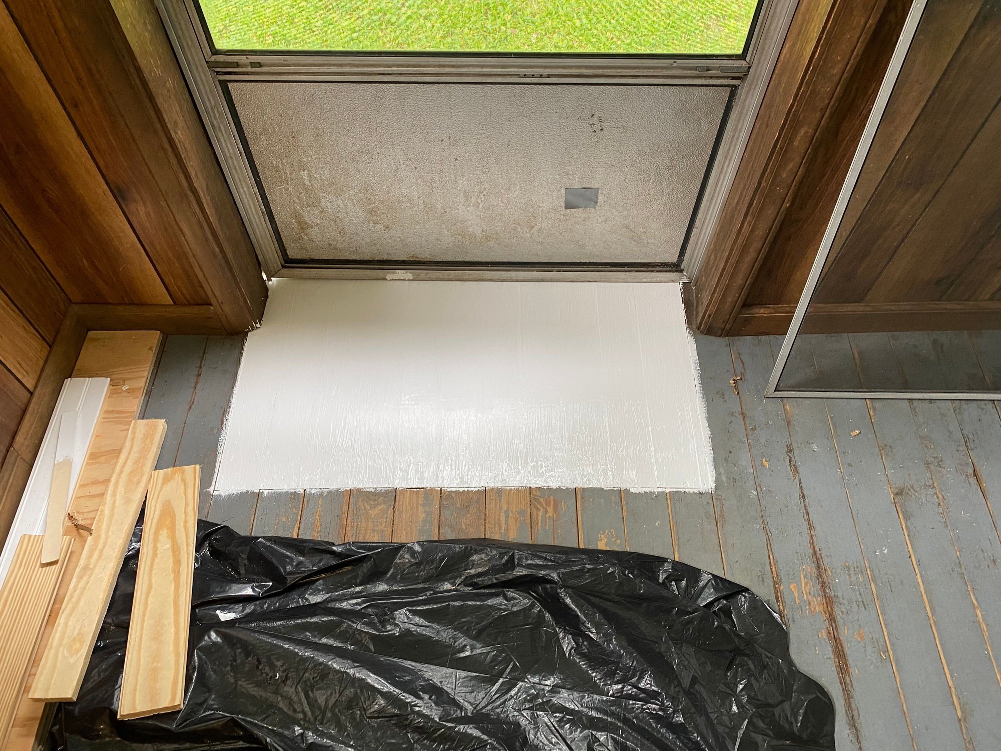

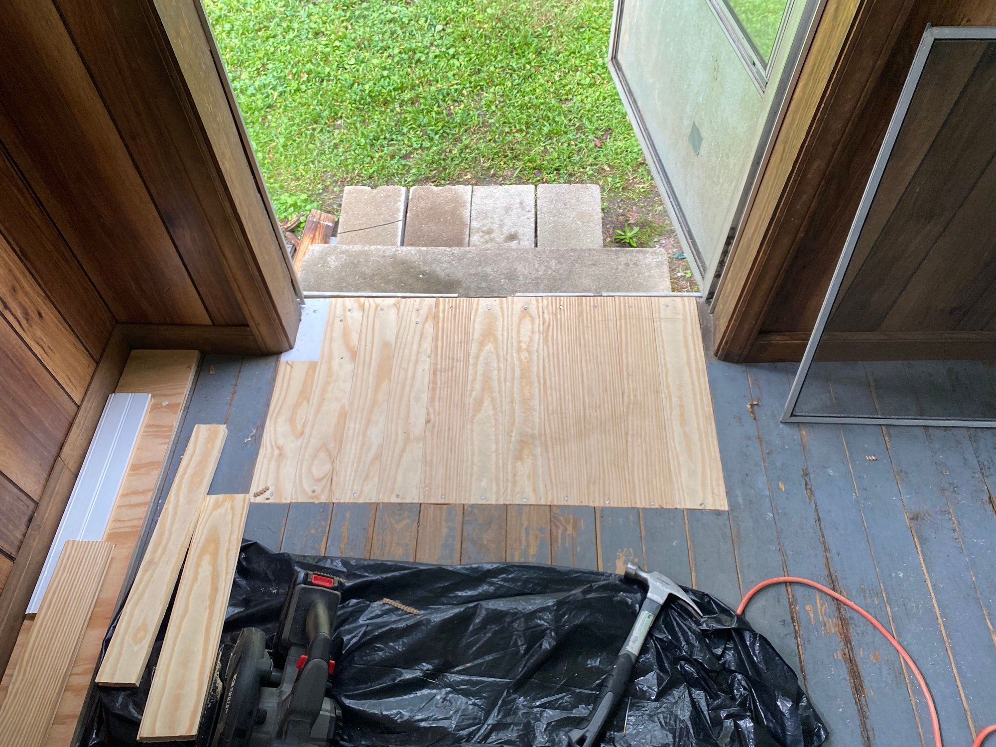

got the rotted floor repaired in my laundry room. No more risk of falling through it coming through the door back there now. And with both sides painted i dont have to worry about terminites eating the new boards.

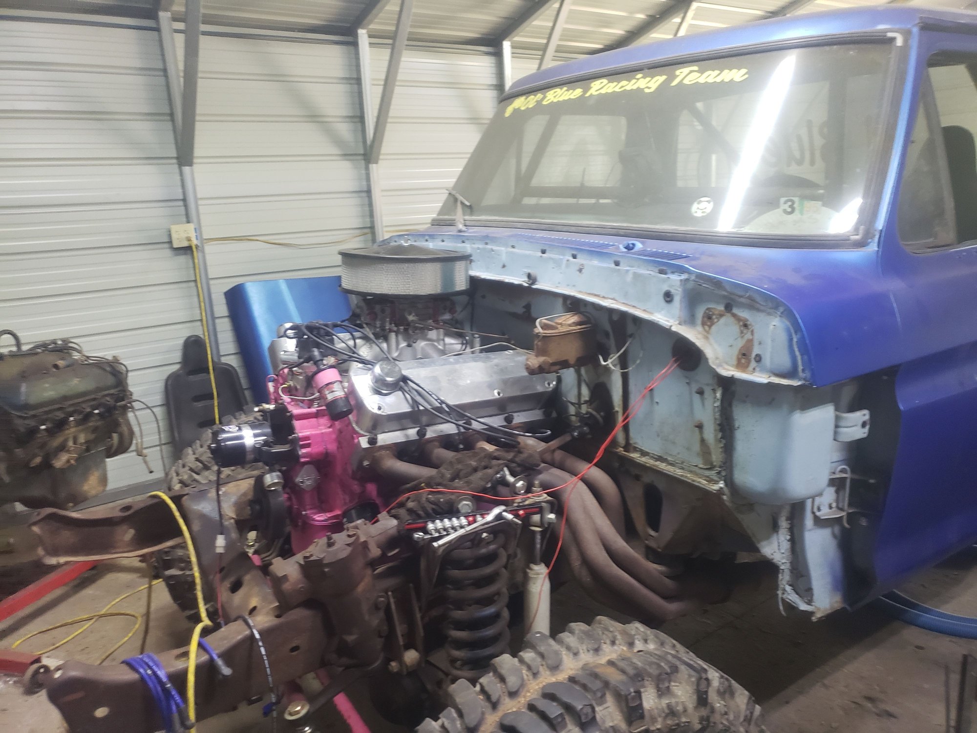

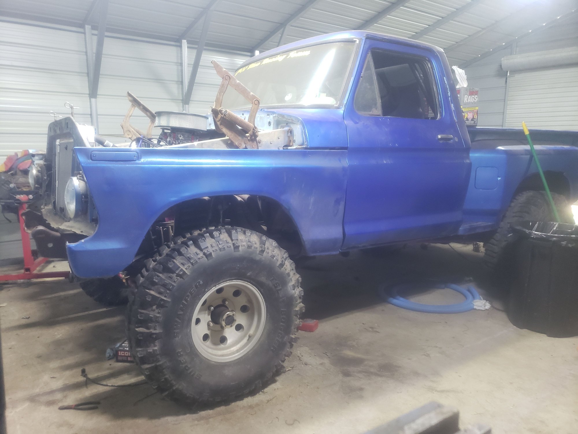

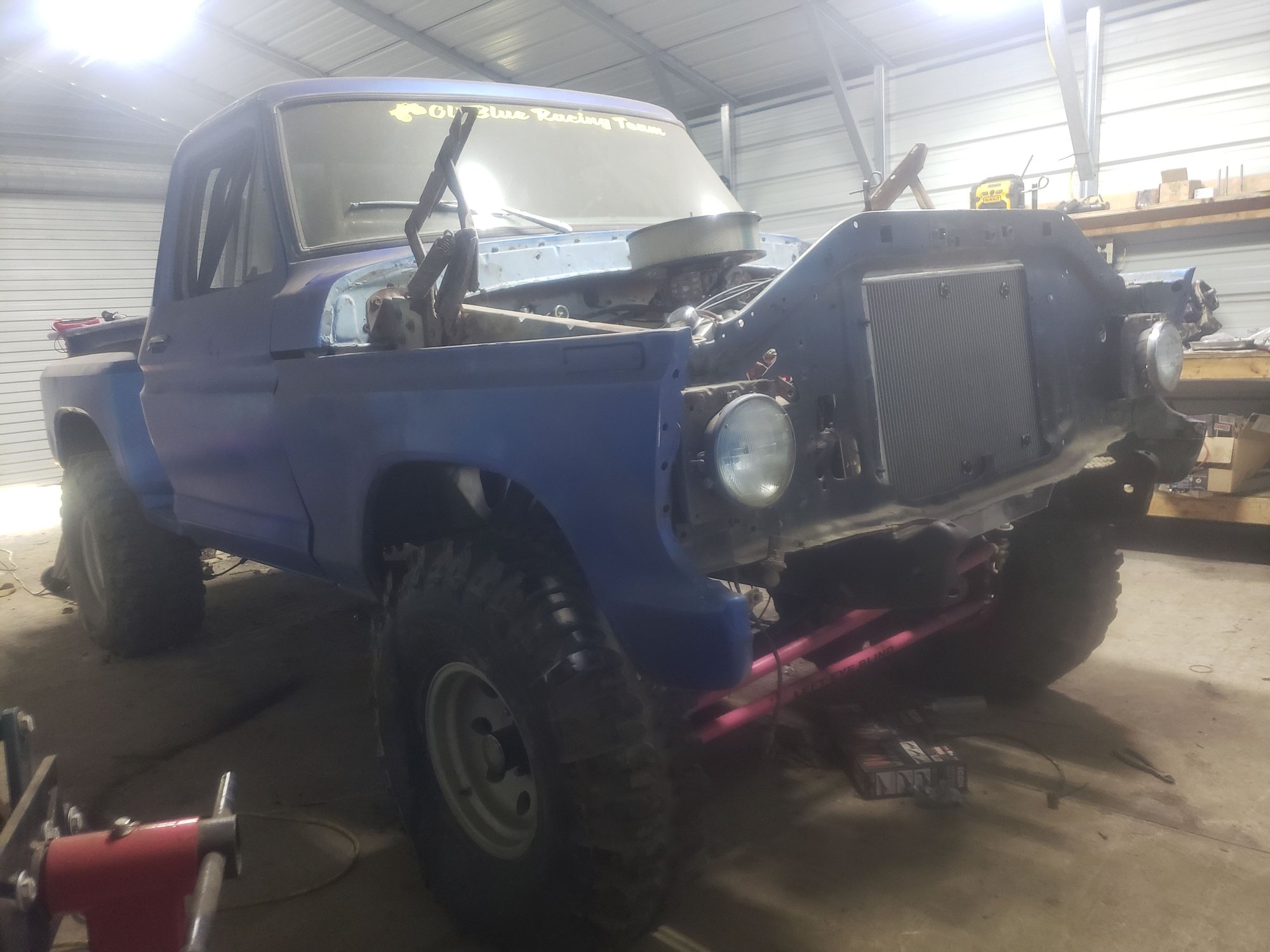

Wellllll finally did it, I awoke the sleeping giant? Beast? Pink panty dropper?
Ran it for a few seconds a couple different times Sunday, everything sounded decent for absolutely 0 tuning, and timing set "close enough to make it crank". I just basically wanted to make sure it would run prior to bolting everything around it. After that I ran through the valves real quick.
Then I started bolting radiator/fenders etc in place.
If it doesn't get to hot in the shop this weekend I hope to get it running again, this time with coolant so i can actually work on tuning it some. I took some video, but obviously being in the building you can't really hear much other than just LOUD on the video.... but it sounded good, that big ol cam sure counts it off.

Larry that pink motor looks pretty hot!
