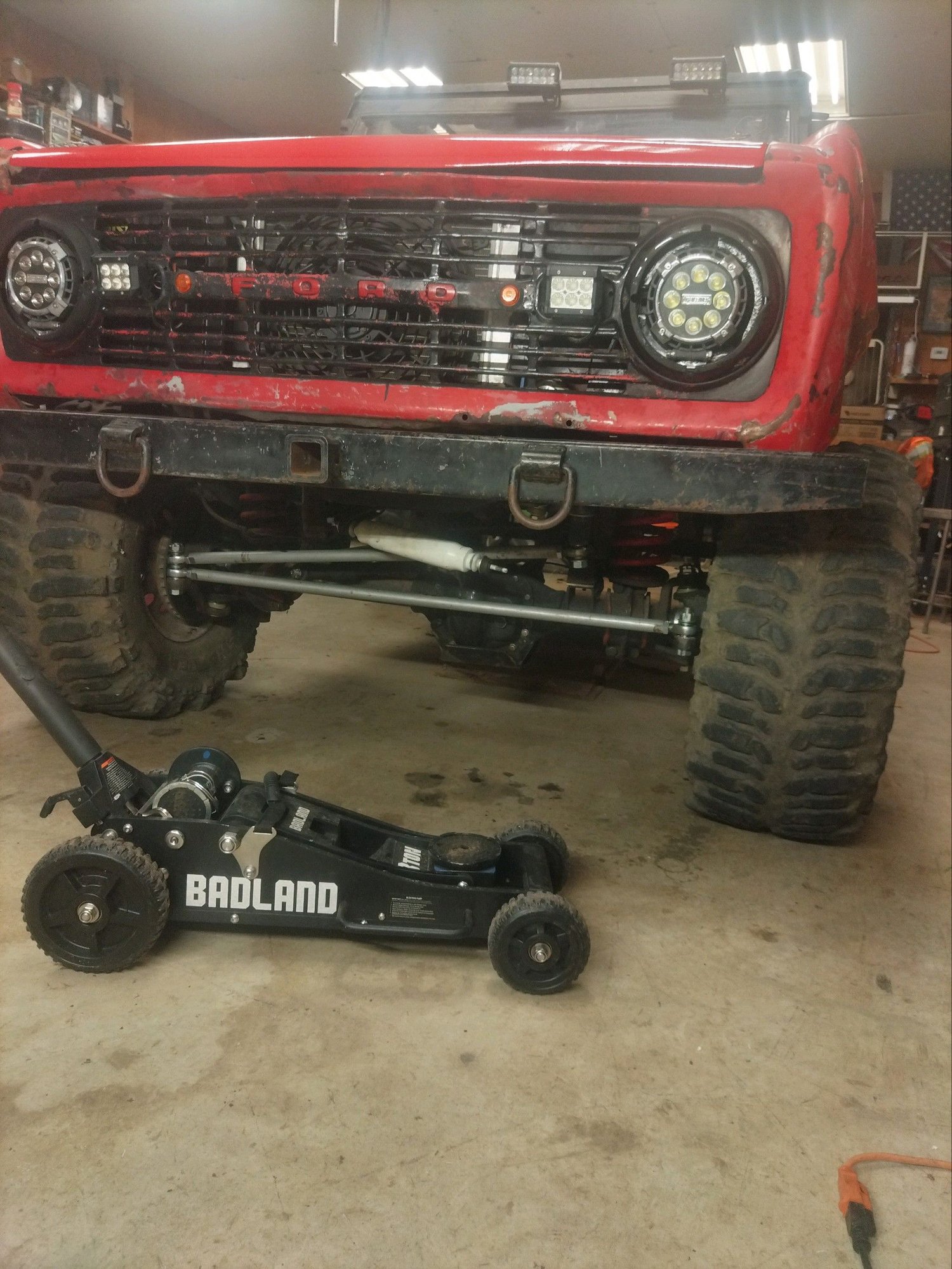

So my Ford buddy came over this evening, we set up the big ol shop fans to pull the exhaust our the front of the shop and push from the back. Started it up and did a full range steer check of everything. All good did not hit any heim edges and heims are parallel to each other. Pitman arm cleared the frame, the double stack of the linkage on the passenger side knuckle, lots of clearance.
Then jack stranded it behind the radius arms (to the frame rails) and put the front suspension in full droop and steer checked it again. Again all good.
It as running crappy so it was putting to much exhaust in the shop for the fans to handle it, so I shut it off and tired it up. Almost put the 37x12.50x15's on it with the bead locks, but only I did test fit one. But I like the 35x14.50x15's and the rims back spacing because it gives me a wider foot print and more stable feeling.
Plan is to get it outside the shop and steer flex it again and set up the steering damper to let me get the most out of its compression and extension ability. I will set it to help the knuckle steering stops "stop short" of MAX MAX and the shock to stop short the steering linkage at the same time the knuckles stop. I am sure the CTM ujoints can take it, but I do not want to be replacing them brand new joints any time soon. Same for my new hardened 4140 chromoly axle shafts.
Tomorrow I am going to test the front receiver and get in the end bay and use the chain lift to pick it up and then the Badlands to stuff one tire. I also spent some time spiffing up the front fenders.
FYI best floor jack ever, rolls over... zip ties, extension cords, air hose, tools, helpers foot/toes or fingers...will roll out the shop one handed and down a gravel road. Rolls over a cats tail like it is not even there. Has a sand/mud pan under carriage, to help from sinking in. Has the extension mounted to it, and the tool to attach/tighten it down. You can lock the pump handle in to a 1/2 down and lift the front wheels to steer it under the truck. Comes with carrying handle.
https://www.harborfreight.com/3-ton-...ack-59136.html

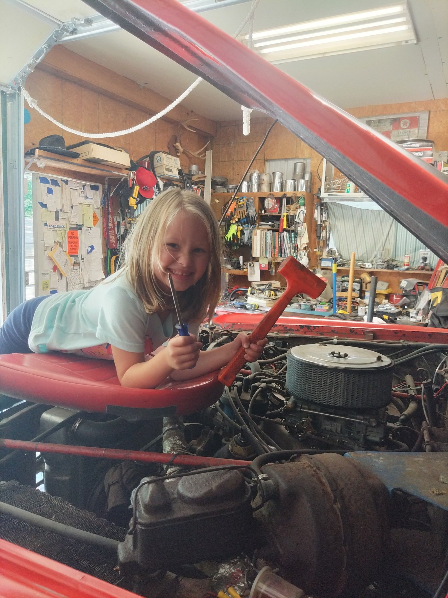

So my shop helper came up to insp my work.
Thinks she can tune a carb better than paw paw. Do you hear that stubble? Can you tune it out.
Hay boss those are for working on chebby tools.

Great pictures! Love seeing’ the young’uns come in to show them how it’s done.

Looking good Rich, Glad to hear you got the steering figured out and nice to see you had some help tuning the carb.

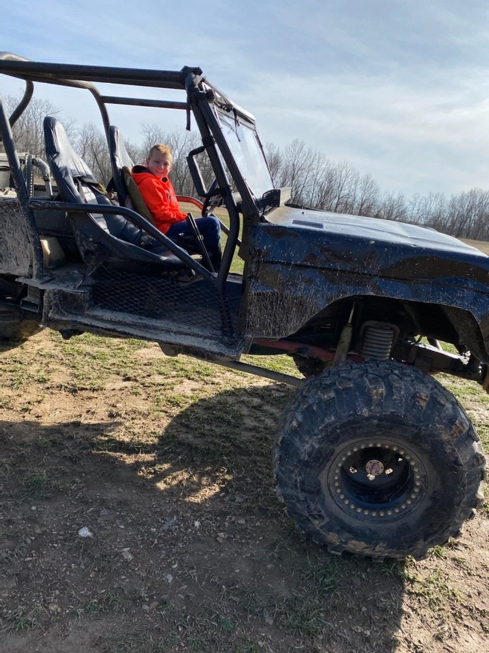

Thanks, yea this grandson will probably own it some day. 7 yrs old and wanting to get on the tire obstacles
Paw Paw coaching him on the flex bumps in his dads rig.
Ready to hammer down solo at 10. Throttle stop bolt installed.....

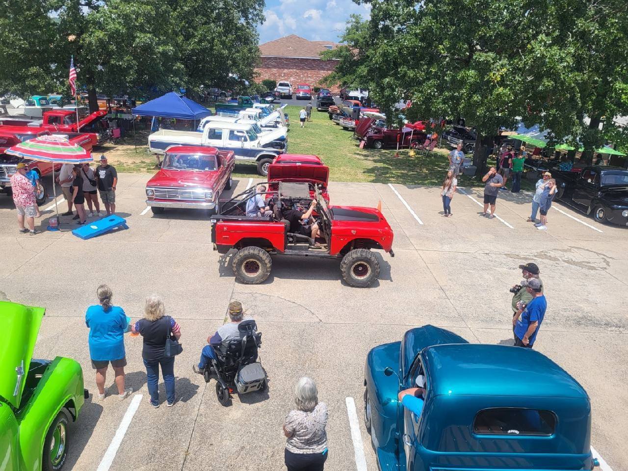

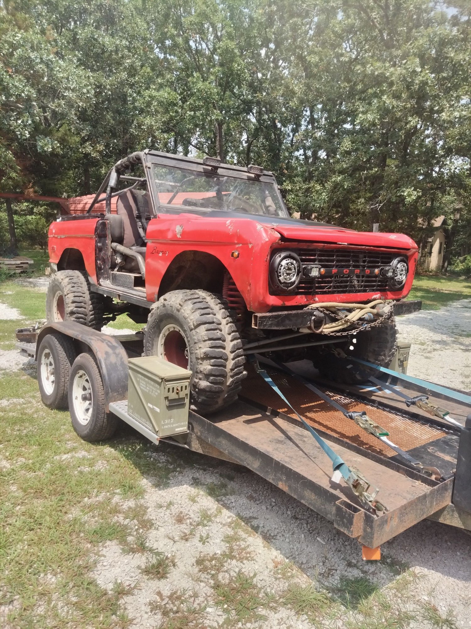

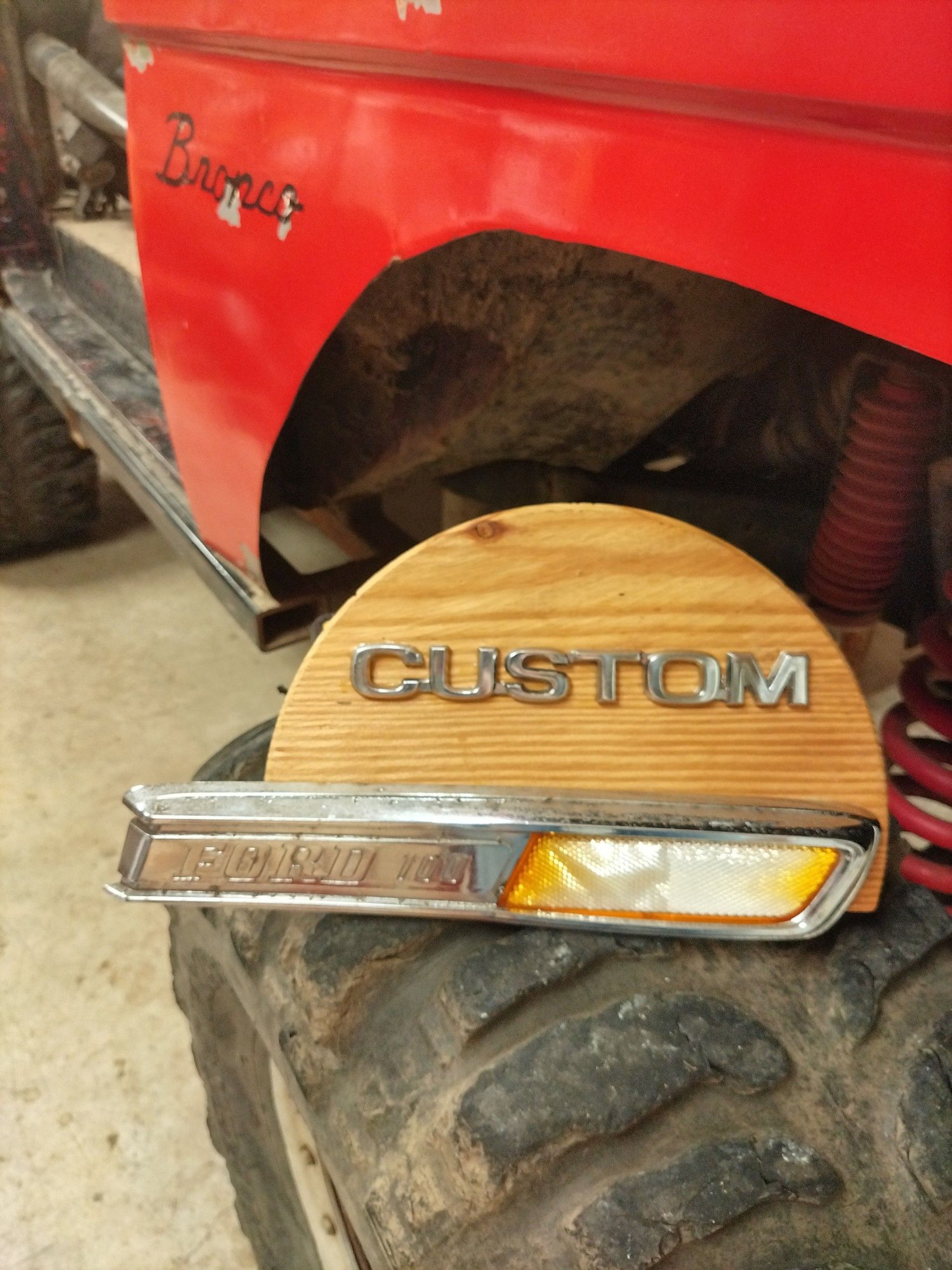

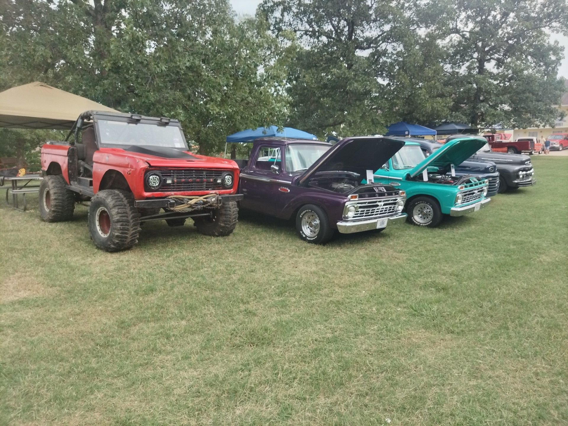

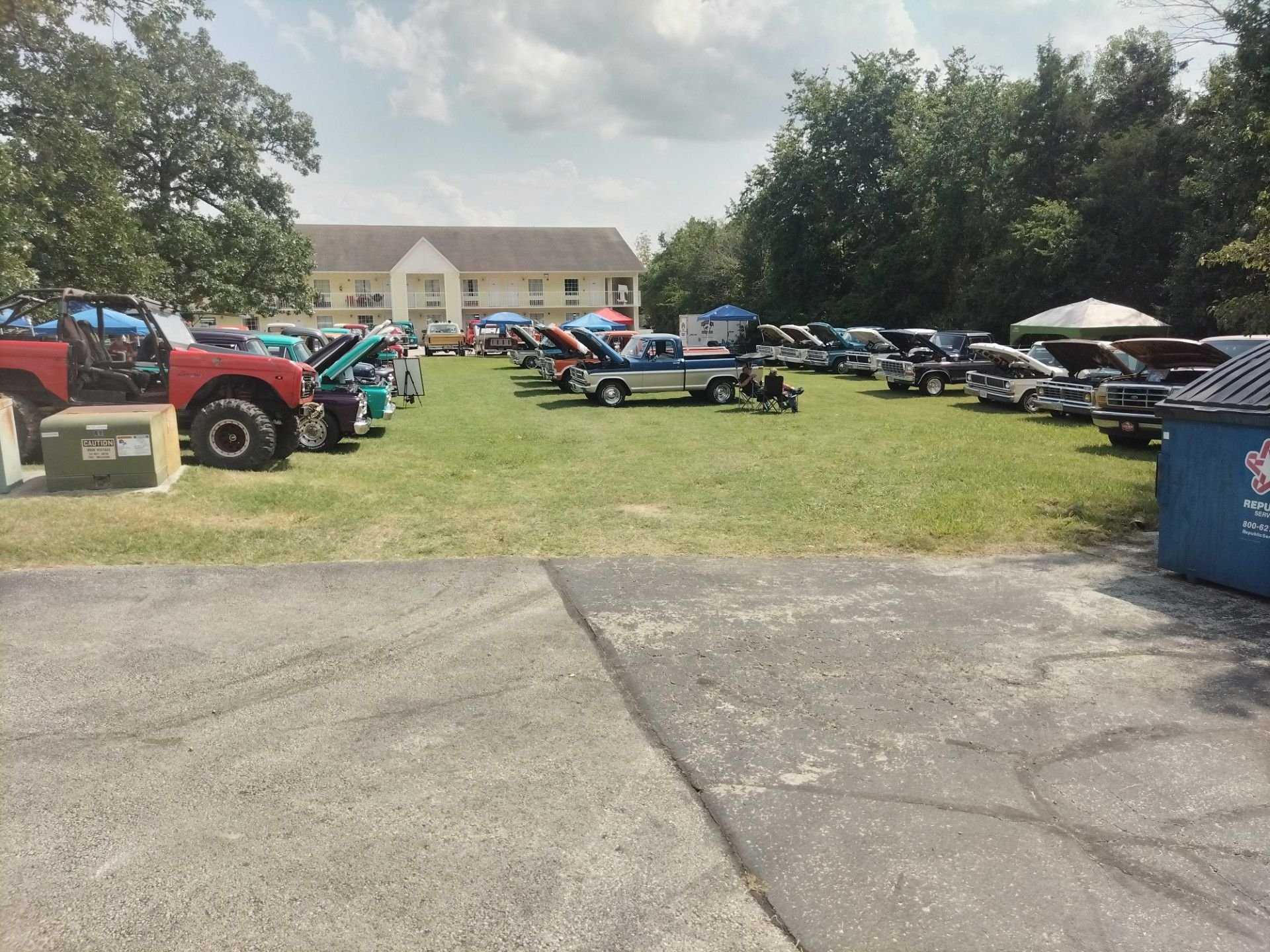

Loaded and hauled it to the Ozark Mountain Run all Ford truck show in Branson Mo last weekend. Had a absolute blast hanging out with fellow FTE Missouri chapter members. I was the only early Bronco there and there was one other 79 Bronco...at all at a Ford truck show. I was talked into doing the "Slow Crawl". How SLOW can you go in 60' with no brakes and NO stopping. I put it in 4 low and low 1 and crawled and slalomed my way to a almost win. I got beat by 1/10th of a sec...I still won a home made plaque for effort, so that was cool. Yes I am a 4 strapper.
Sure enough hauled a Ford Bronco to an all Ford truck show with a Dodge diesel. That is my primary tow rig, so is what it is.
The 4 rigs next to me are Missouri chapter members also.
98 Ford's registered for the event.
Slow Crawl.
Cool home made plaque for sure.
That 66 with the flares is 2wd and double A arm front set up, that is way cool.

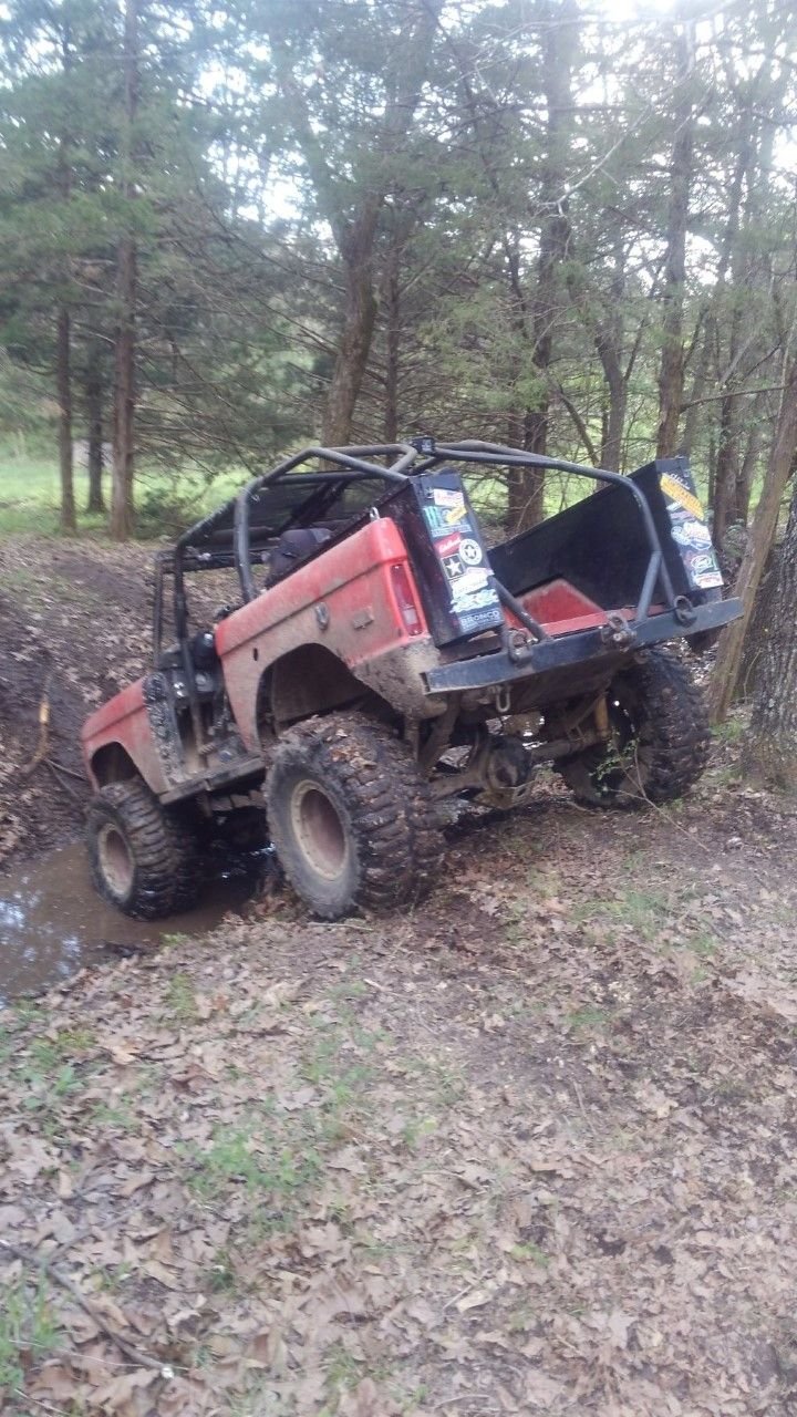

I can go to my back yard, cross the creek and then I have some obstacles to get around on that I built.
