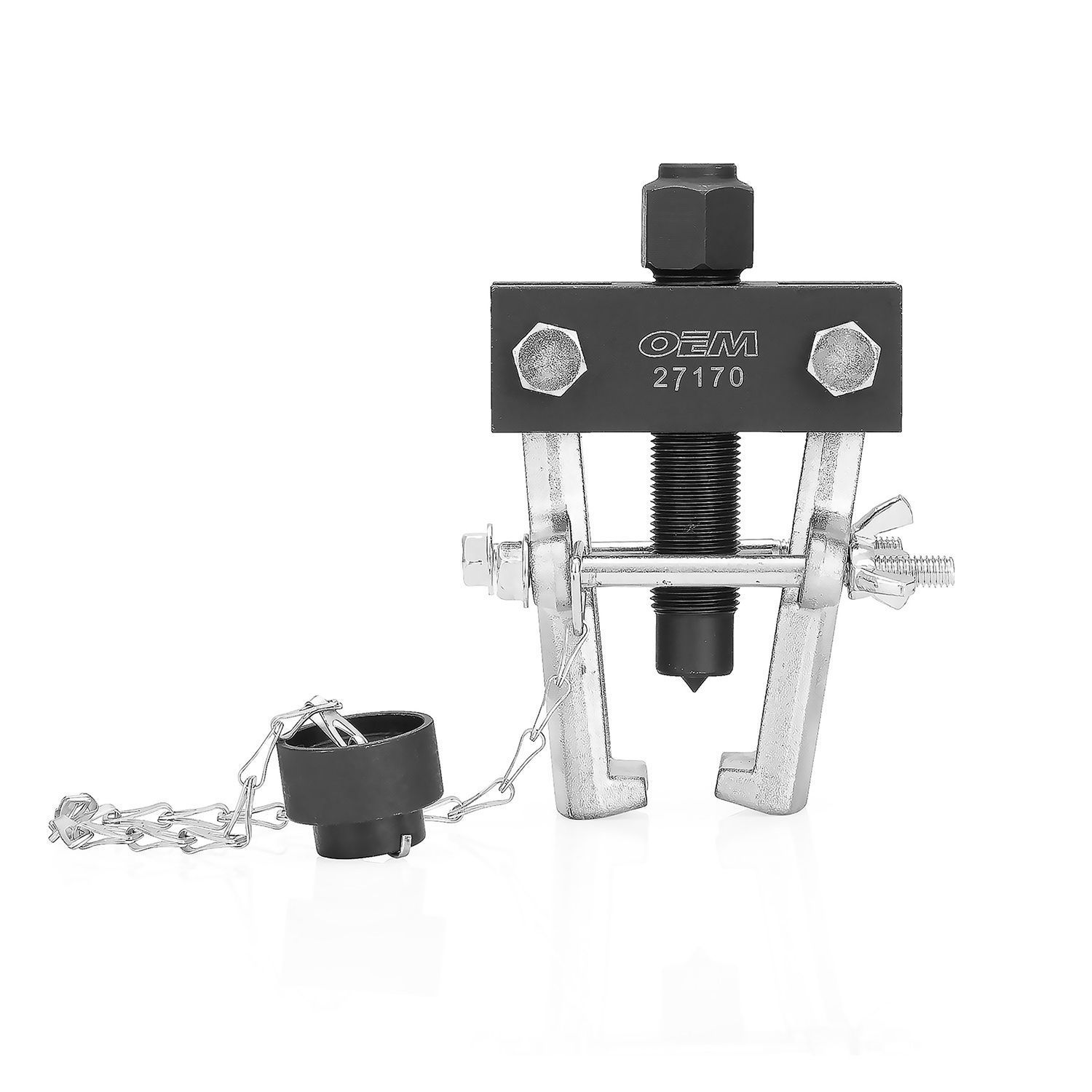

Update: I bought this and popped the pitman arm right off and then the tie rod end in the other end of the pitman arm. Best money spent EVER. I followed the directions to a T and it worked AWESOME. I am now waiting to get the upgraded steering linkage modified (cut, tapped for the thread in heims) and then going to use it.

Oops forgot the link. I got mine from Auto Zone because they had it on hand. I bought it out of their tool loaner program inventory. So yes cost more ($100) than if you can order and wait to get it from Amazon or Summit Racing. But still is the best puller I have ever used.
($62.99) Amazon link:
Amazon Amazon
($62.99) Summit Racing link: https://www.summitracing.com/parts/oes-27170
Just know that is does not work like just a tension puller only, even though it can. It works as a tension and hammer force/impact puller. Like I said, I read the directions on the box and once the tension screw is hand tight with a wrench (NO IMPACT USED).
And you have the adapter collar on there. That collar helps keep the adjustment screw centered on the end of the sector shaft. The collar is what is at the end of the chain, and you get 2 different sizes. And yes you have to take the chain off of them, to use them.
Once it is all on there, and hand tight, you then hammer on the end of the tension screw, like ONE time, not like a 20 hit with a 5lb sledge. Yes that seemed odd to me also. With the tension on the pitman arm from the adjustment screw and the ONE hammer tap, it popped it right off.
I tried to wrench tighten only the arm off, with no luck. And I could of used my Milwaukee 18V impact and tightened the adjustment screw that way and tried to pressure it off. But I have enough gear pullers with jacked up threads.
It also worked perfect for the tie rod end that was in the other end of the pitman arm.

That puller you got looks like it could be useful in many different applications beside just pit man arms
The last pit man arm that I took off of my 93 F150 I broke 3 of these OEM 25262 pullers
So on attempt number four I got the OTC 8150
It worked great but there was so much force applied to it I was afraid to be under the truck with it for fear of flying metal in the explosion I was sure was about to happen.
The conical style pullers seems to stay put very well and don't deform when under pressure.

Yes that bottom one is similar to the p/s pump pulley puller. I am getting one of them next, thanks for the part #. I am also looking at a similar design one that is a u-joint press.

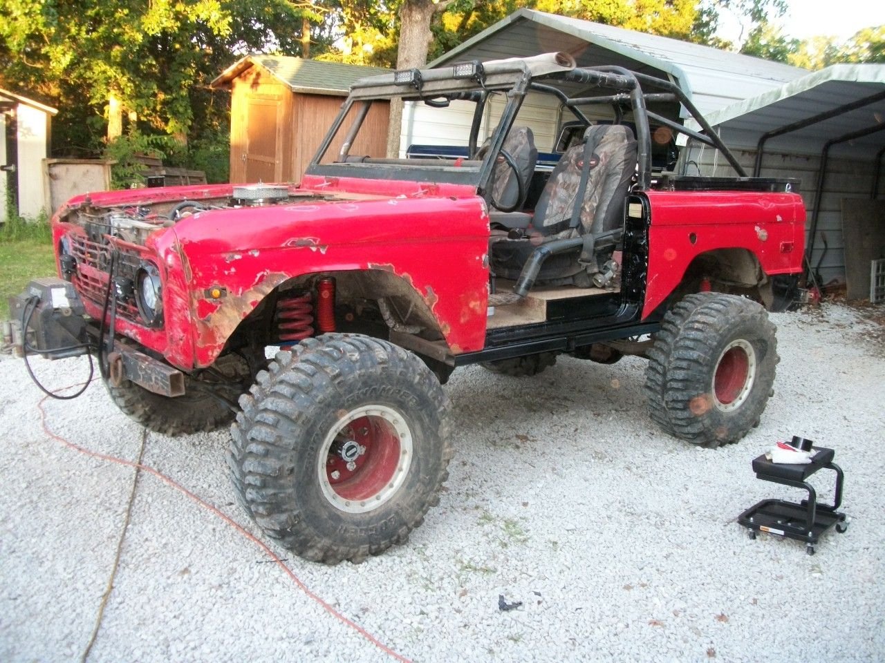

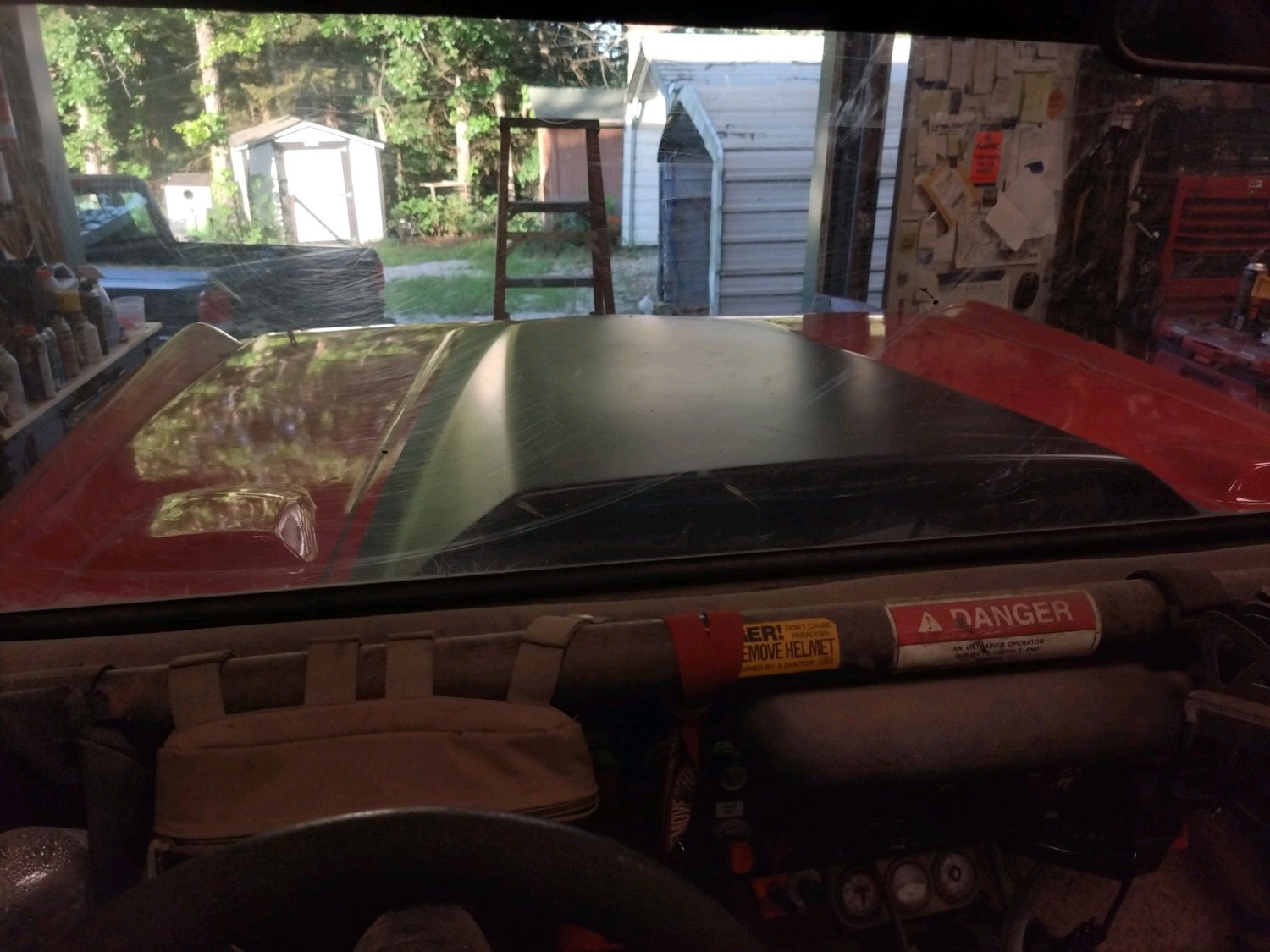

Well my paint and body work buddy said he had some left over red paint and offered to do the needed fiberglass repairs and then shoot some paint on it. I said go for it. Now it really shows how badly faded, oxidized and beat up the fenders are. Yes the gaps are atrocious due to the front end taking a little shot in the dvr fender. It is a crawler, I do not worry about gaps, they help with engine compartment air flow. And yes that is a rectangle hole cut in it from the PO.
Seems they could not get the elec fan mounted any lower, so they just cut the hood. I did a little core support trimming and got the fan centered on the radiator. I had my buddy leave it in there because that is my handle for removing it by myself, I do not have any hinges on the back edge. I just use a bungie cord thru the cowl vent holes. I also got my upgraded steering linkage back from my machinist buddy after a cut down and tap new threads for heims.

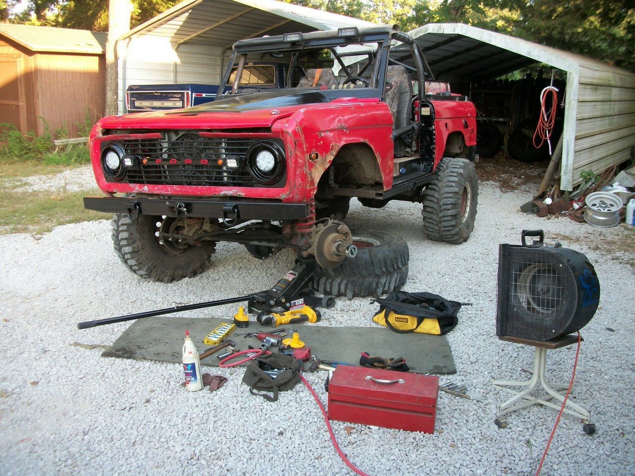

After my buddy (same one that just painted the hood) did a buffer polish job on the rest of it, quite a while back though. And I squirted some black on the parts that need it.
And the grill back then, that I need to redo now. This was track bar hdwr replacement...always something.

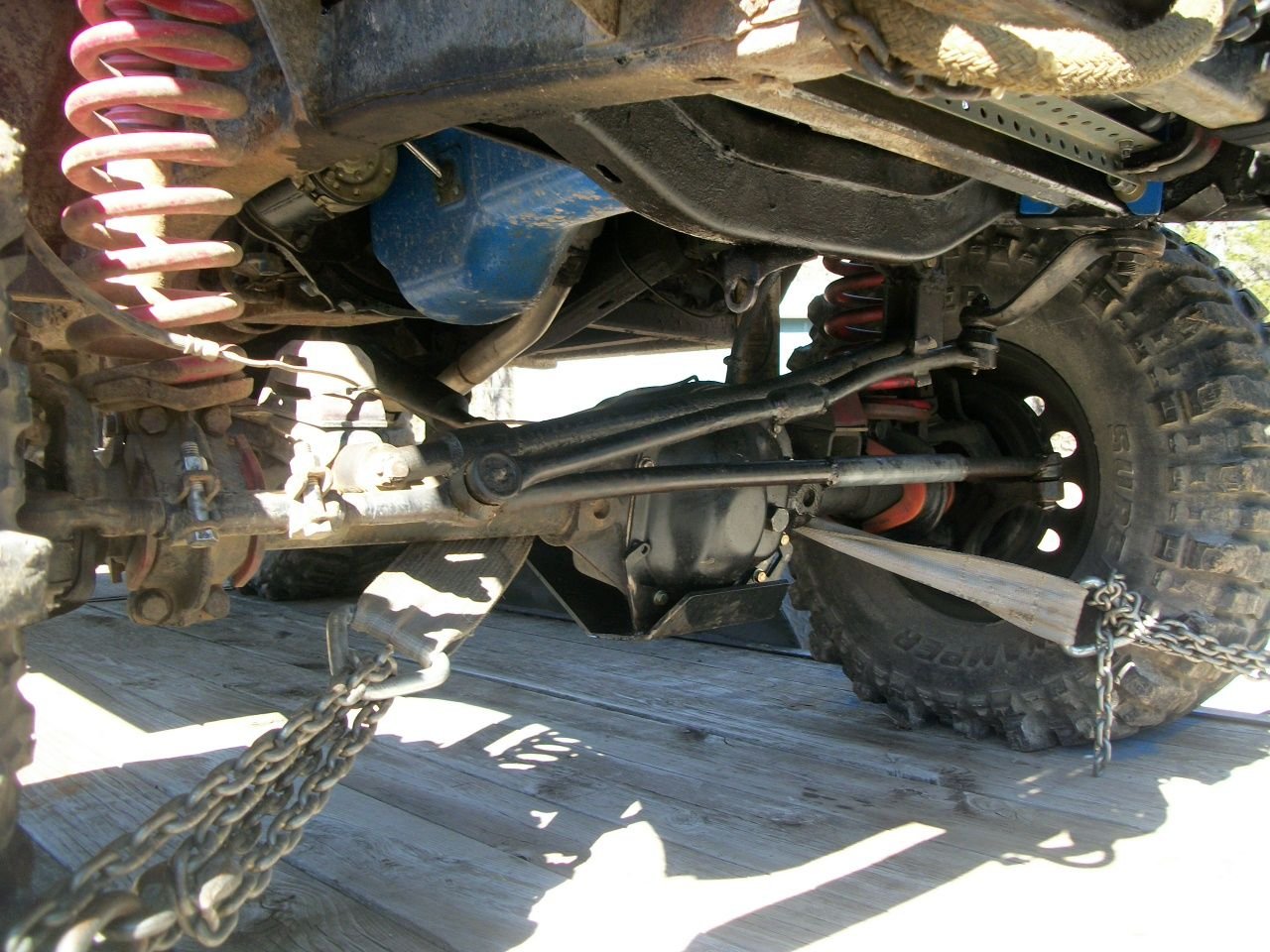

Some say the crossover and highsteer can help with some of the steering linkage (crazy angles you get with a giant lift) and make the steering geometry better. Mine was already done as far as the tie rod (on top of the knuckle mount) AKA TRO (tie rod over) aka tie rod flip. The PO built it from unknown (to me) tie rod ends and it only had one removable/replaceable tie rod end.
All the rest was welded, even pieces of pipe were used...worked well for a off road only rig, but all the ends are getting worn, so I decided to upgrade. I would not buy BPSS new, that is quite a bit of $ to me too. I got a smoking cheap deal on a complete USED Bullet Proof set up that came off a fullsize Bronco.
