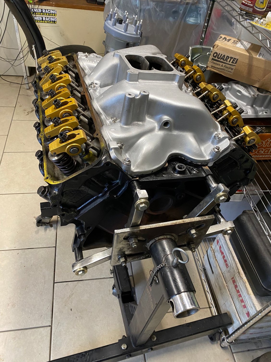

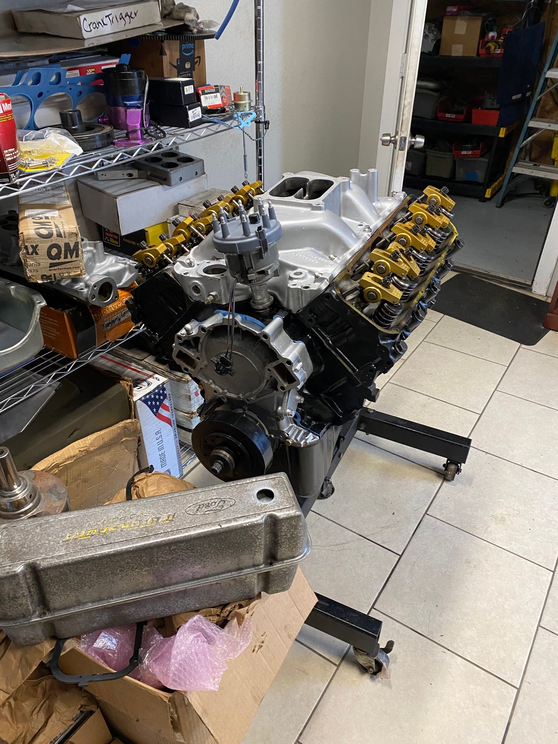

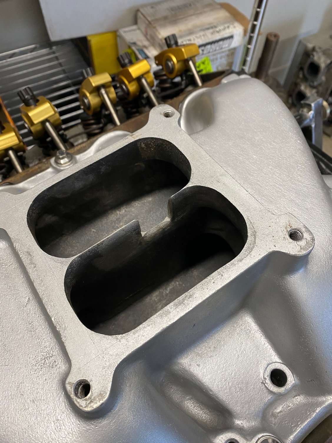

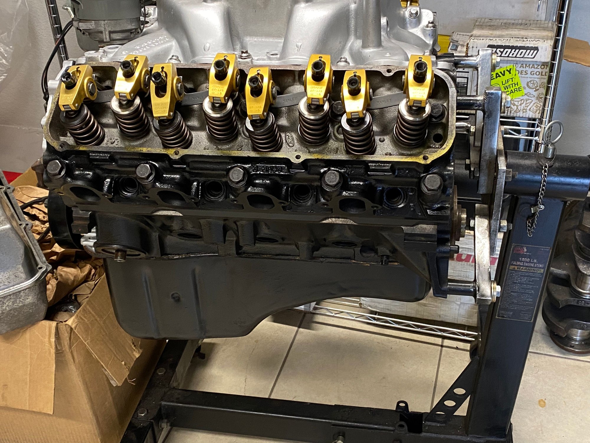

Hey, guys I found a good motor here in Houston. It’s a 466 (.30 over) with comp cam and roller rockers, dual plane high rise intake, 10.5:1 compression, Holley 750 DP (not in the pic), solid lifters.
The builder said it’s good for 550-600hp. I have a dyno scheduled for next week, we are going to see what it can do.

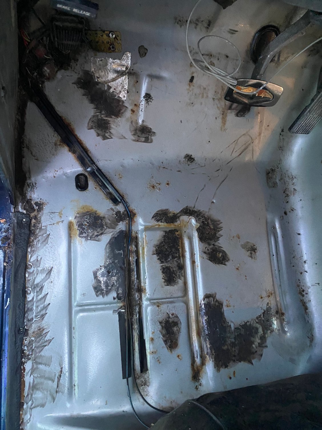

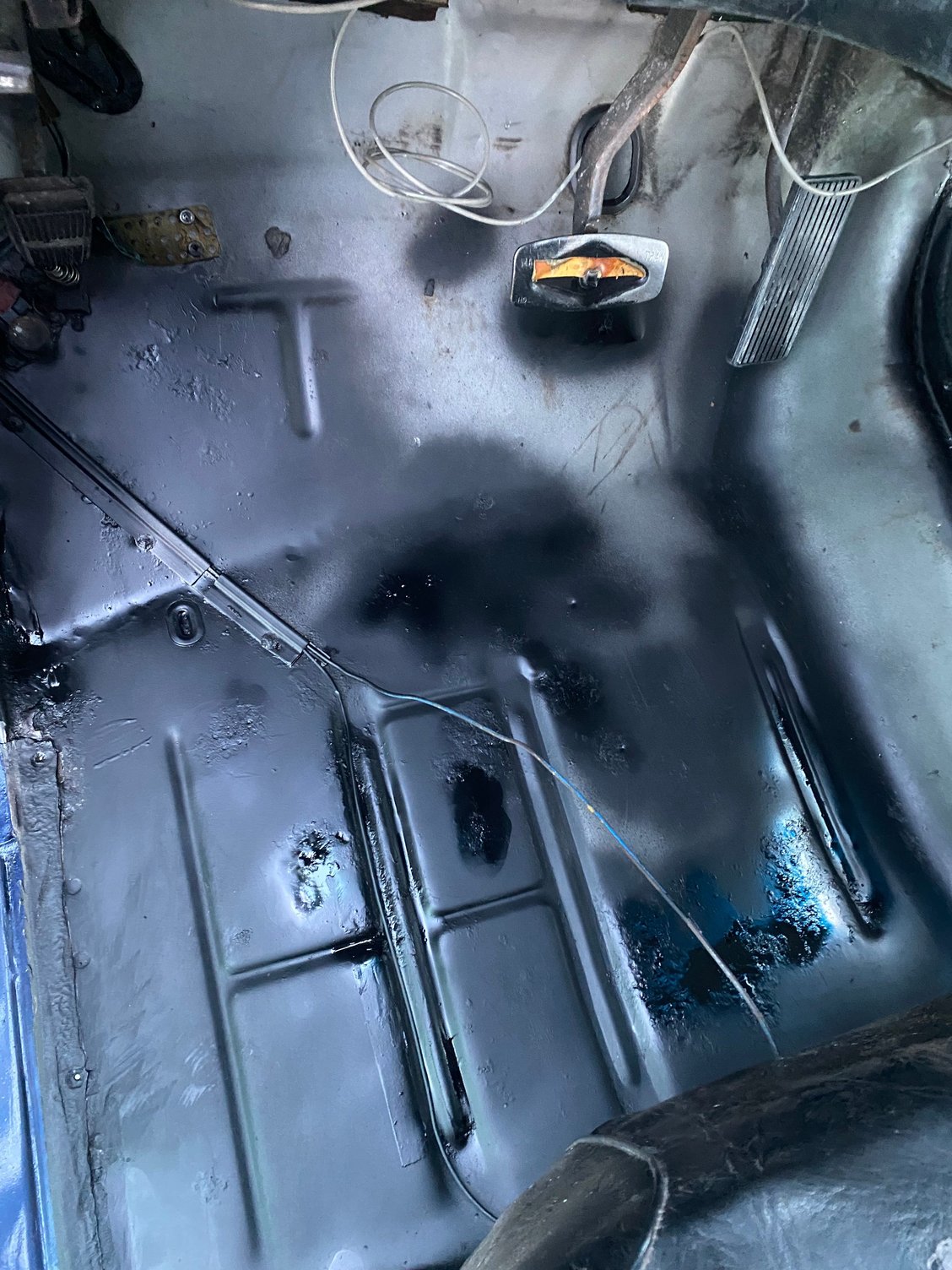

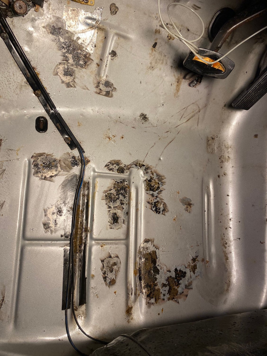

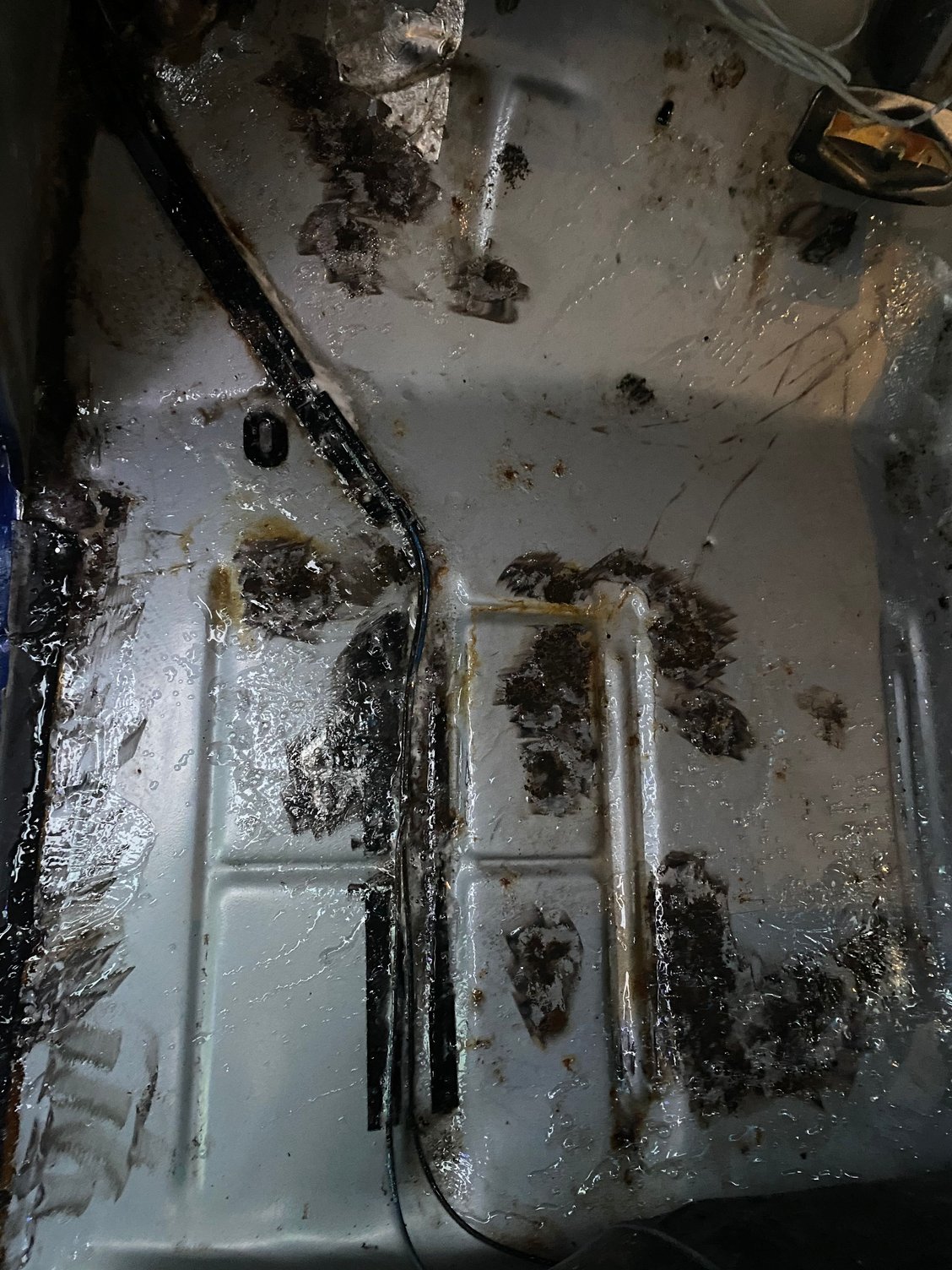

Going to start cleaning up my floorboards. Here are some pics. They are pretty good to start with just had some rust spots, so I flap brushed the spots down then treated the rust and painted with a rust converter paint.

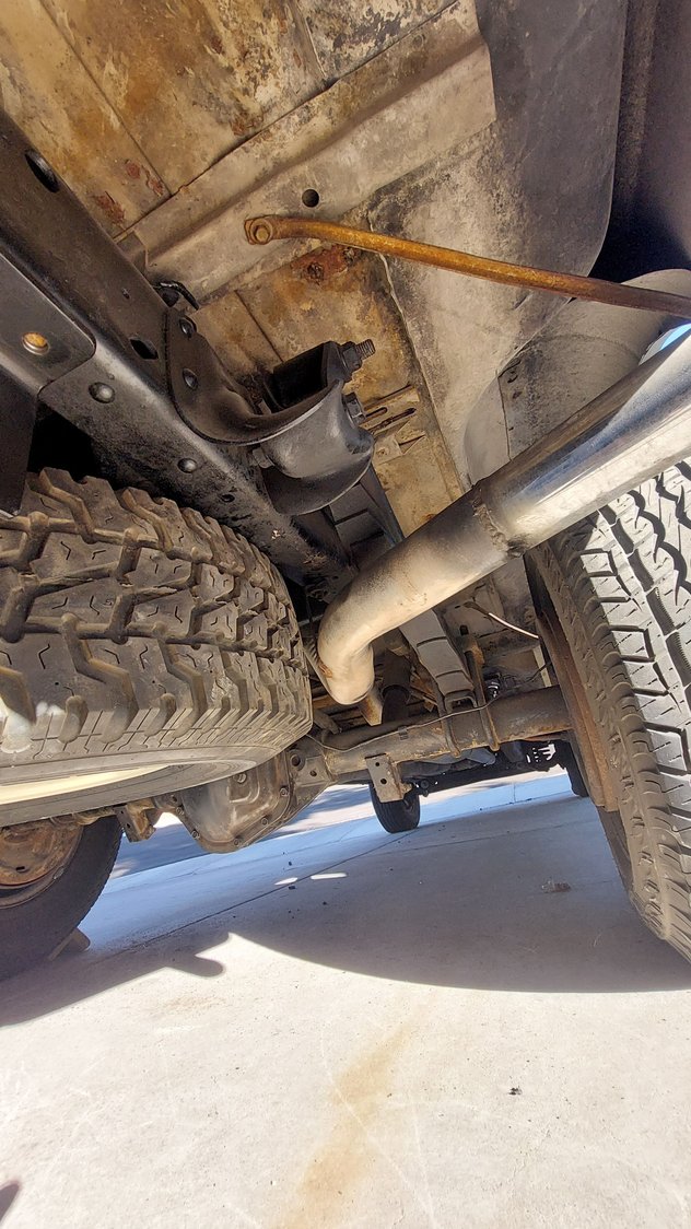

So I ordered a rim from B&R Auto Wrecking, and it was about 35 bucks I think. They had to ship it from Reno to Vegas, to their sister yard here I guess. Anyway, the guy told me that it was a rim only, even though there was a tire on it in the picture. I said fine, as it was only listed as a rim. Well, yesterday I ran over there to pick it up, and damn if it didn't have an almost new tire on it! Made my friggin day! I thought I was going to have to pay almost 200 bucks for a tire to match my others.
It is about an inch taller than the others, but for now, and seeing as how I didn't have a spare before, It will have to do. I had to paint it match the other wheels, and then tested my winch assembly that I built a couple weeks ago, and it works great!
The exhaust is about an inch closer than I had figured, obviously due to the larger tire, but I am going to either build a sheet metal heat shield, or wrap the exhaust pipe right there with the heat tape, or both.
Need to drill another hole in the hitch mount on both sides, and put a third bolt in each side of that.
Dang, it looks like it "wentintight" Goesintight. LoL
Did you get the pipe wrapped yet ?

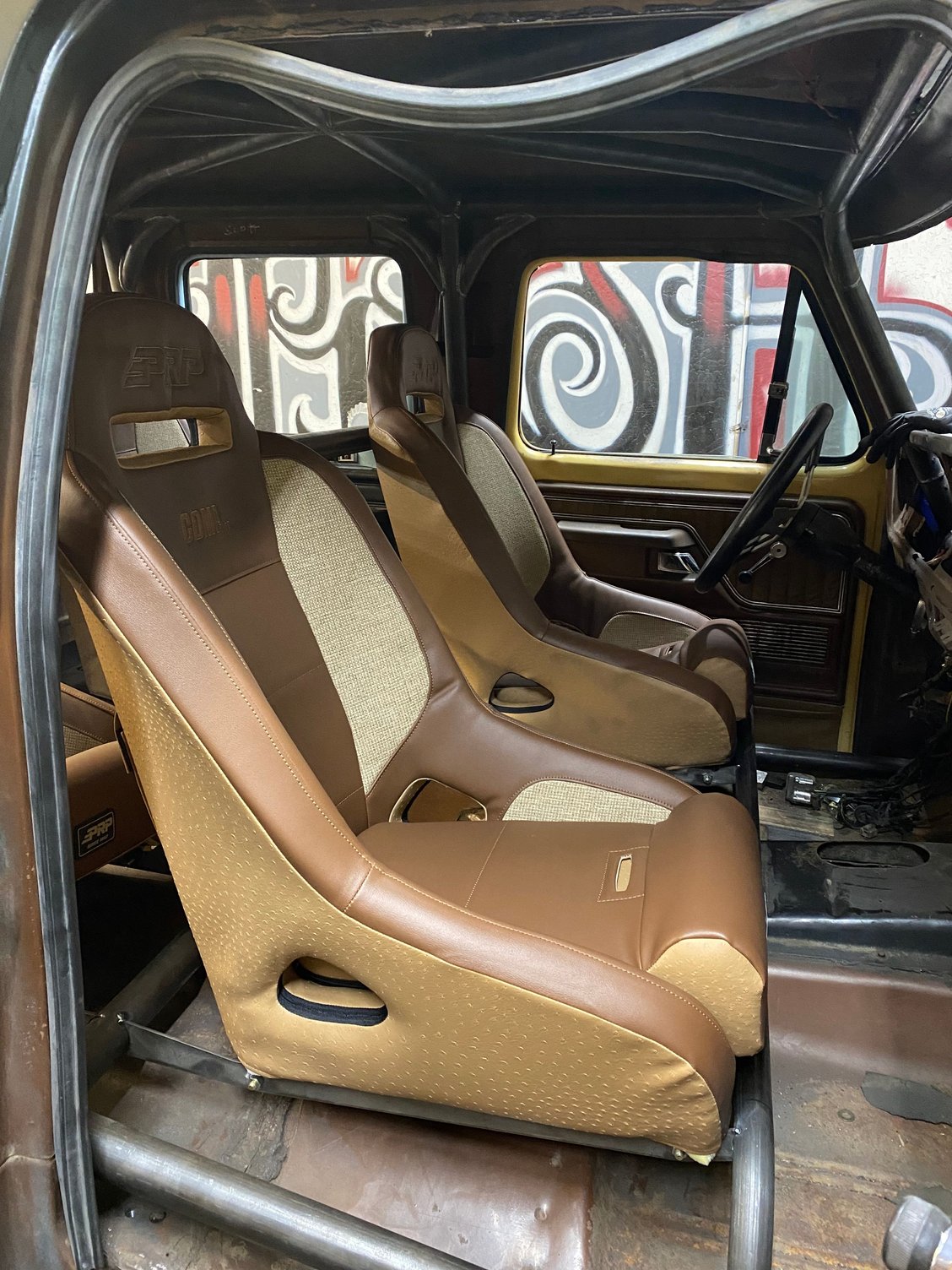

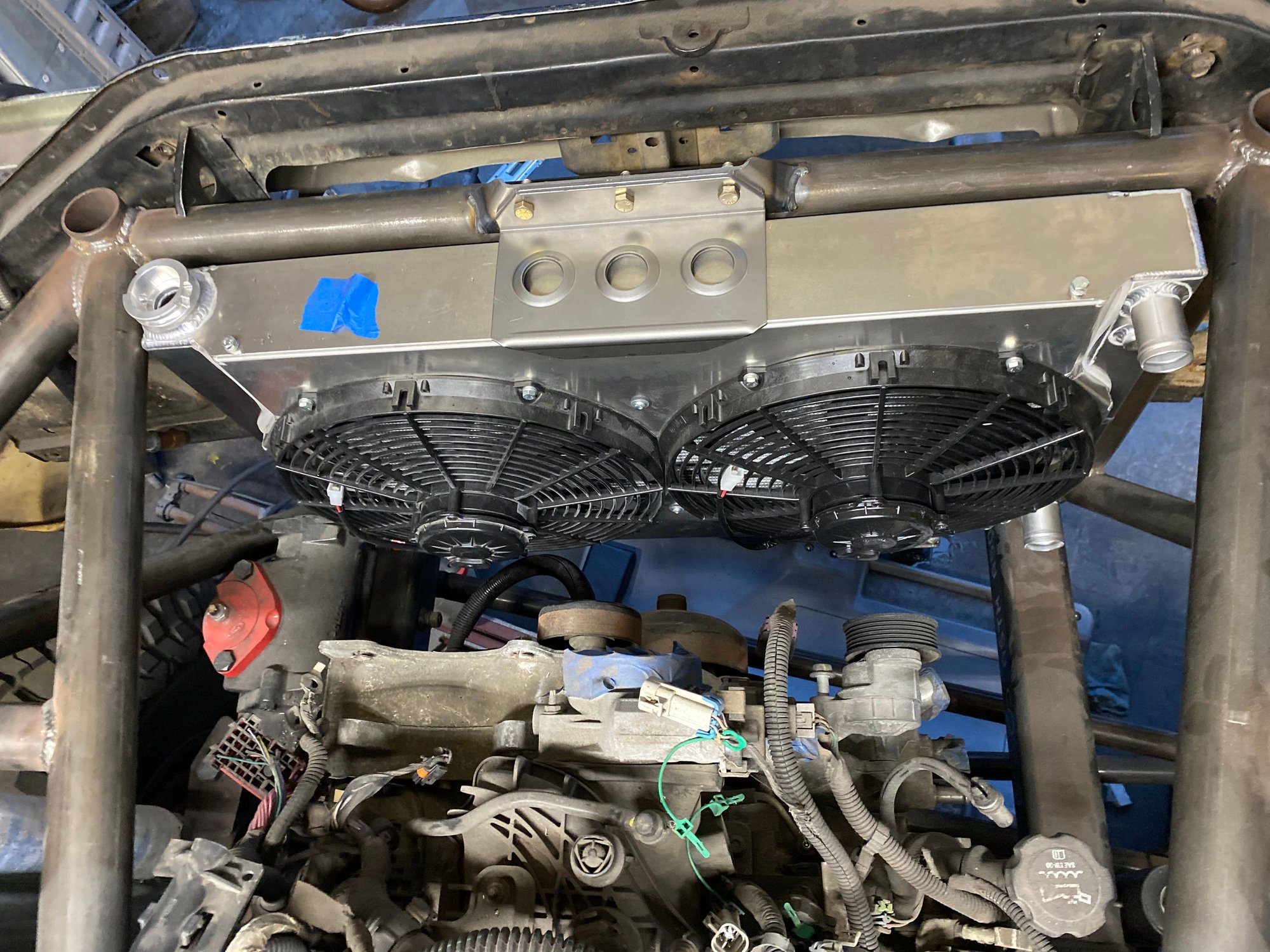

NVfab has made some more progress. Seats are mocked up, truck is sitting on its own weight and CBR radiator is mounted. Suspension cycles 14” front and 24” travel in the rear.they said they will be working on it some more this week so I am looking forward to more updates.

Manny this is a sick ride man! I love the pics

Manny - overbuilt is the best kind of built - very nice!
Really dig the seats!
