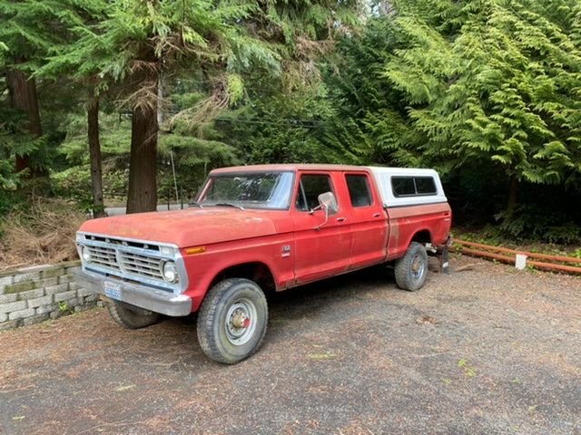

About ready to get to work on this one. I imagine it’s easier to repair the rear doors than replace them? I know I need to be on the lookout for roof rot so I’ll clean up the inside cavity and spray with fluid film or something similar.

Rear doors are not reproduced so unless you already know where you can get a set in good condition for a good price you're likely better off repairing them.

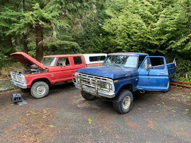

Haha you got me, I’m off Mile Hill. Well at least the trucks are. I’m actually in Bremerton right now but I’m hoping to buy a house in the next year or two somewhere in Port Orchard. What area are you from?
Another crew pic to keep it relevant

So when I had mine sanded down, it seemed pretty obvious to me that the rear doors are fabricated from front doors. So based on the welds, it looked like they took a front door, cut it down to size, and then took the back window rail from another front door, and boxed in the front side of the back doors. I would imagine that any part could be cut out of a normal front door to piece in the back sections.

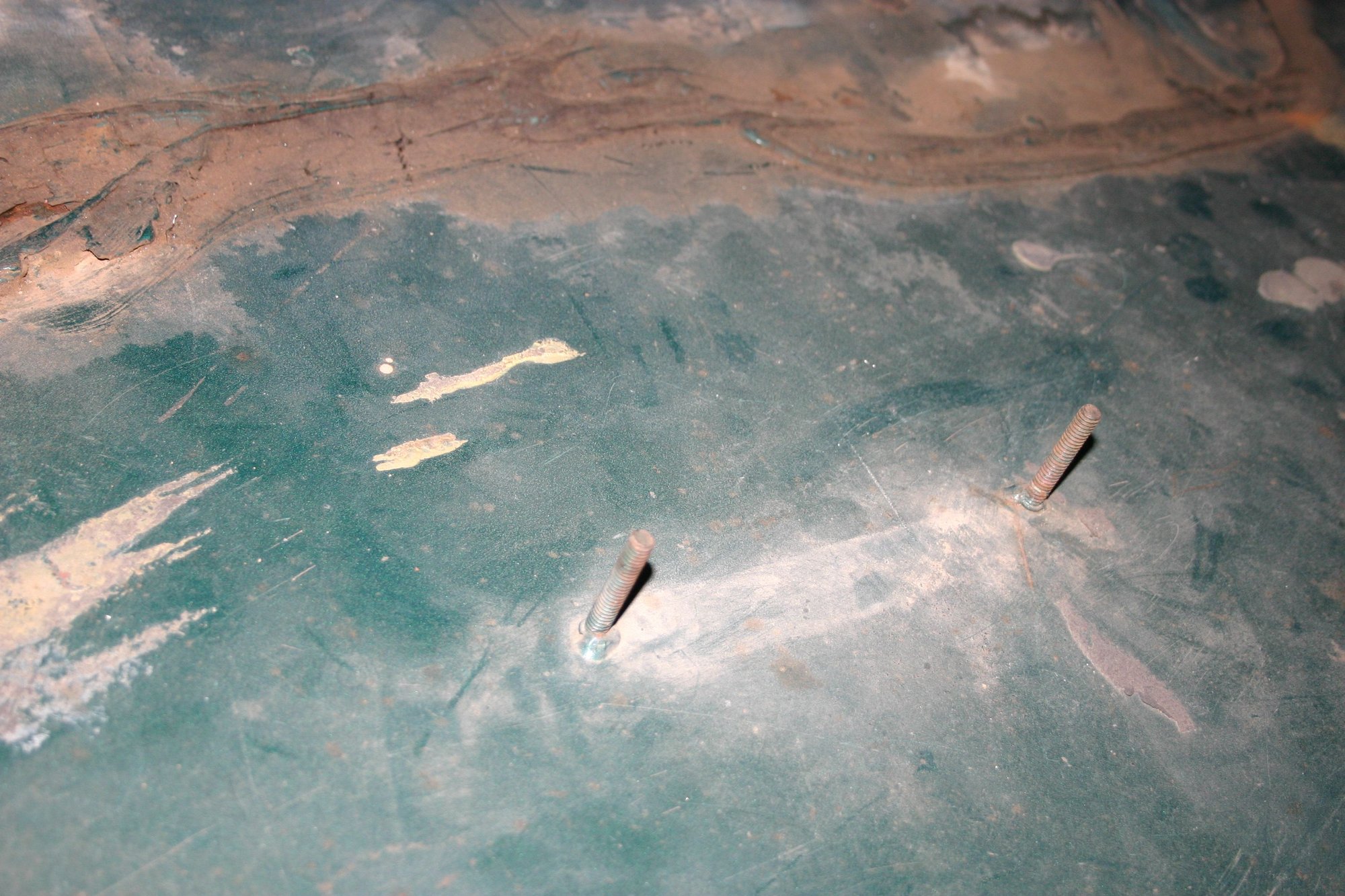

Mystery studs
Does anyone know what the heck the two studs that are welded to the floor, underneath the middle of the rear seat in a 78 crew are for? It's not for seatbelts or anything, I thought maybe a jack, but there is already a jack in the engine compartment. I know it's factory because I have seen the same studs in pics of other people's crews...
Old Apr 6, 2021 | 08:57 AM
  #3674
Flabmobile's Avatar
Flabmobile
Joined: Dec 2020
Posts: 148
Likes: 143
That is where the two-piece lug wrench is secured. It is a straight rod about 5/8-inch diameter and 18-inches long. The other piece is a lug socket with rod that had a hole for turning. There should be two clamps with wing nuts to hold everything down. If you really want to see how it goes, I can snap a photo of mine tonight and post it tomorrow.

I'm interested in seeing a picture of what you have. My crew cab has the studs but didn't have anything secured to them when I bought it.
