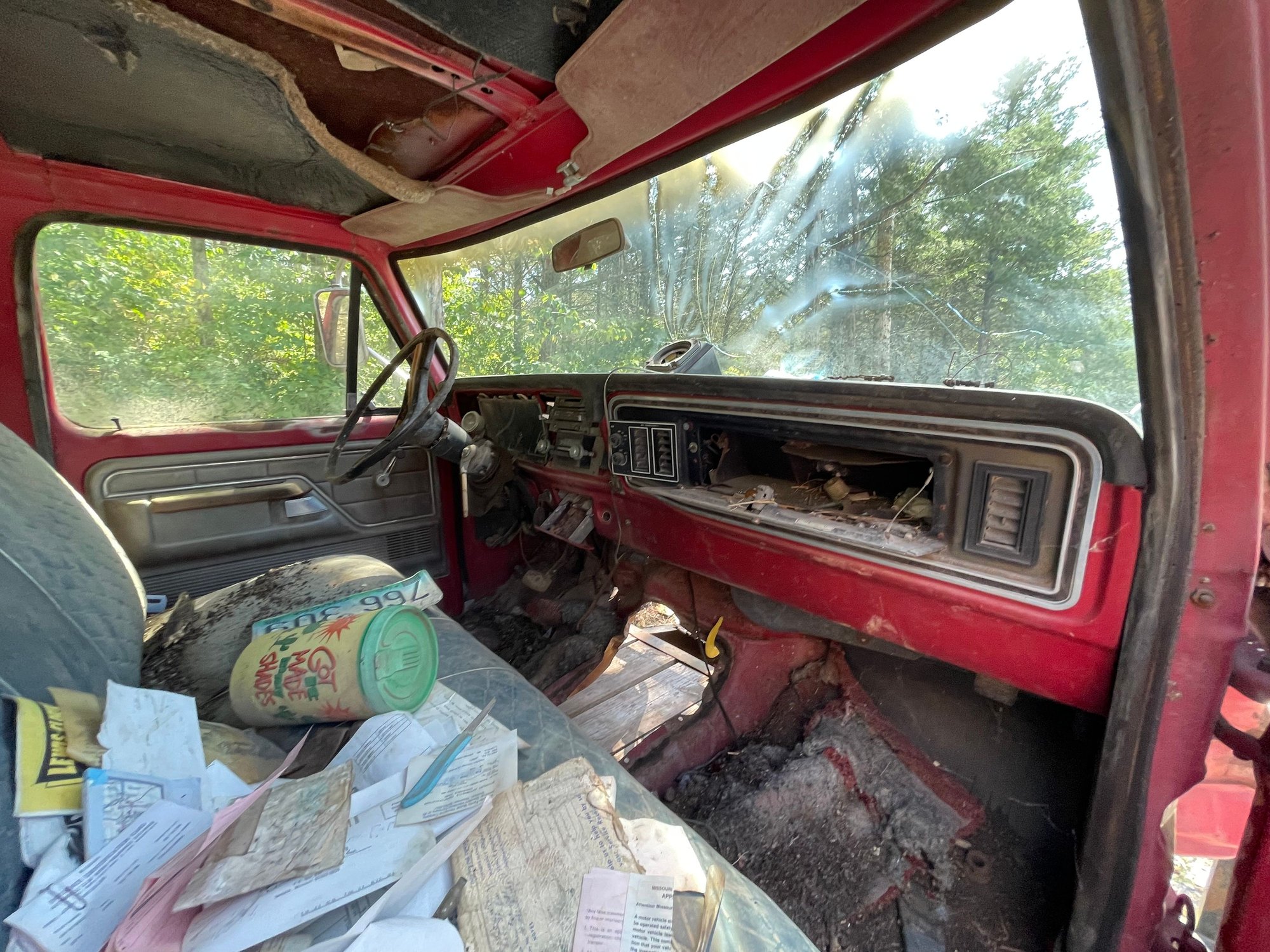

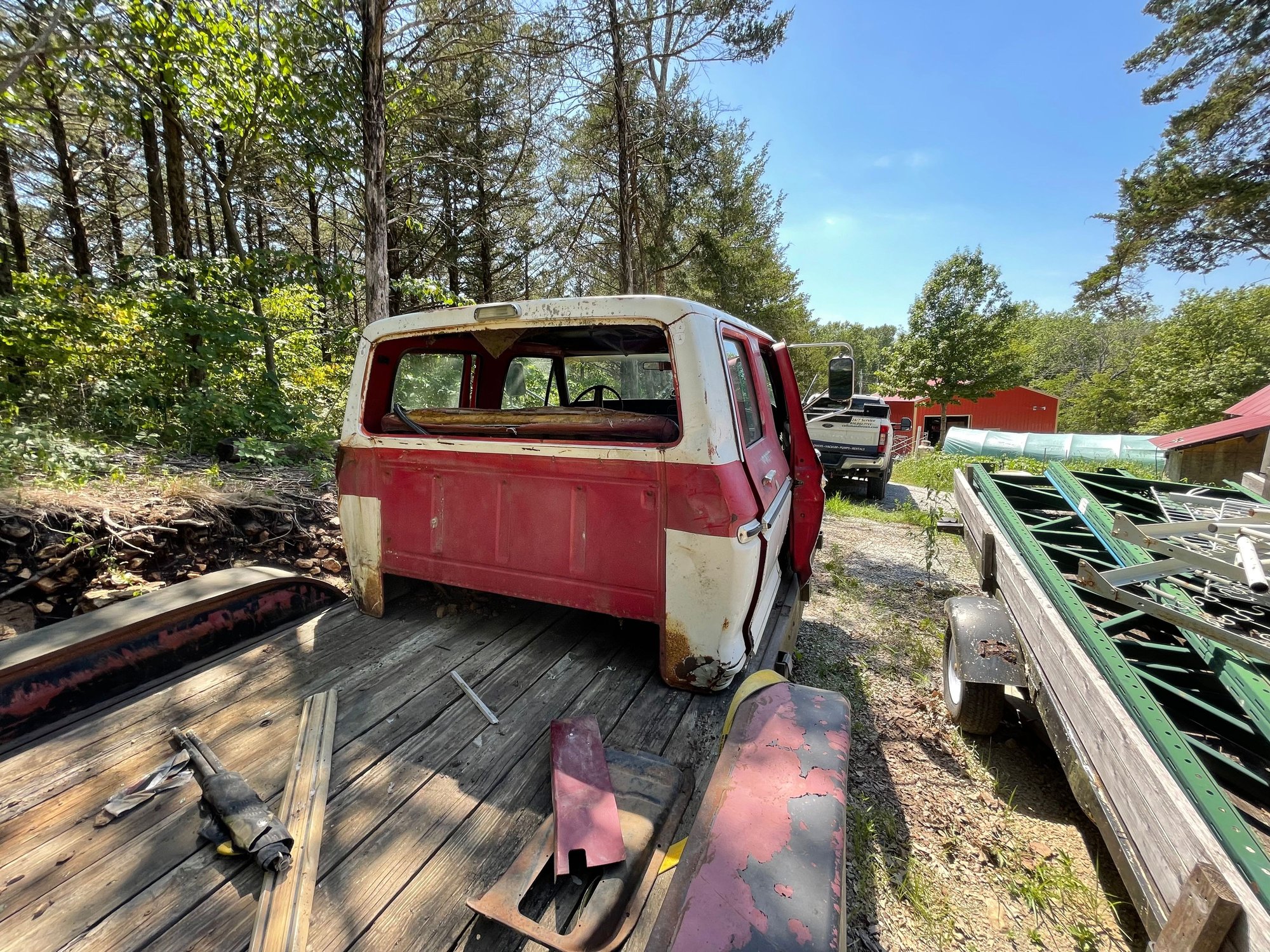

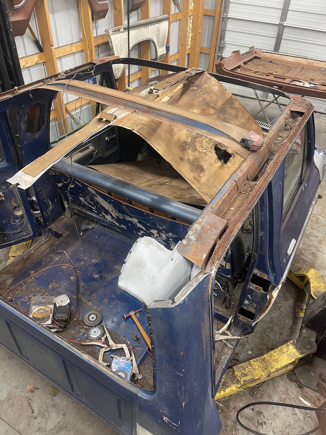

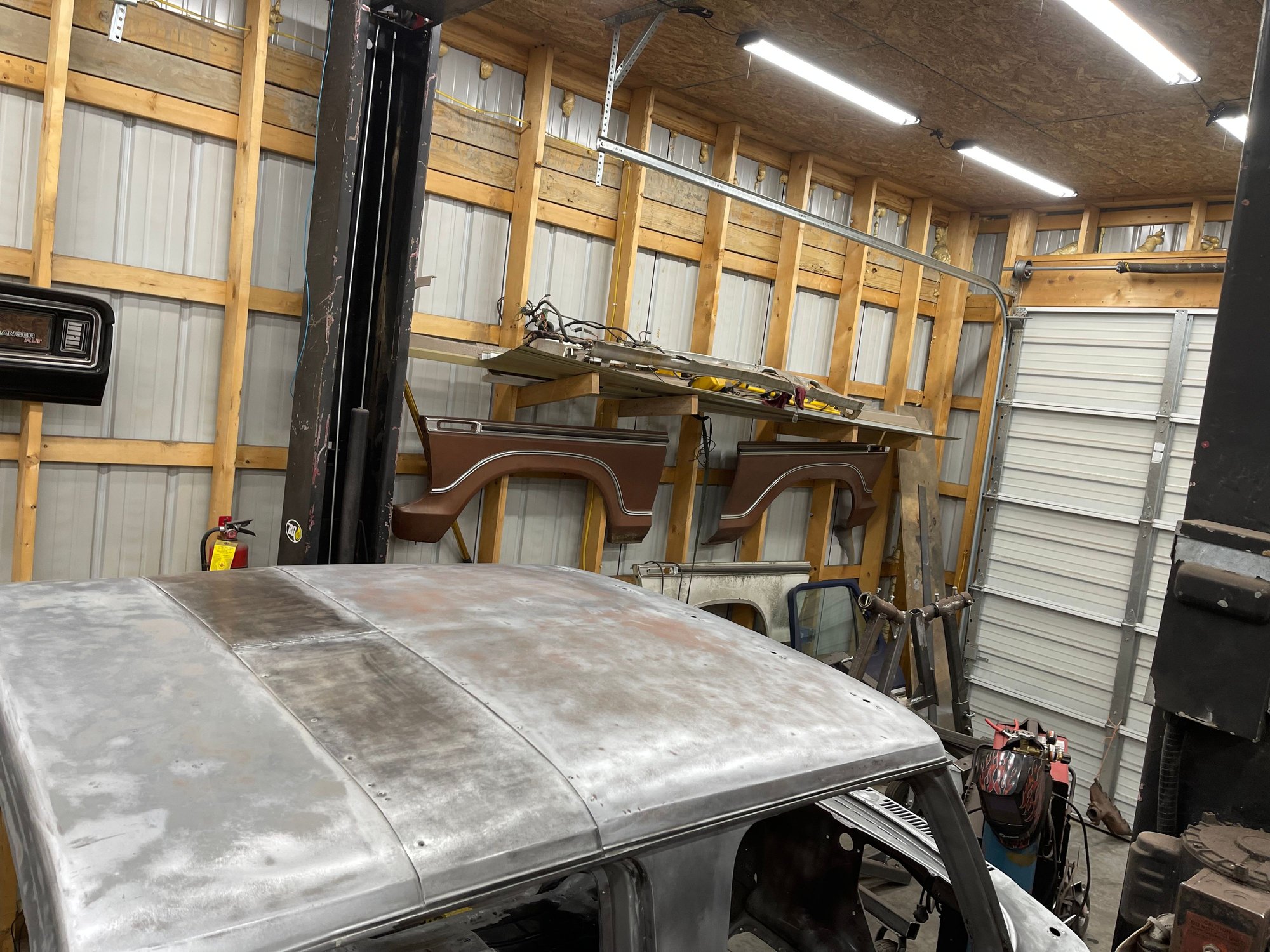

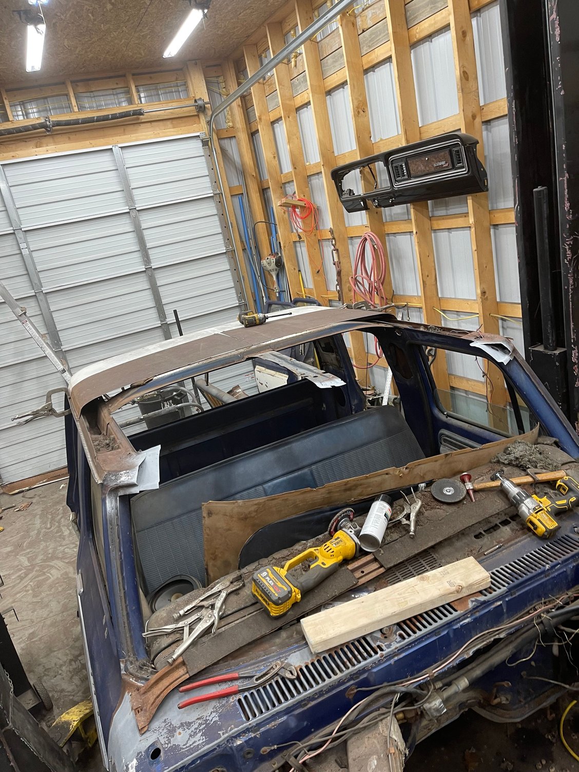

Anything is saveable.

That’s insane! Nice work. That’s really motivating for guys like me with pretty rusty cabs.

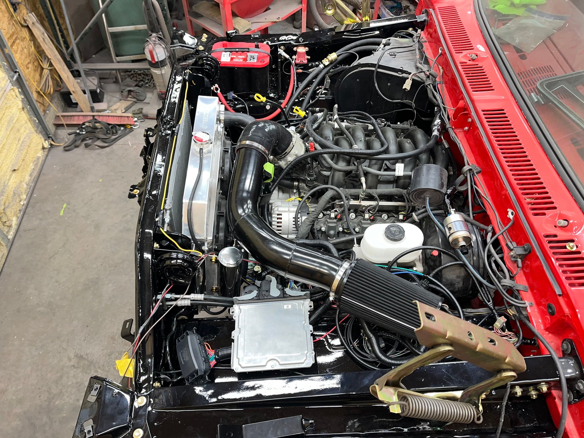

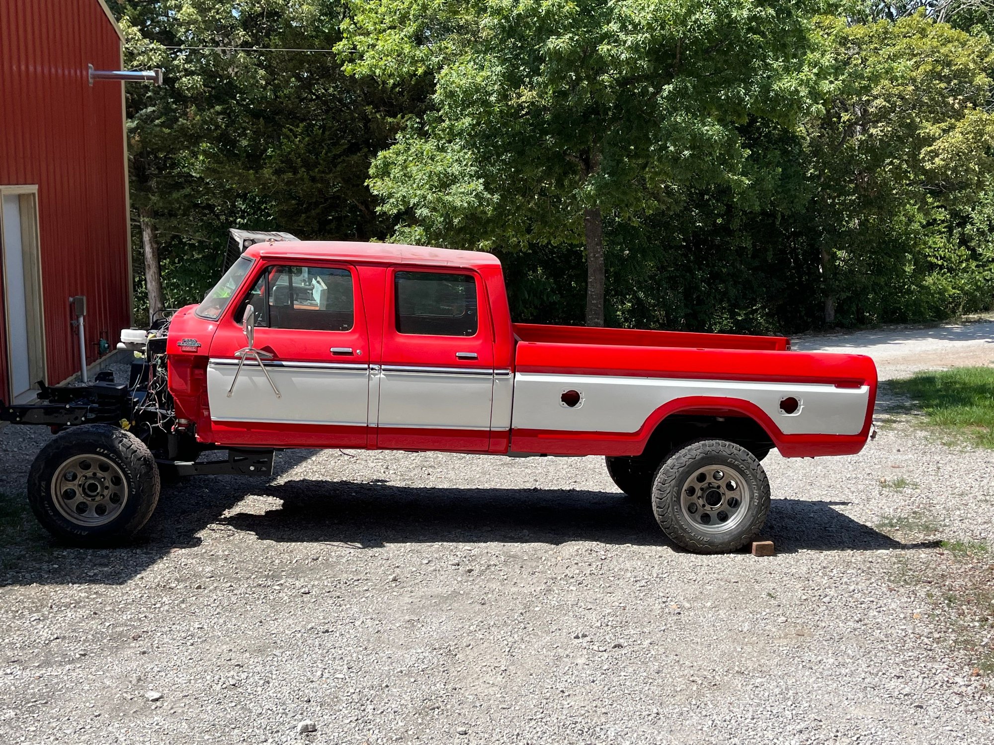

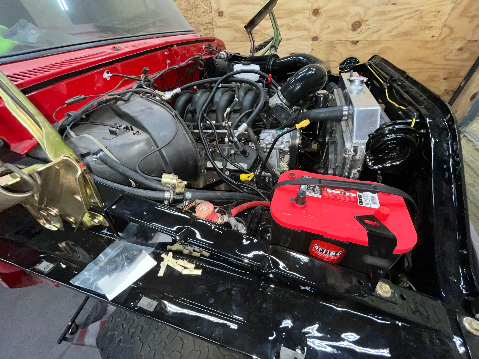

Still a work in progress. Finishing up the Godzilla installation currently. Should be ready to fire off in a week
or two.

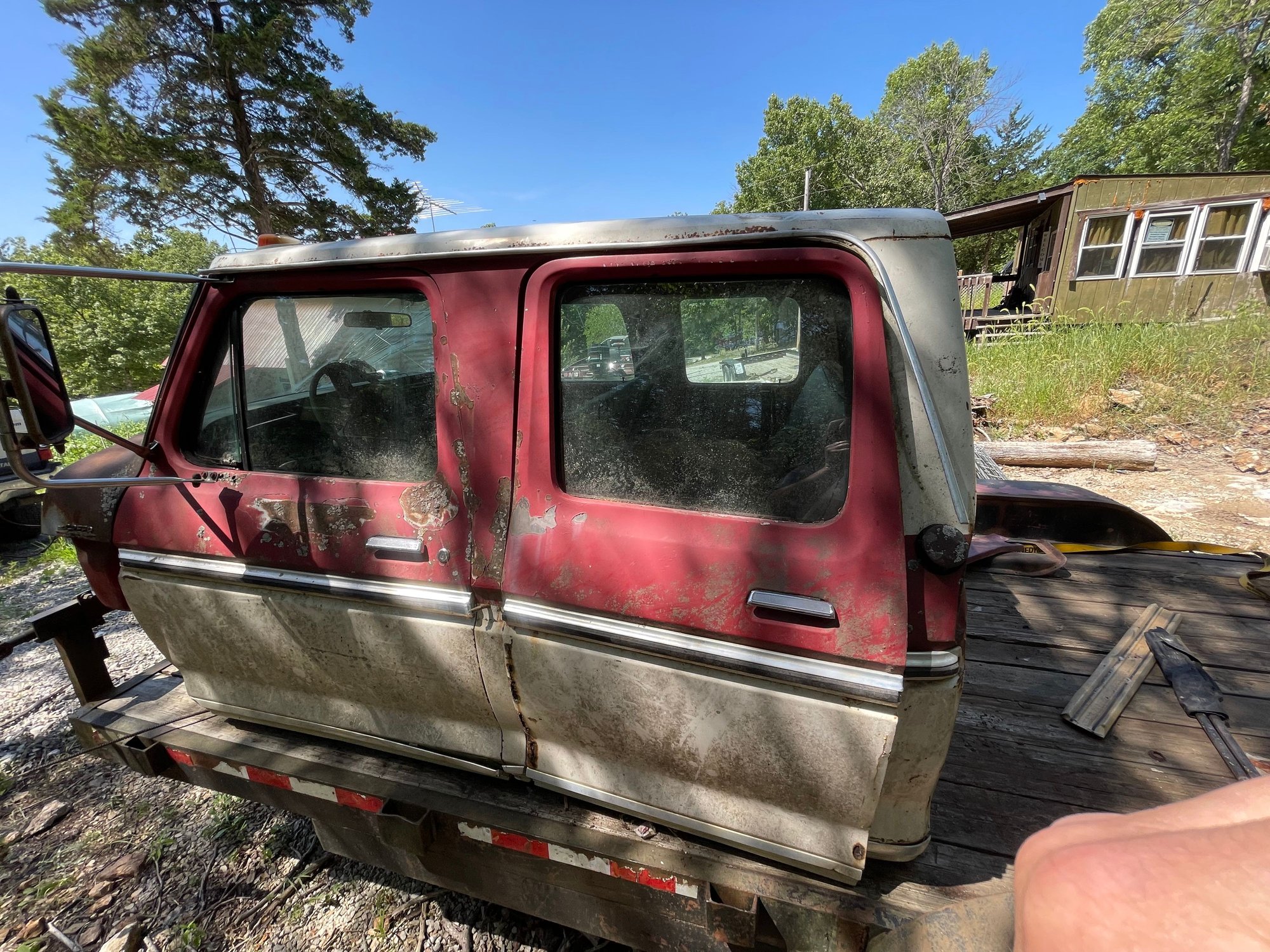

WTB 1977-79 Crewcab rear door lower racetrack
Still looking for one lower racetrack molding for a rear door. I do have an extra Crewcab cab that has the earlier trim on it both upper and lower that I am not using.
I need a nice rear door trim
for my build. Thanks.

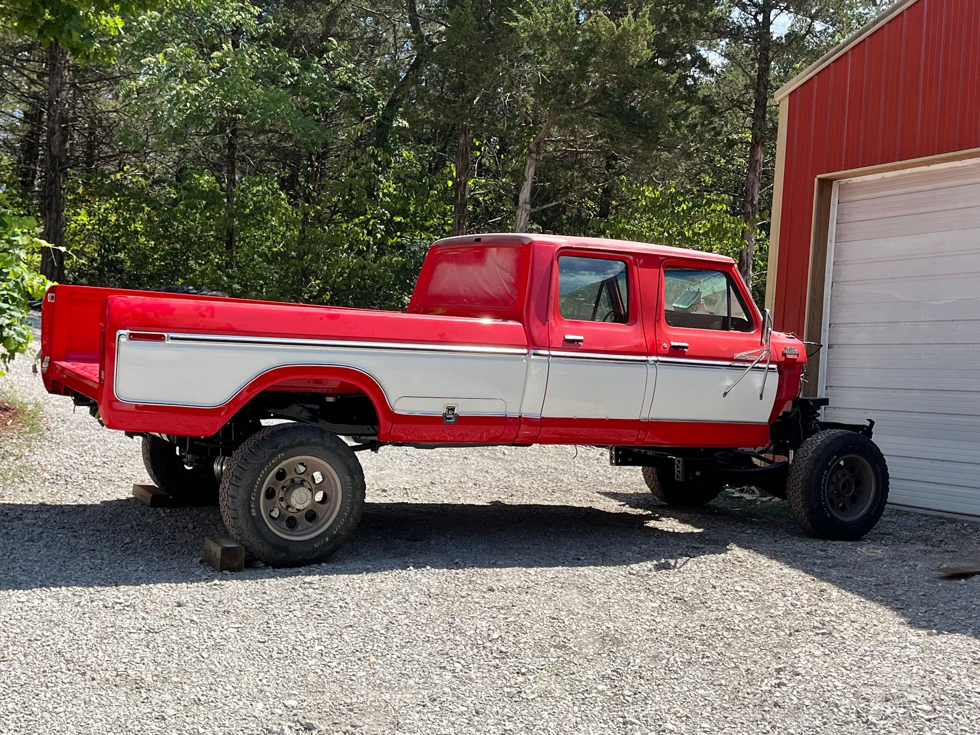

Now that the highboy crew is really coming along, excited to sink my teeth into the 74 2wd!

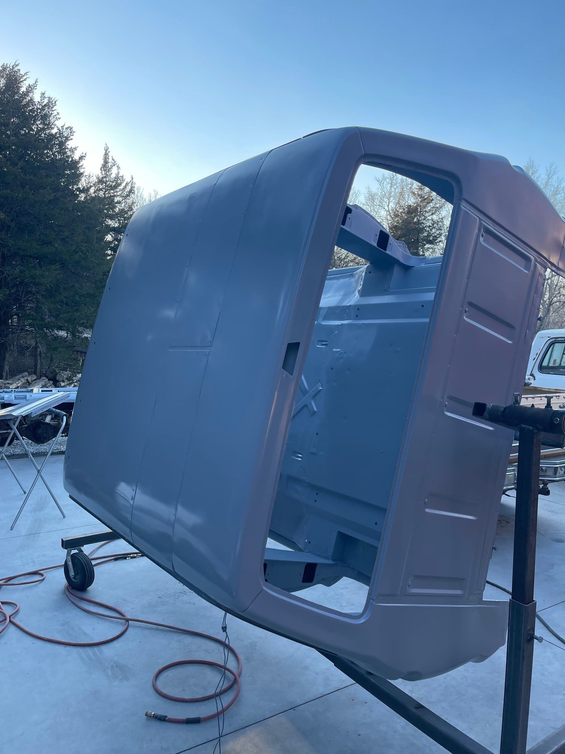

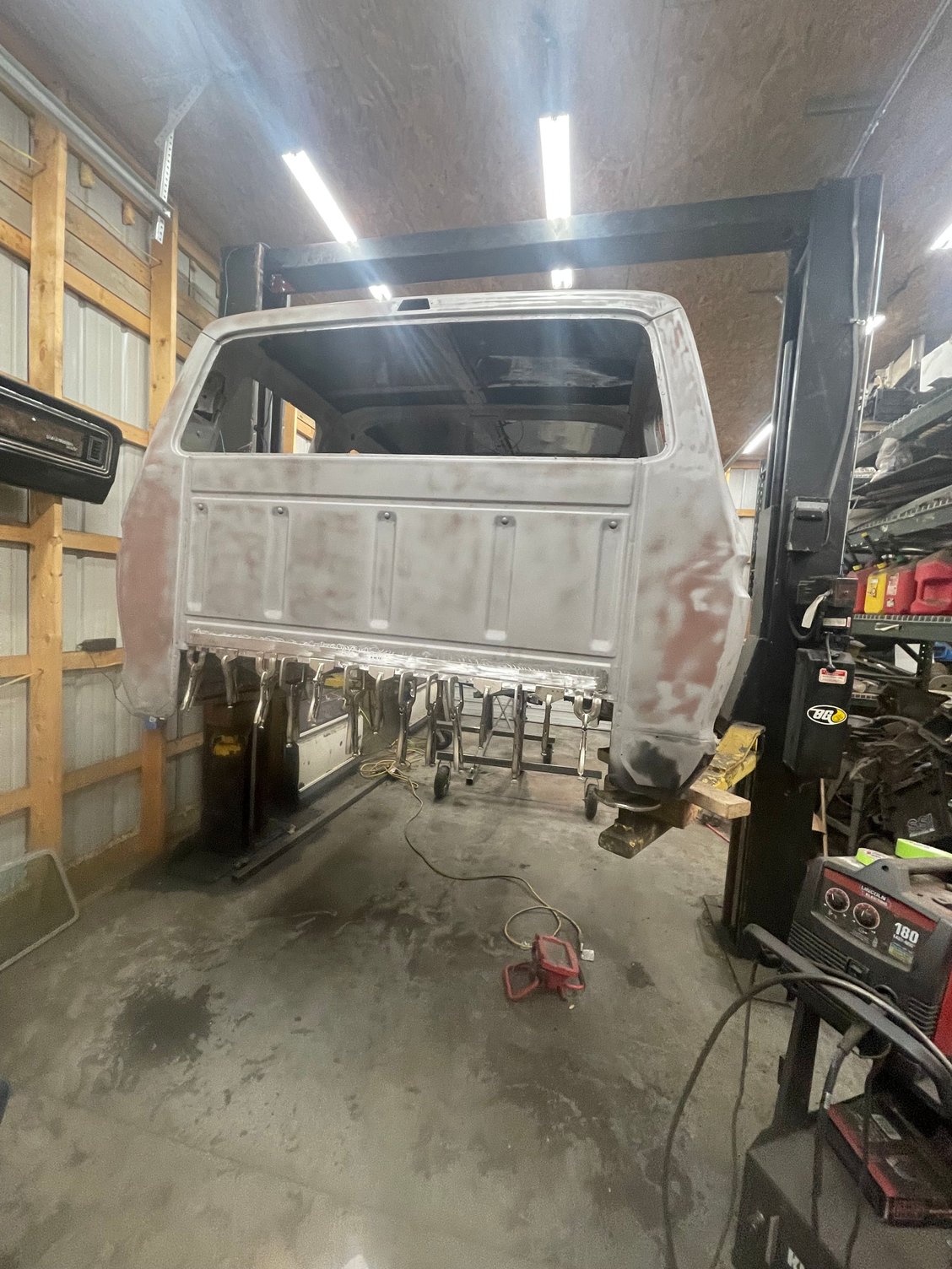

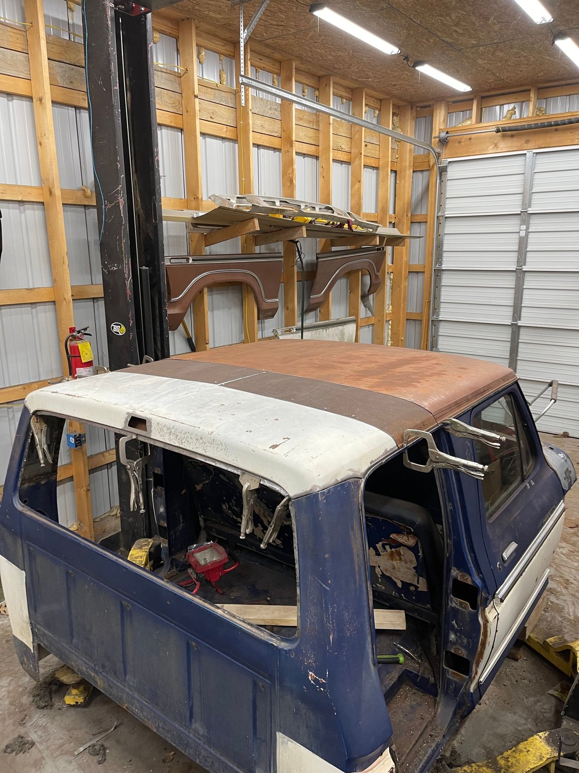

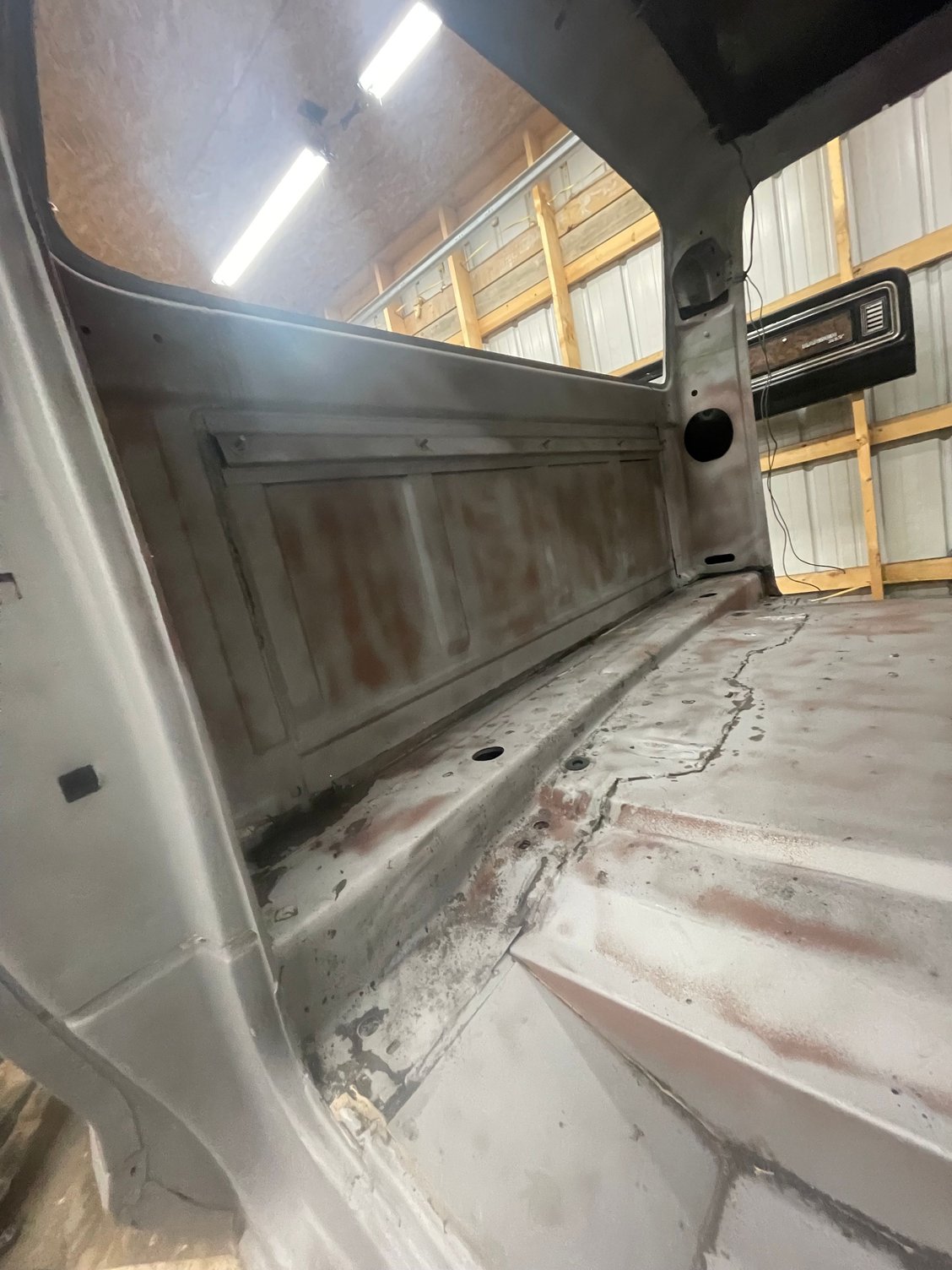

My brain is now Overdosed with the Cab refurbishing that @dbeers02 so masterfully performed.
Those photos are priceless for us member's to refer to while dissecting panels for Cab Preservation.
One Note: way back when I was building a Wood-Cutting CrewCab, there was a big idea that I wish I had followed thru with:
the roof panels really can use additional cross supports.
Back when I was jacking the roof back in place and pushing the support back into proper position was when my first "thought" was to pull a few supports out of a Ford E-Series Van, and then modify to fit, and weld-in Two additional roof cross supports. I STILL WISH i WOULD HAVE.
Plus, also the supports give you something to attach the headliner base material to for good support.
​​​​@dbeers02 the roof panel pieces you used for donor, did you cut them out of stad cabs from the '73-79 year span of cabs ?
Also just curious of if you are using a mig machine with .026 ga wire ?

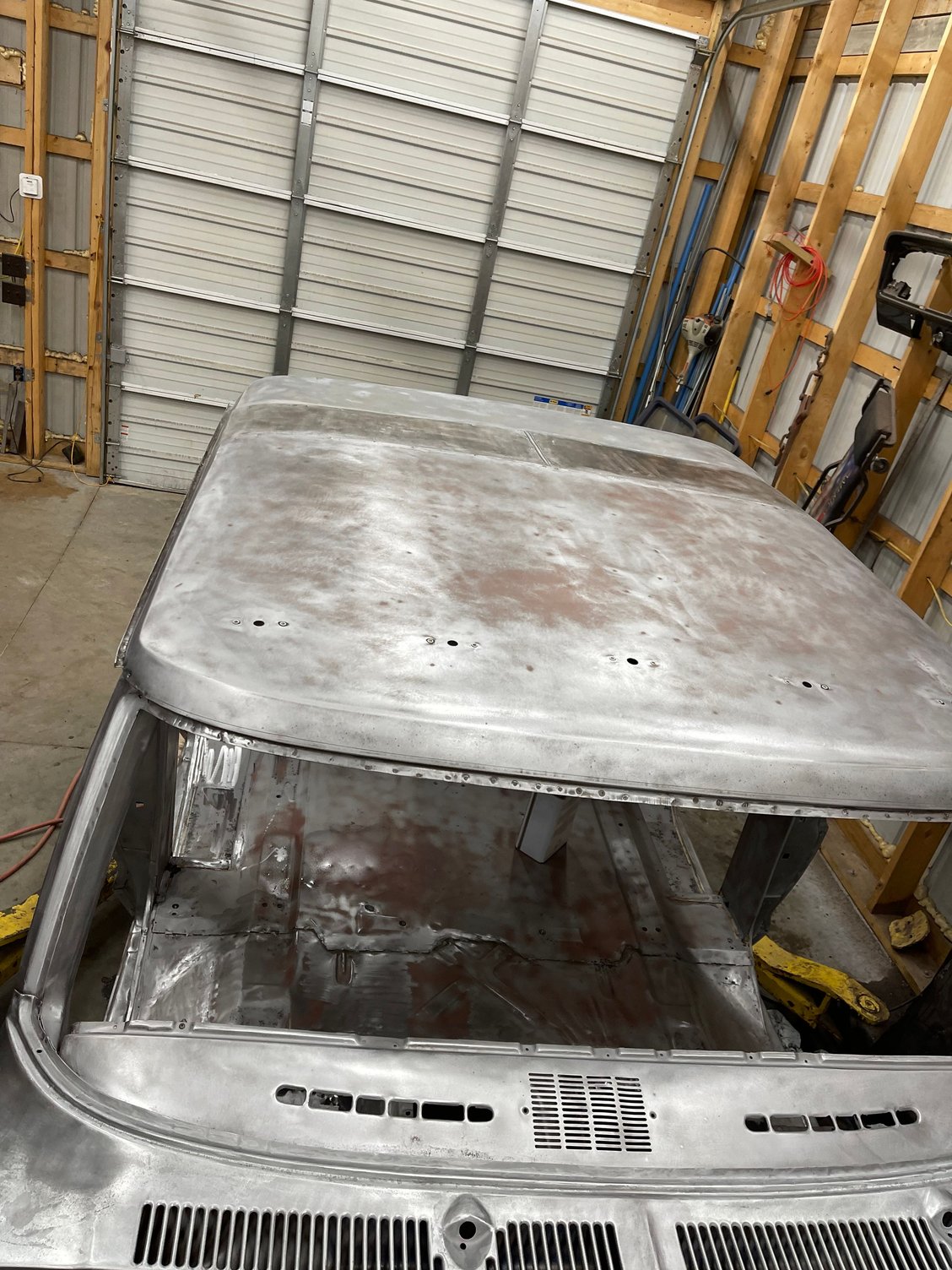

the front repair panel
is from a 1979 supercab that is trimmed down. The others are from standard cabs. I panel bonded the panels together and to the drip rail structure. Strong and water proof permanently water proof sealed clear through each panel and the problem area at the drip rail.
as far as rear doors, not many options. I rebuilt the lower 1/3 of each rear door inside and out. Took some time. They came out good. Welded top edge, panel bonded the door lip. Bond created a perfect seal so no water can get in the folded over skin lip so hopefully no further rust.

Dale,
Thank you very much for your thorough explanation of how you saved and reconstructed the roof.
By the way, when you said you used Panel-Bond for attaching roof panel pieces together, and for attaching the Roof-to-Drip-Rails.
A close friend who has worked his career in Auto-Body repair in a Ford dealership, cannot say enought Good about the benefits of Panel-Bond use.
