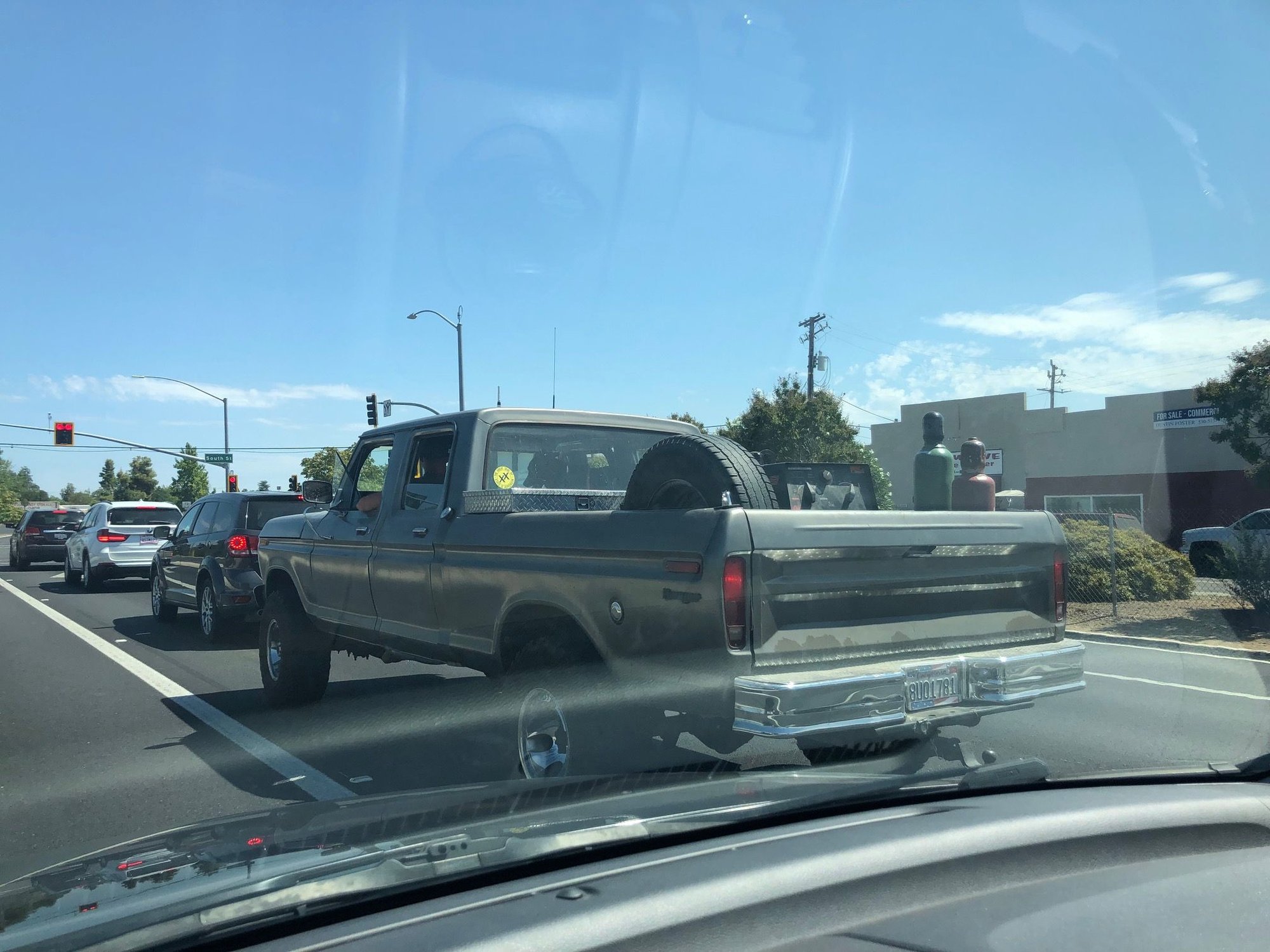

Someone bold needs to give that white Crew a new home and cut out the roof cancer.
above: yesterday's on-road Sighting in Anderson, California.
I pulled up beside the guy, a true American Red-Neck with a red Do-Rag !! hahahaha
He said it is a '73 _ _ _ and sounded good. Oh yeah, he was on the pipe and the engine sounded healthy.
('73 probably produced the 352 or 360 ? Someone like Orthman probably has the engine code table.
I looked at a nice standard cab '72 F-250 4x4 last month and found a table somewhere which told me the pickup was a California assembly with 4x (F256 vin) and engine code 390 !! kinda cool history.
I didn't buy it because of no paperwork, and DMV cannot divulge info of what kind of penalties are due against the vehicle. I still have a soft spot for the older iron with Divorced transfer cases.

you can research back fees on the DMV website just need the plate and vin.
I am sure it wasn’t a factory 390. Ford never had a 390 option for the 4x4.

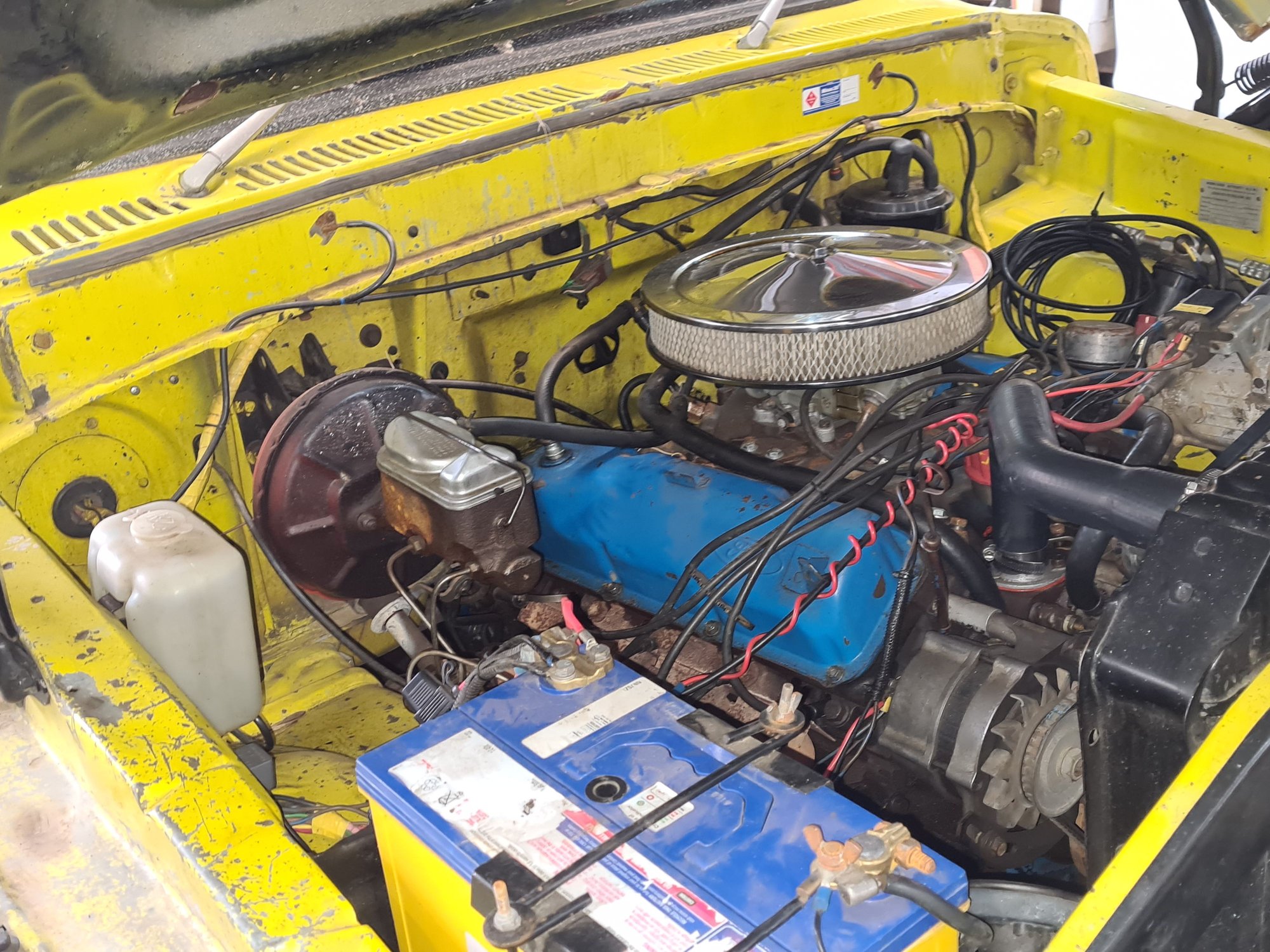

Super cool! Are those rear panels factory? I’ve taken the tears out of my truck because I put a lot of heavy hard stuff back there and don’t want to damage them. Factory or not, that looks really good. Would also love more pics of the dash and the engine bay.

Hi Larry,
We believe that this rig was coach built when new for the telephone company down here in Oz.
351C with C6.

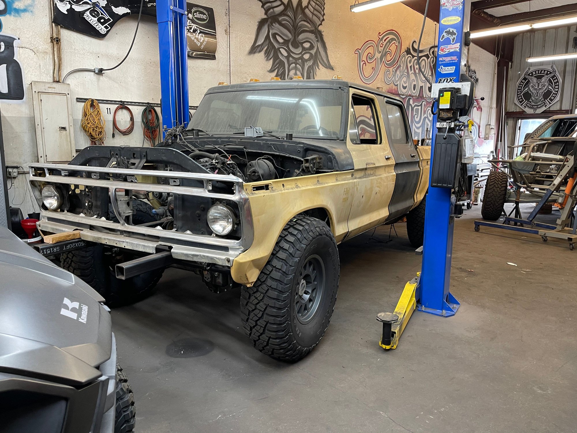

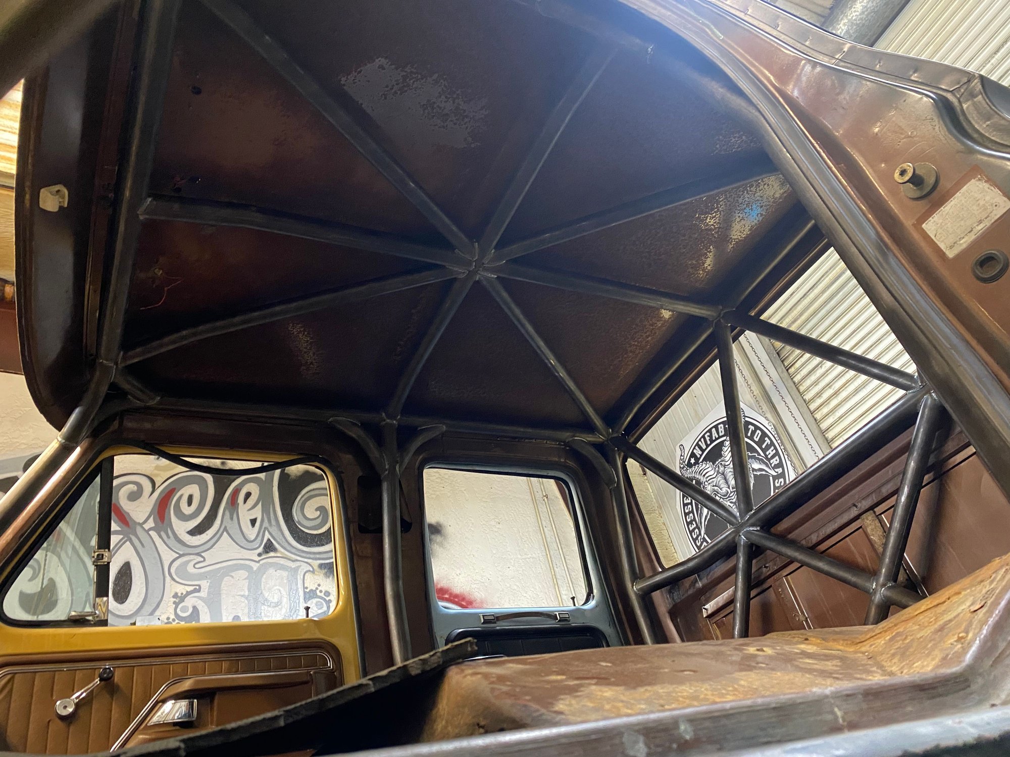

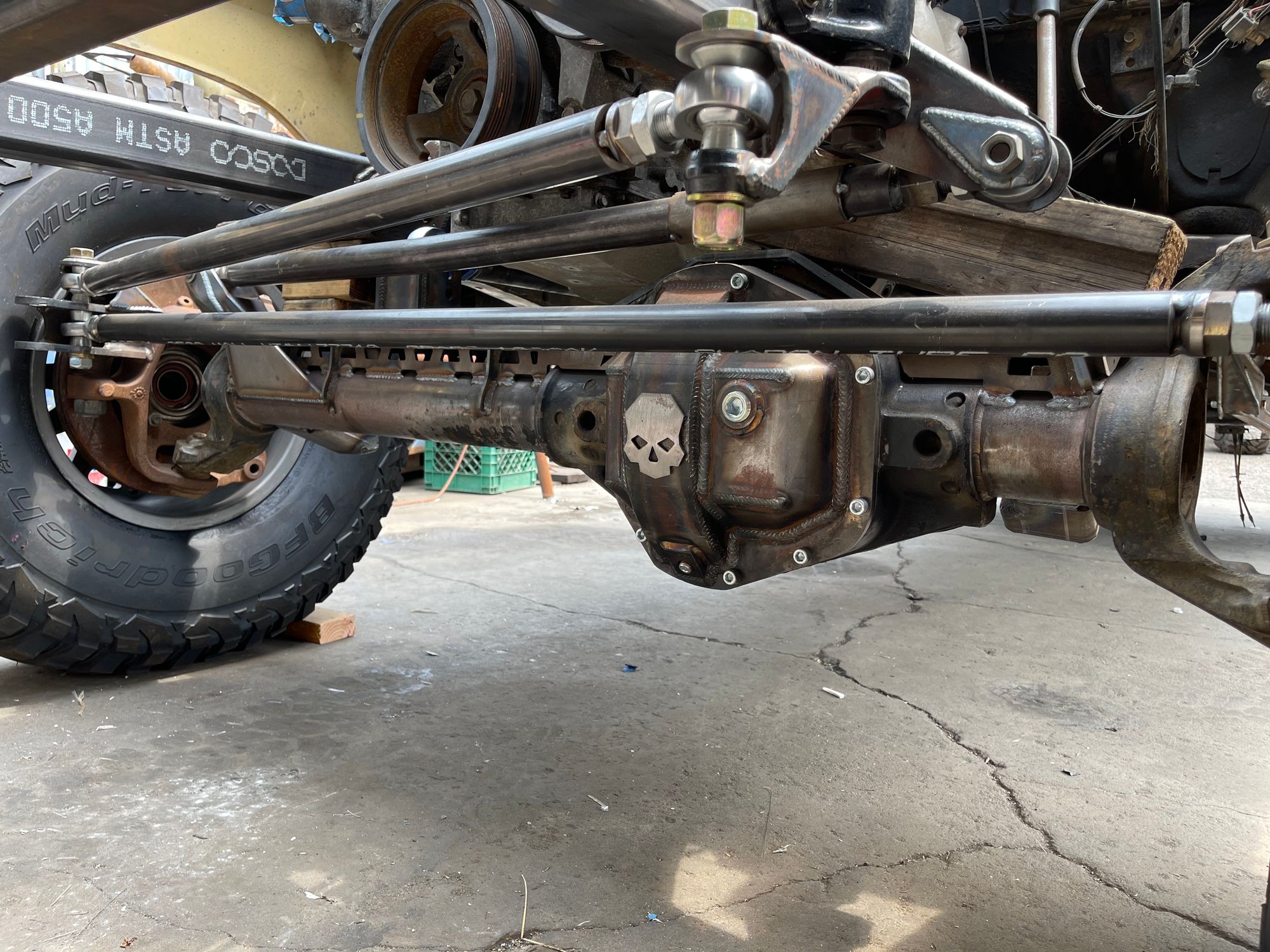

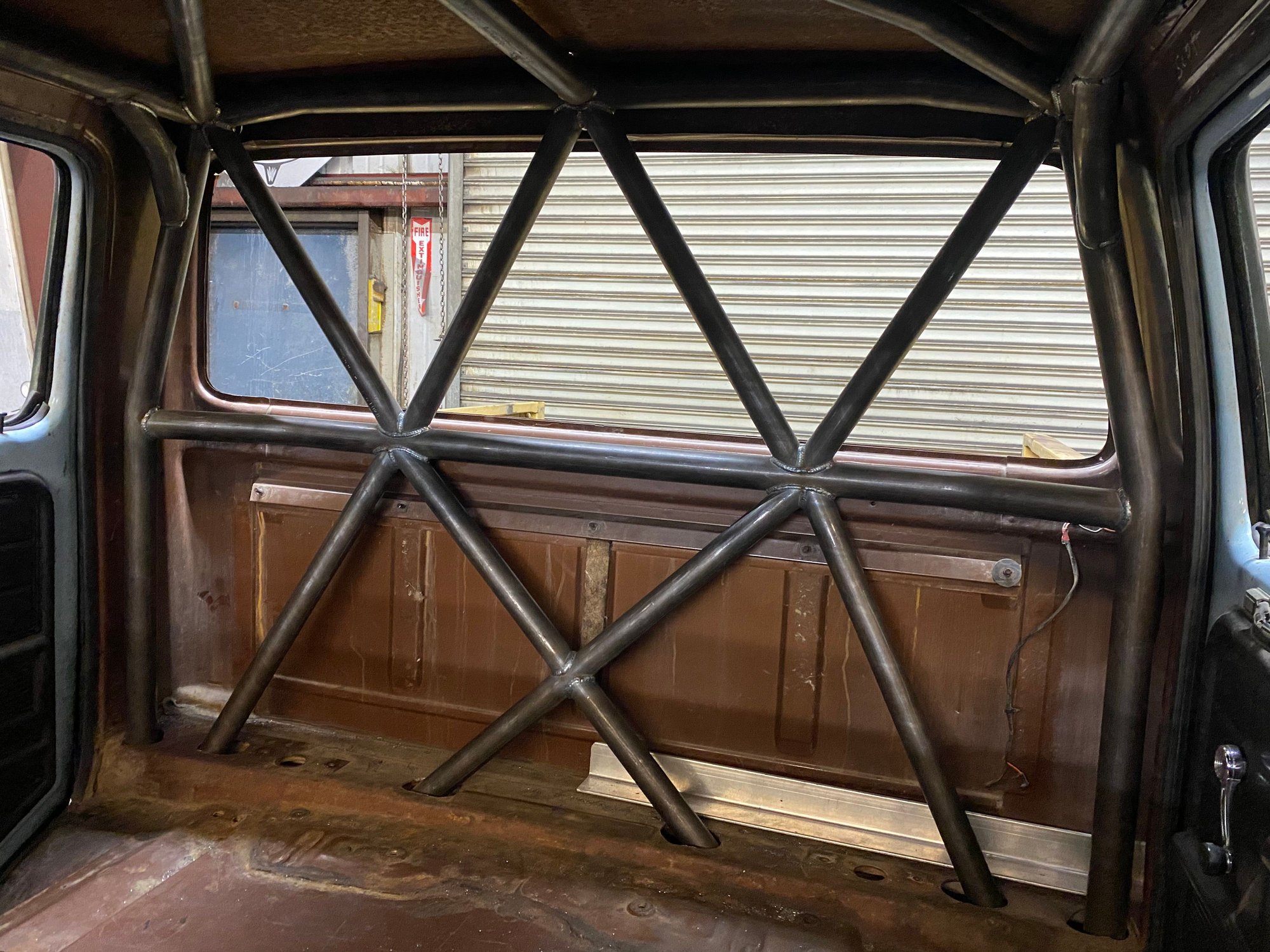

a little update on my truck build. I sent it to a fab shop to build it the way I want. As much as I enjoyed building it the finished product will be much nicer with a professional doing the work. Now it has a front 3link and a rear 4link, all four corners will have coil overs/ external bypass and hydraulic bump stops from king. I swapped out the 37” for 39” tires. Shaved the rear axle. Axle trusses front and rear, full cage front to rear. It will take a lot longer to finish but will be worth the wait.
