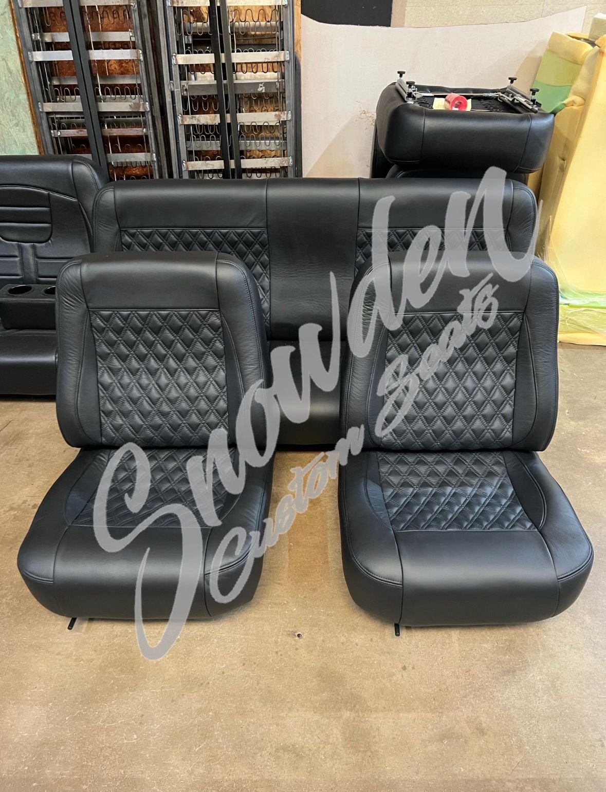

The day I bought and brought it home. About 24 years later. Rusted roof, no interior, supposed to run but currently only turns over. Cummins swap, super duty axles, snowden seats and a lot more coming up. Hopefully by next summer this truck will be back on the road!!
The new seats are on the way for this truck. Truck is at the body shop getting rust repair and roof repaint. Full superduty swap sitting in the garage on standby as well as a 97 cummins 5 speed 4x4 donor truck in the driveway.

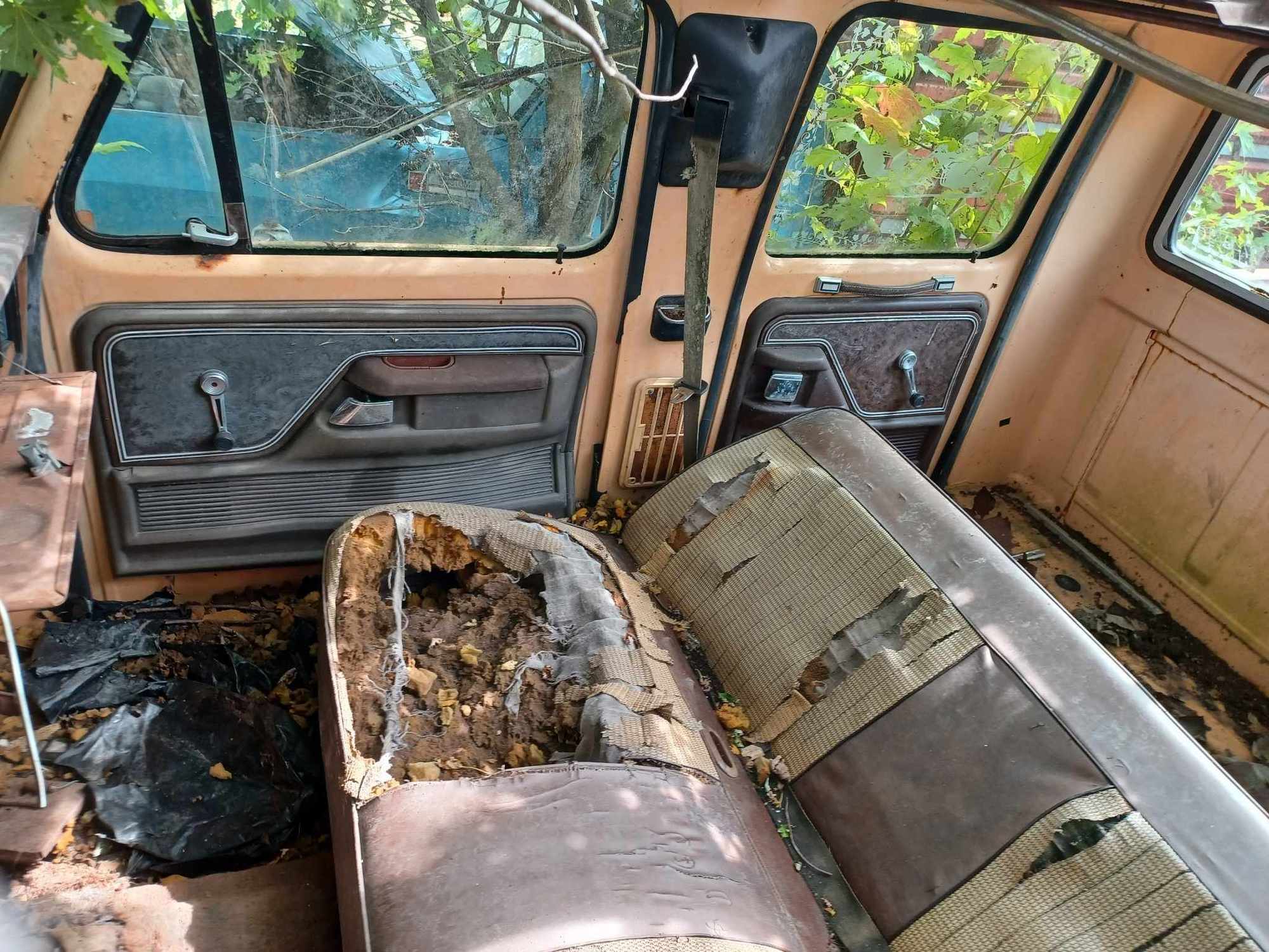

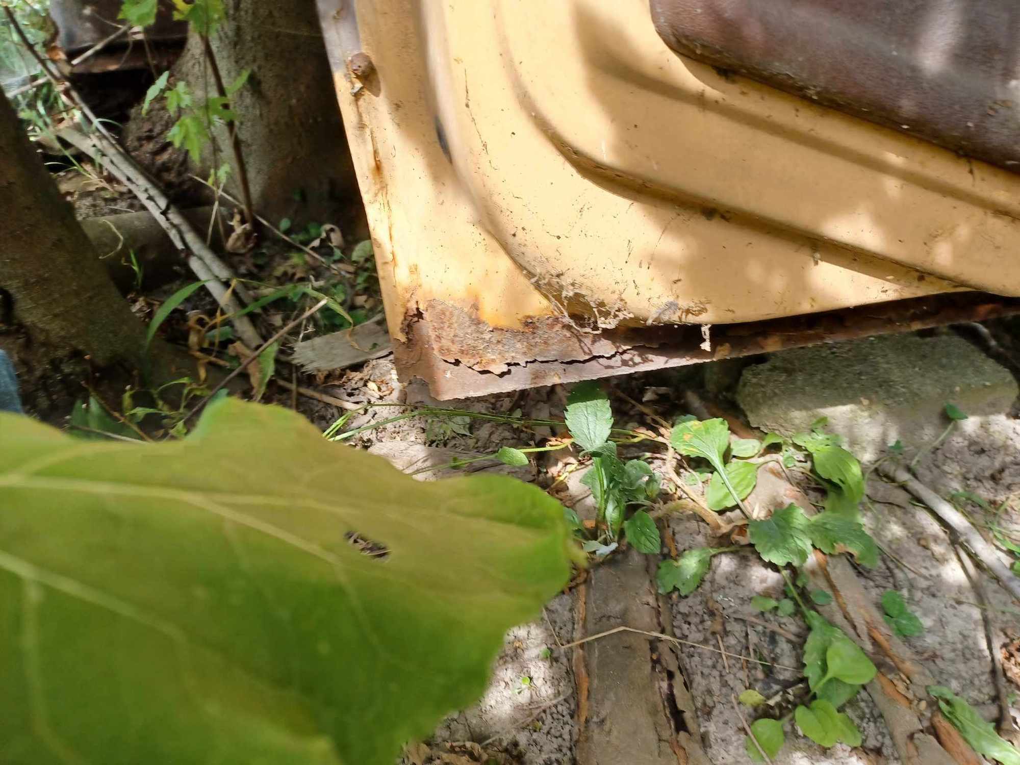

More Pics
I got a closer look at the truck and it is worse then I thought, the roof skin is completely gone and driver side floor boards. I wont be able to pull it out for a couple weeks due to harvest. It does have a 460 with a Automatic I believe to be New Process 542-fl 5 direct speed and a Dana 60 354 gear. The 460 did run when parked years ago and under hood looks pretty complete. I was wondering about the bed how bad can it be to be sellable?

@ChaseTruck754 _ _ I agree with you. These crew cabs are bringing high bucks if a clean restoration and effort.
I have passed on so many affordable CrewCabs since building mine in 1996 thru 1998 completion. It is a mix of pieces and parts.
Ok, just for grins: I built up my '77 Crew before digital camera and iphone or internet. Therefore, no photos. Ha
@Fair 96
My recommendation is to post that in the Marketplace section here in the forums to give it some exposure. Sell it complete
There will be someone with the capability to section out that roof and rebuild it.
I would give it a good pressure washing, and fire-up the engine using remote fuel supply first. Remove valve covers to tap open all valves to check if you have any that are stuck from sitting. This will prevent bending pushrods while turning over the engine if having a stuck valve from sitting.
A good 18cfm @ 90-psi compressor and a sandblast post will have that thing sparkling and ready for the mig welder and patch pieces. A section of a newer crewcab would be a wonderful donor to restore that cab.
