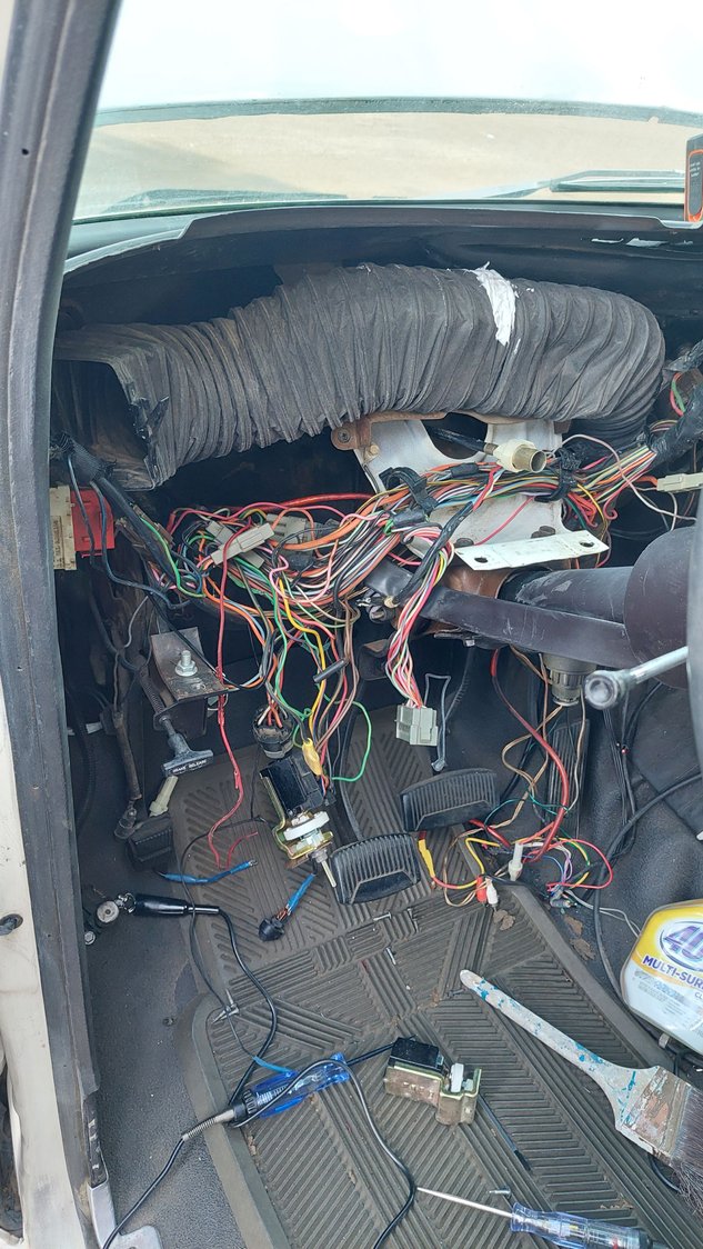

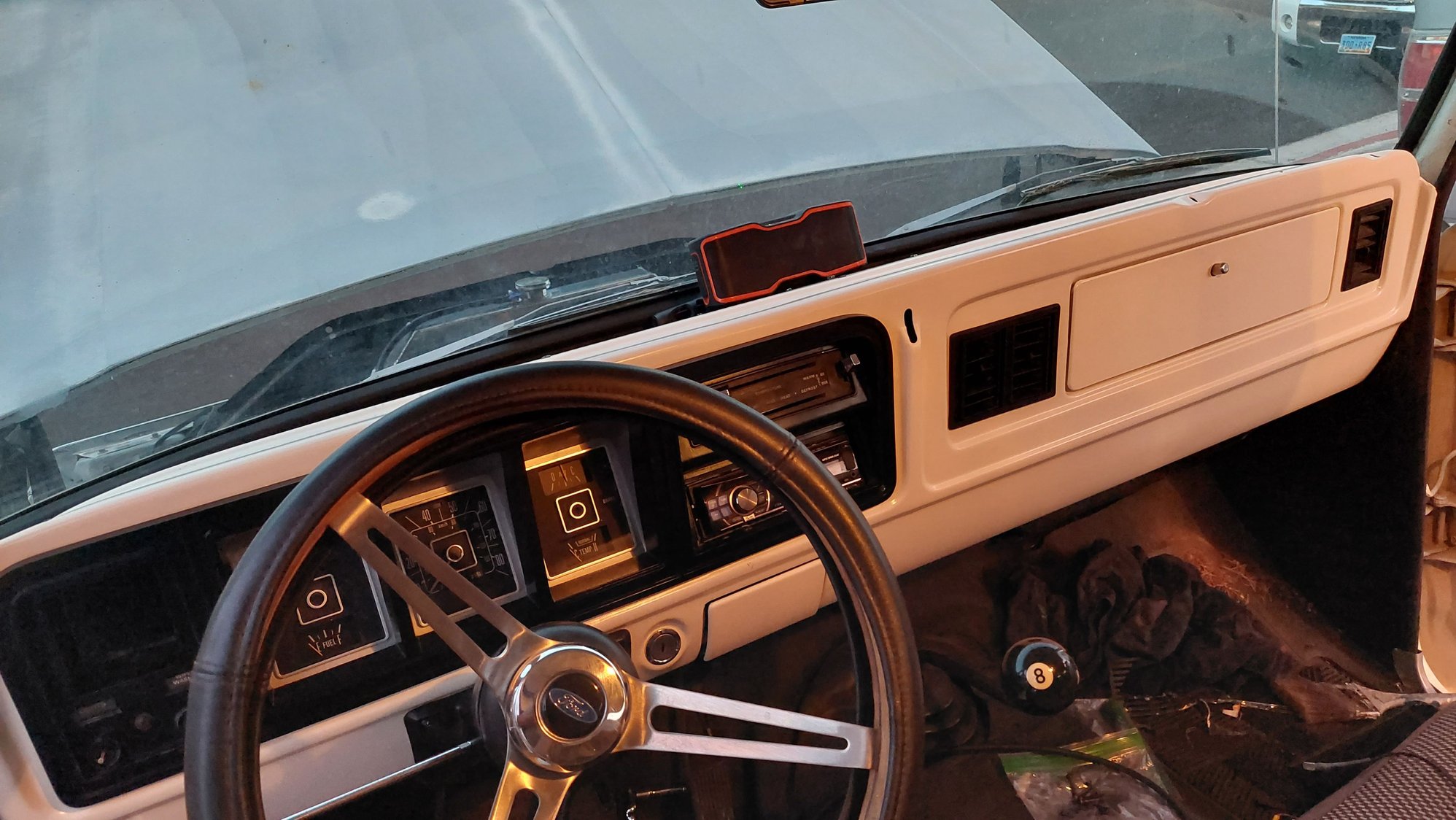

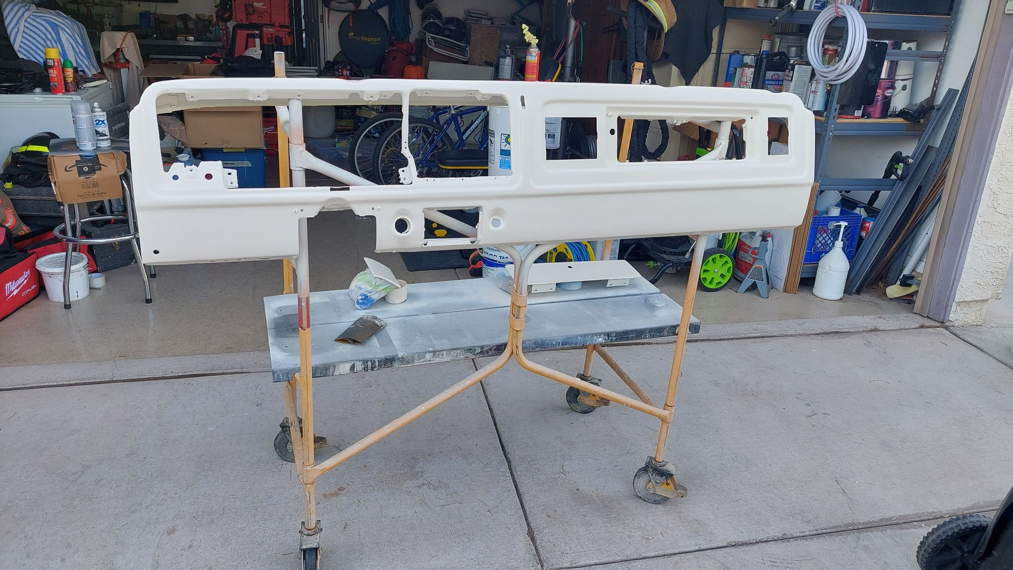

So I took my entire dash out to address some minor issues I was having with a vac leak, and my dash cluster lights not working. while I had it out I painted
up everything and cleaned up 40+ years of dirt. Got everything back together and now I dont have brake lights. I found some bad wire connections, and fixed them, but I think I may have disconnected the hot wire to the brake. Does anyone know the color of wire I may have disconnected? I know I can probably just run another wire to the switch, but I have 2 wires that were not being used when I put it back together. There were about 5 when I started removing them and patching the holes in the fire wall. The ones left are original wires, but I just want to connect the right one if possible.

Dang ! Nice job on the Dash-rehab Pete.
Did it go in tight ? hahahaha (Gozintite) LoL
As nice as your dash looks now, I'm gonna have to reconsider mine. I had painted everything but my dash, back when I painted my pickup. Hmmm.
What pointers might you wish to share with us guys if we were to tackle this job ?

Well, there are only 5 bolts that hold the dash in place. I disconnected everything like, the bezzle/cluster, the glove box, registers lighter, steering column cover and HVAC/radio. Then there are two bolts above the steering column, one in the e brake bracket, and one at either side of the cab. If I had known how easy it was, I would have done it years ago. I cleaned everything out, with a leaf blower, and dry paint brush, and would strongly suggest eye protection. The shop vac was ok, but wasnt getting to some of the tight areas.
edit: there are a bunch of screws along the top of the dash that need to be removed. 6 total I think, and the ones on eitehr end are hard to get to without a shorty phillips screw driver.
When putting it back together, set the glove box into the opening behind the dash before setting the dash in. I just didnt want to be fighting with it while trying to get it back in place, and risk damaging it, just screwed it back in once the dash was set. Man I couldnt believe all the bad wire connections and holes in the firewall. Would have never seen them if I hadnt done it. The whole damn truck smells better too. I would suggecst not leaving the thing out very long, so you dont forget stuff. Like I did with the brake light wire....

After breaking out the old Chilton manual, I was able to chase wires down, and figure out the passenger brake light wasnt working from the damn turn signal switch in the steering column. Would have never figured that out normally, but was patient and chased wires until there was no other solution. I was actually able to disassemble the turn signal switch, clean all the terminals, and put the old one back together and everything is now working. I ordered a new switch, but will just let this one ride for now. For the first time since I have owned this truck, every single light on the exterior not only works, but as it was intended.

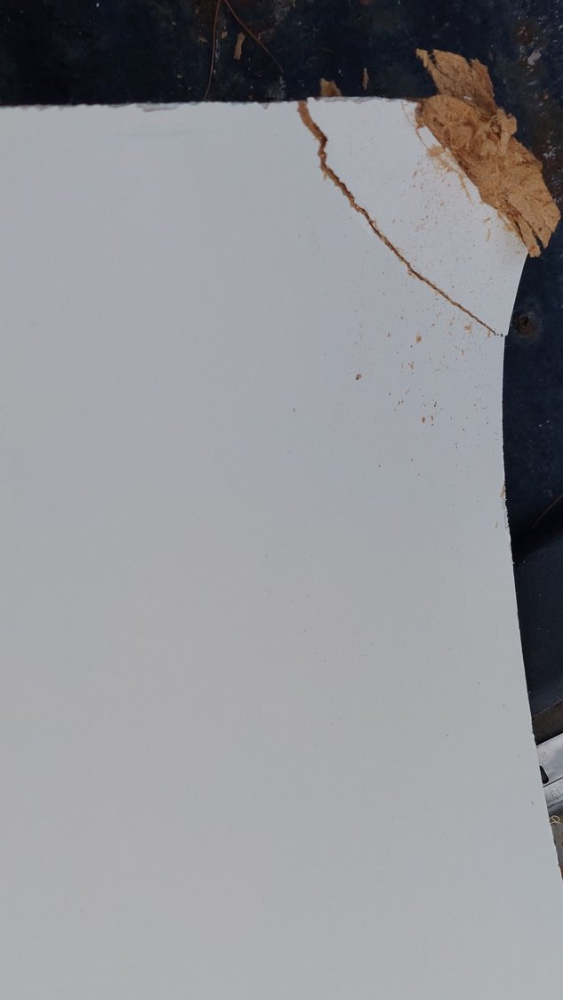

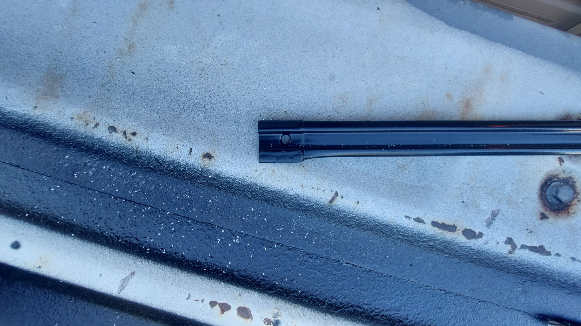

I am sooooooo pissed right now. I took the head liner panels out that I made years ago, and had some work to do on the trim support for the center, as I cant find the plastic pop on trim piece.
I cut down the track of the trim support, at either side of the cab, as it was forcing a weird transition at the ends.
track cut away
trim modified slightly
center trim support dry fit
Modified the trim pieces to accept the new metal at either side.
Went to grab the back head panel, and ****ing dropped it!.........
Old Oct 30, 2021 | 10:54 AM
  #3764
Peter Gozintite's Avatar
Peter Gozintite
Joined: Apr 2017
Posts: 180
Likes: 84
From: Las Vegas
**** me to tears!
Old Oct 30, 2021 | 11:52 PM
  #3765
Light Blue Oval's Avatar
Light Blue Oval
Joined: Apr 2021
Posts: 346
Likes: 159
From: Ootsa Lake
Yup...but--on the bright side--at least you have a perfect pattern for the new one.
