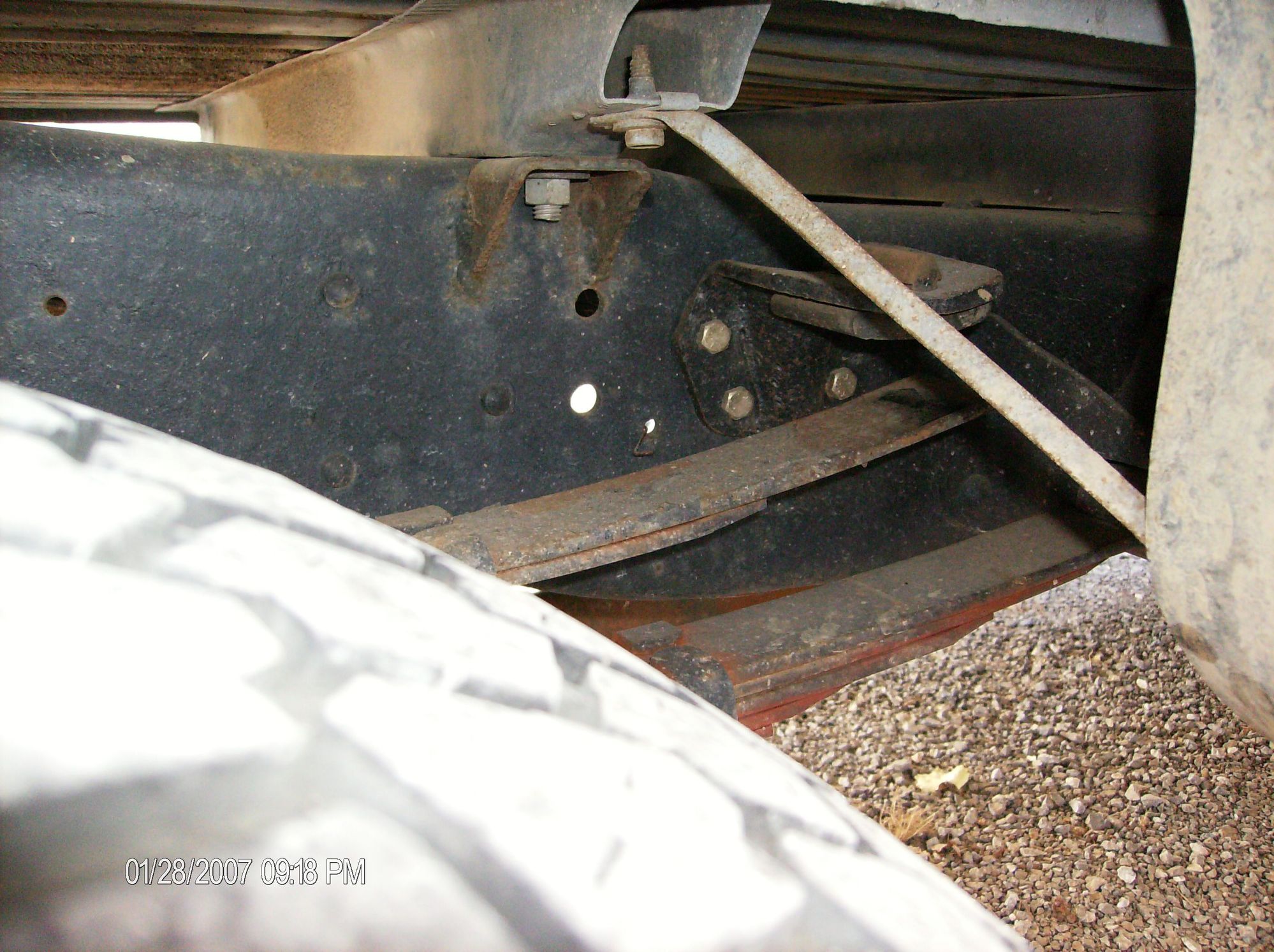

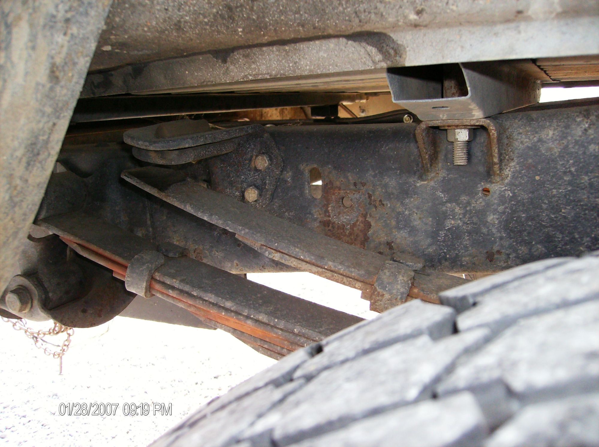

Hi ya Firemedic,
I am running a ;77 F350 longbed 2wd chassis converted to 4x4 up front using '76 highboy springs and frame hangers.
In the rear, I removed rear springs from a short wheelbase '77 f250 2wd Crew for pliability and soft comfy highway ride.
On top of the F250 light spring pack sits a factory overload spring pack which sits on a 1-inch spacer block.
The frames are factory punched with holes for accepting the frame perches for the overload spring set-up.
I sourced the overload spring pack,and spacer block from a 1-ton dually, and sourced the frame perches from a later ford that have the heavy nylon scrubber-pad. I am very happy with my set-up using factory rear spring shackles.
Above photo showing front end of overload spring, and frame perch pad from a later model ford w/ plastic scrub-pad.
My 2wd longbed Crew cab F350 chassis was factory punched with holes to accept overload perches..
Above photo showing rear overload spring frame perch from a later model Ford w/ the plastic rub-pad.

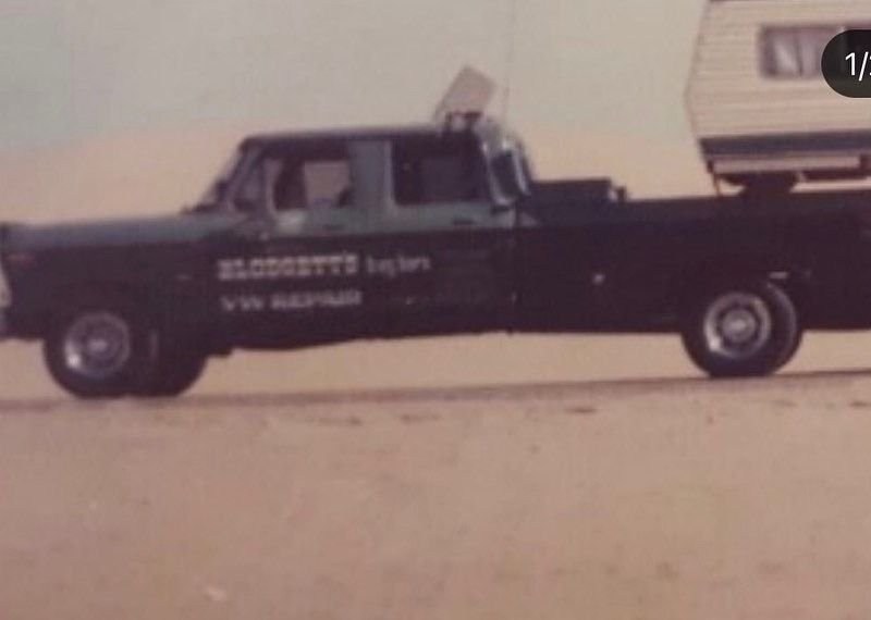

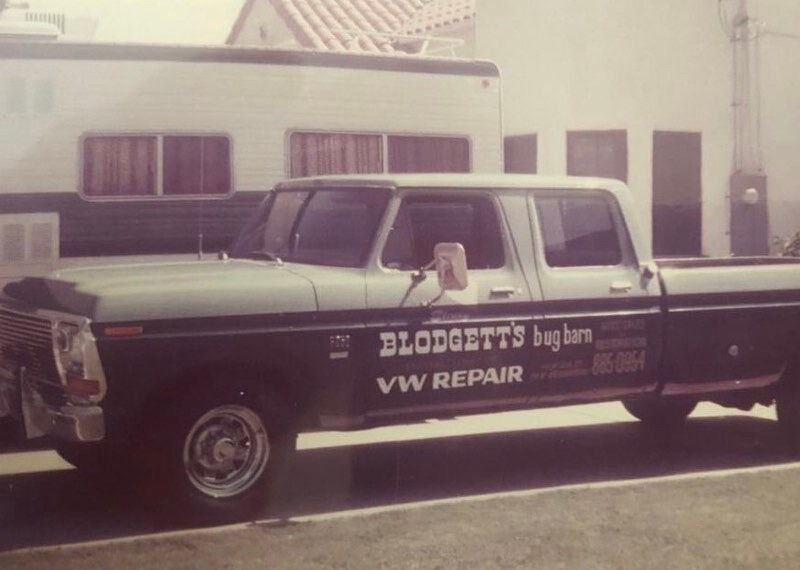

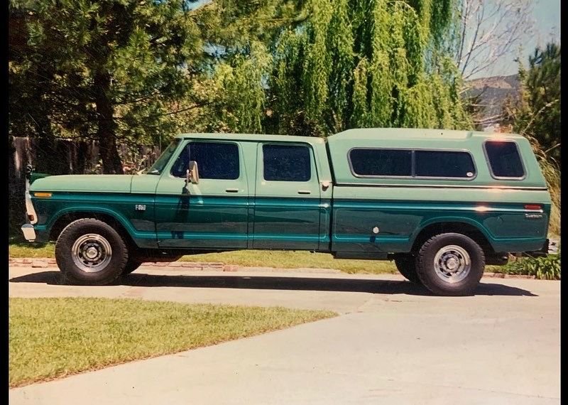

Has anyone seen this truck in the last 20 years. My dad bought this new sold it around 1999 it’s a 1973 f350 with a 79 grille. I’d love to get it back lots of memories. The truck had a fresh paint job and interior when it was sold. Any leads would be appreciated. Thank you.

@justaboutbroke
Dang and double Dang, your dad had a super nice Crew, and long wheel-base same as mine. mine was a 2wd F350.
You guys must have shared some wonderful times together.
When you look at the looong wheel-base in the photo's it sure looks stable for Towing chores.

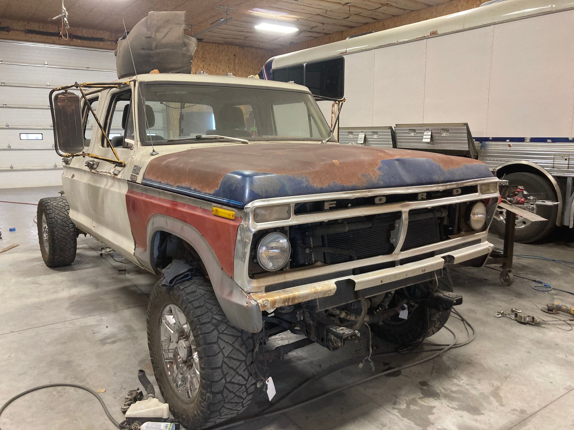

DM @oldfordcrewcabs on instagram. There was a clean one in Los Angeles a couple weeks ago for $15k

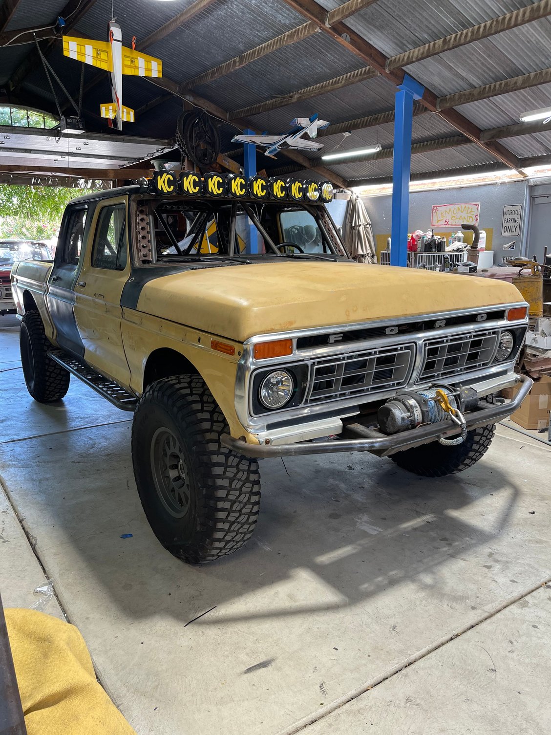

Since I am here,

that truck is so badass!!!

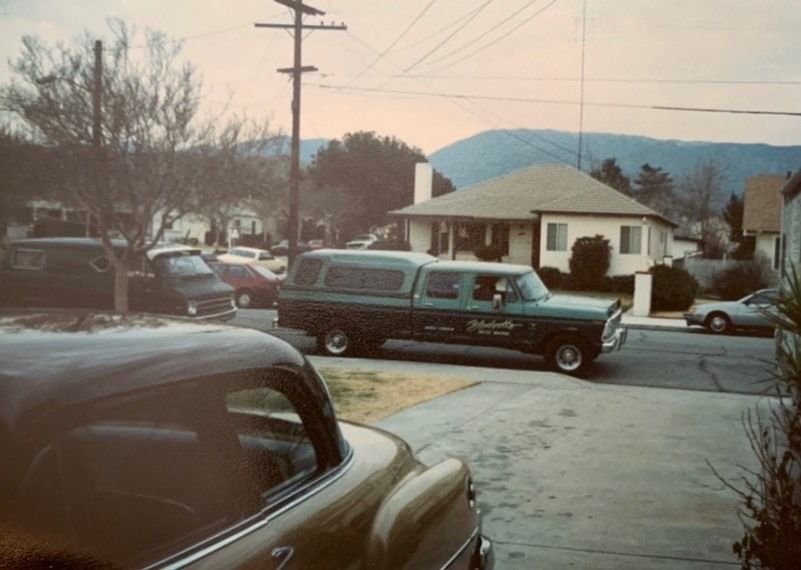

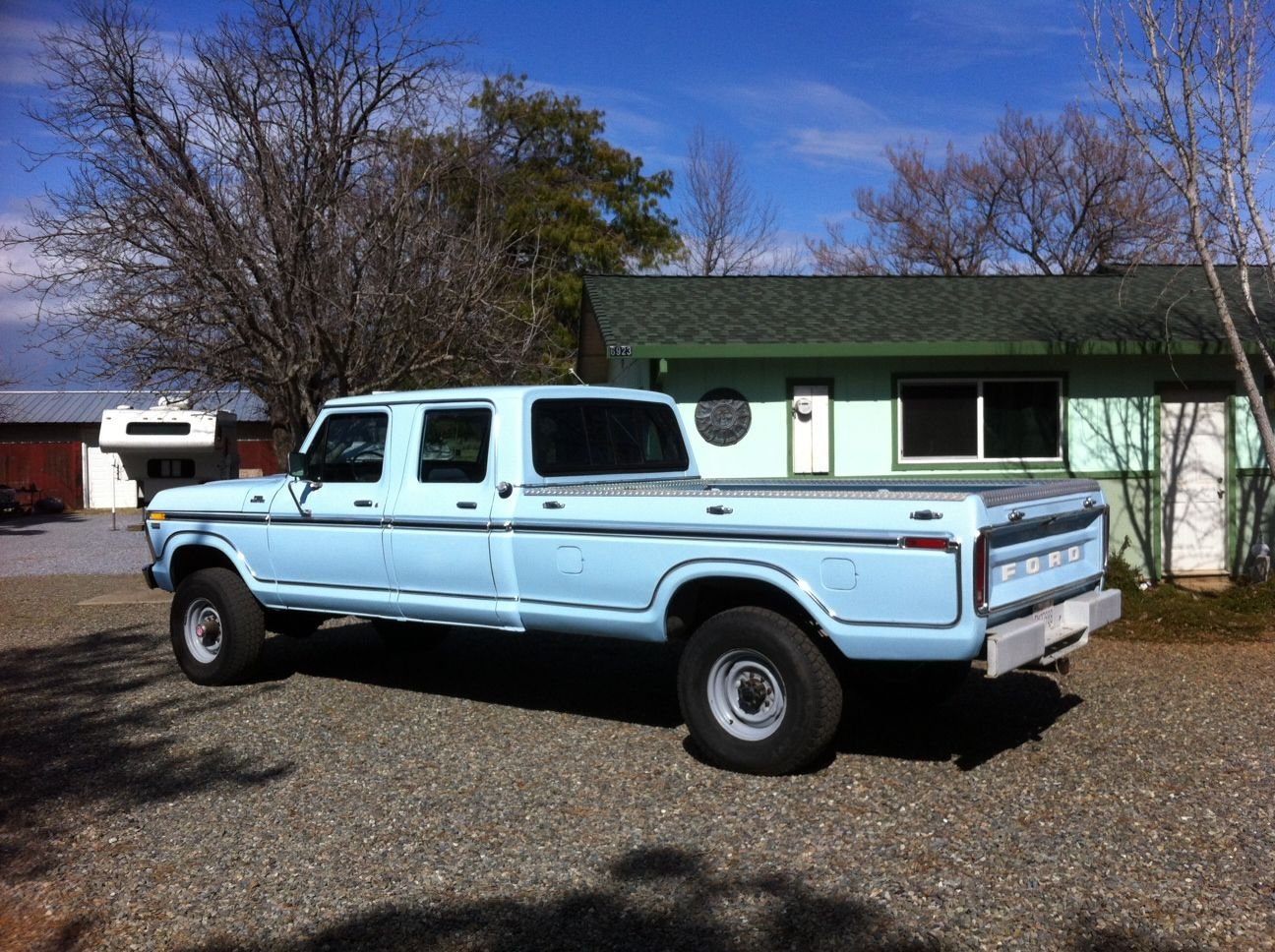

Shortly out of high school in 1969, a guy I knew bought a new '69-'72 F250 Crew Cab pickup powered w/ the 300 inline six.
Needless to say, it took me several years-plus to convince myself to purchase and restore a Crew Cab Vintage Ford.
OMG, look at what they are worth Today
Above photo shows my pickup color and package prior to me placing my cab on a F350 2wd chassis, and installing long box and 4x4.
Above photo - 20-some years after my frame-off refurb and 4x4 conversion (Greaser fabbed)

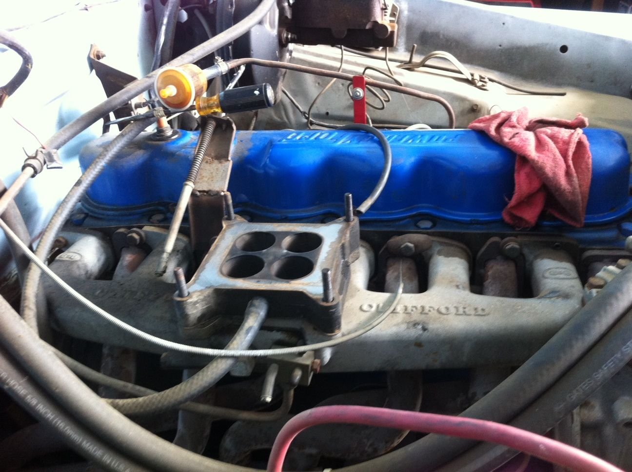

Above photo - showing the Clifford intake with 600 cfm Holley universal carb removed. _ _ _ simple-simon open engine bay.

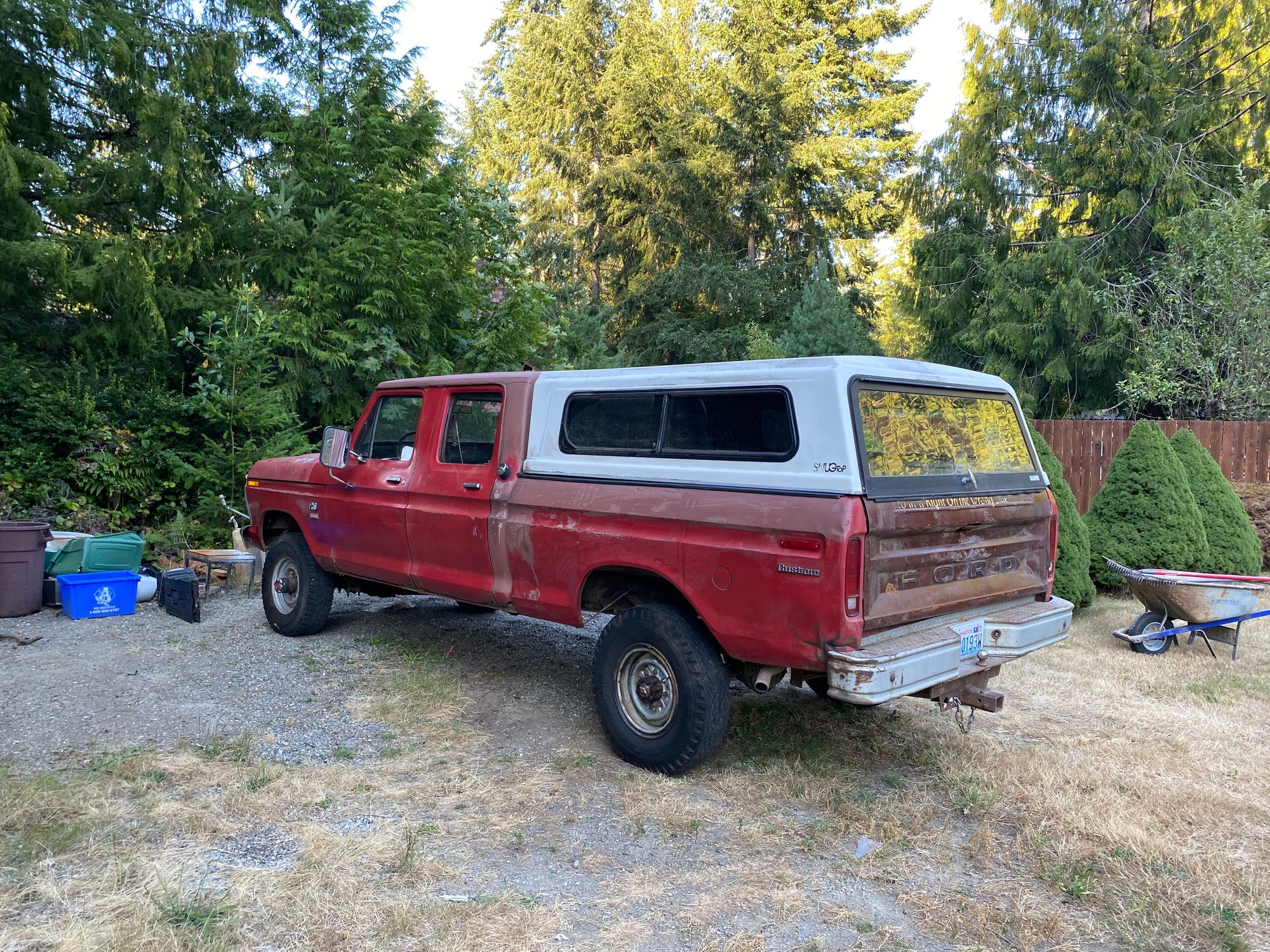

Also, here’s mine. Just got brakes the brakes squared away and replaced a u-joint. Going on its second drive in 5 years on Sunday.
