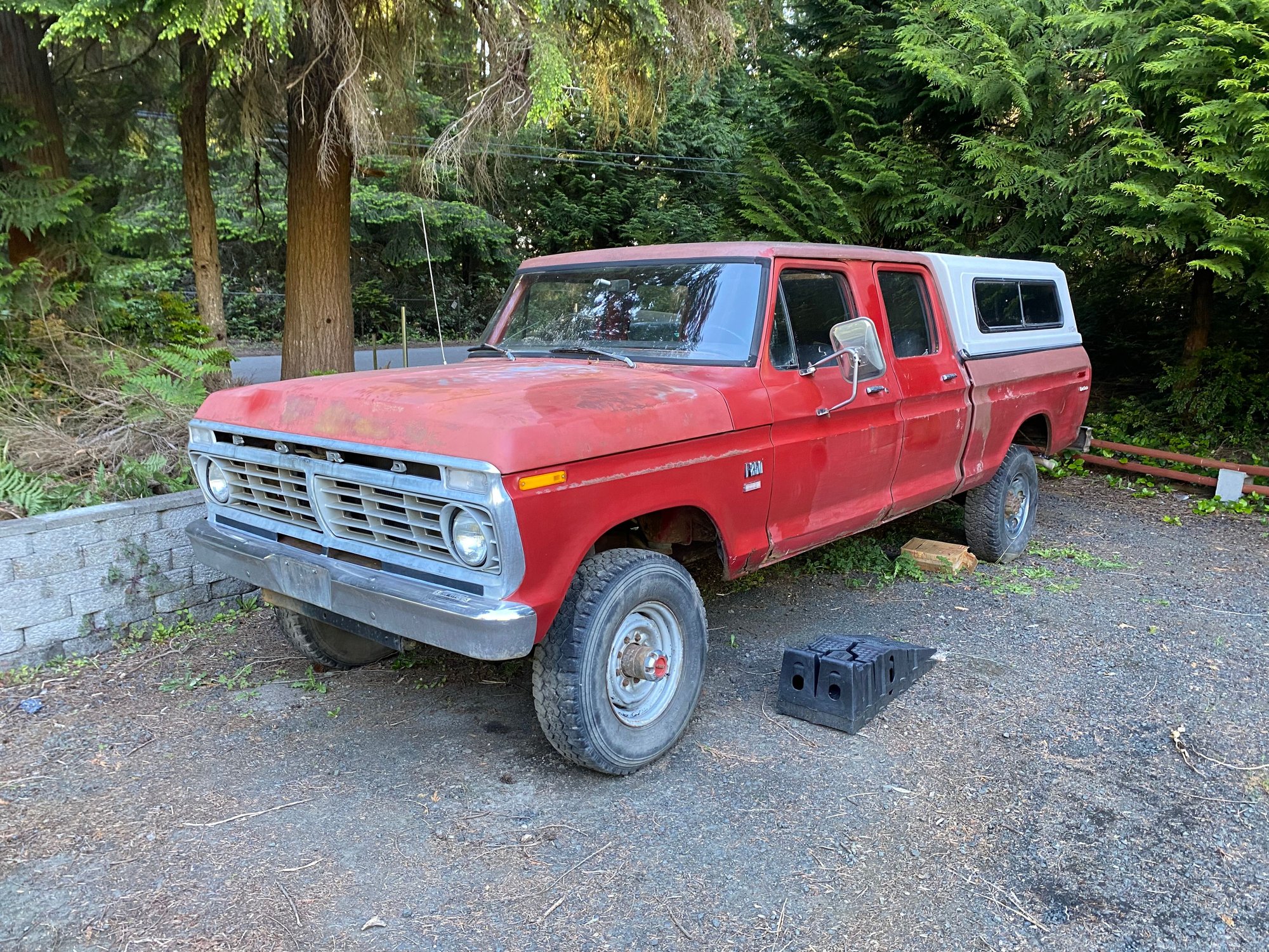

Spotted this truck on BringATrailer. It is one digit off my truck. It is from the same fleet order as mine but it was sent to Wyoming whereas my truck was sent to Michigan. Pretty cool to see a “sister truck”!
https://bringatrailer.com/listing/1974-ford-f-250-24/
