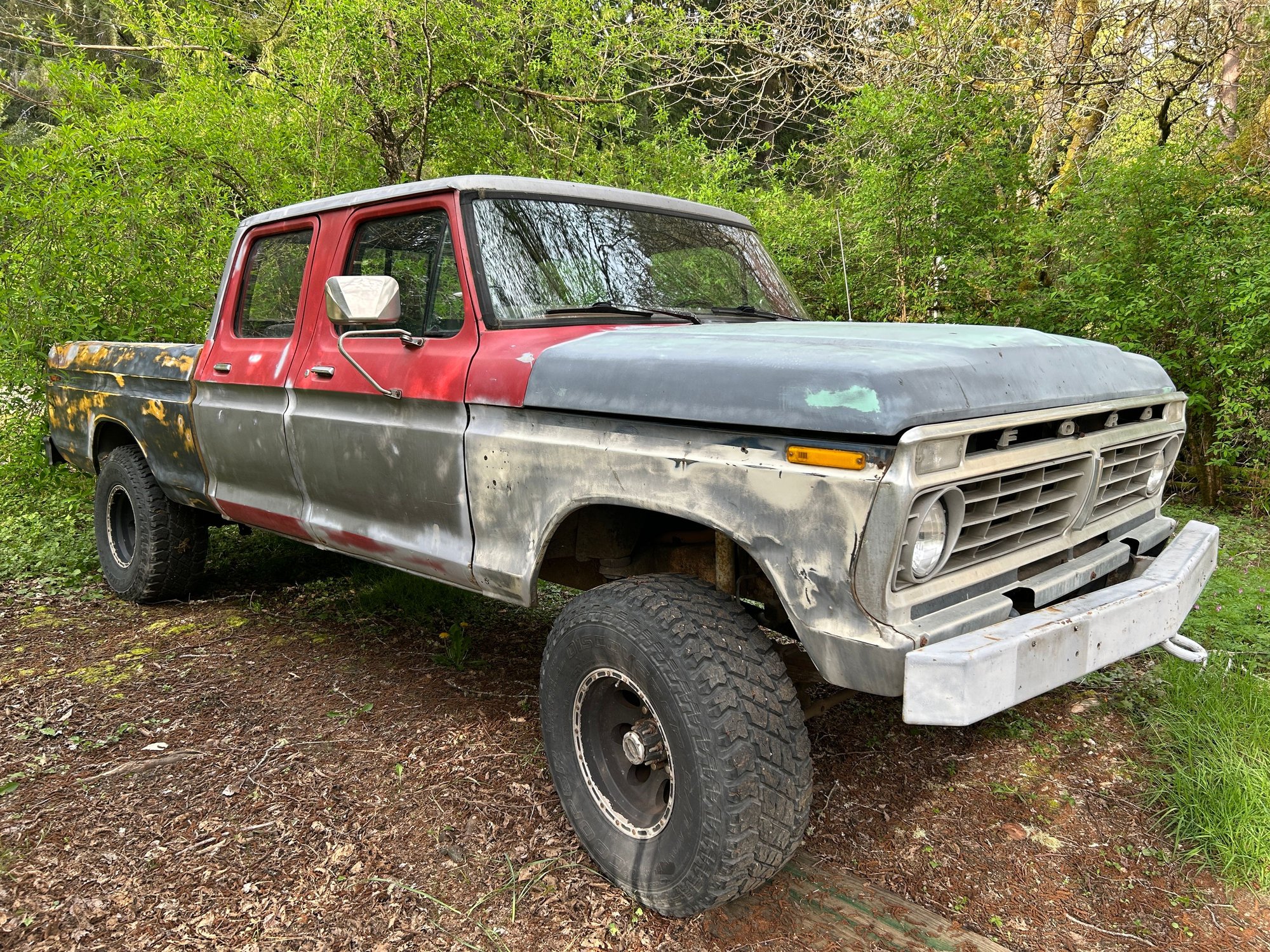

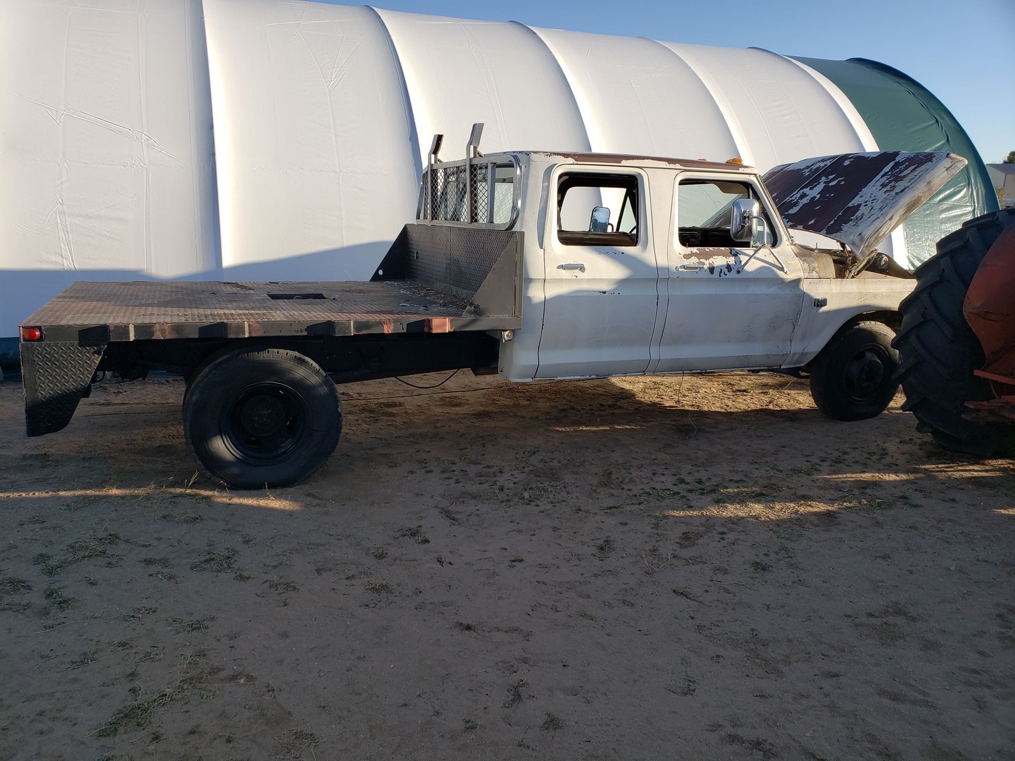

Yesterday I bought this ‘76 to replace my other ‘76 crew project. 300 six, 4 speed, and it’s converted to the late model power steering box. It needs some work but made it over the Snoqualmie Pass no problem.

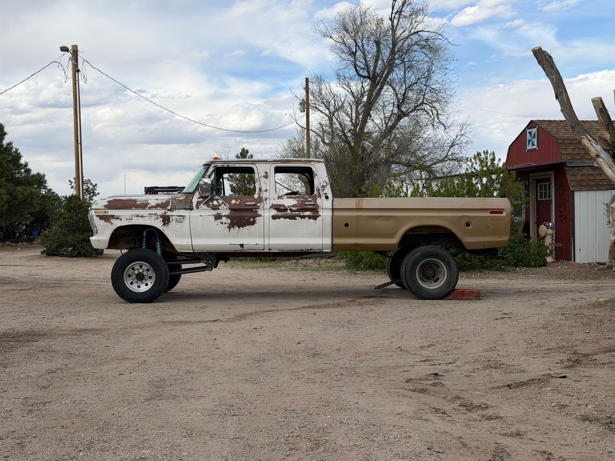

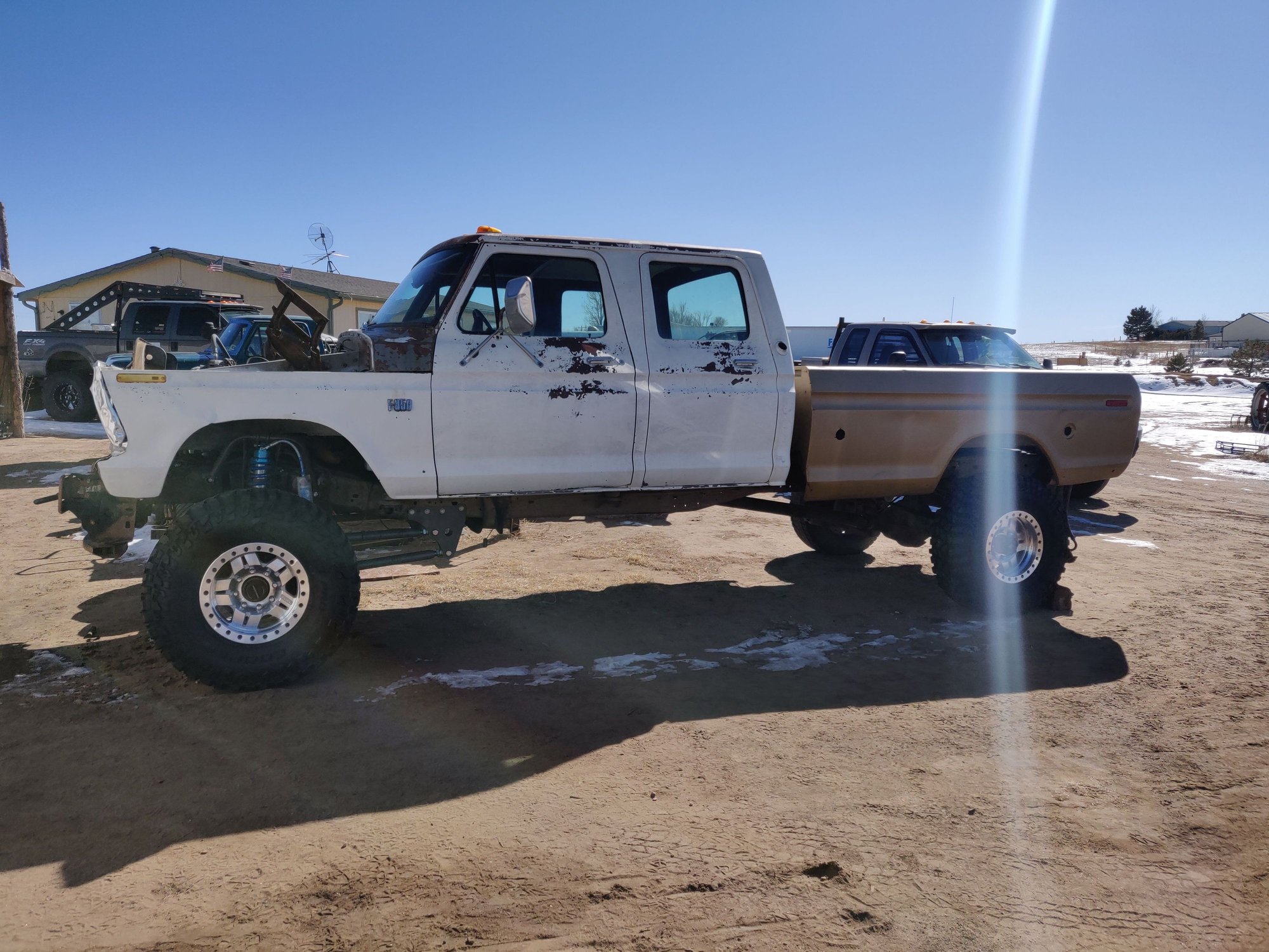

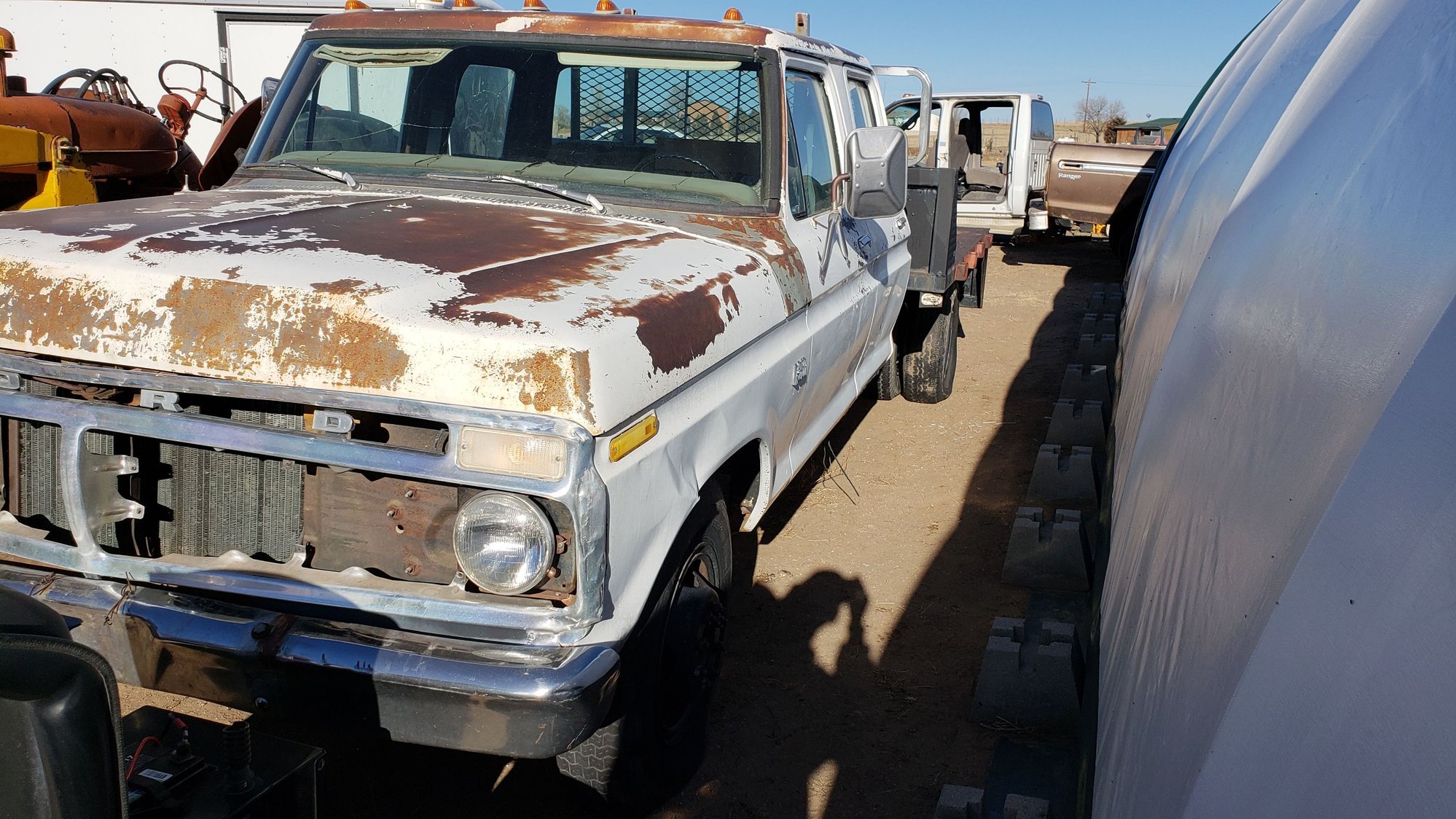

I picked up a 76 F350 back in 2018...finally getting back to it and basically started over. Truck started it's original life as a chassis cab truck. I was going to put it on an 01 7.3/ ZF6 Powerstroke SD chassis cab rolling chassis. After recent research, I changed things up and went with a SD CC chassis as the 79 bed bolts right up. During the frame shortening process, we discovered the frame was bent up front...so we had to use 2 different chassis to make 1.
This is how i got it. It doesn't have the correct mirrors, but i'll eventually fix that
This is where we got to back in 2018 on 01 chassis cab

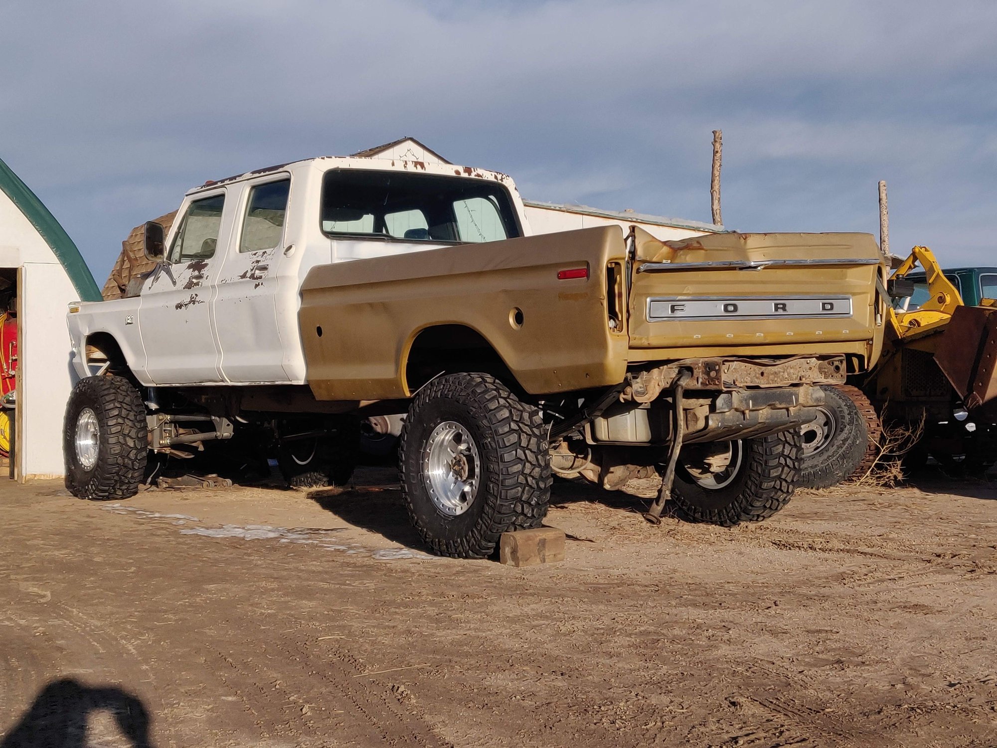

This is where we are now. next step is to cut off SD cab mounts and reposition them for the 76 cab

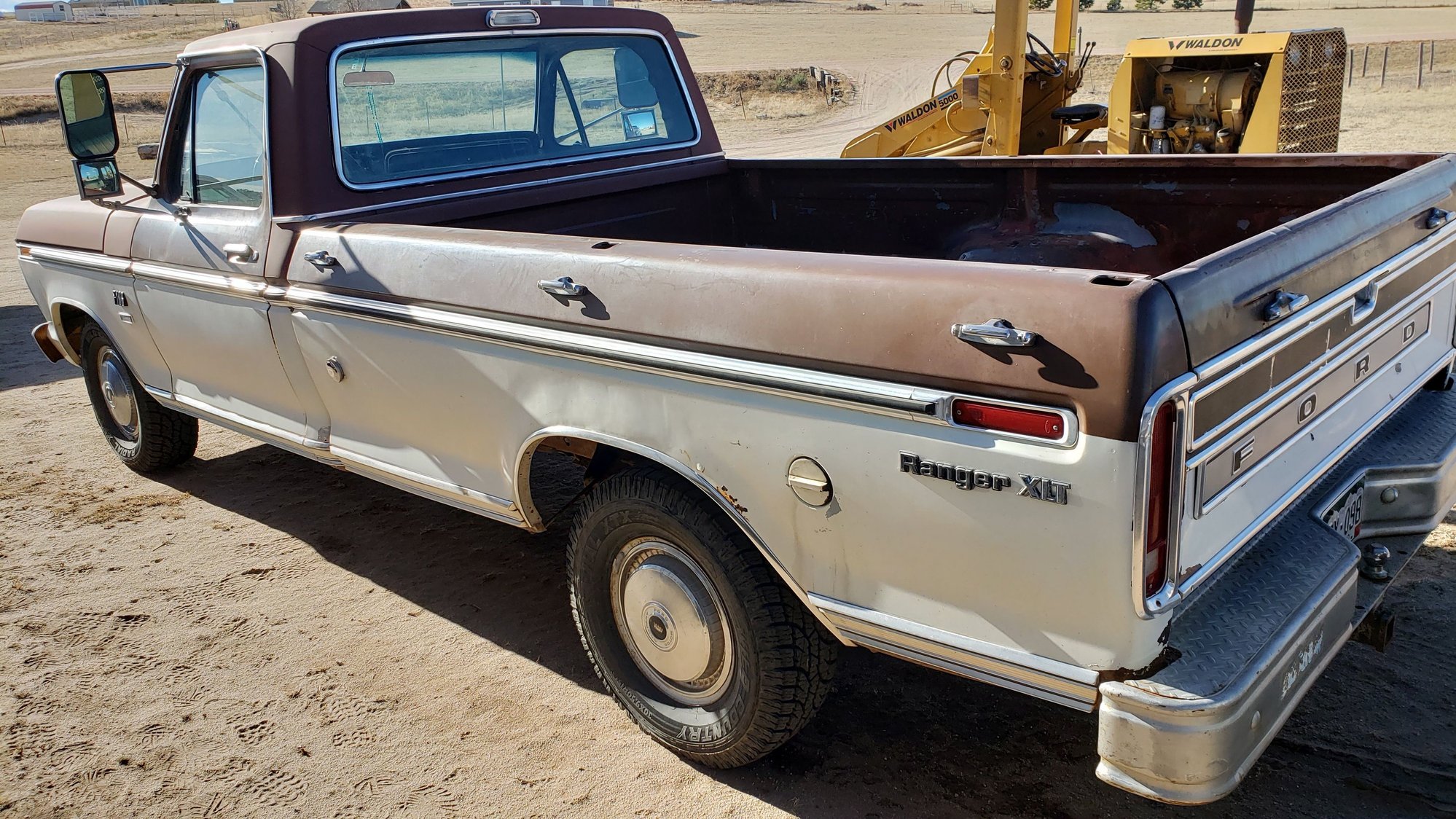

I bought this F100 back around 2018 as well and was going to use it as a donor...but not sure anymore. Might just keep it as is and rebuild the 460 and do bodywork on the crewcab

I've been cutting off the superduty mounts, they are all welded. I'll be using the superduty mounts with S&B bushings. We did have to replace the rear spring hangers though. We used to heat up the rivets with the torch, knock the heads off and punch em through. This time i opted to cut an X in the head method...that actually worked extremely quick and easy...easier than anything i've tried before.
