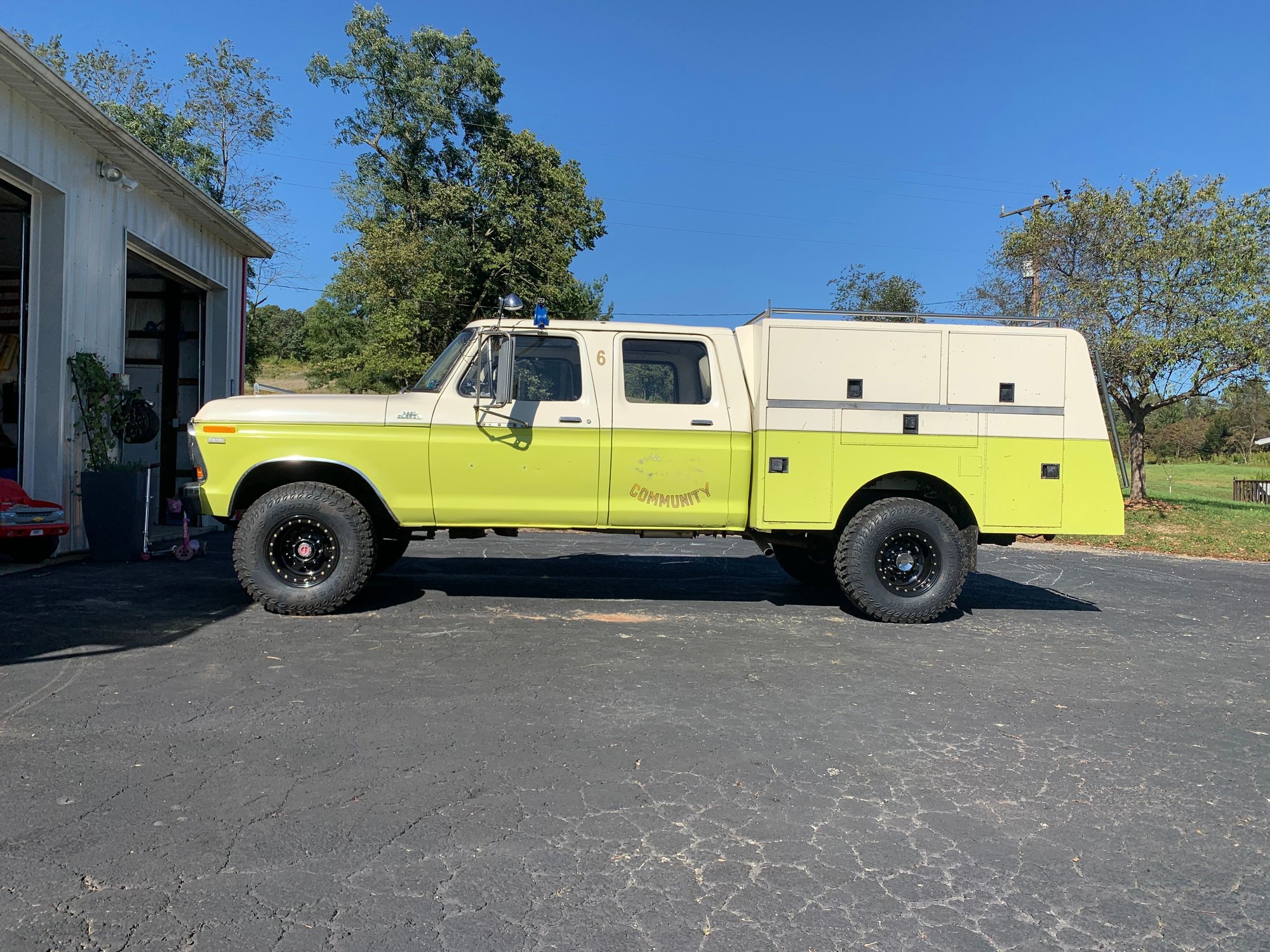

Originally Posted by somethingclever
Wowzers!!!!!!!
I was torn between my current colour (white) and my company colour (Mooneyes yellow).
That Sir, may be the answer - it looks awesome as a 2 tone in those colours!!!!

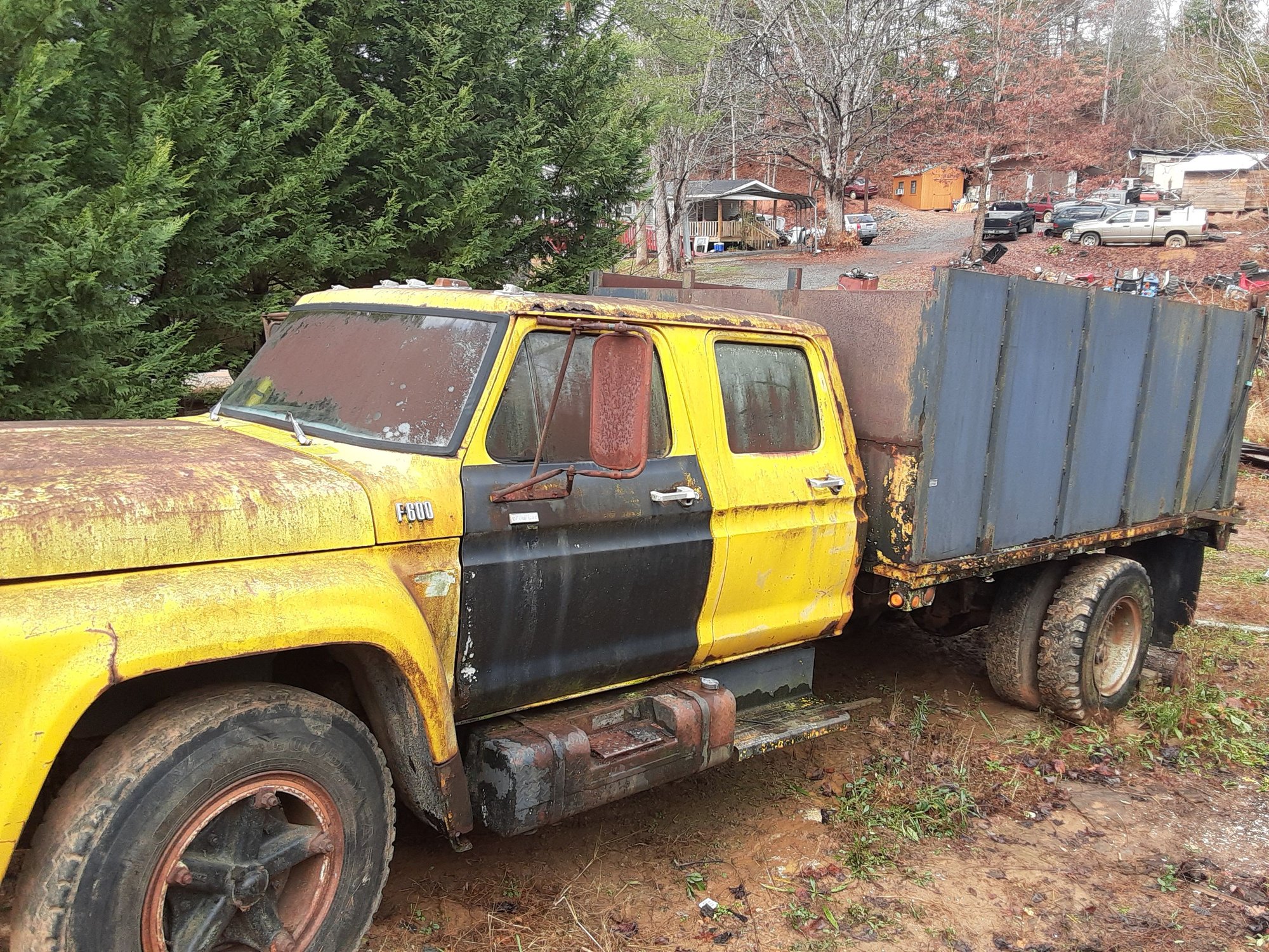

Here's the starter to my project
Looks AWESOME!!!!
and by the way.........what rust????

Heck yeah medium duty trucks are cool especially crew cabs. Does the bed tilt? Have any story on what it was used for?

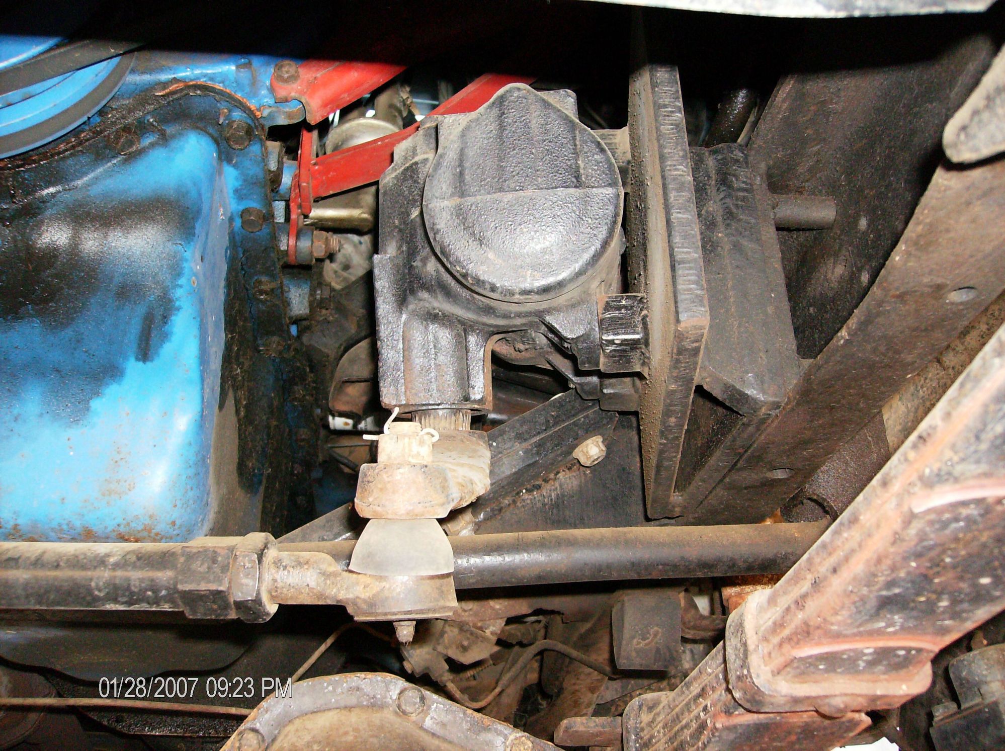

Does $$$$ grow on Trees ?
It had better if you wish to install a oem 4x4 power steering box on your pickup, whether rebuilt or slightly used.
That is why I chose to source a PS box out of a '91 2wd Ford F150 pickup. Nobody has a use for a 2wd PS box right !
Therefore, the Ford corporate PS boxes are almost sold at give-away pricing $40.00 each, with hoses and pitman arm.
The steering box works very well with my home-brew Cross-Over Steering setup using a DynaTrac passenger side steering arm.
Yes, I am just rambling for something to share, but I know there are several Ford Truck Nutts who drive a 2wd wishing it were 4wd.
Personally I feel those expensive-as-gold oem steering boxes used on '77-'79 4wd pickups are OVER-RATED, and a rip-off, unless someone just insists on being a Purist. I can paint the top of my affordable steering box Blue, so I'll have a "blue-top" box. haha
Above photo showing the '91 Ford Corp power steering donor box installed on my home-fab mounting bracket (removable).
Please excuse the filth because my pickup lived 6-years on the Pacific Coast upon completion of my 4x4 conversion.
The front king-pin Dana 60 came from a donor '79 Ford pickup hauled to California from Alaska in 1996.
At the time, I paid $600 smackers for the D-60, and completely disassembled and rebuilt it with $800 in parts. good to go !
It spent all it life on a farm is what I was told. It has a little door on the dump bed for dumping corn onto a silo conveyor
