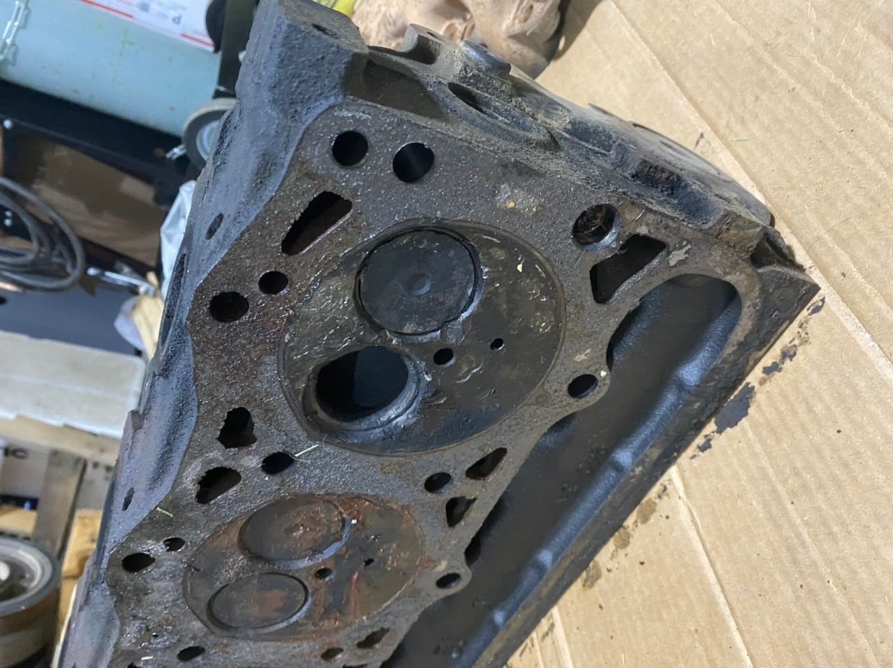

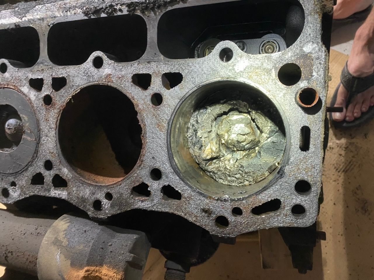

Dug into the motor a decent amount tonight. Got the heads pulled… found out why the motor was pulled… I’m thinking this will need a sleeve. There’s a decent divot in the cylinder wall. Hoping the head can be machined flat into spec. If the machine shop says it can’t be done, the shop I got the motor from will refund me so I’m not super worried about it. Oh, it’s a PMR motor

I think I have a Dieselsite spacer. Seems to work fine.
IMO. I would swap blocks. See if you can just find a beat one that has forged rods and a non destroyed cylinder.

I do plan on swapping to billet rods. Reason being that I know I’m an idiot, and I’m sure one day I’ll end up with another truck that I tow with, and this one will become a toy and probably get compounds. No clue if or when that will happen, but I figure I might as well do that now, with the rest of the build rather than do it later. I will also have the rotating assembly balanced with either a fluidamper or ATI damper. The rebuild on this will probably take a couple of years, as I don’t expect to have the money to complete it any time soon.
but either way, if the machine shop doesn’t think it’s salvageable, I’ll get a different block

I'll take some pictures when I get home. Its been a slow disassembly, as I have been bagging and labeling every part and piece of hardware. Have all of the pistons and rods out, hoping my neighbor brings home his big impact and harmonic balancer puller tonight so I can easily get the rest of the block stripped. Down to the crank, cam, front cover, harmonic balancer, and LPOP. Then I'll take it to the machine shop and see what they think. I'm guessing it'll need to be sleeved on that cylinder and honed on the rest. It looks to be in good shape in terms of the other 7. But I haven't heard too much about sleeving 7.3s, so I guess we will see
