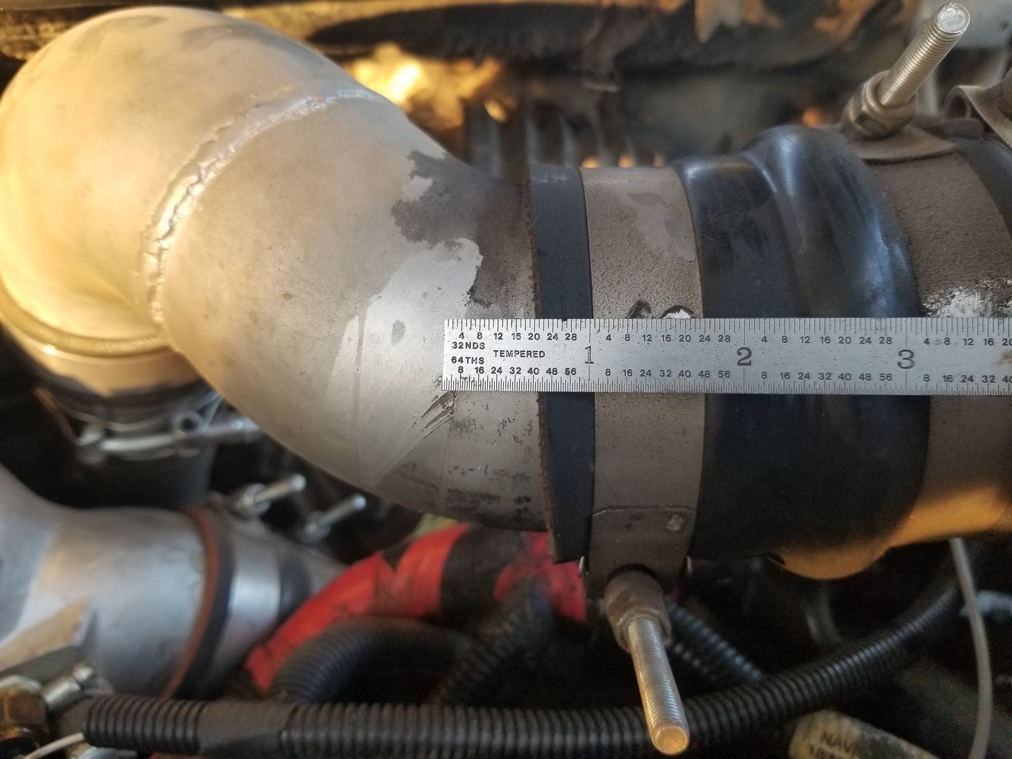

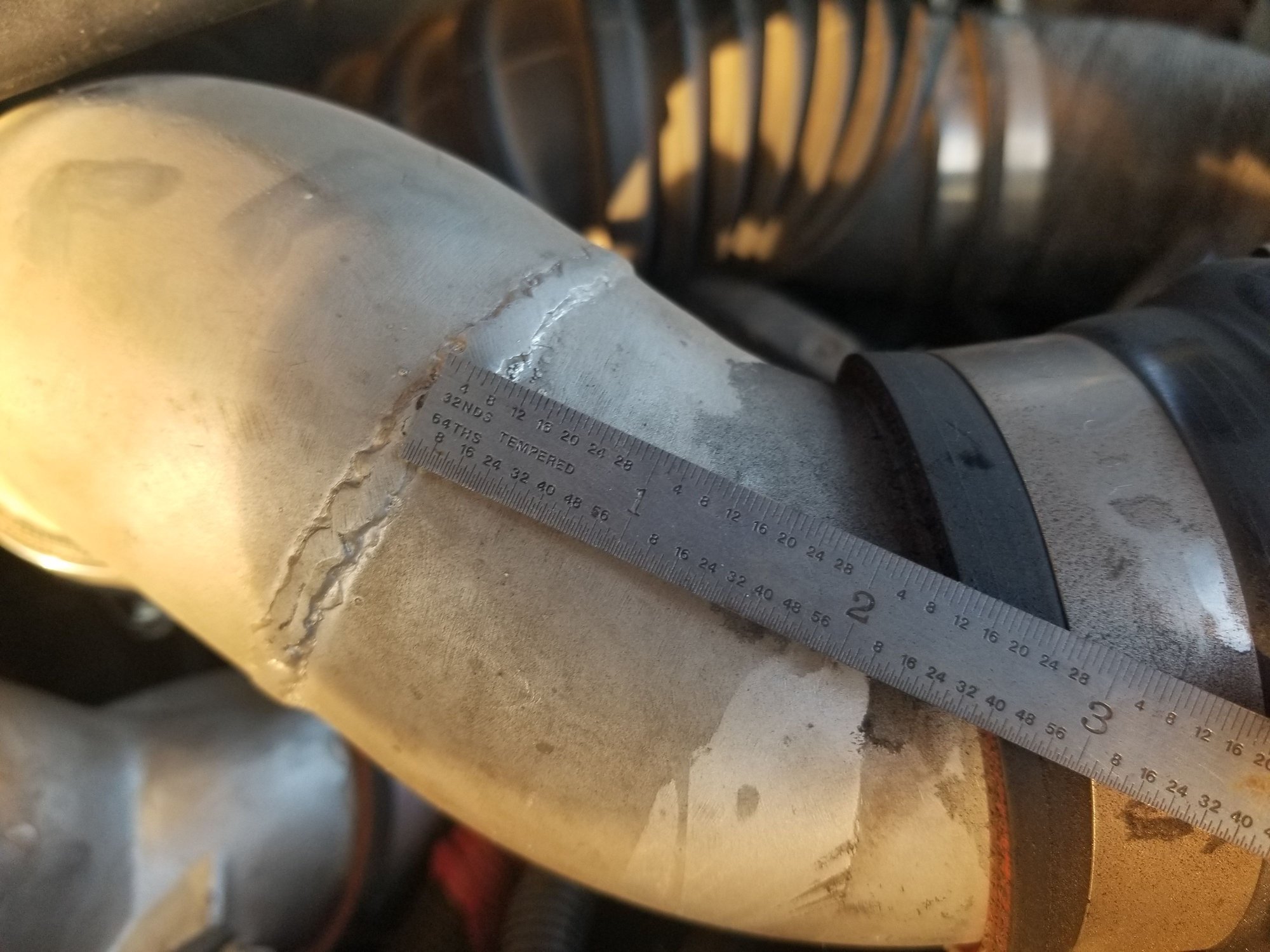

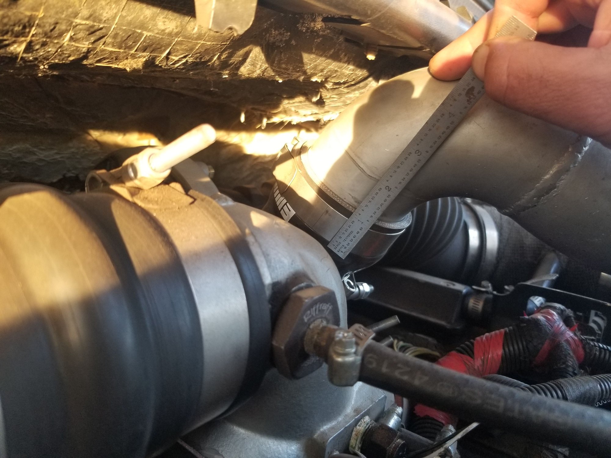

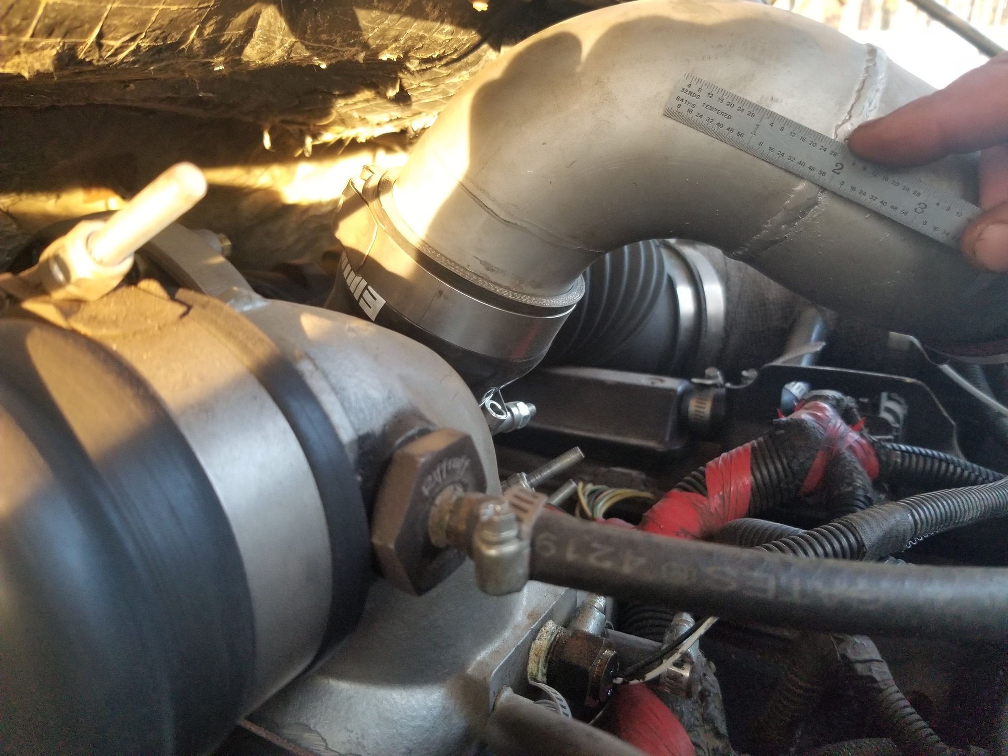

Ah I didn't think of that. I guess the oil film from the CCV should be enough for the inside of the tube.
Thanks for the pics and measurements! That helps to give a better idea of what I should buy.

No problem.
Took a couple more with a ruler for reference.
