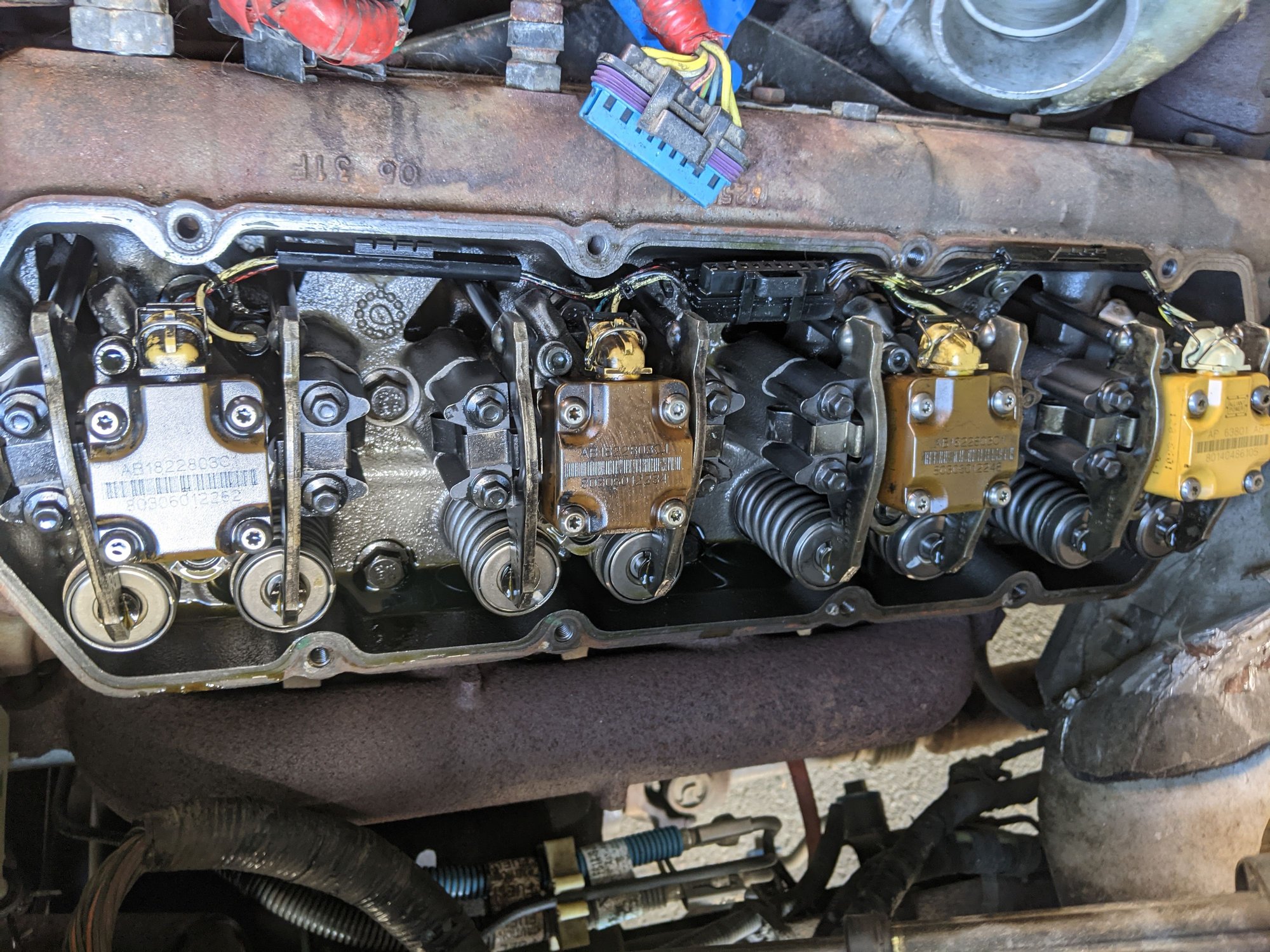

Alrighty. Day One!
Removed the stock turbo assembly, up pipes disconnected (need to be fished out still). Up and down pipes were rusted to the turbo so had to bring a hammer, small crowbar, and ton of PB blaster to the party. Was able to disconnect the up pipes from the manifolds using a mid torque impact with extension and u-joint, using a breaker to keep the bolt from spinning... didn't even have to remove the wheel-well liner!
Seems like the up-pipes were indeed leaking.
Driver side valve cover off. All injector and rocker arm bolts were torqued to spec. None of the rocker arms look cracked. Is there a way to test the GP resistance with the batteries disconnected?
Injector #8 was replaced with an Alliant at some point. Wonder if this was done to try and address the intermittent knock? Anyone know when they started selling 7.3 injectors?
When removing the harness some of these little plastic tabs broke off and went *somewhere*. If they did fall near the injectors I doubt they'd do any harm(?). Should I replace the harness or will it be fine with those little tabs missing?
The hard lines to and from the bowl look rather sad. I suppose I should replace the pump-to-bowl lines in addition to head lines.
HPOP lines also look pretty sad.
The valley and the right side of the head in general is *caked* with oil and detritus... unfortunately a poor critter tried to seek shelter on the warm engine and didn't meet a good end (please check your engines in the winter). I'm having a hard time ascertaining what could have caused such a thick buildup of dried oil. Whatever it was coated the valley 'n' pedestal, ran down the back and the passenger side of the oil pan, coated the passenger side intercooler tube and on to the intercooler, and made it's way around the crankshaft pulley.
I'd like to start cleaning the valley and get some Corroseal and paint on it while I wait for parts. Would need to find a way to block off the plenums and turbo oil holes so I don't get liquid 'n' debris down 'em.
*When the truck was together I took a video while driving to try and illustrate the knock better; don't think the videos in my other thread conveyed it clearly. Gets pretty audible after 8 seconds. Literally sounds like there's a small gremlin in the engine bay tapping the firewall with a wooden mallet. https://youtu.be/HyIzQxfUIYY

My feeling on “too much” for the CCV is if your oil level is going down. The CCV will always put a film of oil into the intake tract so not sure you could tell from there. SSJ had previously said he ran a 38r with the AIS and found it to use oil on his towing trip. Personally I feel like the AIS is so quiet that it’s worth routing the CCV to atmosphere if needed to keep the AIS.
I don’t want to speak for Dan, but the 68mm turbine SXE being used with the 7.3 is new to the forum. In the past everyone was running the 73mm. It was only recently that the tide has changed on this. I think you came in at the perfect time for a T4 install project. The 68mm weirdos were dubbed the Goof Troop at some point before it became an accepted option. We will be glad to add you as a member.
The knock…. I can’t really hear it in your video. I tried to find your 1-3 videos but they weren’t on your YouTube channel. I’m thinking they are accessible by link only.
Have you done the Hutch mod yet? The Hutch helps prevent air from getting into the fuel system and I found it to noticeably quiet the injectors in both our trucks. Might be worth a try before adding the fuel feed kit. The in tank screens plug up so most folks feel this is a required mod for our aging trucks.
Have you removed the fuel line clamps from the heads? They will wear through the lines. You can just remove them.
I agree with Sous about the tight timeline. Like you said, parts delivery is a BIG factor in this. Glad to hear you have a backup plan.

You have gotten a lot done already and you are well on your way! The hatchback is a great backup plan and I am glad to hear there is one in place. Murphy tends to show up when we least expect it.
Those HPOP lines have seen better days, that is for sure. I don't remember if they were on your list, but if not, I would recommend they receive a spot now.
That little piece of plastic is of no worry if you cannot find it.
As for testing the glow plugs with the UVCH off, yes, you can do that. This quote was taken from the PC/ED volume of the Ford Service Manual. Section 4A: Diagnostics Subroutines.
measure glow plug resistance to ground (preferably B-). A resistance measurement of 0.1-2 ohms indicates a good glow plug.
My engine valley was pretty well grime covered and I spent a good deal of time with a bottle of Simple Green, tooth brush and a few rolls of paper towels to get it cleaned off. I can still remember working on the passenger side valve cover and finding the International sticker on it. That was like a small victory in the major battle of cleaning the engine. I spent hours in there cleaning, literally kneeling where the driver side battery and airbox are currently at. My truck was owned by a rancher that transported horses from LA to TX and back for a living. So, it had been used, but thankfully it was not abused.
What a great feeling though looking in now and seeing the clean engine and very dry valley.
