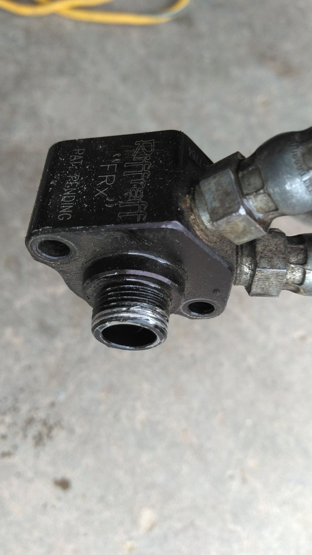

Used frx and high flow cvd fittings ready to ship. A little clean up on frx threads may prove it still very useable...

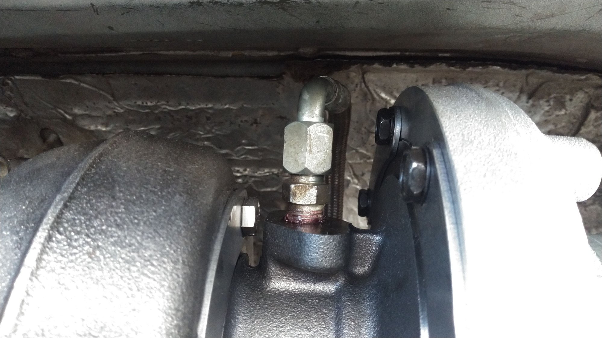

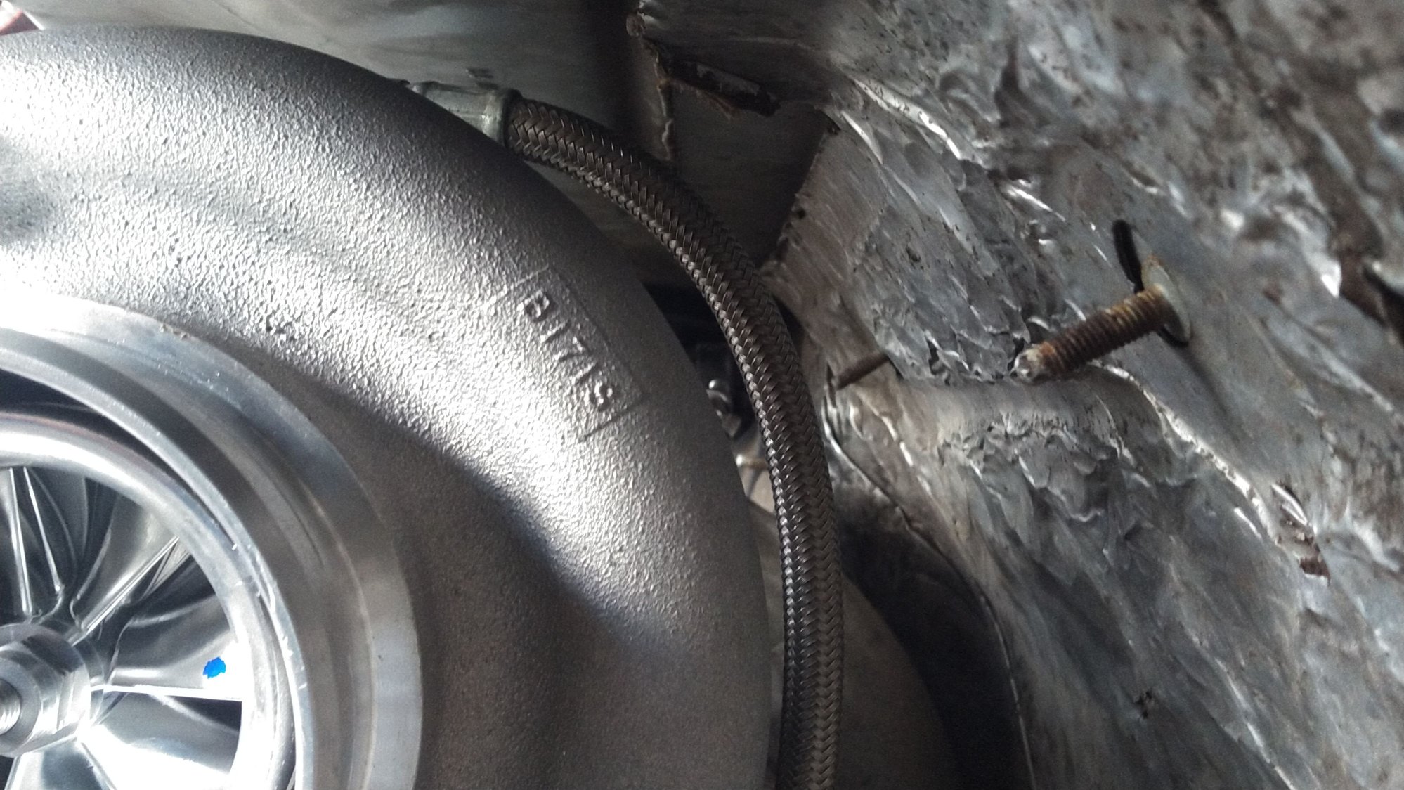

  • The other concern is the oil feed line facing the firewall/going over the back of the turbo. In one case, an OBS owner suffered an engine fire from this line on their Irate kit rubbing through via contact with the firewall: https://www.ford-trucks.com/forums/1...l#post19824388
    I'm assuming this isn't as much of a problem with the SDs as there's a little more room to work with? Again if you own an Irate kit I'd like your input. Perhaps there is a way I could run the line around the front of the turbo like CSD has it?

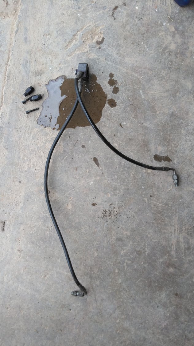

The valley fitting is no big deal, how do you think obs mechanical fuel pumps work, yup through that same hole..
The Irate oil feed line is, in my opinion, by far a better fit then csd. It isnt close to rubbing, the closest to anything it gets is 5/8" and that is directly on top of the turbo. My pics dont accurately show it, but it has tons of room.

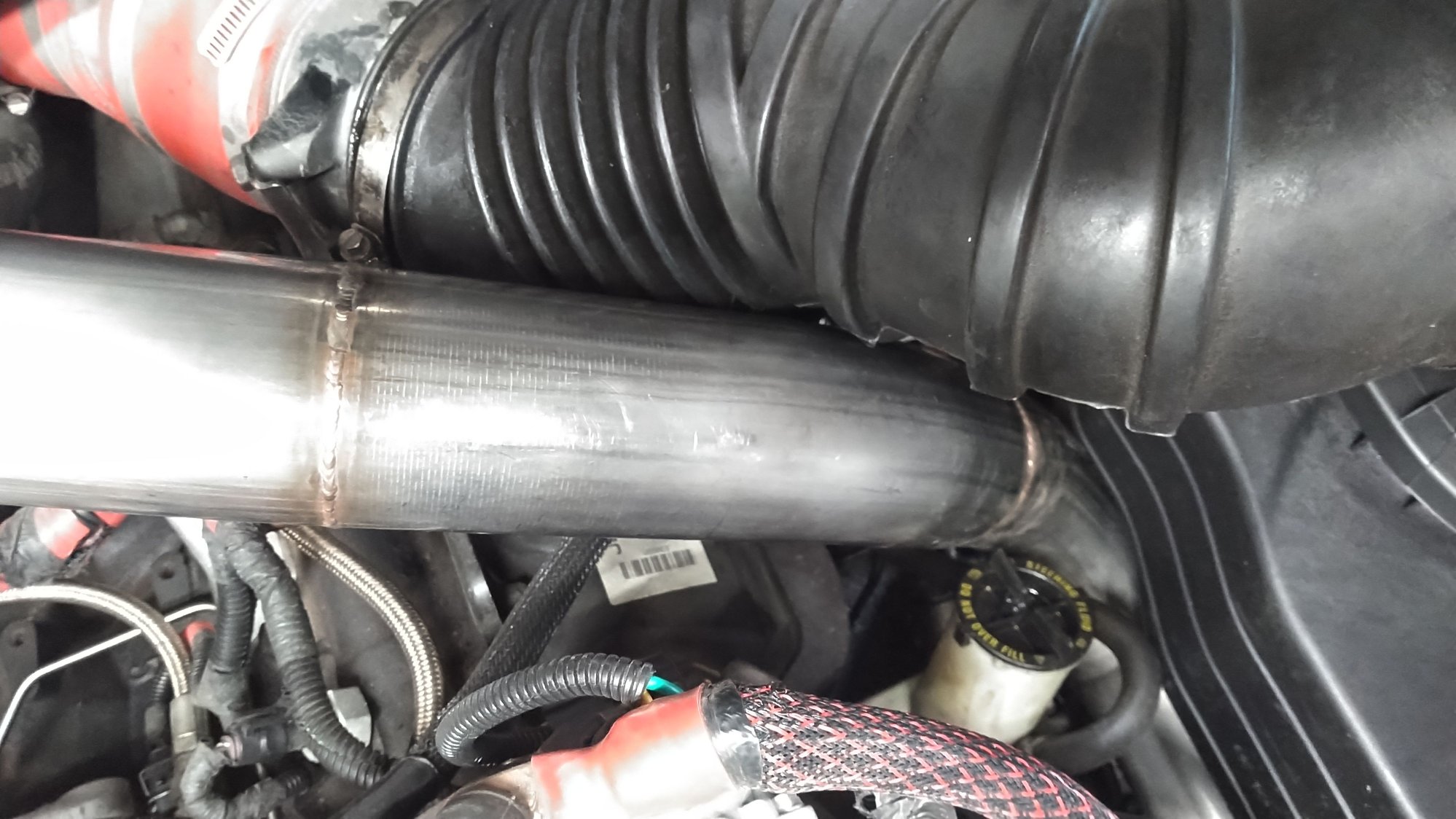

This is posted in responce to a pm.

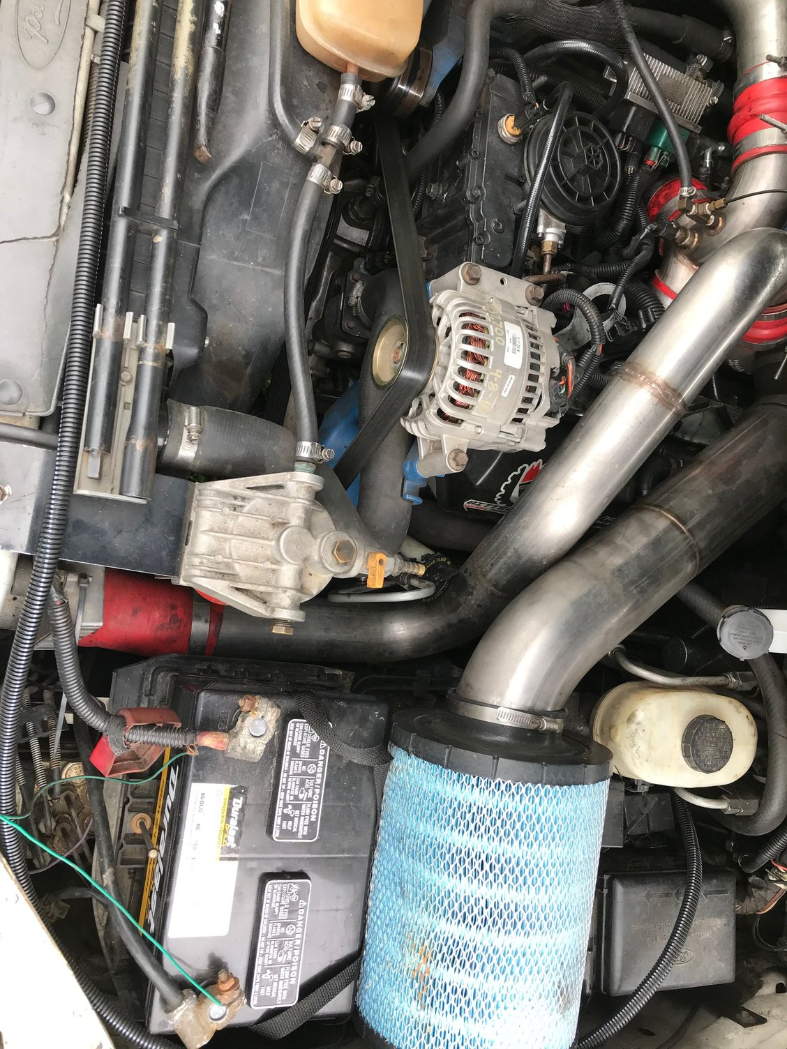

The irate hot pipe does not fit all that good with an ais, it is super close to the power steering cap <1/16" and still rubbing the intake tube. It could be dented a bit to clearence it, but it seems like a future rub issue. Maybe it would fit with a remote ps pump reservoit like a saginaw kit..., That is why I have hung onto the irate pipe.
The csd hot pipe below is a much better fit

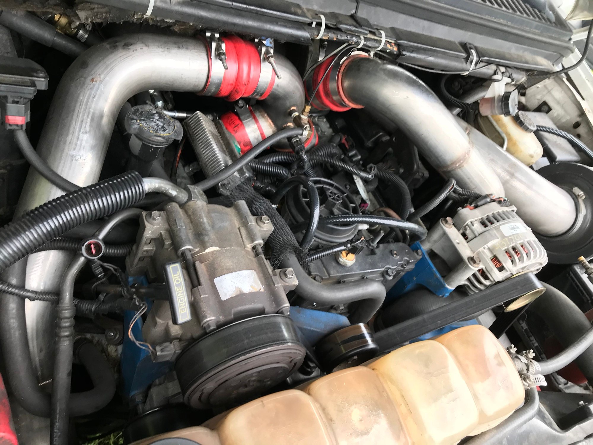

My (very old) Irate Kit.
