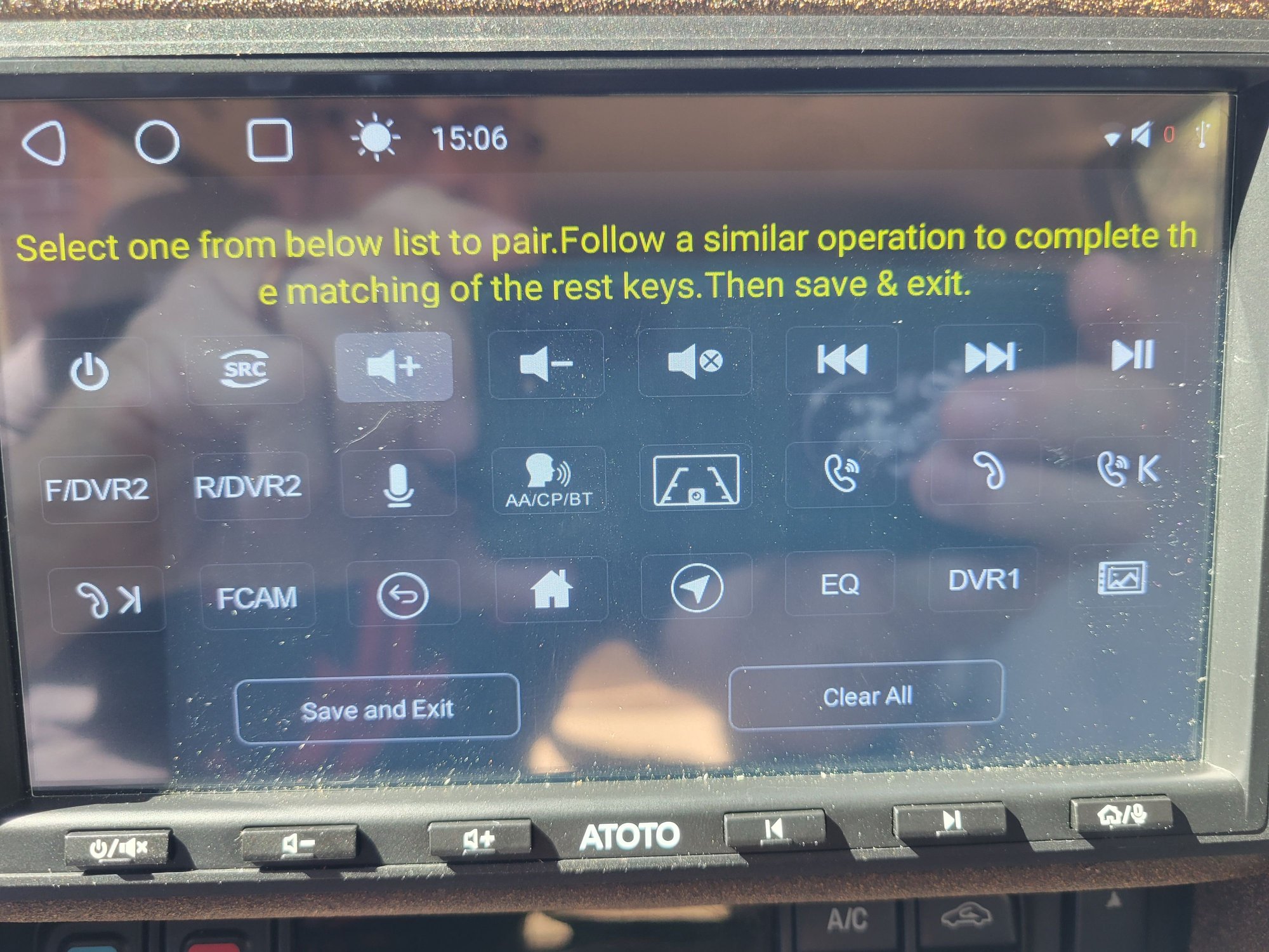

I just got mine installed the other day and got my steering wheel controls to work on my 2005. Hook up the Orange/Black Steering Wheel Key (+) wire to the Blue/Red wire in Pin 18 on the factory harness. Then, go into Settings and then Default Settings, then Steering Wheel Controls (these names may be slightly different, I don't have the manual or radio in front of me). Then, make sure to press the RESET button, it will not program unless you press the reset button. Then click the button in the radio you want to program, such as volume up, it will flash, then click the volume up button on the steering wheel. The icon on the screen will stop flashing and have a little corner marker on the icon. Repeat for all other buttons. Worked like a charm on mine.
Thank you. I did as you instructed. (Does the blue steering wheel key need to go anywhere, like ground?) I got to the attached photo and then another screen saying to press and hold the steering wheel button. It stopped there with no success. What reset button do you refer to? Thanks.
I have the Pro A6 and my screen looks different. Did you try the clear all button on the bottom right? You also have to hit save and exit before they will work.
I did not hook up the other steering wheel #(+) wire. I just hooked up the orange/black one.
several times on the clear all. I did try the save and exit. Freezes on the press and hold steering wheel button to program. Thanks for trying to help.
On mine it was just a short press, not a press and hold. Not sure if that matters. What truck do you have? I’ve read elsewhere that both wires work the same, maybe try hooking up the other one?

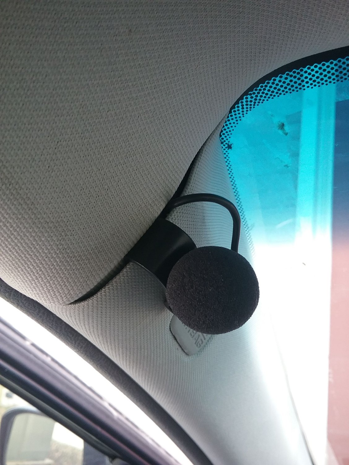

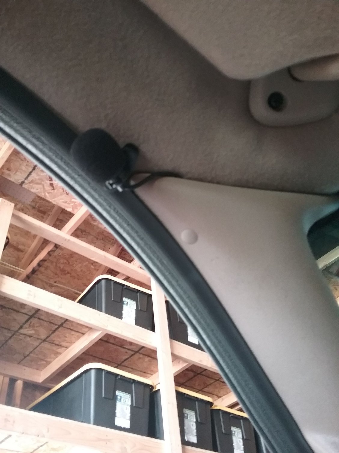

SOUS, I had already installed the included ATOTO microphone on my A-pillar. I ran it up the pillar but then clipped it on the door seal next to the pillar. Wasn't a huge fan (as I know you made a custom clip to work). I pulled the clip off the wife's car and tested it on my pillar. Works 1000 times better. So I ordered the same style for my truck. They are cheap on Amazon from like $10-$15.

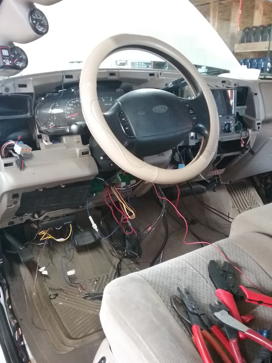

This is the link to the one I purchased on Amazon since I didn't like the aligator clip style for my truck. Pictures posted below of the ATOTO one installed on my A-Pillar (actually, wire run through A-pillar and clipped on the door seal next to my A-Pillar). It is mostly clean, but I wasn't huge fan of the clip. So I tested the style of clip that my wife has in her car (also pictured). It clips nicely on my A-pillar and looks much better IMO. Just waiting to receive the new microphone.
Amazon Amazon
Other picture is of my dash all torn apart. ATOTO is mostly done, but I'm installing an auxiliary fuel controller, fuel gauge, AirLift airbag controller, and F650 manual dash (pictues to come when finished). I'm also trying to tidy up some of mine and my friend's old work from installing tow mirrors and gauges. We were working on his and my truck at the time. So I think we did some things the speedy way and not the best way (like too many tap-in splices). I hate those things. So I'm trying to remove those wire taps and switch to spade connections where possible to tidy it up.
