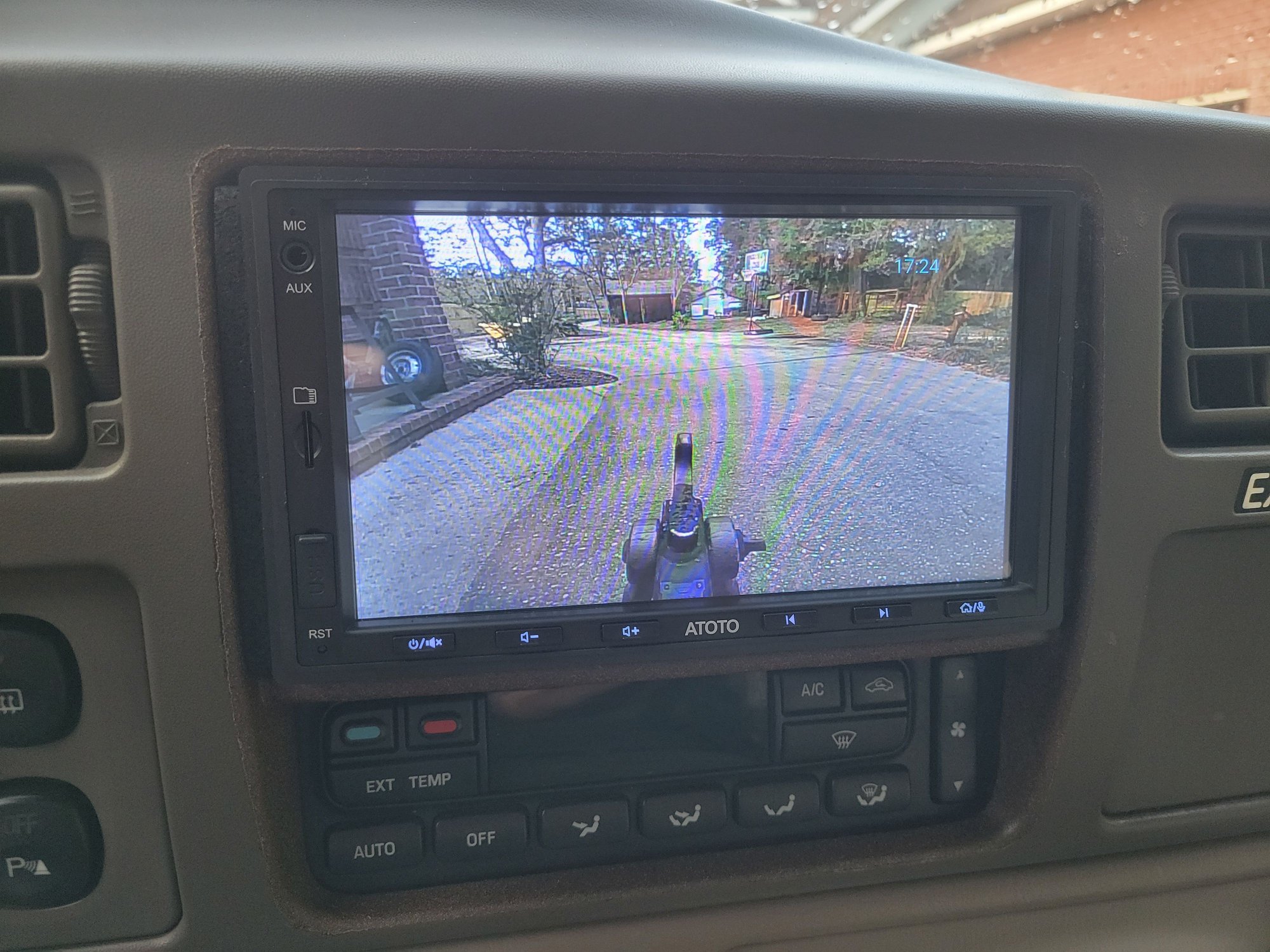

Put the steering wheel audio control on hold for a minute. That might help something come to mind. On the backup camera subject. Atoto camera power wired to power antenna lead, all other connections as per atoto camera instructions. I.e. triggered from reverse light signal. Camera works with shift into reverse as well as when selecting pre-installed rear camera view. Photos attached showing differences.
Selecting reverse gear.
Selecting rear camera view from head unit. S8

I simply have the power (12v +) wire for the backup camera wired to the "accessory on" 12v wire in the back of the head unit. There are two 12v + wires to the head unit, as you likely know.
I used the accessory on and simply push the auxiliary input app button when I want to view the backup camera. Running the 12v + wire was easy as I needed to run the RCA video cable to the head unit anyway. I used some wire loom (as I normally do) and ran them together.
So, the backup camera has power all the time, when I want to view it I push the auxiliary input app button. I used this method a lot when we had our travel trailer and I didn't like having the truck in reverse when my wife was hooking up the trailer to the truck.

To clarify my install of S8 standard. Camera to head unit via rca to rcin port. Camera to negative of backup light via black wire and camera to plus of backup light via pink wire. CAMERA POWER (RED WIRE) TO PWR ANTENNA, (BLUE WIRE,). Works as previously described.
Can't figure out steering wheel controls yet. Somewhere I read a post explaining that no additional "black box" needed.
