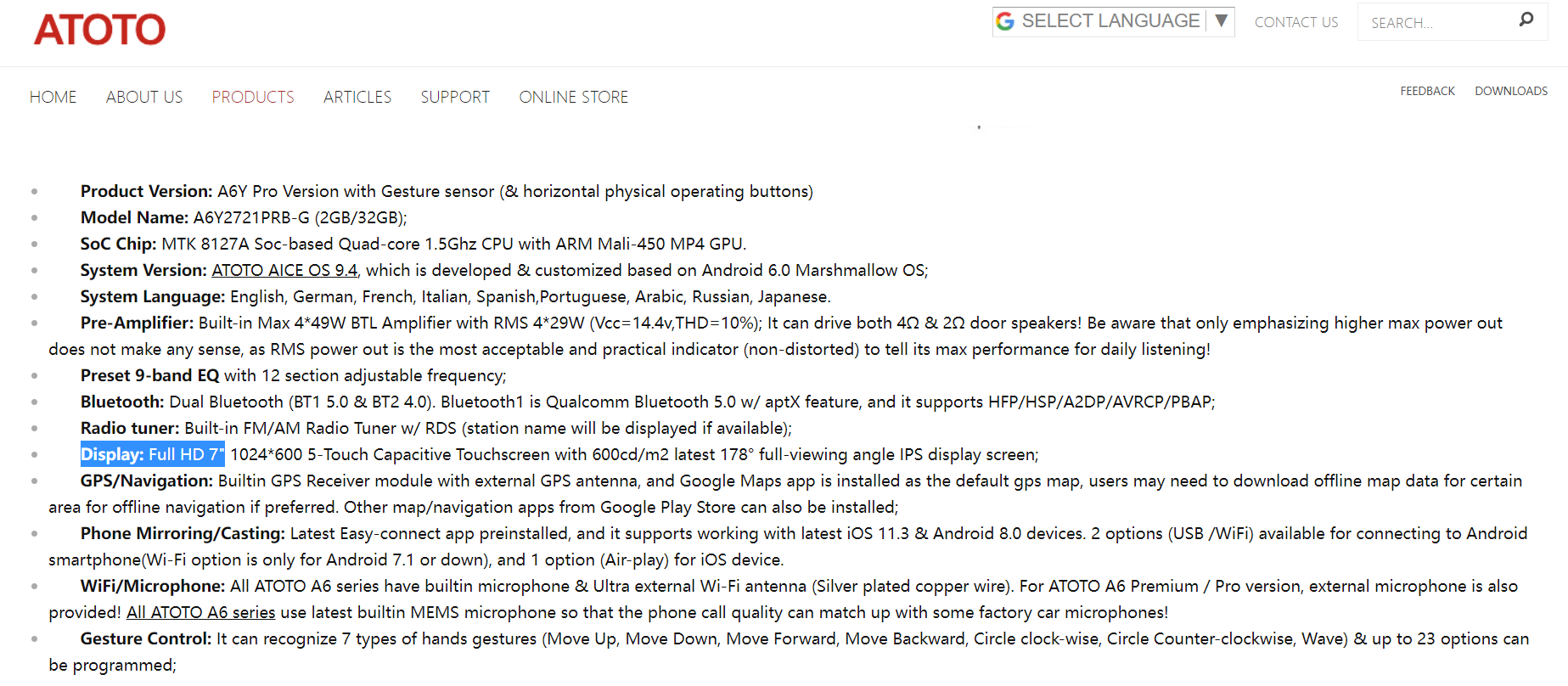

There are so many model variations between the A6 and S8 that I will provide a snip of the EXACT model I bought.
Then, taken directly from the ATOTO website, the model number is the second line and the screen size is highlighted.
Image source = https://www.myatoto.com/index.php?m=...catid=15&id=41
Again, there are several variations in models, just be sure you have the right one in mind when you hit the purchase now button.

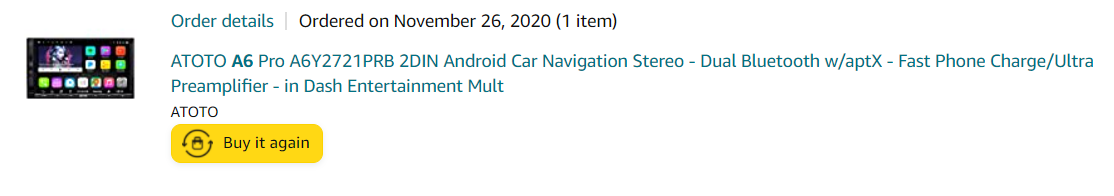

Tristan, I don't see the one I bought (A6Y2721PRB) listed any longer, but the A6Y2721PRB-G is the same head unit, with a "gesture" control feature. I bought my head unit for $200 when it went on sale last November for a Black Friday sale.
There are many, many options out there that are branded other than ATOTO as well. I went ATOTO because I thought I was going to use the dual bluetooth receivers, but I ended up going with a USB adapter for the OBDII port instead.
A6 Pro A6Y2721PRB-G link
You might try Ebay or ATOTO themselves as well.
