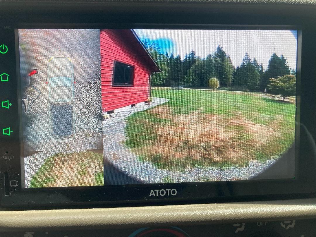

Thanks for the tag on this Sous, and for the backup cam trick, Mark.
I wondered if the virtual bird's eye view could be disabled when needed. I have had good luck with the virtual view by putting in my truck dimensions in the calibration mode slightly larger than actual, so the truck outline in the view is bigger than actual, providing a buffer.

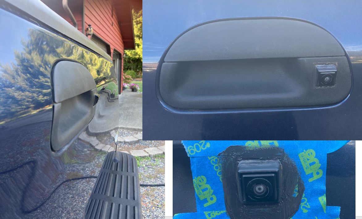

I've had to play with camera placement. I still cannot see the lower left and lower right corners of the backup view due to the tailgate handle keyhole mounting position - I need to modify the mount to extend the camera further through the handle so those areas are not cut off.
So far, the S8 has been stable and workable, though it has "taught" me how it prefers to be used at times. I'm sorry you are having trouble with the back button and having to do hard resets - that would not be acceptable to me either. If asked, I'll continue to recommend the A6 to folks as the most stable version of this product line for these trucks. I have threatened to pull the A6 from the Yukon and use it in my truck, but my youngest son drives that rig and would rather it stay put.

Spent some time today repositioning the ATOTO rear camera through the handle to expand the field of view, and also see the hitch for fast hookups.
You do trade a somewhat distorted rear view for the virtual birds-eye function, given the fish-eye lens on this camera model. I still might try the full view code you provided, Mark, if this modification does not work out.
The view is better now. Will try it out on the camping trip next week.

On the backup cam topic, the repositioned ATOTO unit worked very well.
