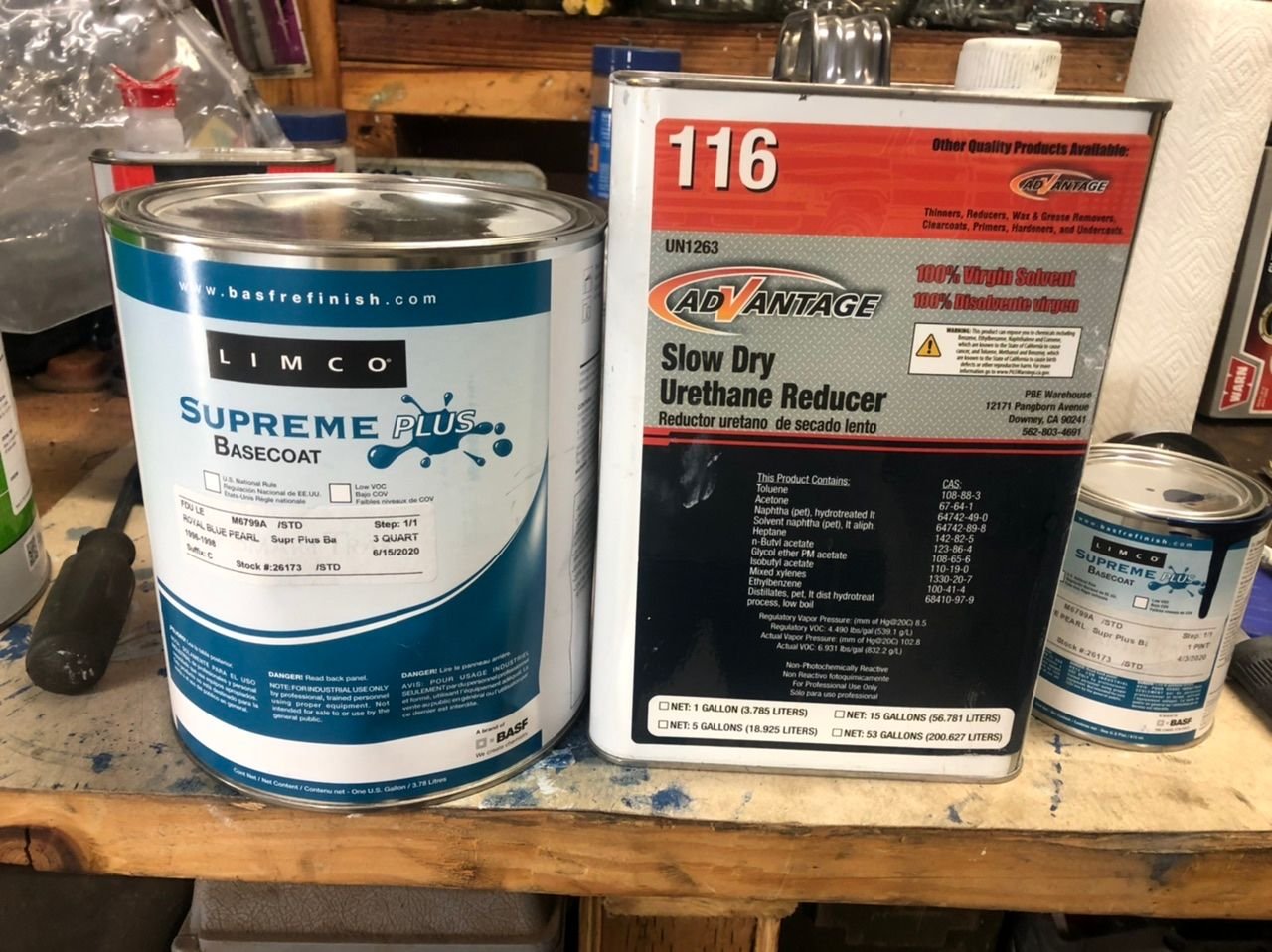

Two coats of base wet. This basecoat is one part color to one part reducer. Waiting for it to flash off so I can clearcoat.

The clear is 4 parts clear 1 part hardener
