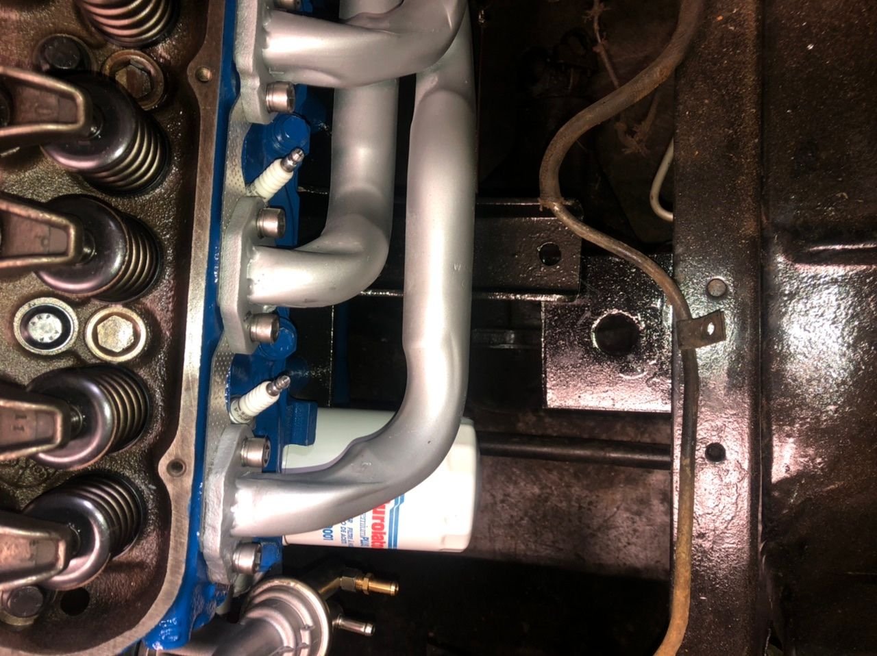

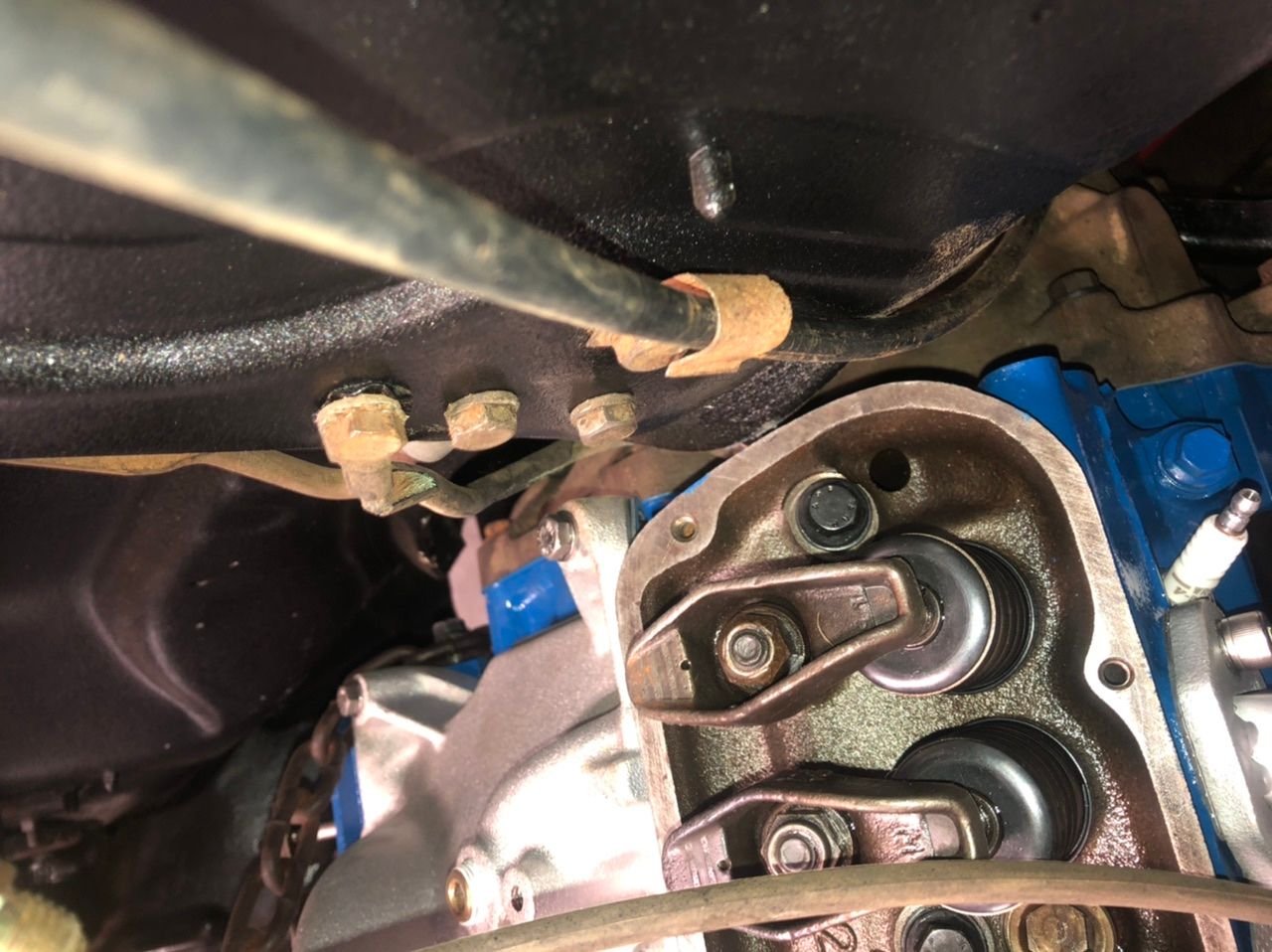

I am sad my headers wont work. I was hoping they would drop down behind the steering box... I have seen some discussion on the forums about the steering box being in the way with different combinations.

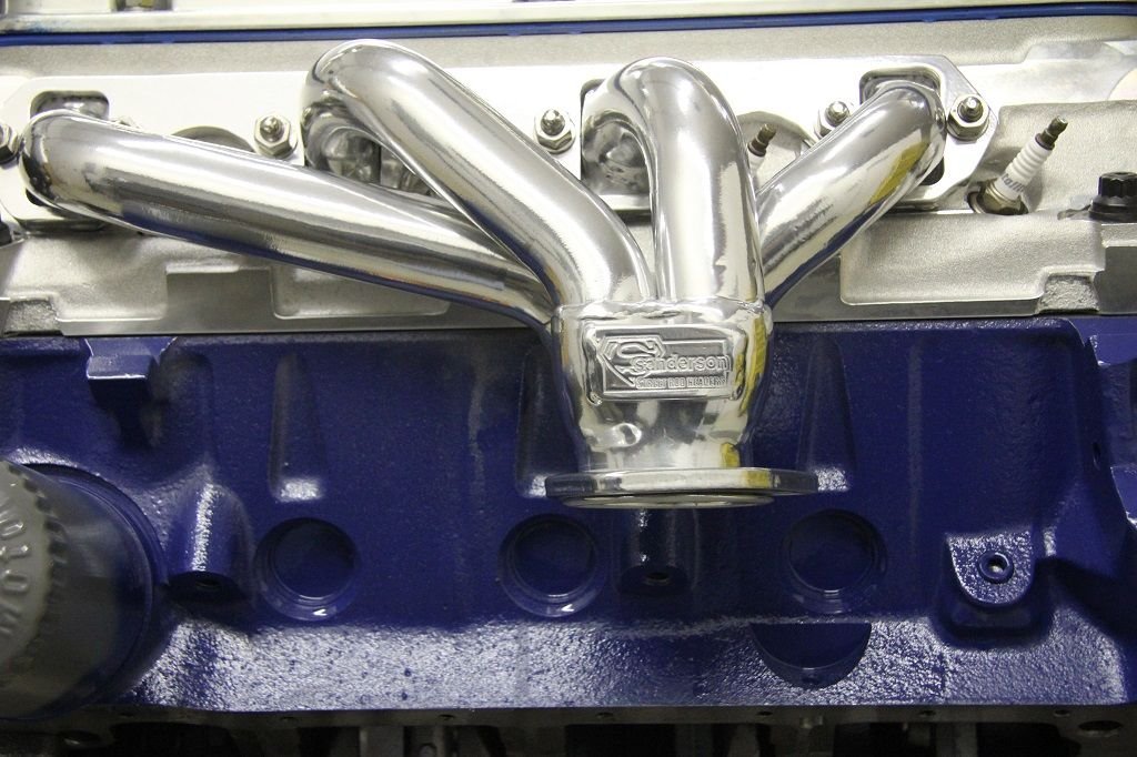

I was going to use the Sanderson headers shown in the below picture. I think they are model #FF4.
Something like these might work for your application.
Do you know how far off the block these exit? I need to also clear my clutch pushrod. It looks like I have the best clearance straight back and then down behind the steering box.

Originally Posted by JohnNewb
Would it be crazy to cut off the flange and extend down past the gearbox?
I need to come over 1.5” towards the drivers side still. I need to be either over or under that chunky monkey box...
