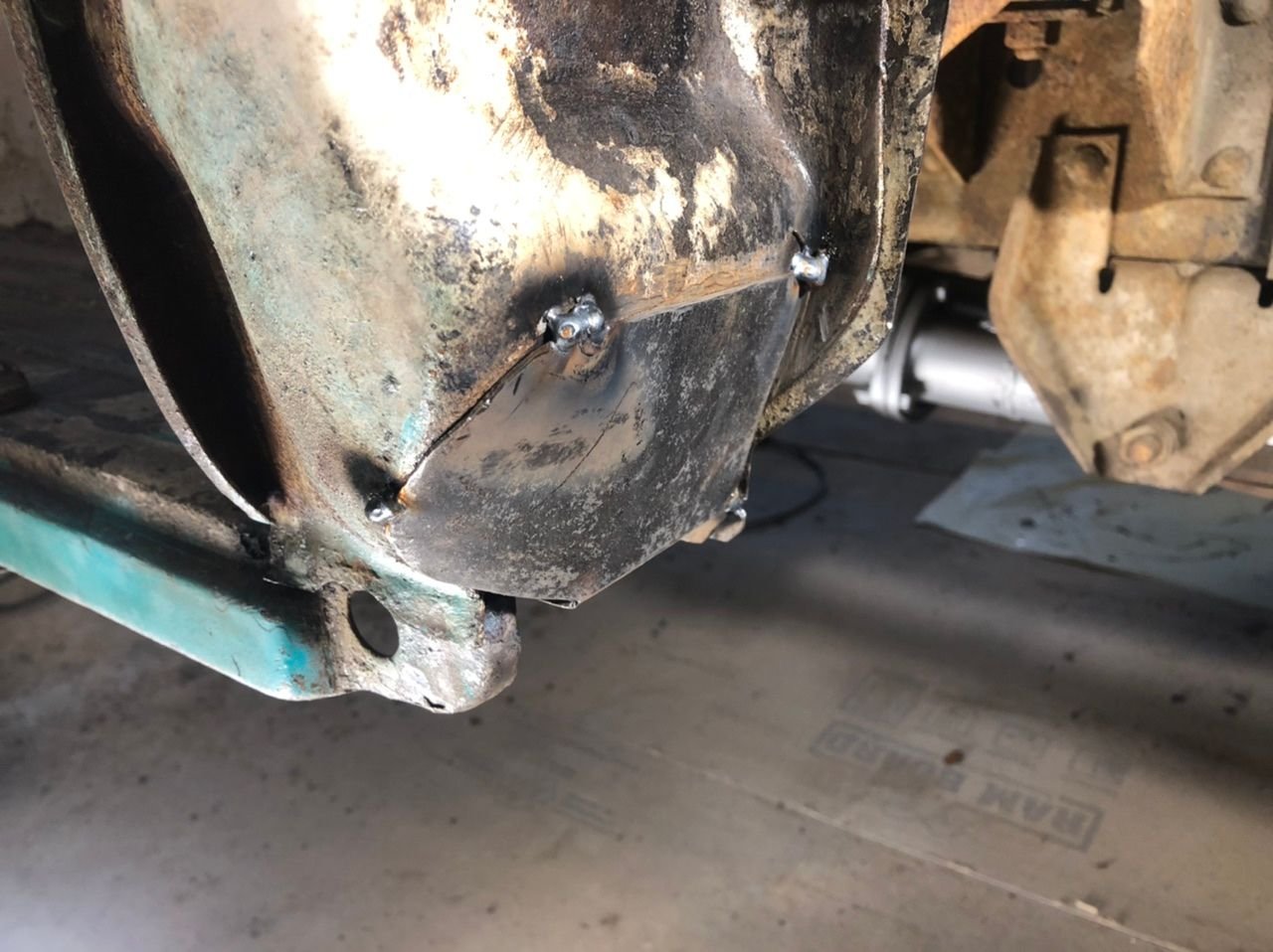

Skid plates
After consideration and smoking gears in my head, I have decided against the original Ford design at the bottom of the door pillar where there is a “shelf” to collect mud and debris thus a “rot spot”.
I have designed a one piece “Skid Plate” to let the mud and water roll off cleanly.
I will tack this in and bend it to fit the edge contours then fully weld the perimeter and paint for good protection.
The front meets the center of the rolled line and fits flush inside the rails for welding. Bottom view below. Once tack welded, I will attempt to roll the edge to meet the side curves and weld fully.
I already know Im crazy but go ahead and tell me why you see this as a terrible idea. Hurry though, Im welding them in Thanksgiving afternoon!

Front cab corners are now skidplate upgraded!

Shouldn't all 4WD's have skid plates?

Yes its usually a good idea.
