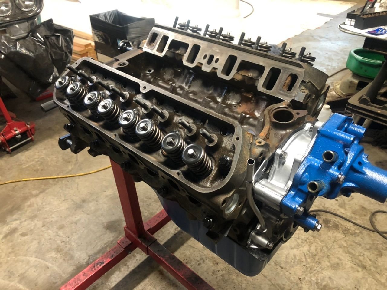

More progress today. I had to retime the cam because the crank gear moved a spline. I did time the marks right but the cam & crank timing was wacked! Glad I caught it during lifter installation!
Finally got those heads on! Had to chase all the holes- oil pan bolt holes, head bolt holes & timing cover holes. That took a while too.

Looks like my valvetrain geometry is good. Got the rest painted and rockers installed... The rest is just assembling so it should be ready to go in the truck tomorrow. Heart transplant almost complete.
