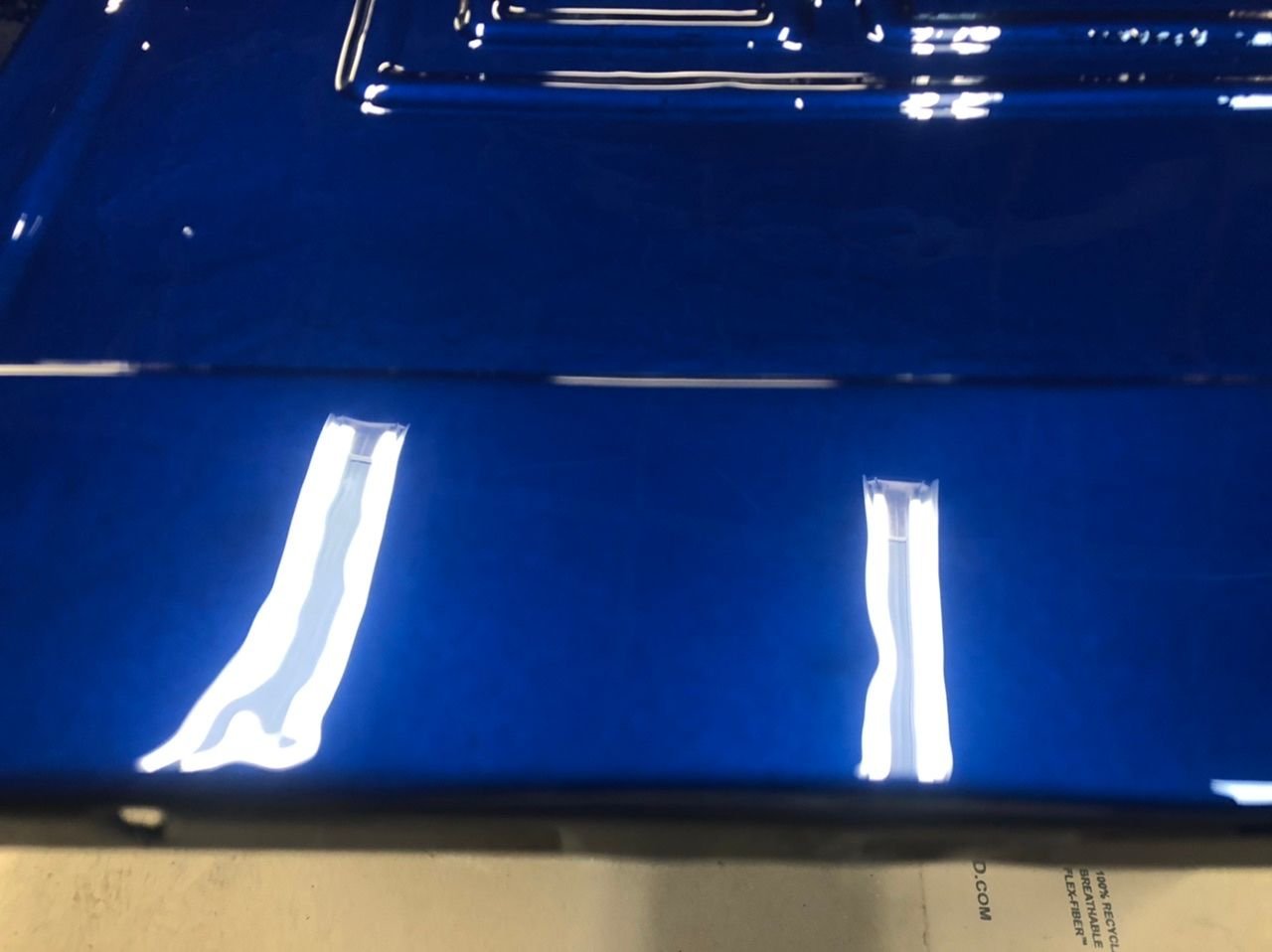

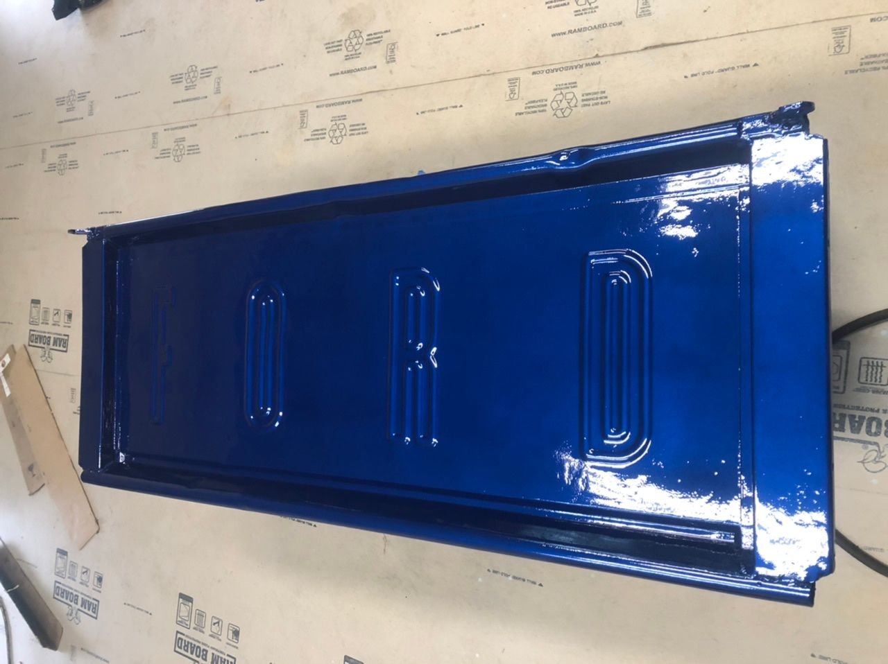

Im putting bedliner on the inside of my tailgate. Lets see if the color shows up correctly on the screen. Supposed to be Ford Royal Blue...
These shots are without clearcoat while its still wet. I have wrinkle near the letters where I used different primer ##^*%!
Gotta let it dry fully and start over... trying to decide to clearcoat it just to make the color decision and rework it after the inspections or not.

Wow! Glad I went ahead with the clear! Color changed!

Man, that is a nice color. You say it is bed liner? Looks pretty smooth. Is it extra thick? I would like to do the whole truck with that. My cousin runs hounds and his hunting vehicle takes a lot of abuse. He bedliners the entire vehicle but the stuff he uses is quite ruff.
Steve, thats normal urithane basecoat with clearcoat. I will be putting bed liner on the inside of the tailgate so only blue on one side.
