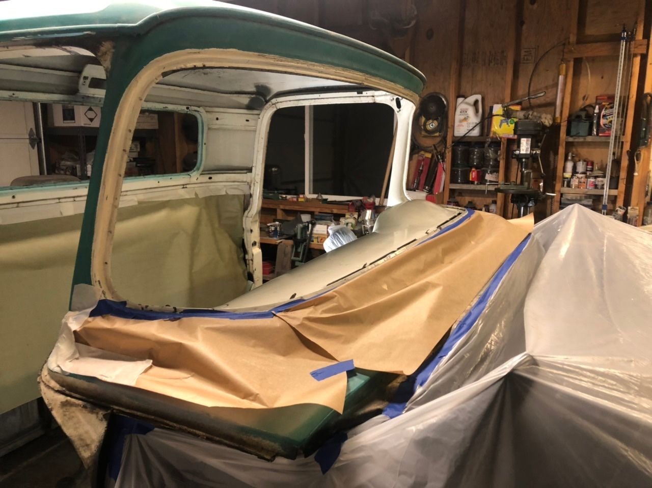

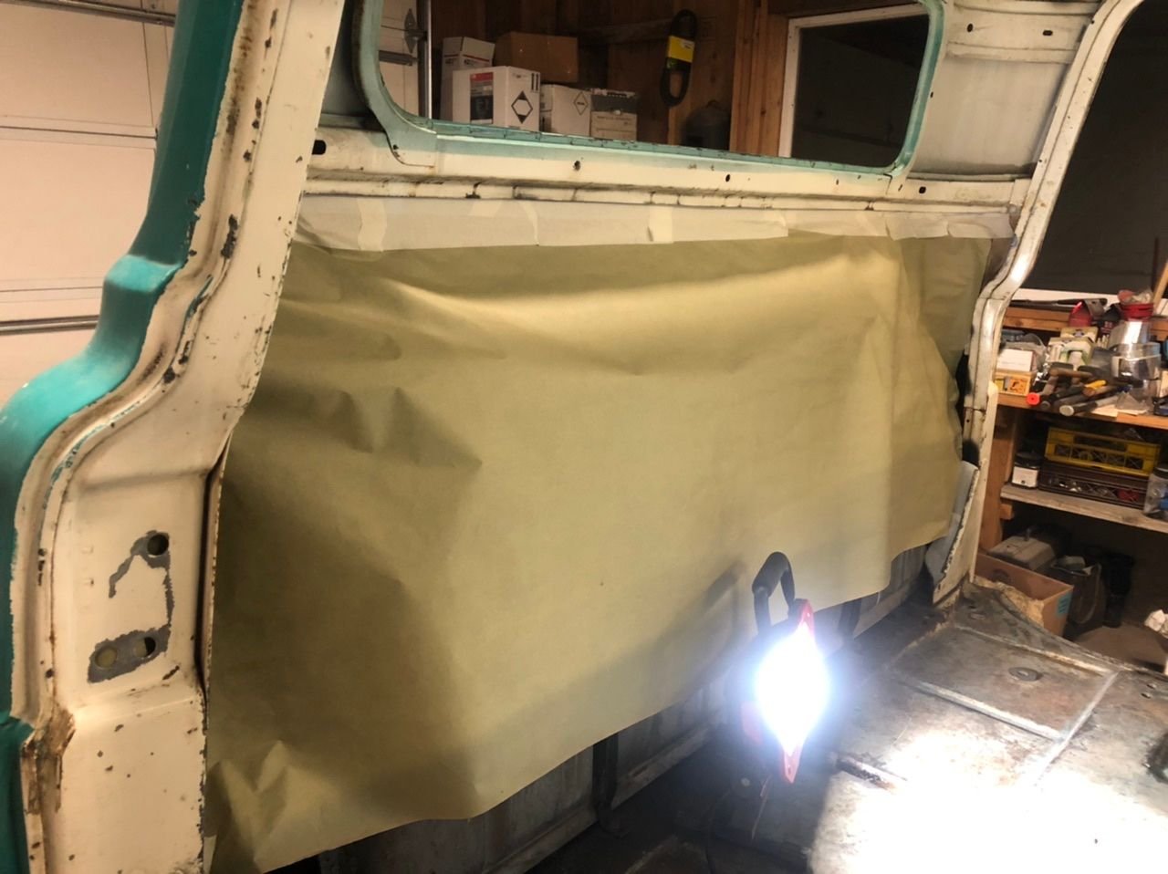

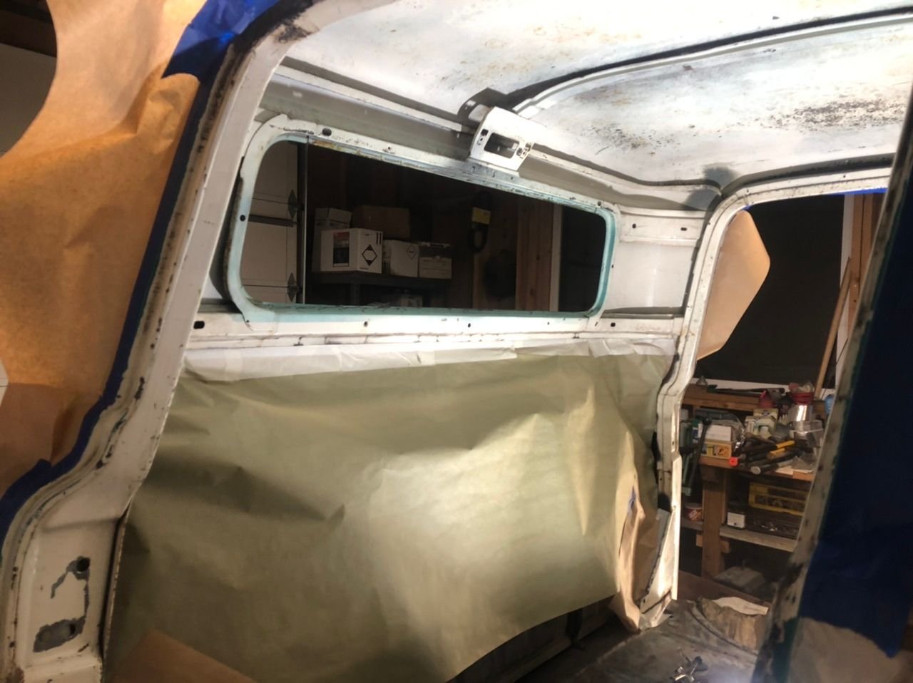

Has it been an eternity yet? I am sanding and masking...sanding and masking. This is probably why patina is normal! The vision I have for this project requires that I finish this beast. Lets make it one & done. New truck with 1960 styling is worth the $$, effort, and wait...
latest pics
Sanding all old finish with 600 grit
Dash needs more masking
Three tone interior adds time and effort to the project. Hope it is worth it in the end...

27-40F here but I have an idea to test.

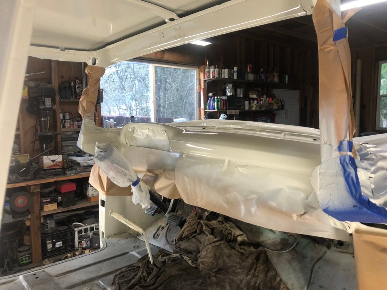

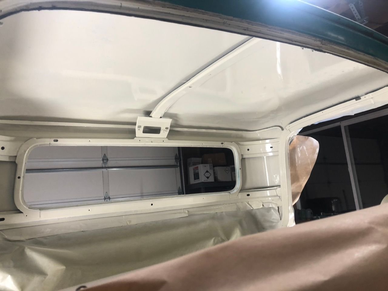

I am trying a test area tonight to see if heating the shop and only running the exhaust during the spray will cure correctly. If not, the test patch is behind the headliner anyway...

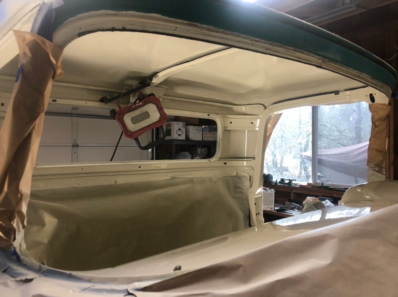

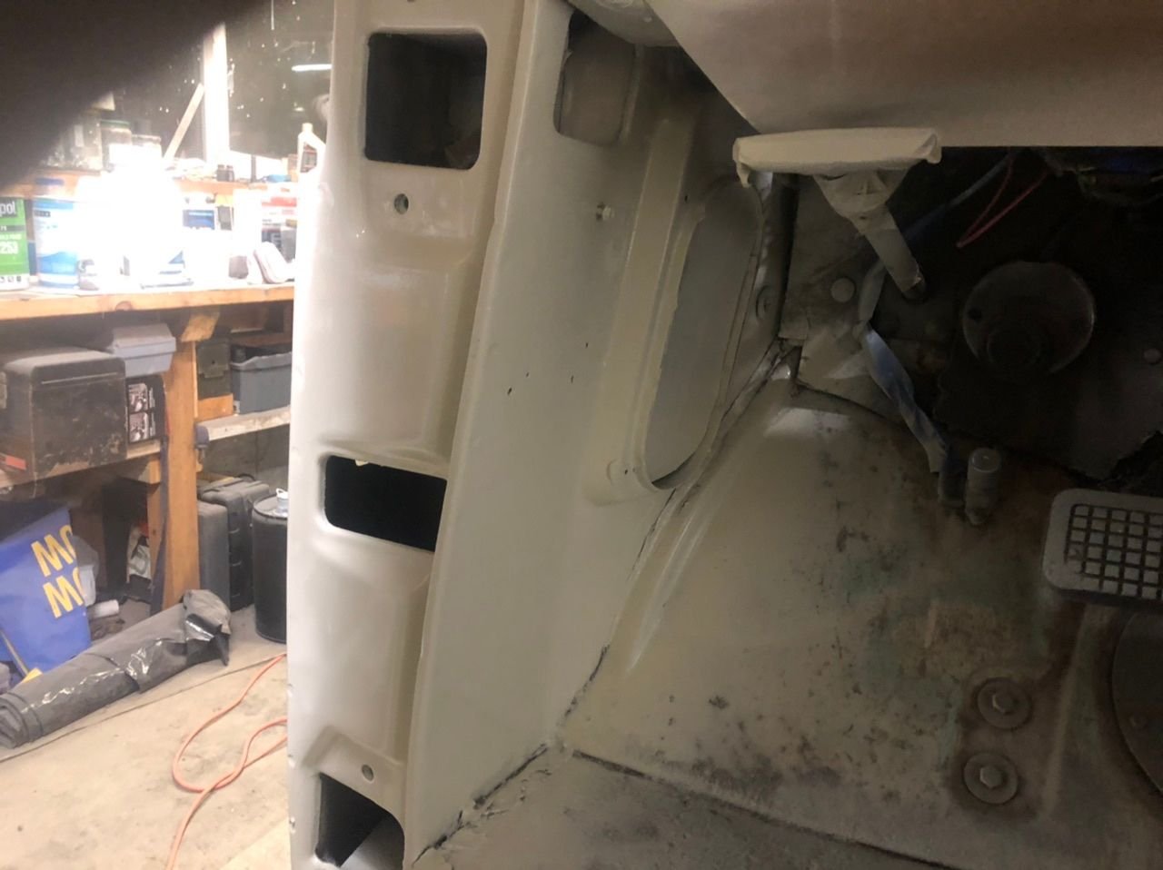

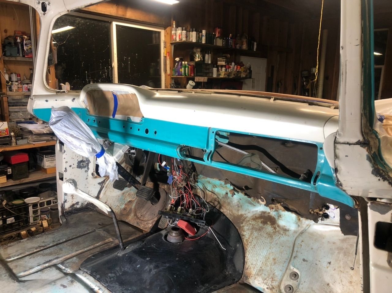

The Corinthian white is thinner than I anticipated. I will need to sand out some runs on the pillars and respray but the good news is my plan worked thus far and the paint is setting up and glossing correctly!

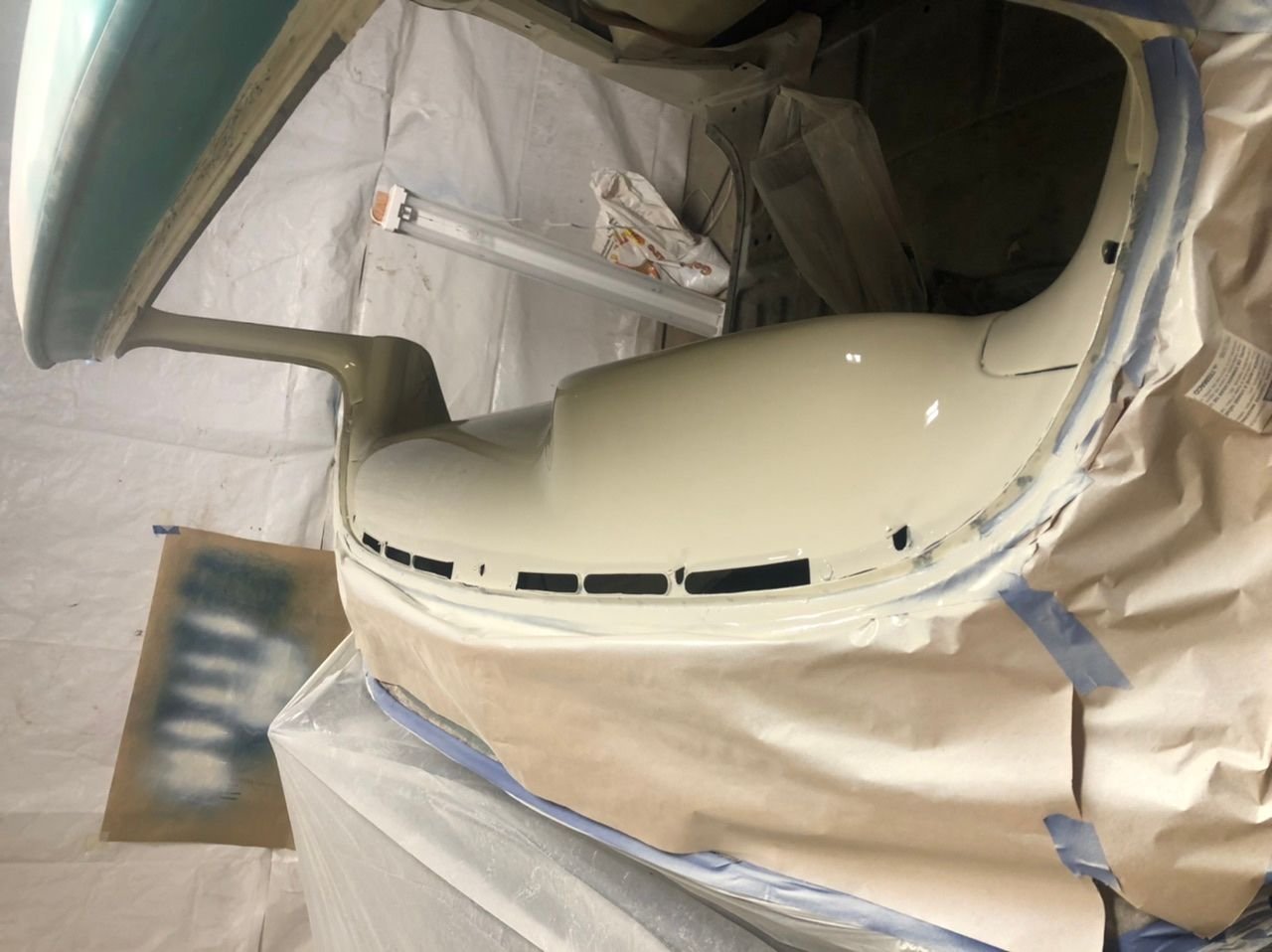

Today went better but even with my careful attention and gun setup, this paint loves to run on vertical surfaces! It flows too long (maybe temperature related) and is good at self leveling/running... I will sand and repaint the dash since it ran below the front edge. More progress...

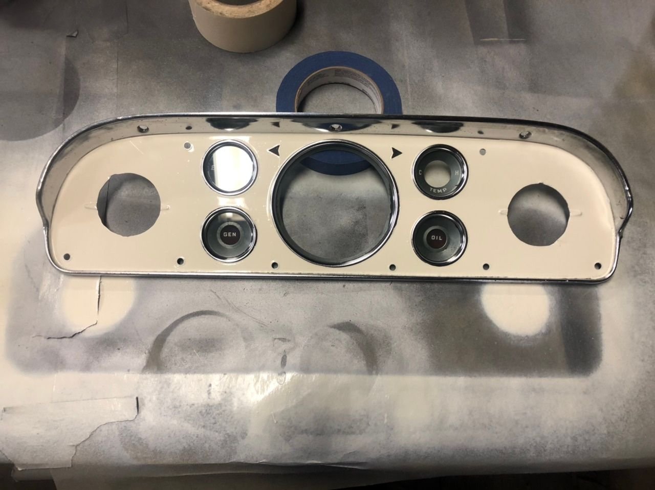

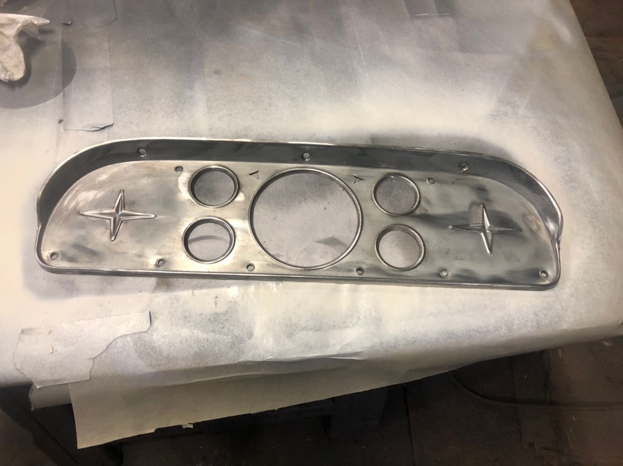

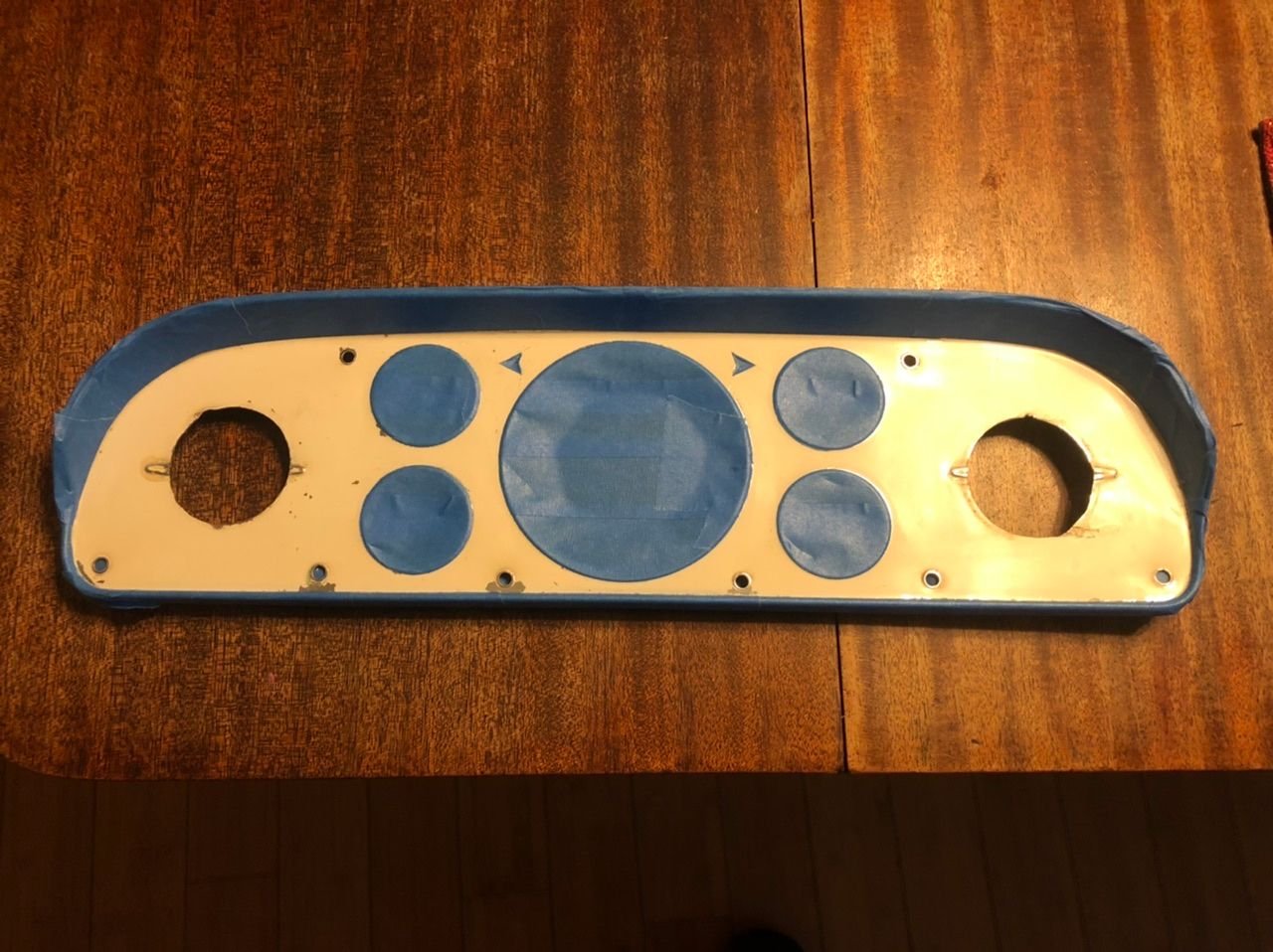

Spoils of War!

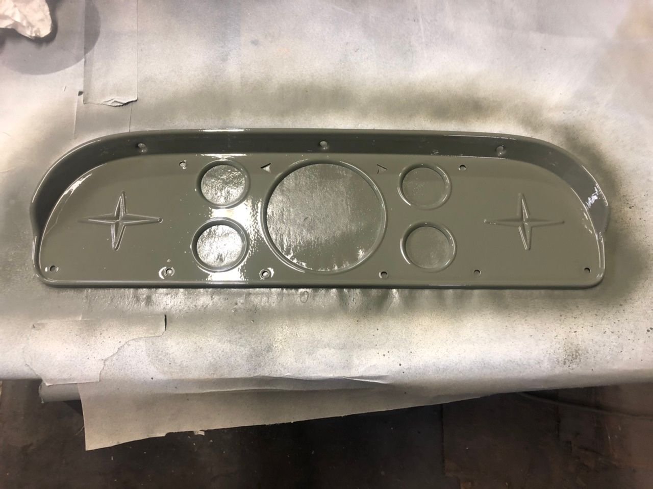

Red is benefiting from my project. In this case, the instrument panel had flaking Corinthian White. I stripped it to metal and etch primed.
When I do the next batch of white, Red’s instrument panel gets it too!

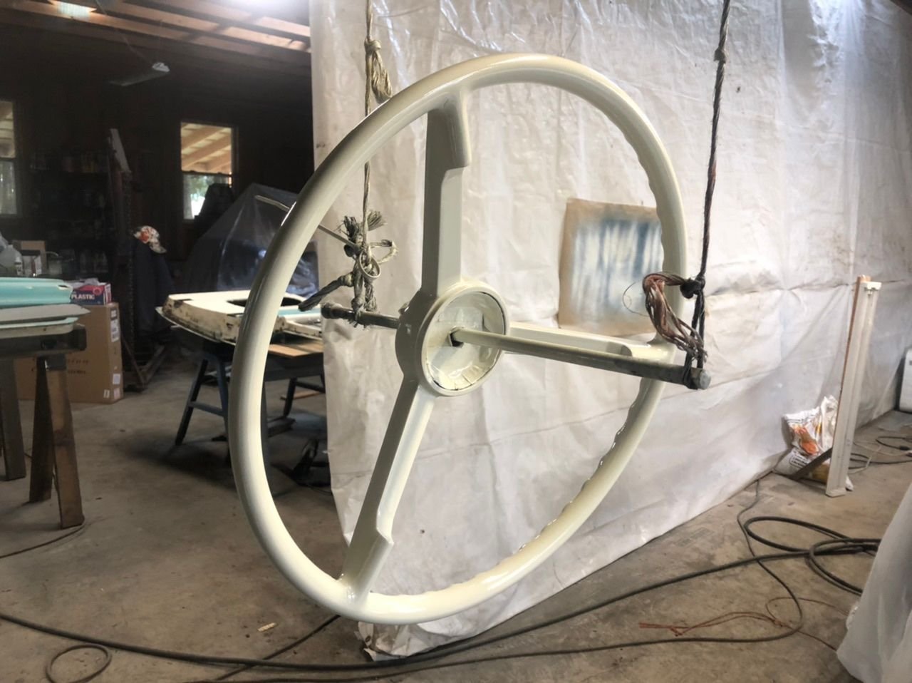

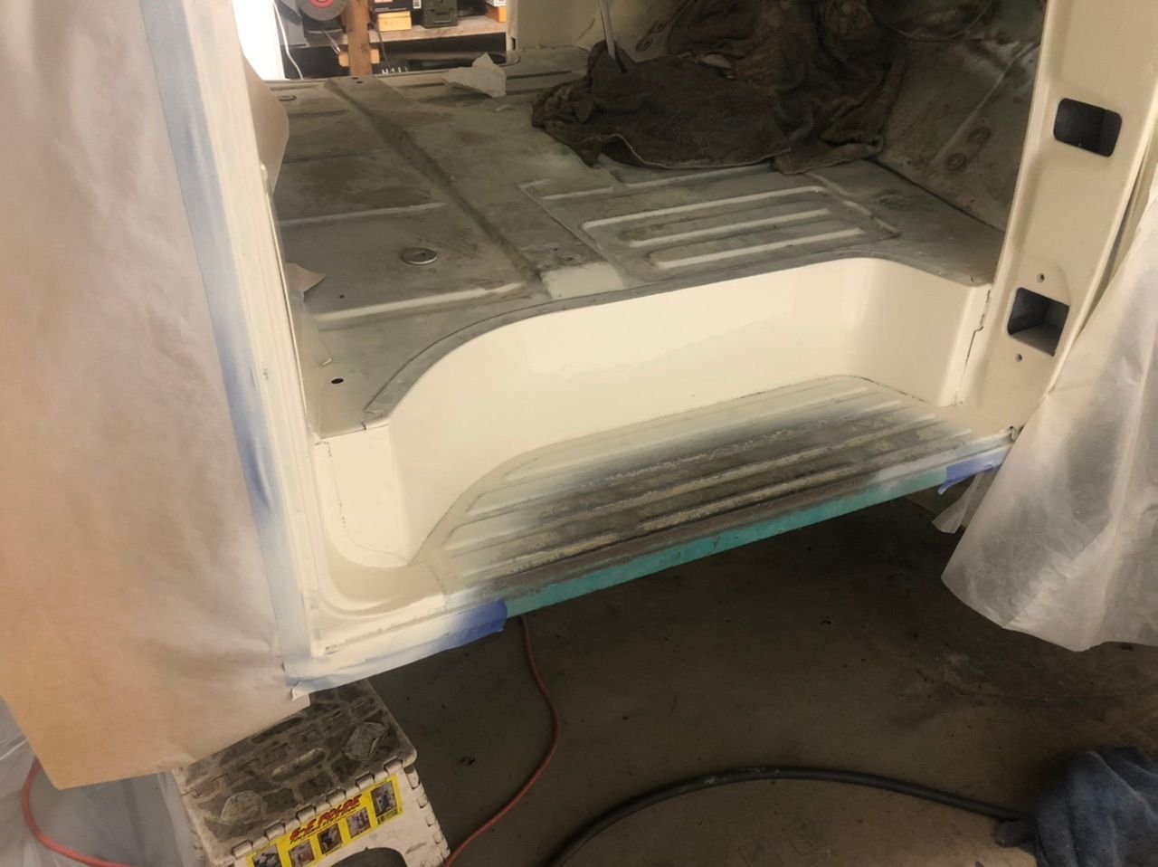

Now it needs to cure.

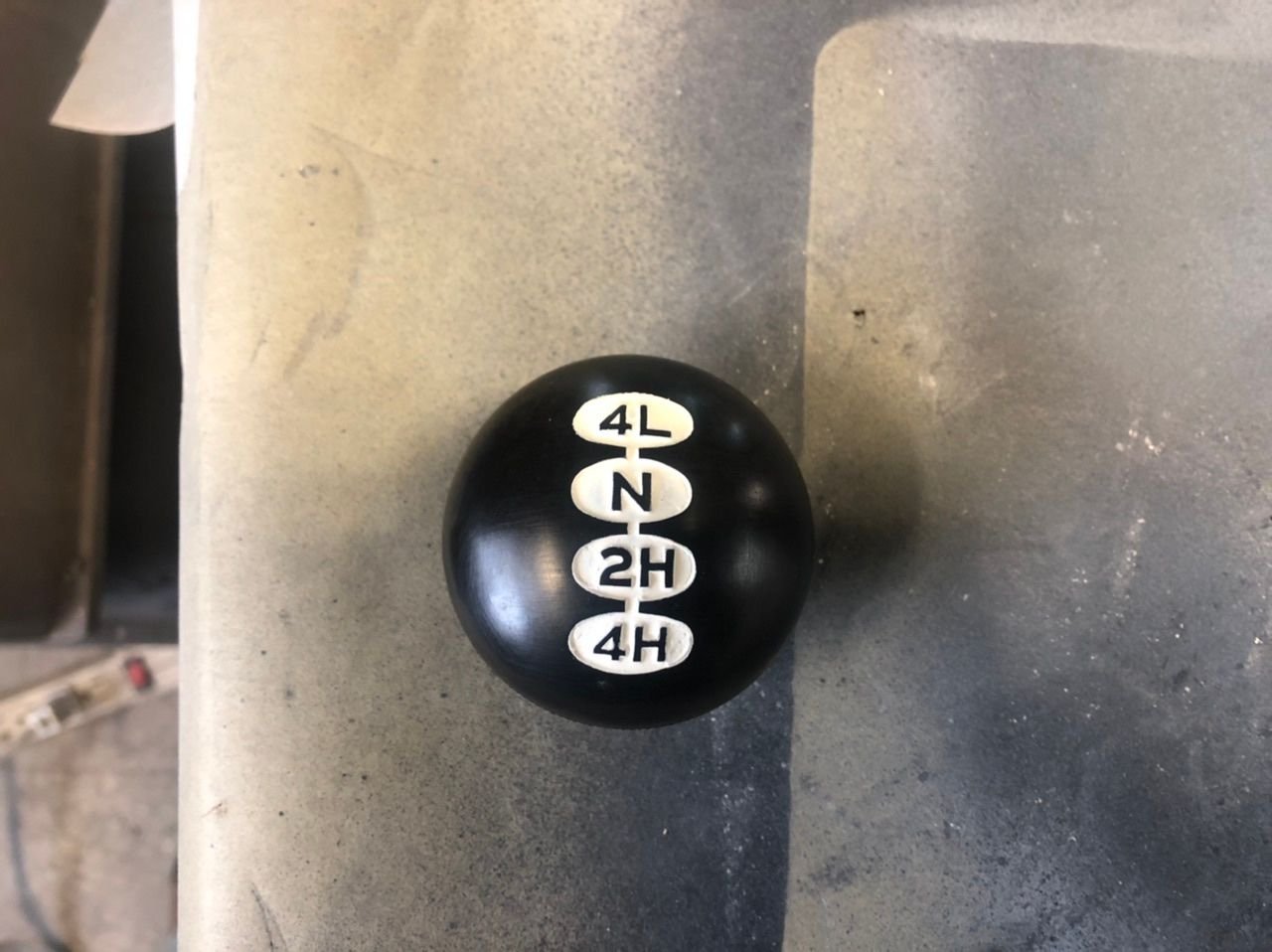

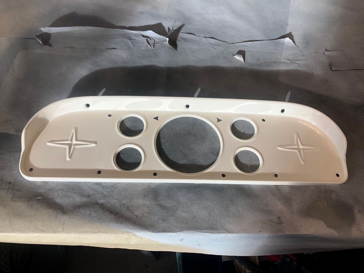

I have to let all the white cure and then can do the blue part of the interior. Pics of todays spraying. I like how the shifter **** came out and now have three coats on the steering wheel. Red’s instrument cluster looks great with two coats as well as the fuel tube,
Easier to read shifter with white background fixed
All coats on the steering wheel. It DDFD!
Spoil of war in Red’s favor...
Filler tube is DDFD

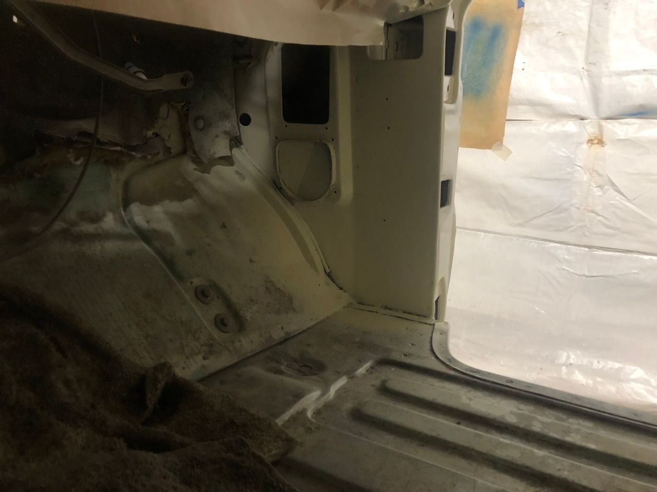

This was the last Corinthian White needed inside the cab. Doors have white after I complete the cab exterior and swap bays.
Not perfect (overspray in spots) but looks serviceable and not as beat up
