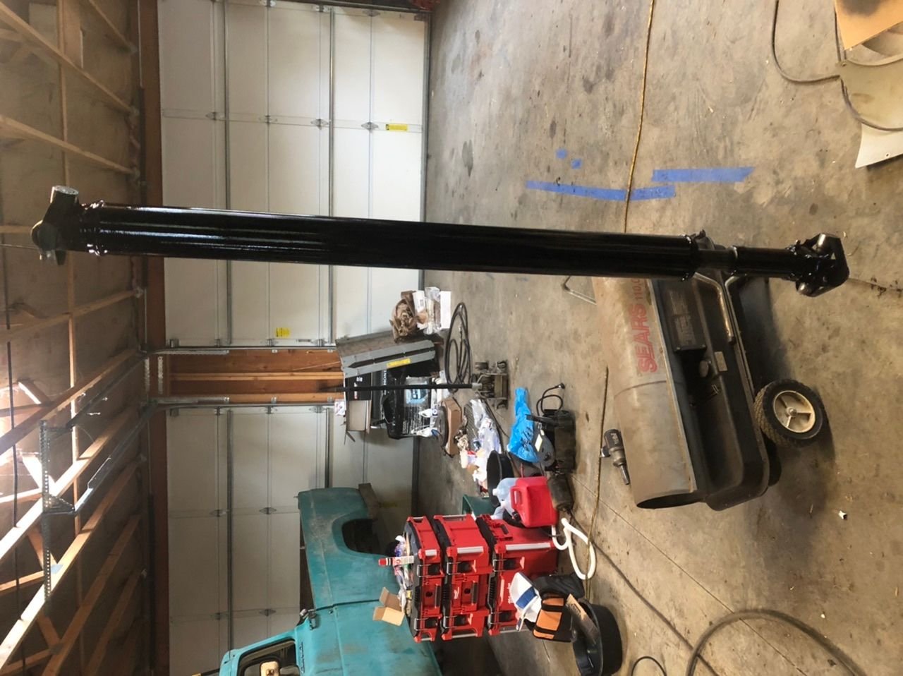

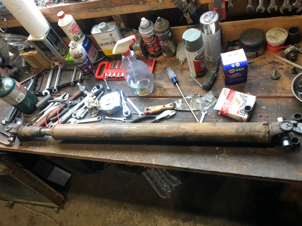

Front Driveline
The front driveline is getting a cleaning followed by paint today

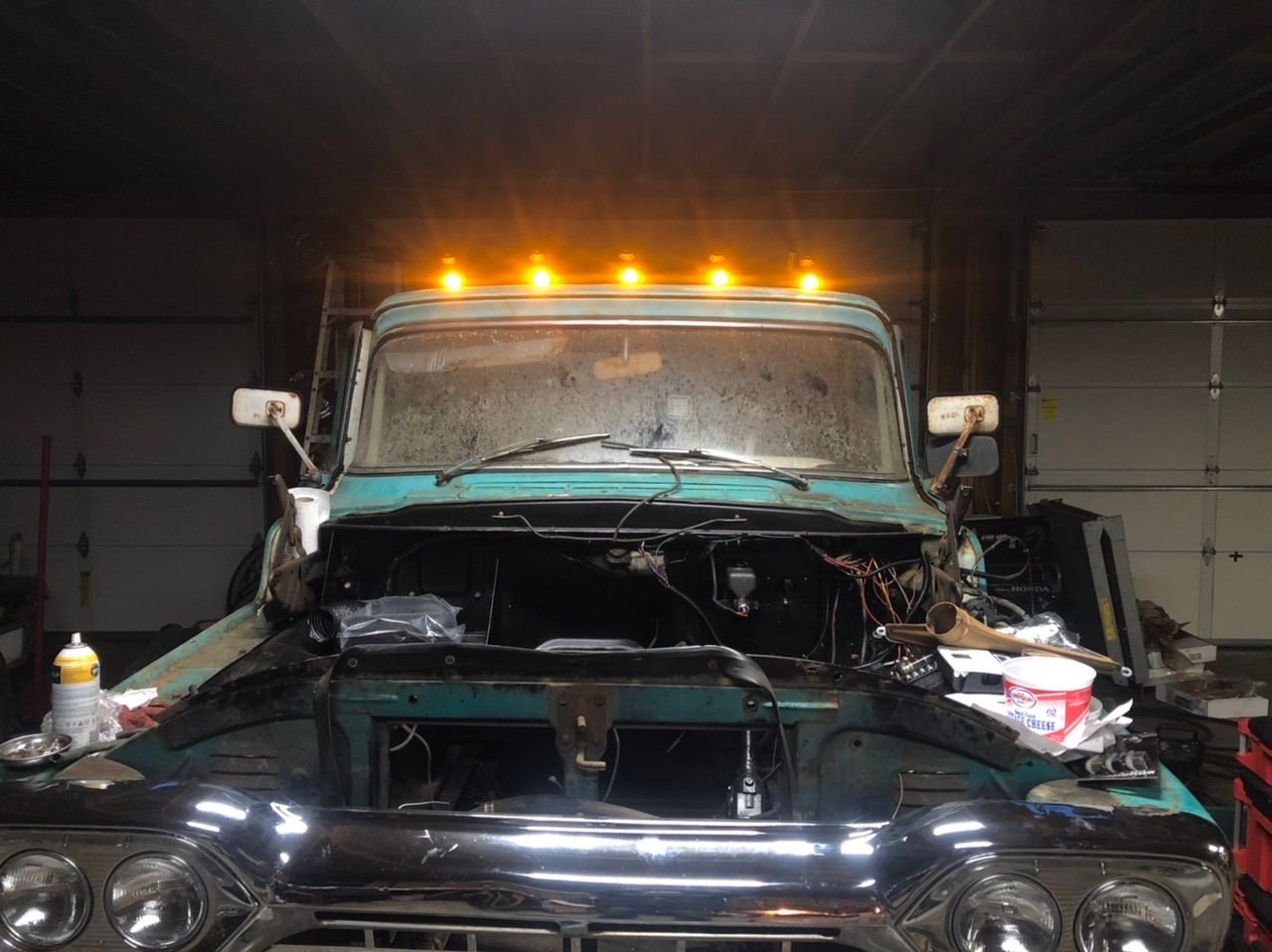

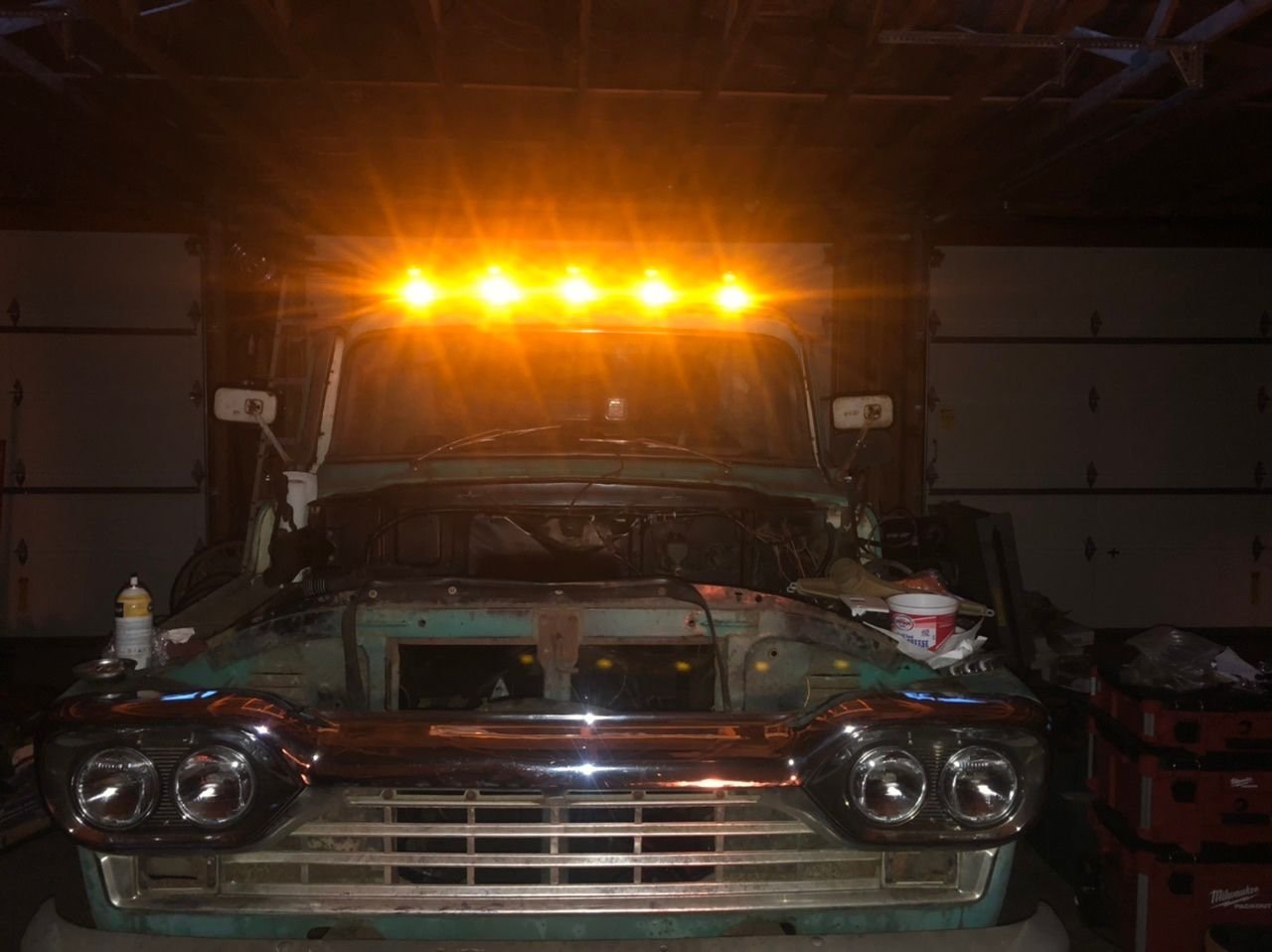

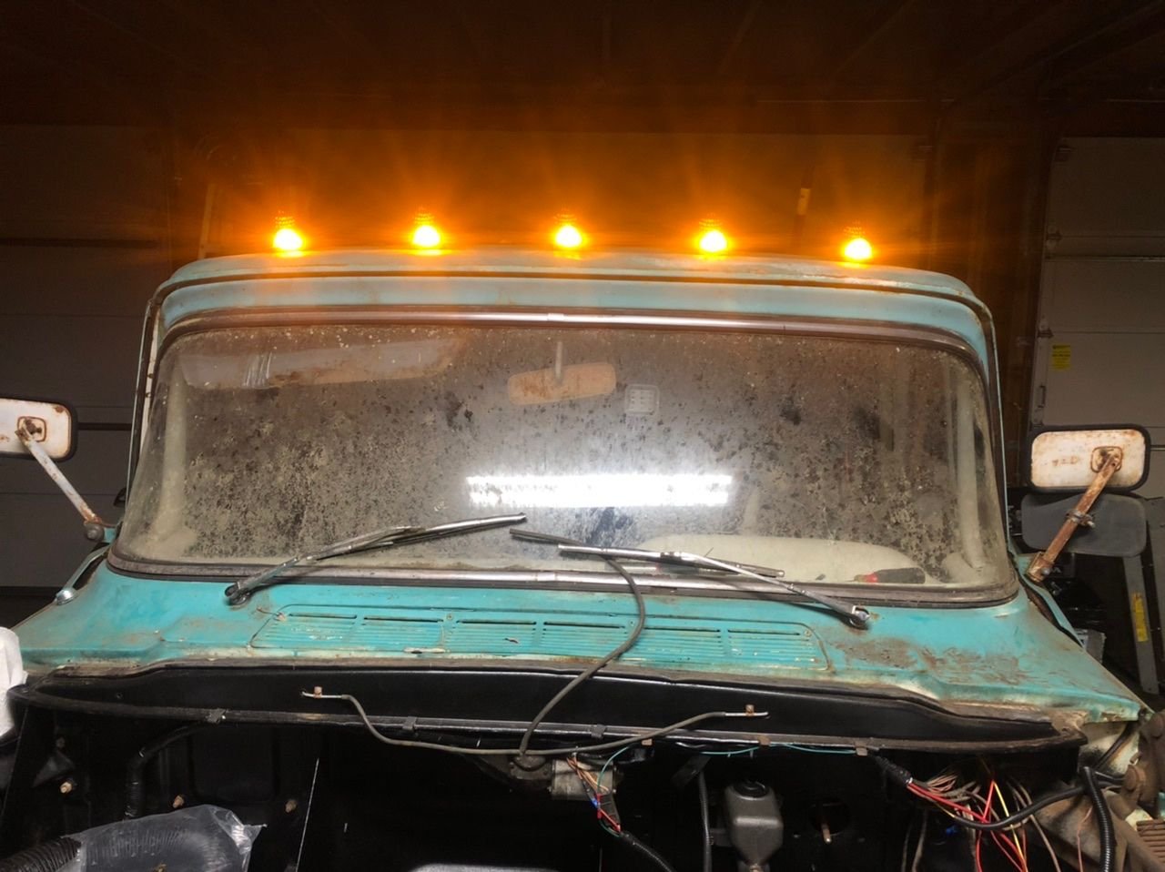

Cab Lights MOUNTED & WIRED
These took a couple hours but I like them! These are LED instead of bulbs so they should last lots longer with no contact points to corrode. They are bright too.
Those lites are amazingly brite!

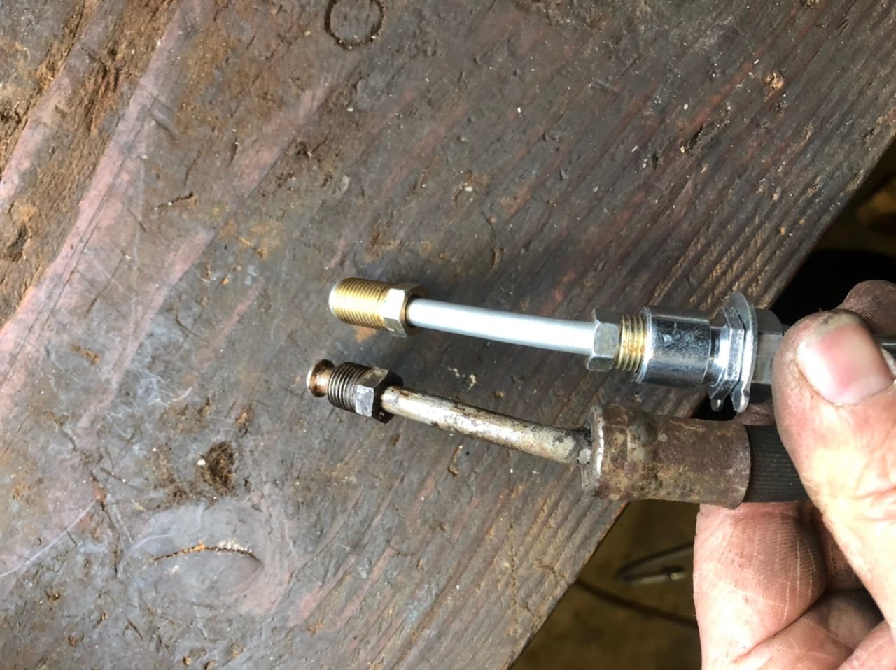

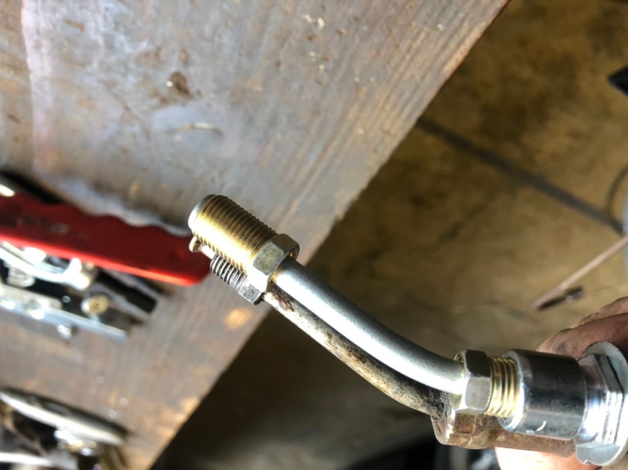

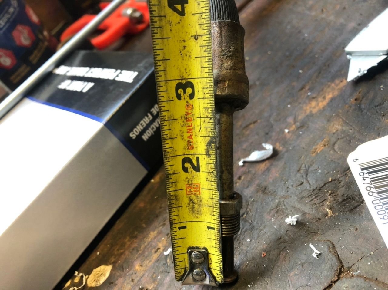

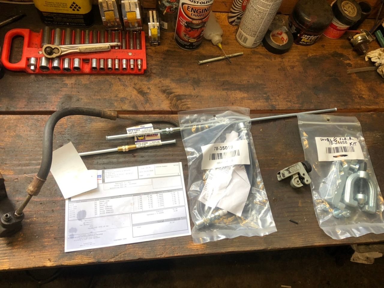

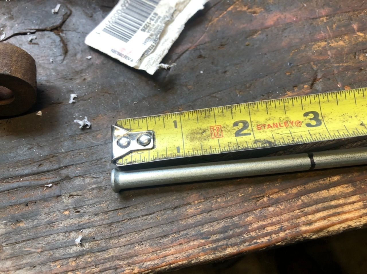

Made a new clutch hose (discontinued)
Bought three parts from Napa and simulated stock hose 35019 rubber line, 1/4”x20” hardline, and 1/4”x8” hardline. Approximately $24 cost. Tubing cutter to match lengths bending tool, and double flaring tool. Final touchup bends when everything is in place.
You can do it!

I need to make one too. The rubber hose and hard lines come with fittings? You cut the hard lines and reflared?
yes. The rubber line has two females so two double male hardlines for each end, cut to length and double flair. Part numbers included above so you wouldn’t need to spend an hour in the hydraulic hose book like we did.
BMC

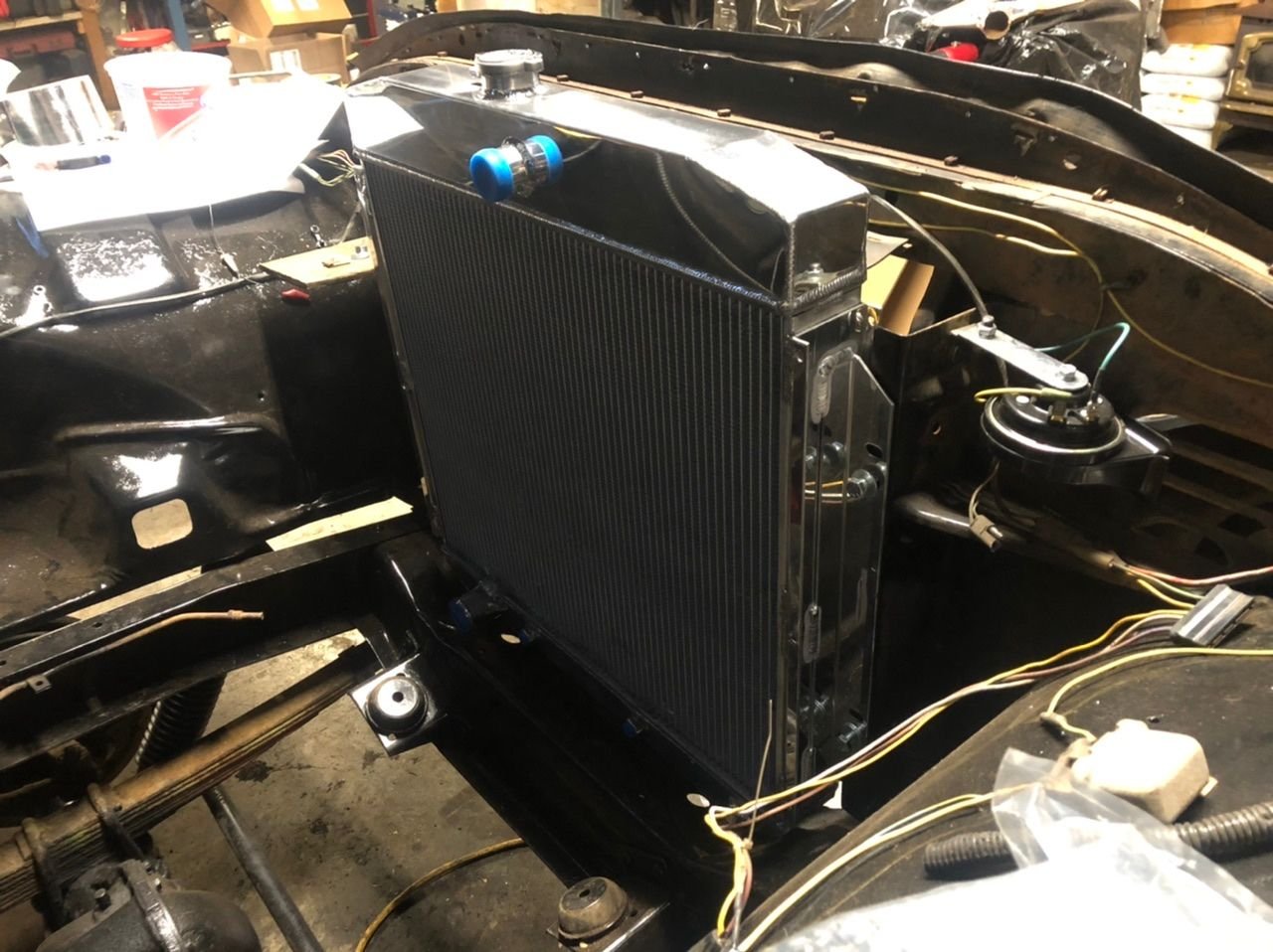

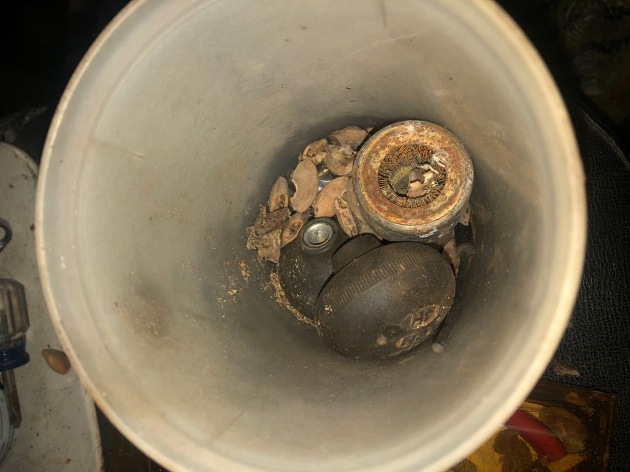

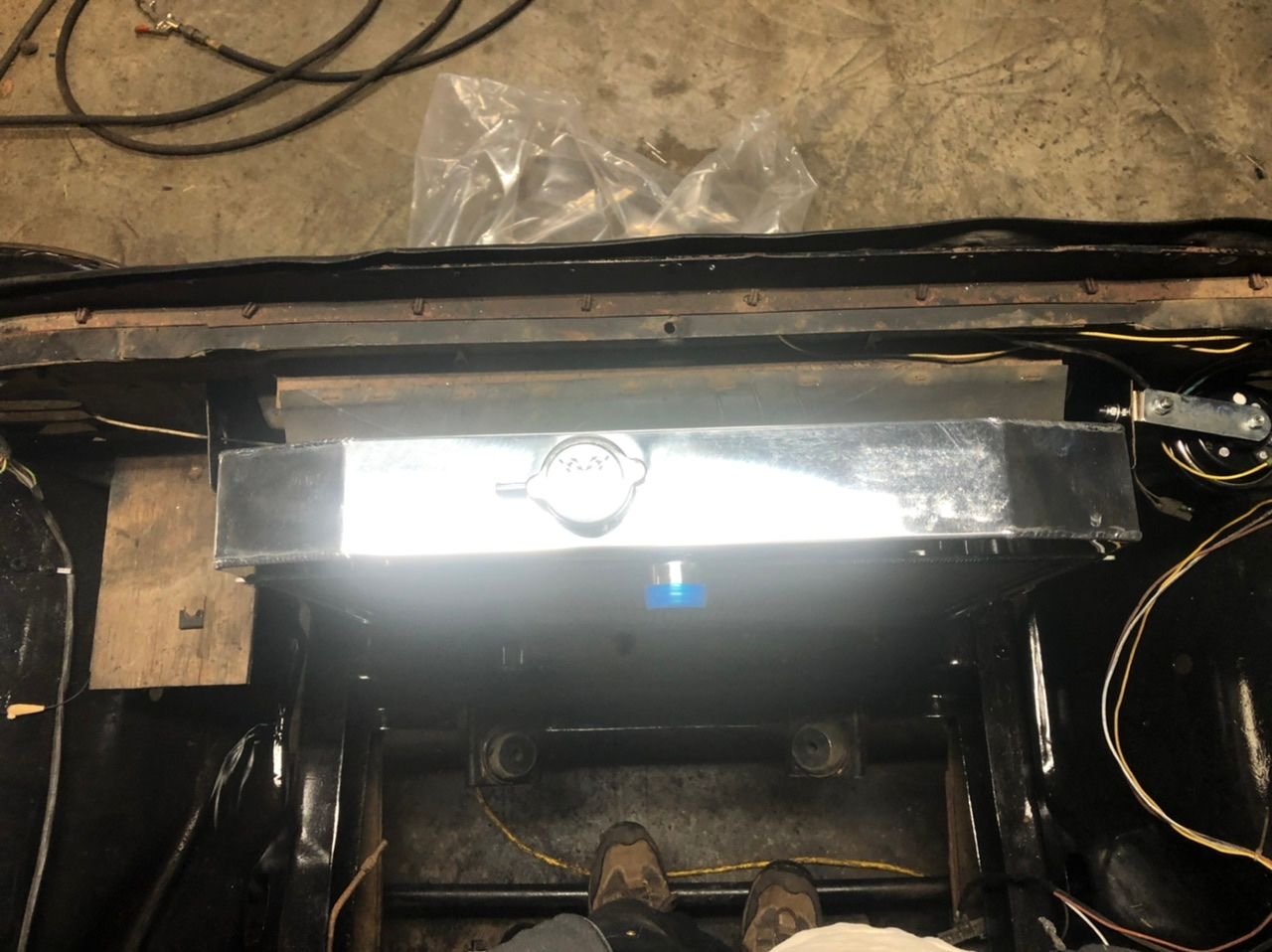

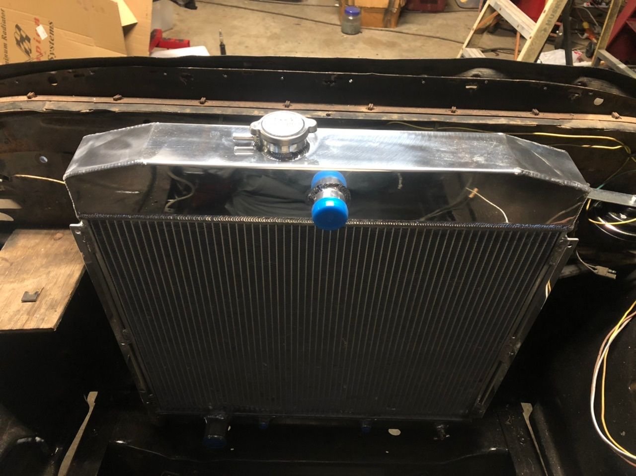

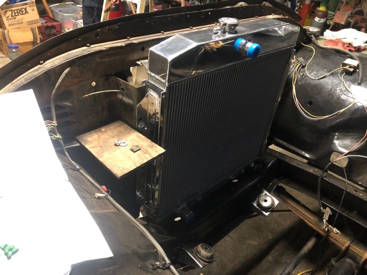

Radiator test fit
The new aluminum radiator bolted up perfectly! it will be nice to have a trustworthy cooling unit! (The mice had over 4# of shells packed in the upper tank of the original radiator as a home in the bed of the truck)
Perfect fit
Rubber air guide meets the front as it should
Excellent
Adds extra bling bling to the engine bay. ​​​​​​​
