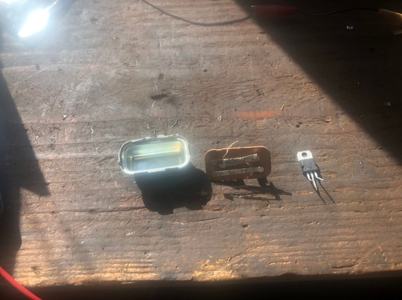

Instrument Voltage Regulator Conversion
Here is the process I used to convert a bad Instrument Voltage Regulator (IVR) from the bi-metallic contact to solid state chip. The IVR I decided to run my test on was a unit that was burned out and provided constant 12vdc instead of 5vdc. Smd123 told us about the LM8705 IC chips being cheap and good for this application. 15 chips cost less than $7 from Amazon.
The bad unit and new Lm7805 chip before install
Opened the can to expose the old circuit
I cut about half off each runner so I have something to solder to. Scuffed them up so they accept solder.
I cut three 1.25” long wires: black = ground, Red=12vdc from key (male ign pin) Yellow=5vdc output (female)
I used shrnkwrap to keep the wires isolated Red soldered to ign pin on board Black riveted to the housing Yellow soldered to the output pin
Bent the wires while hot for less struggling later The hole in my housing is where the chip with ground on top is riveted. This should also act as heat synq if the chip heats up any.
Pic of riveted chip & ground
Check the board output before installing in the truck
Pic of wires to the pins
Operating full scale with float arm up fully. I did adjust the float stroke to get full scale.

Nice pictorial and description. I really should do that I think. My needle stays just above 1/2 tank when the tank is full. I have messed with everything else on it. Too bad Radio Shack stores aren't around anymore! lol

Spurredon, did you test your fuel gage itself with 3vdc to be sure it shows full? If it does, then test the voltage output if your ICVR (Instrument Cluster Voltage Regulator) which should be around 5volts DC. If its producing 2-3 vdc it will provide low fuel readings. I got 15 chips on Amazon for less than $7 so I have extras if you want one.
