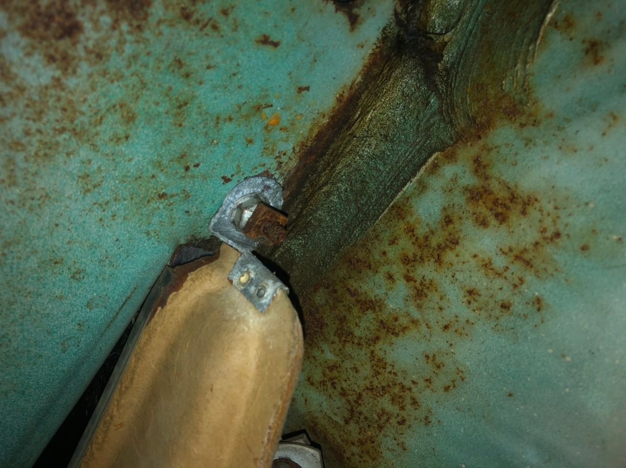

Rusted Square nut
I figure this rusted square nut is a test of my resolve! Anyone else get the weird nut treatment in their build?🦨
Look closely to see the square nut over the stock nut My guess is the PO didn’t know how to tighten these nuts up by carefully hammering the flute slightly flatter

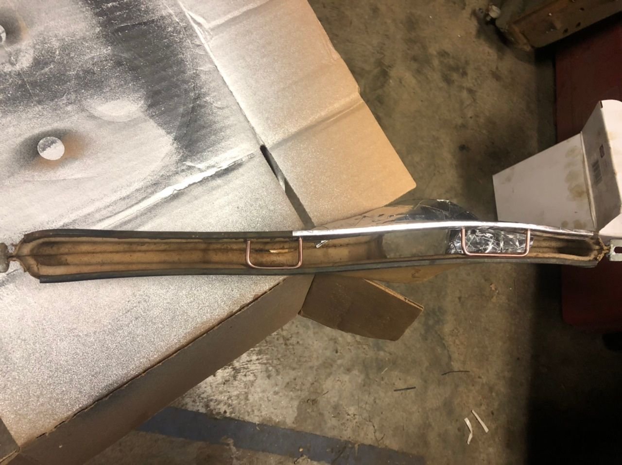

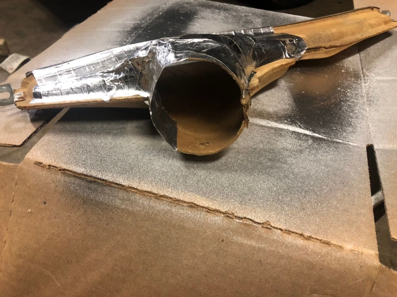

Aluminum Foil tape test repair
Does anyone know a place to get a new defroster piece? Im not convinced my aluminum tape work has “permanent “ in its title. Please let me know your thoughts! Thanks

We had a member here who started making them, ABS? Last I saw they were being sold at Macs the best I remember. Not sure if they still have them, haven't checked in a while. Back in 1975 when I built my truck I straightened them the best I could and covered them with fiberglass resin.

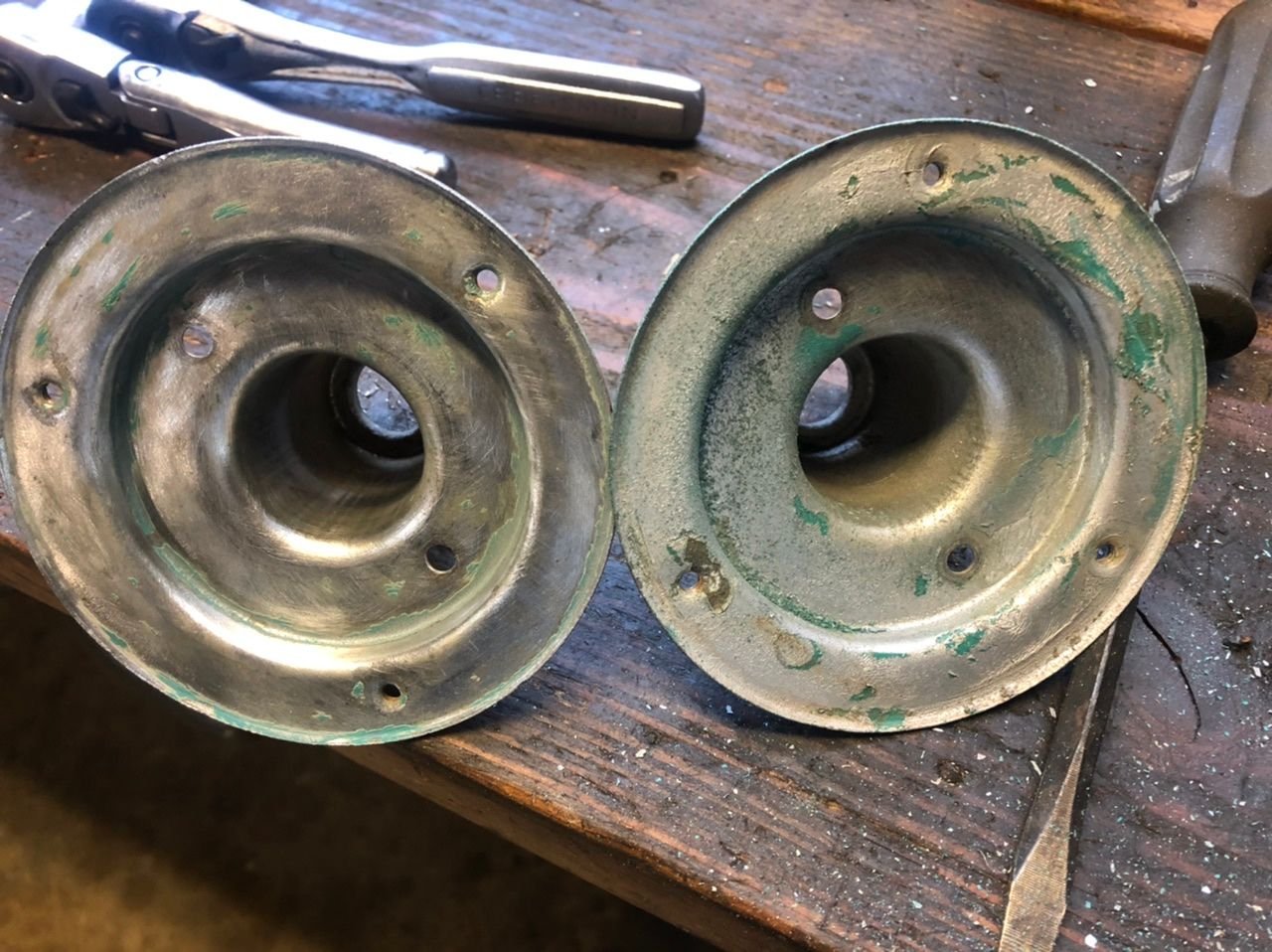

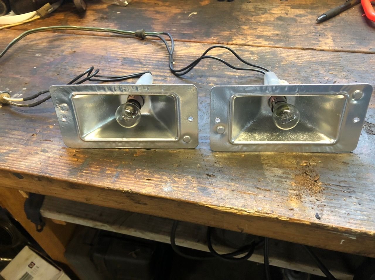

Blinker work & cleanup
Cleaning up the rear taillight housings so they are better reflective and finished front indicators
BMC
Fronts clean and ready for install
Cleaning off old gray paint with drill/brush
Self etching primer & chrome reflecting paint
Primered 2 coats
Reflecting paint 2 coats
