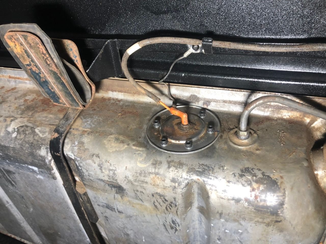

Drivelines are in and greased
Tank is cleaned

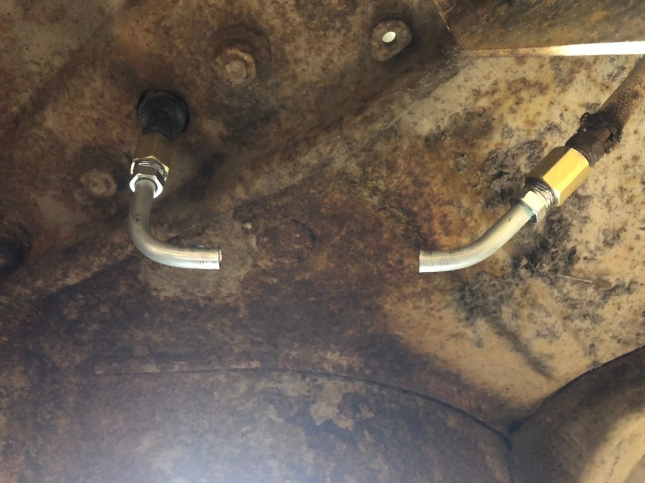

made the flex line that connects tank hardline to the frame hardline. LMC has it for $12 but Napa doesn’t list a replacement. Will likely add this item to next LMC order, but for now its custom with fittings and standard fuel tube for $8.
fuel lines cleared
tank reinstalled
new float installed
fuel gage reverified
If you want to upgrade the screws that hold the fuel sender unit on the tank they are 10-32 and I prefer allen head to eliminate slip/strip.
BMC
Tank after reinstall
Bad flex line from tank hardline to frame hardline. Its 9” long
Alignment shot
Custom flex repair
Had to make the gasket, ordered wrong one from DC
Allen 10-32 bolts upgrade from those flatheads that were mostly stripped
Empty is on E not below

I put an extra little filter right where your flex repair is. I had cleaned the tank fairly decent but that first filter ended up catching a lot of junk. Rubber on either side of it so I could isolate with vise grips and a rag.

Hi, Love the build and the idea of using the bed-liner paint behind and under the fuel tank. What is the purpose of those pads that are connected to the fuel tank straps? Do they keep your seat from touching the tank? Is it a stock bench seat?

The rubber pads are between the straps and tank to prevent the straps wearing through tank.

JohnNewb is correct about the rubber pads. They keep the gas tank from metal to metal contact. Nobody wants a fuel leak in the cab!
