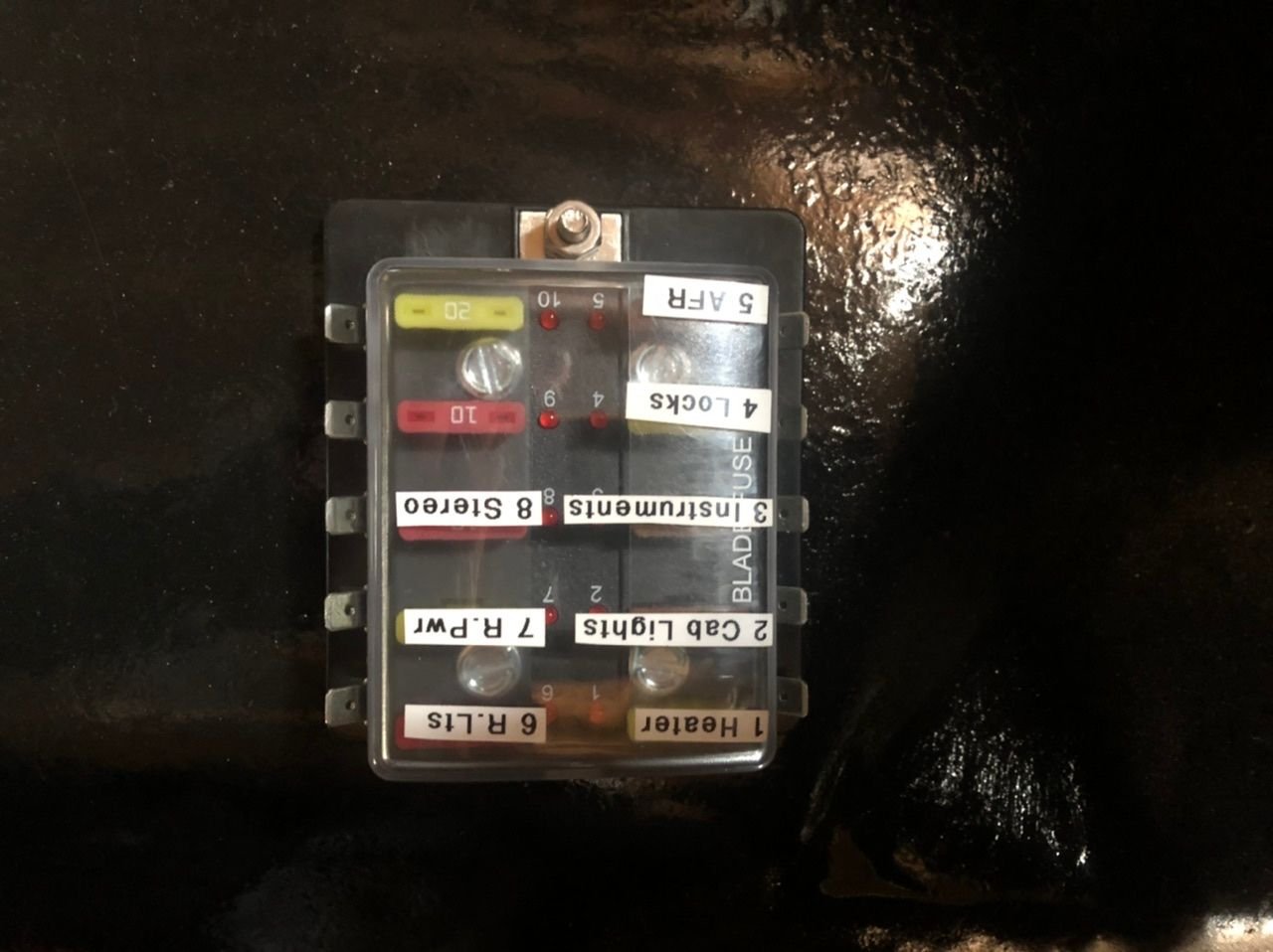

Auxiliary fuse block
New fuse block is mostly for removing the new load from the key switch and light switch. I am adding circuits, not cutting the harness. A high power relay will make these circuits only active when the key is ON.
Located on the drivers inner fender for easy access. This way I dont have to contort to inspect and replace the newer blade style fuses! Note these are all added features except heater blower. I briefly considered installing it upside down so it is legible from my orientation leaning over the fender but thought it looked stupid when looking at it from anywhere else under the hood!

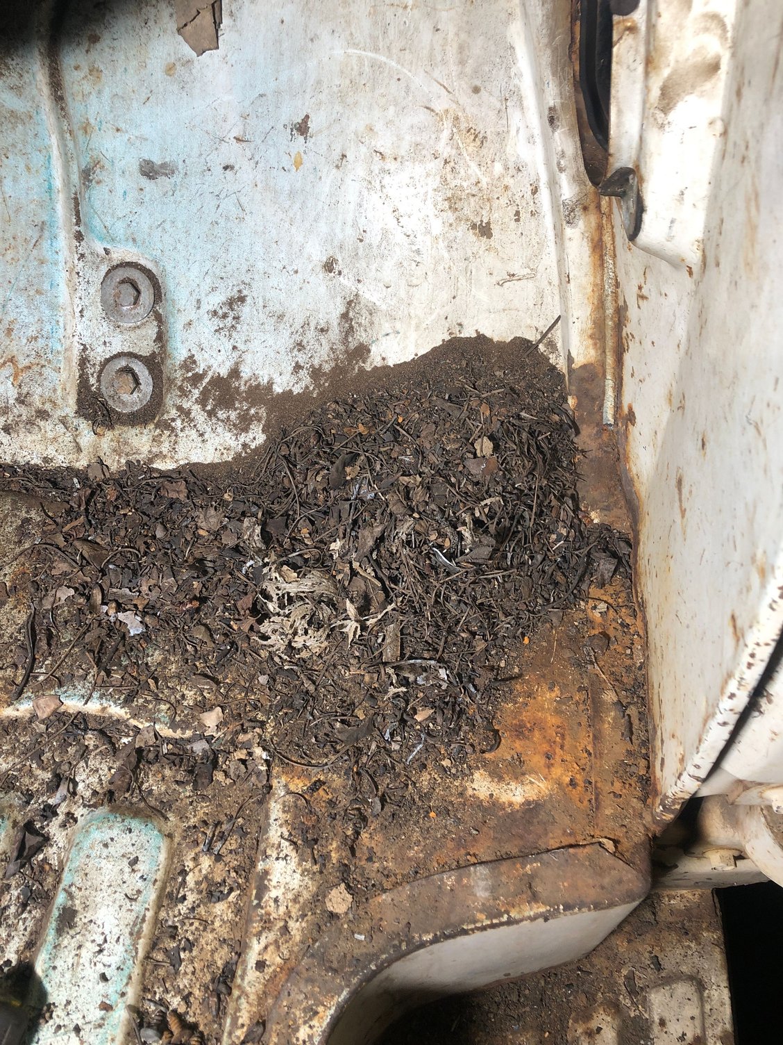

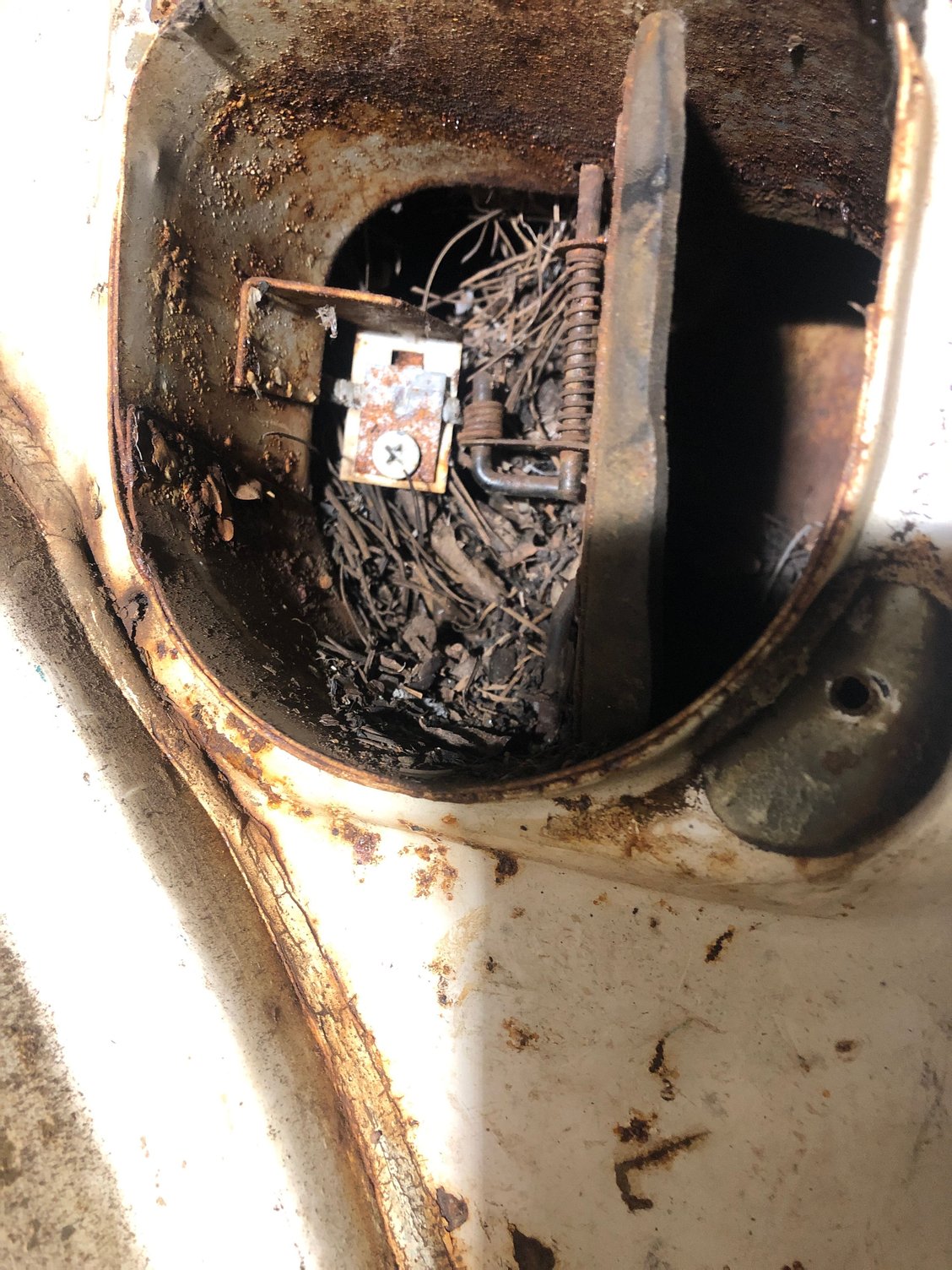

B-B-C
Bearings... done
brakes... done
electrical ongoing
Check out my fresh air vent!

Guessing air not so fresh. Mine were full of leaves and pine nerdles.

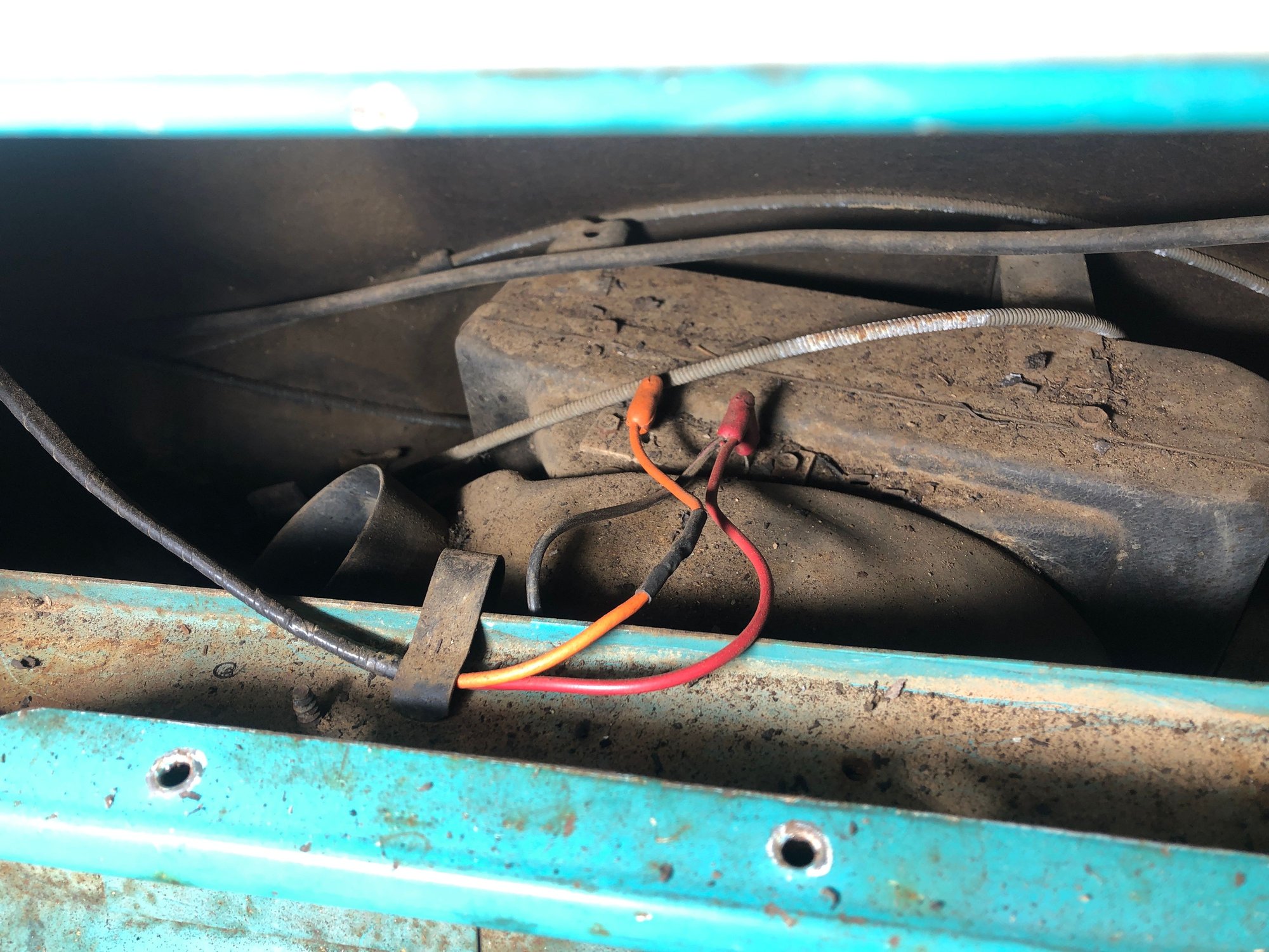

Heater wire
Fixed heater wire soldered shrink wrapped. This works perfectly now on high and low, heat or defrost!
Wires are not brittle, repaired nicely
This pile came from right vent only! Lubed cable and it is now useable.
