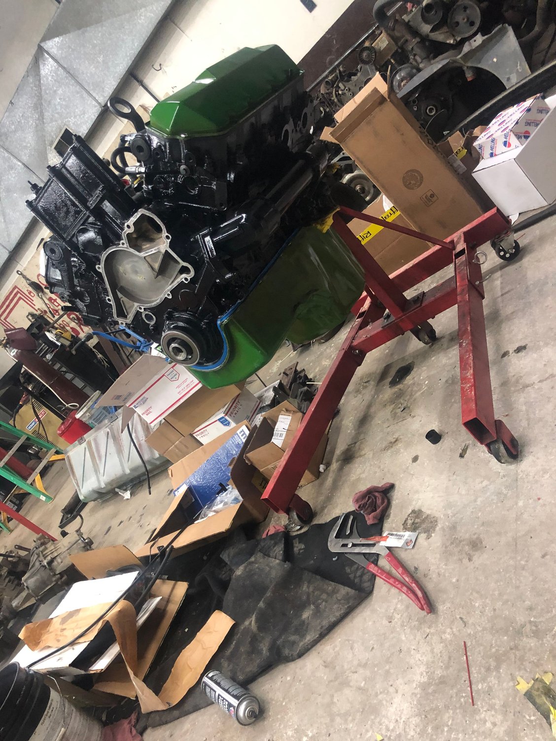

Old Jun 20, 2020 | 09:40 PM
  #190
7.3 forever's Avatar
7.3 forever
Joined: Aug 2014
Posts: 1,823
Likes: 238
From: piedmont mo
Well got little more done today definitely coming together though.
Old Jun 20, 2020 | 10:04 PM
  #191
z31freakify's Avatar
z31freakify
Joined: Dec 2012
Posts: 11,274
Likes: 1,654
From: Las Cruces New Mexico
Oooh shiny, ooks great man. Reminded me of a 7.3 engine I rebuild at work, I did the same color scheme.
Old Jun 21, 2020 | 08:50 AM
  #192
7.3 forever
Joined: Aug 2014
Posts: 1,823
Likes: 238
From: piedmont mo
Thanks hopefully I can have in within a month or so.
Old Jun 21, 2020 | 06:02 PM
  #193
BBslider001's Avatar
BBslider001
Joined: Mar 2012
Posts: 10,590
Likes: 382
From: Texas
What do you left to do? Looks like you're about there. Looks great!
Old Jun 21, 2020 | 07:06 PM
  #194
7.3 forever
Joined: Aug 2014
Posts: 1,823
Likes: 238
From: piedmont mo
I’m vary close clean up few more parts and I gotta bottom tap all the holes for accessory brackets and engine mounts and. I gotta come up with rest of the funds for turbo and injectors.
