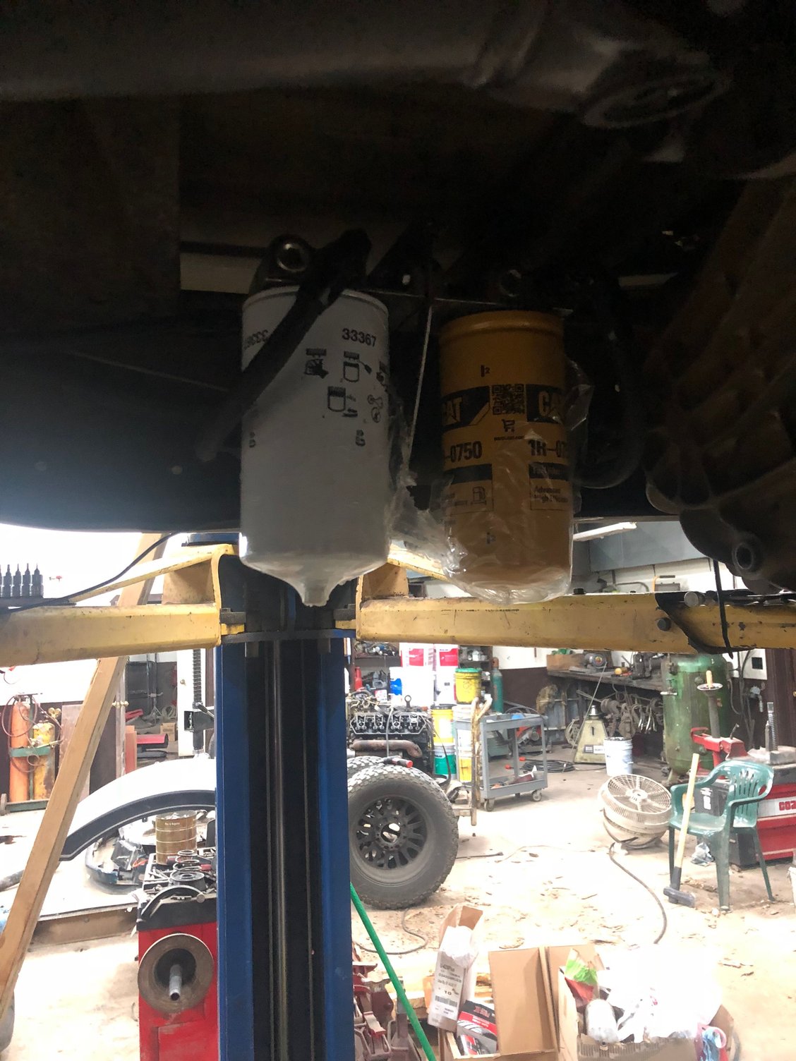

Well guys just about have fuel system redone filters will be nice and tucked up high out of harms way.

test fitting my hoses to make sure they clear the filters everything looks good so should have it finished up first thing in the morning

Well ran it down the road today definitely runs better but won’t really know till I get to drive it for a while still half to put the frontend back together. Got the fuel system swapped out looks much better filters are definitely tucked up much safer. I’ll let you guys know more when I know more.
