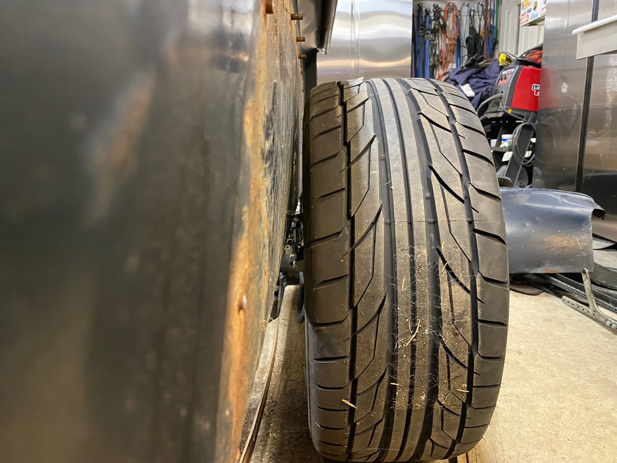

but I’m looking for some advice in the bed area. I have to widen the rear fenders anyway which I’m prepared to do. Currently the way it sits with the fenders off I can barely get a finger between the tire and bed side so I bought a trailer fender and was going to put mini tubs in. But then started thinking that maybe I should just run a wheel spacers instead. I just feel like I should have more clearance.

If you plan on widening the fenders anyways I would definitely use the spacers . Allot less work same result .

I guess I should check how long the studs are. Before doing a spacer route. If I use a spacer I don’t want a super thick one. 1/2” would be more than enough I think

I used the Explorer rear differential on my pickup which is 1/2 narrower than the stock differential and had to use 1/4" spacers to centre the wheel . When I try to run my fingers between the box side and tire I can only get to the second set of knuckles and I've never had a problem with tire rub..

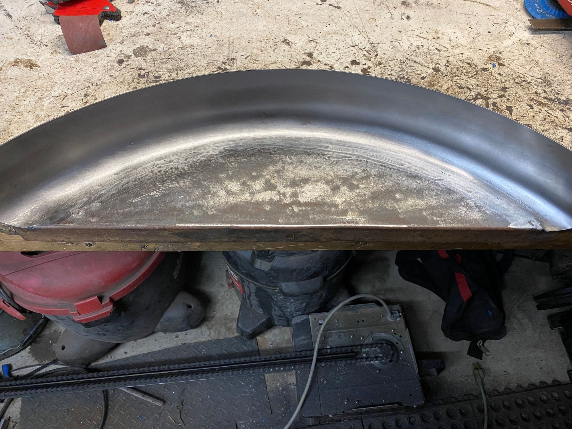

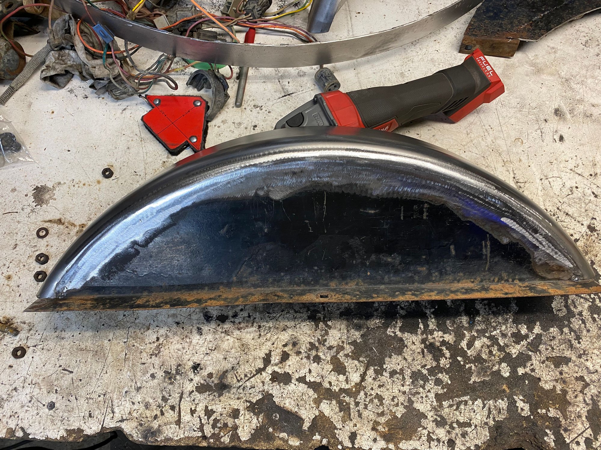

Well I went ahead and cut some metal. I looked at the studs and I guess I probably could have got 1/4” spacer like John said but this will give me more room to get to the air leveling valve and brakes. So what the hell. Here is the first one finished.

Looks pretty good..no need for spacers now..how big of a trailer fender is than and where did you buy it from..what was the measurement at the base of the cut..

The fender I got from princess auto. It was originally 8-9” wide. I took a strip out of the middle and I believe these are about 3”. I can measure exactly if you want.

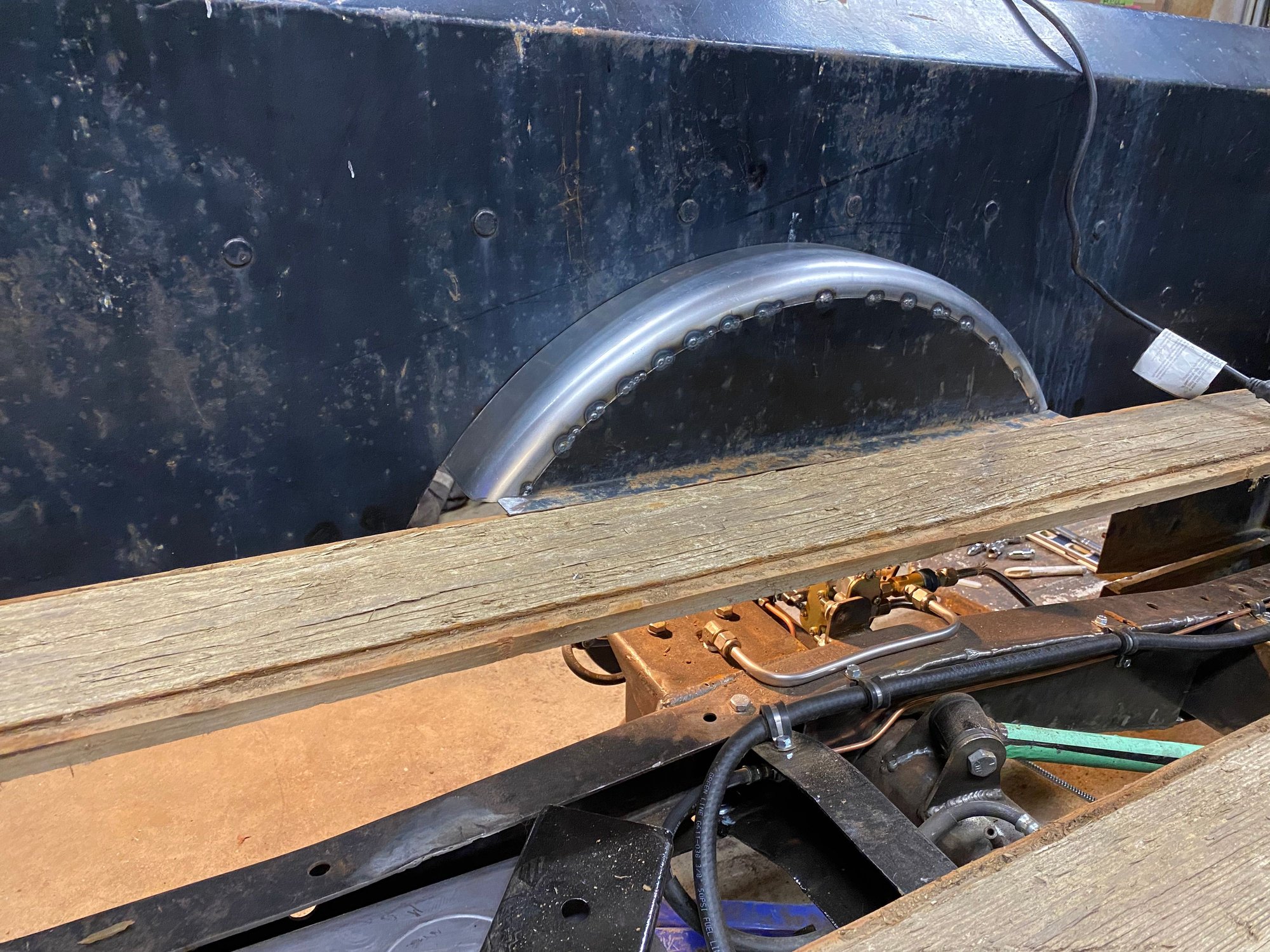

What I meant was the length point to point at the floor..just curious if I could have used one on the box I'm making..

Here the other half of the fender that hasn’t been trimmed down. Is this the measurement your after

That's the one, thanks.
