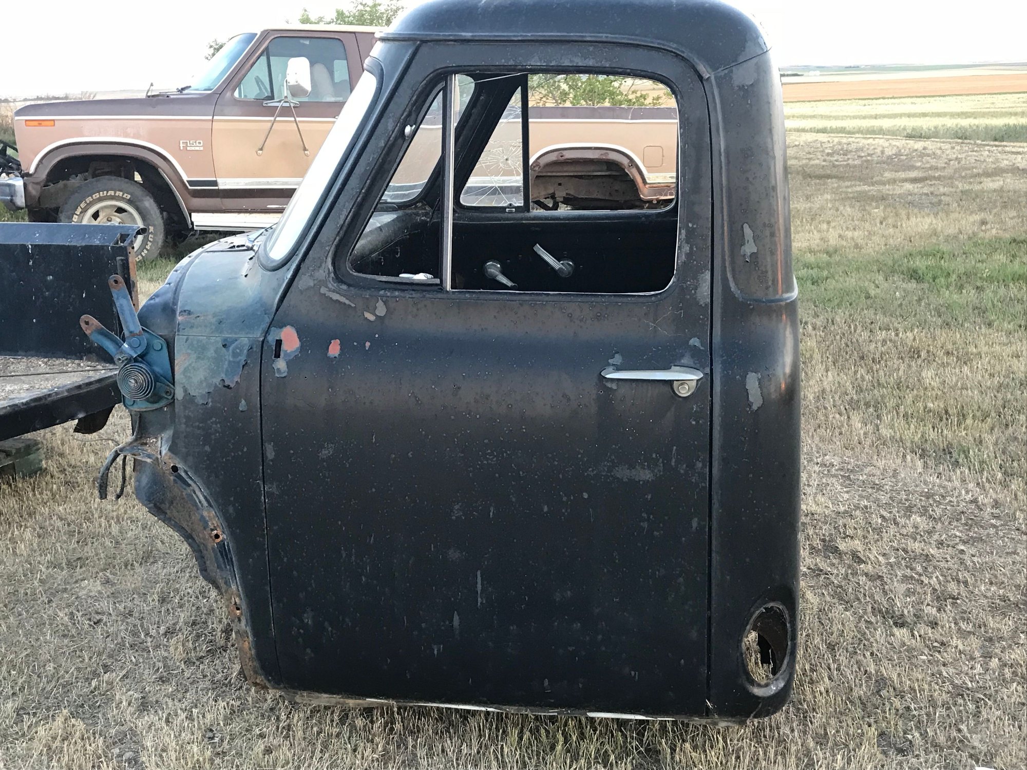

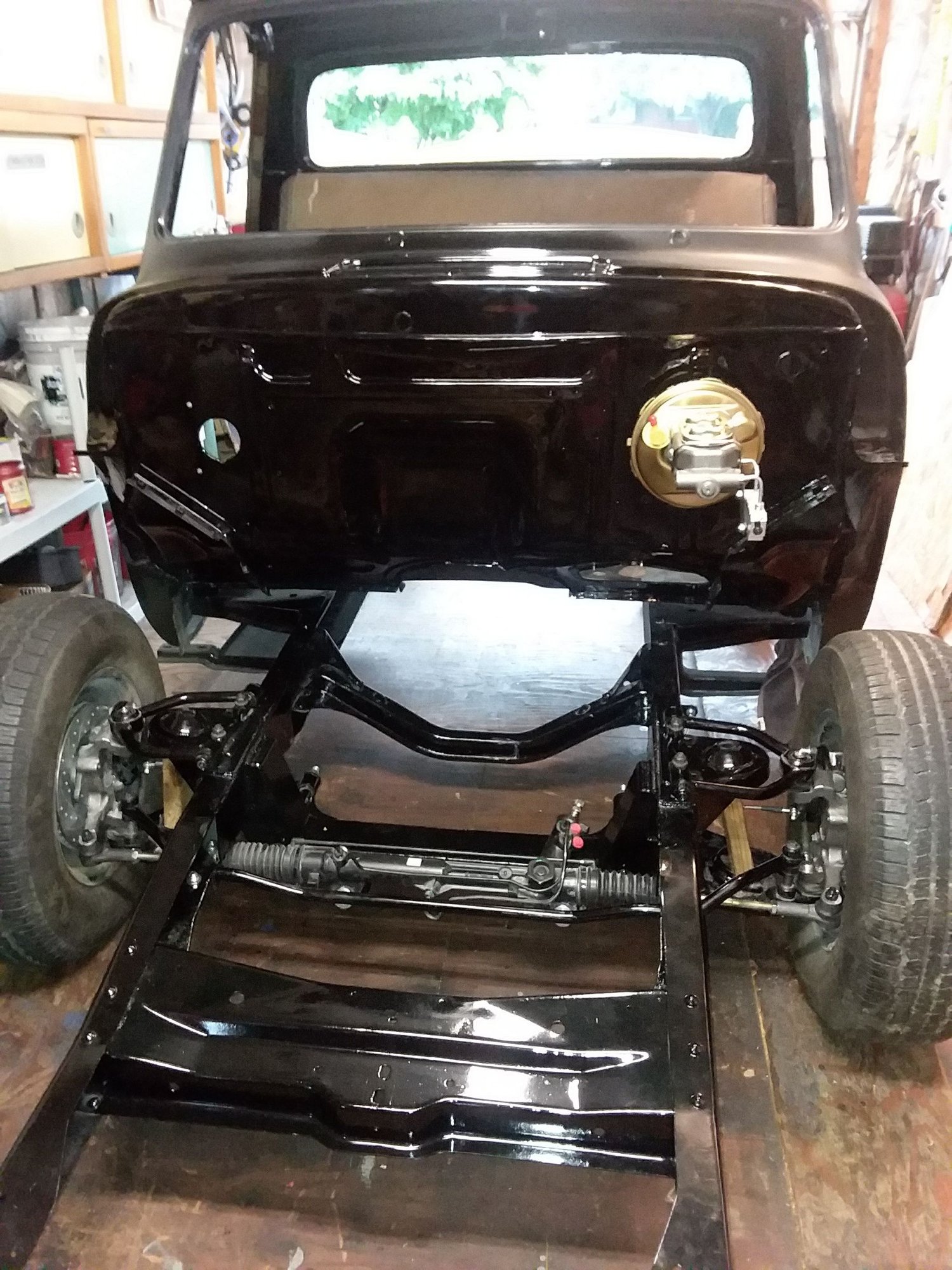

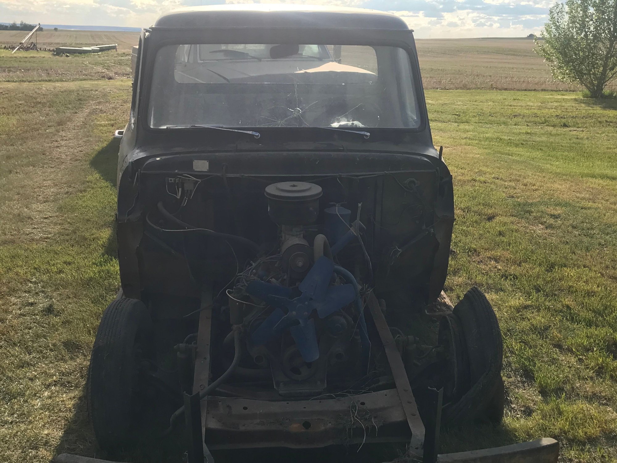

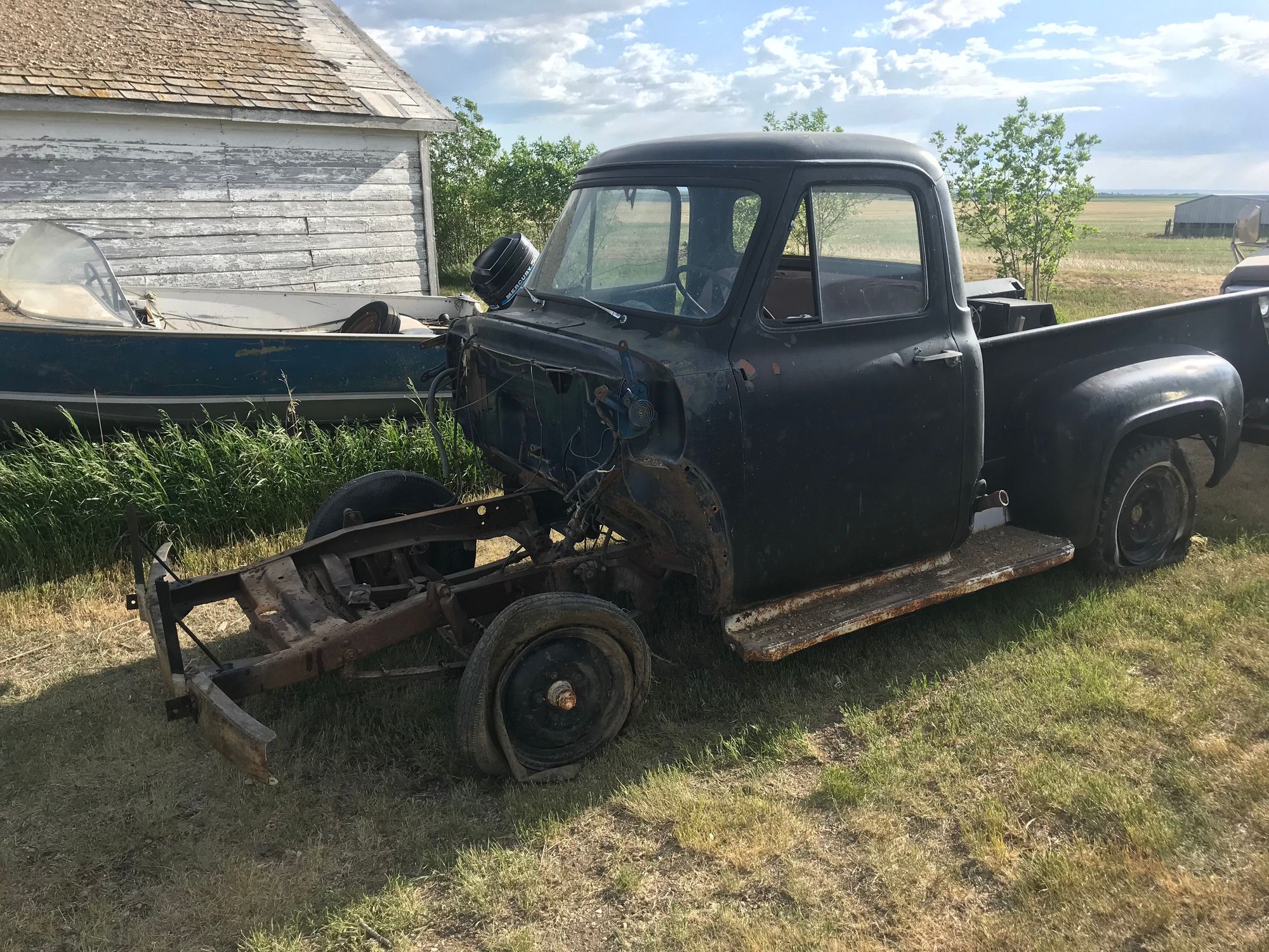

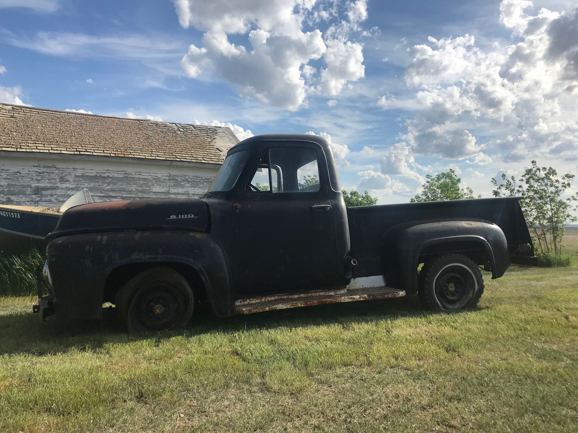

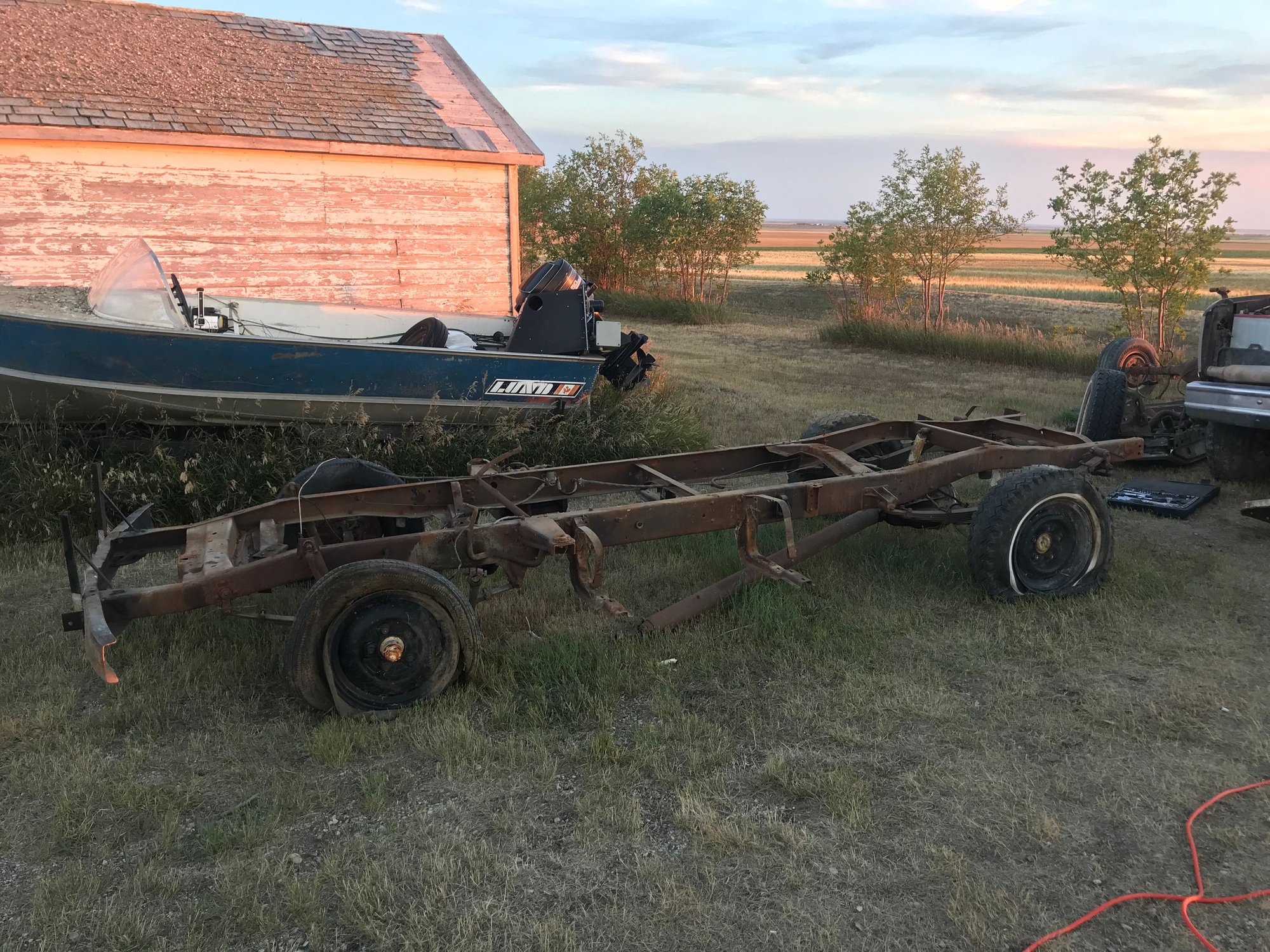

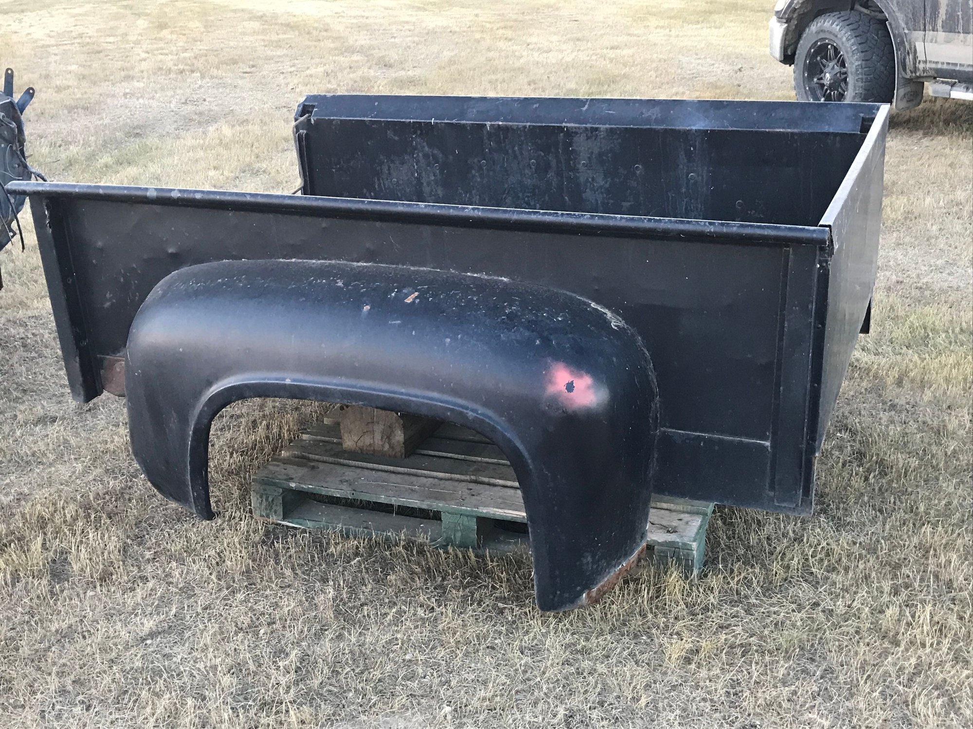

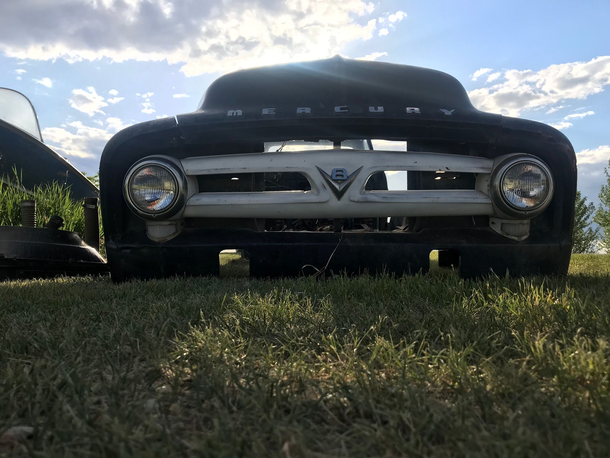

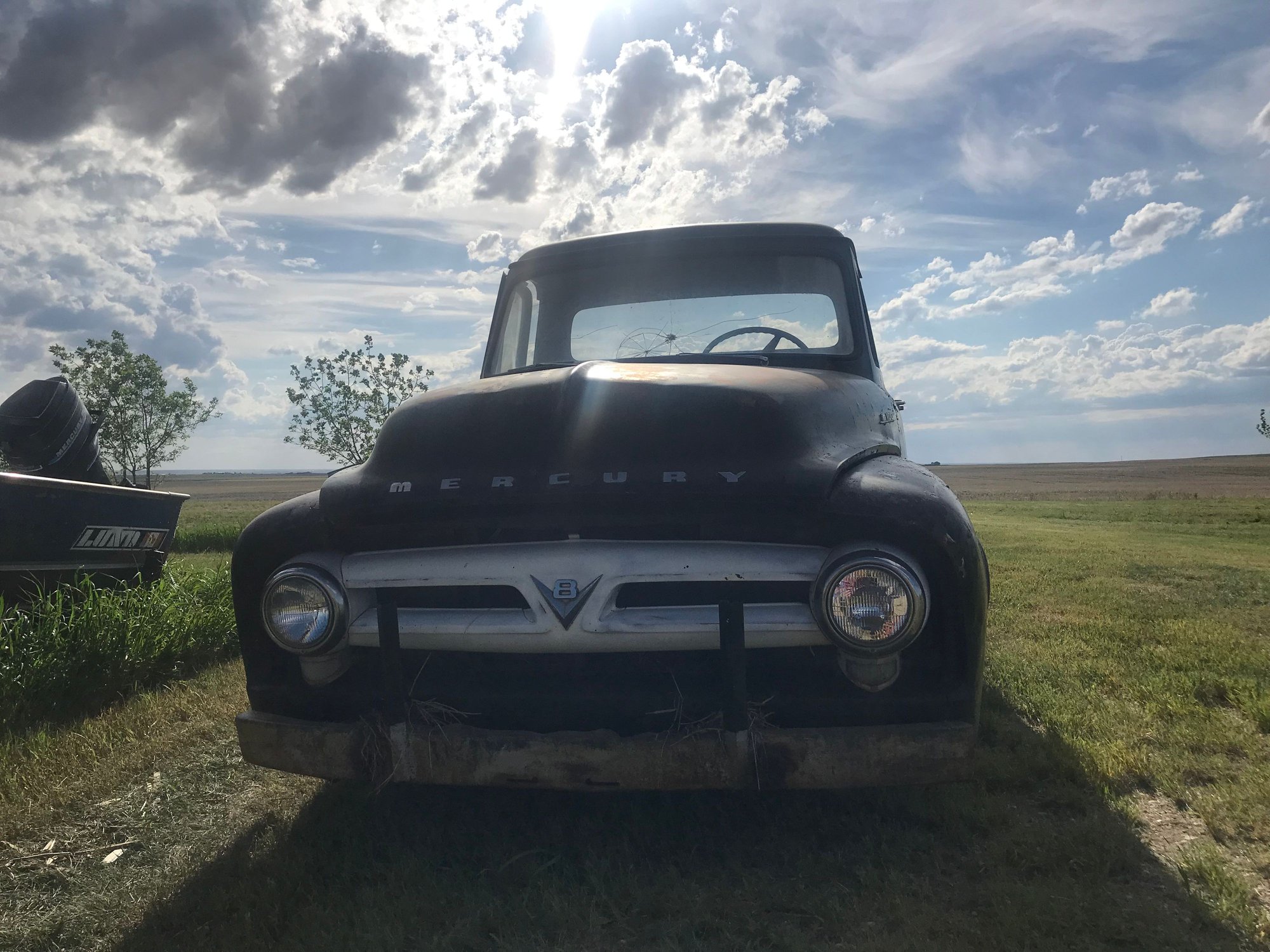

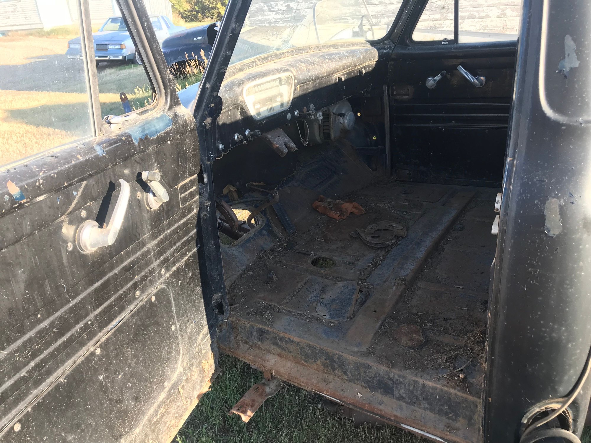

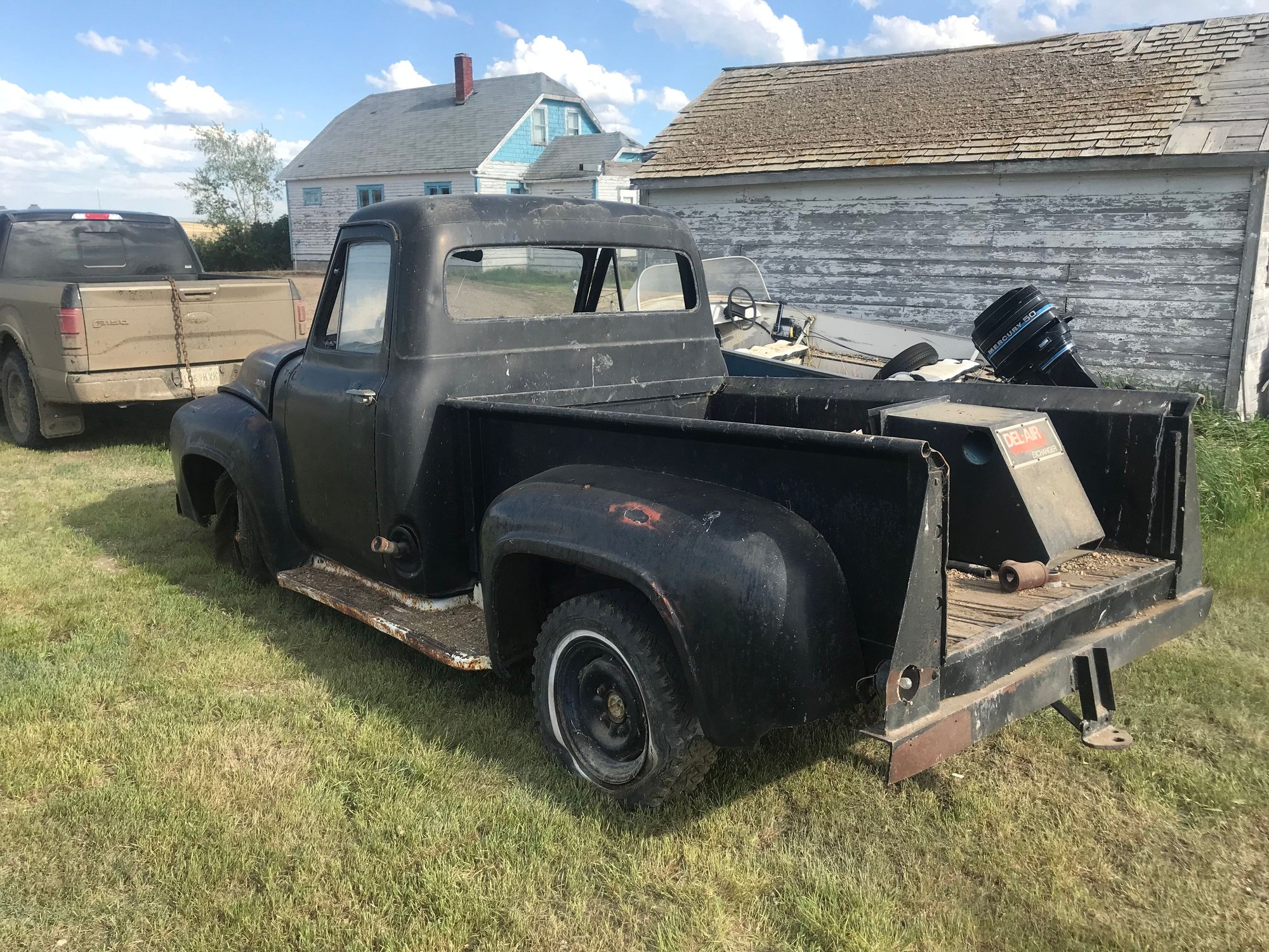

well tonight I got her stripped down to the frame, slow progress, but still progress. my Paul Hortons welder series trianglated 4 link and MII cross member came today, can't wait to get home and start building it
Old Jul 31, 2018 | 11:47 PM
fullyford's Avatar
fullyford
Joined: Aug 2003
Posts: 413
Likes: 136
Here’s a couple pics
Old Aug 1, 2018 | 11:20 PM
ben73058's Avatar
ben73058
Joined: May 2010
Posts: 3,793
Likes: 19
From: Austin
Hey FullyFord
Your truck cab floor looks a lot better than our's did... amazed it's not rusted through.
I think I spy an 80's Olds Cutlass hiding back there in one pic.... Any more pics of that ...
We had a nice Cutlass Calais... looked great but could hardly keep it running.
Ben in Austin
1950 F1
(Those are some pretty long views behind your place. ...I'd hate to plow that field).
