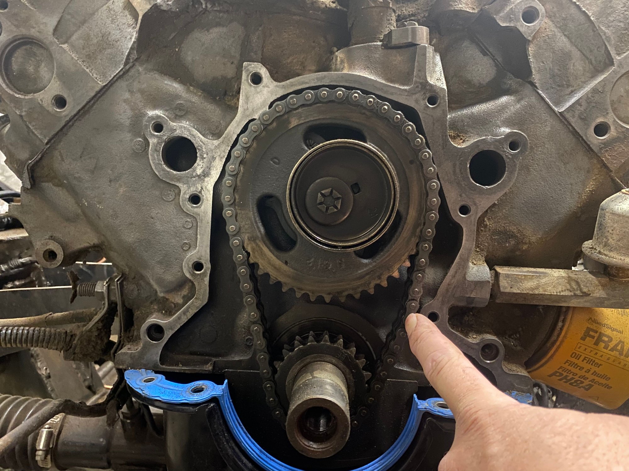

In the pic. On the left hand side was tight. The right hand sided did have some slack it in. Mileage not sure to be honest. It was an old farm truck off ours.

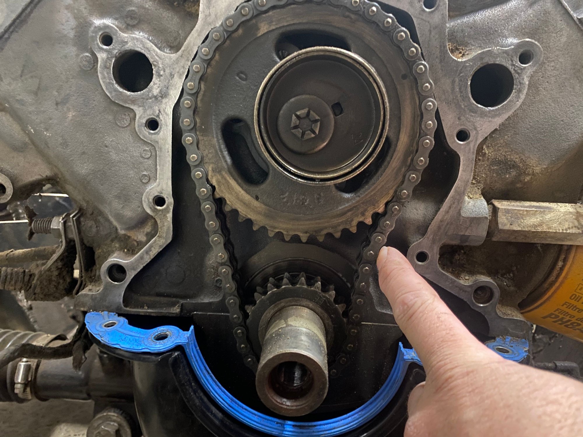

Here’s a couple pics. Hard to tell but there is some slack

It looked a little slack on the driver side in the picture and why I thought I should mention it. After changing mine the chain was pretty tight both sides....
Time to change it..

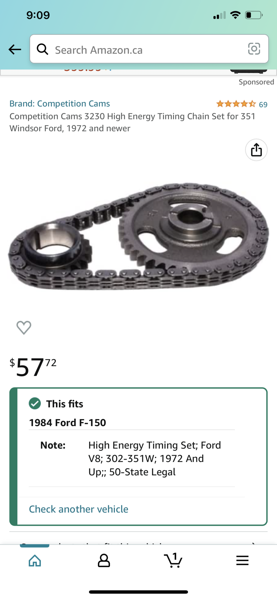

found this on amazon. Plus a few edelbrock ones for a few bucks more. Not sure what i exactly need
Old Dec 6, 2022 | 09:17 PM
  #162
56panelford's Avatar
56panelford
Posts: 283,988
Likes: 8,397
From: northwestern Ontario
Yes. Stock 351w from a 84 f150.
That looks like the one I put on mine and the same that came off. Mine is from an 83 F150, sounds closer to what I paid now that I'm thinking about it, I know it wasn't as as expensive as I had imagined before going to buy one..

Is this one a single chain? The one on the engine right now has dual sprockets. This appears to be the same width but just a single sprocket. But if this one works the same it’s cheap insurance.
Old Dec 6, 2022 | 09:34 PM
  #164
56panelford
Posts: 283,988
Likes: 8,397
That one on Amazon I posted was a double chain, I'd replace with the same as you have now..
Old Dec 6, 2022 | 09:45 PM
  #165
fullyford's Avatar
fullyford
Joined: Aug 2003
Posts: 427
Likes: 141
I didn’t even realize that was a link to a chain. Thanks.
