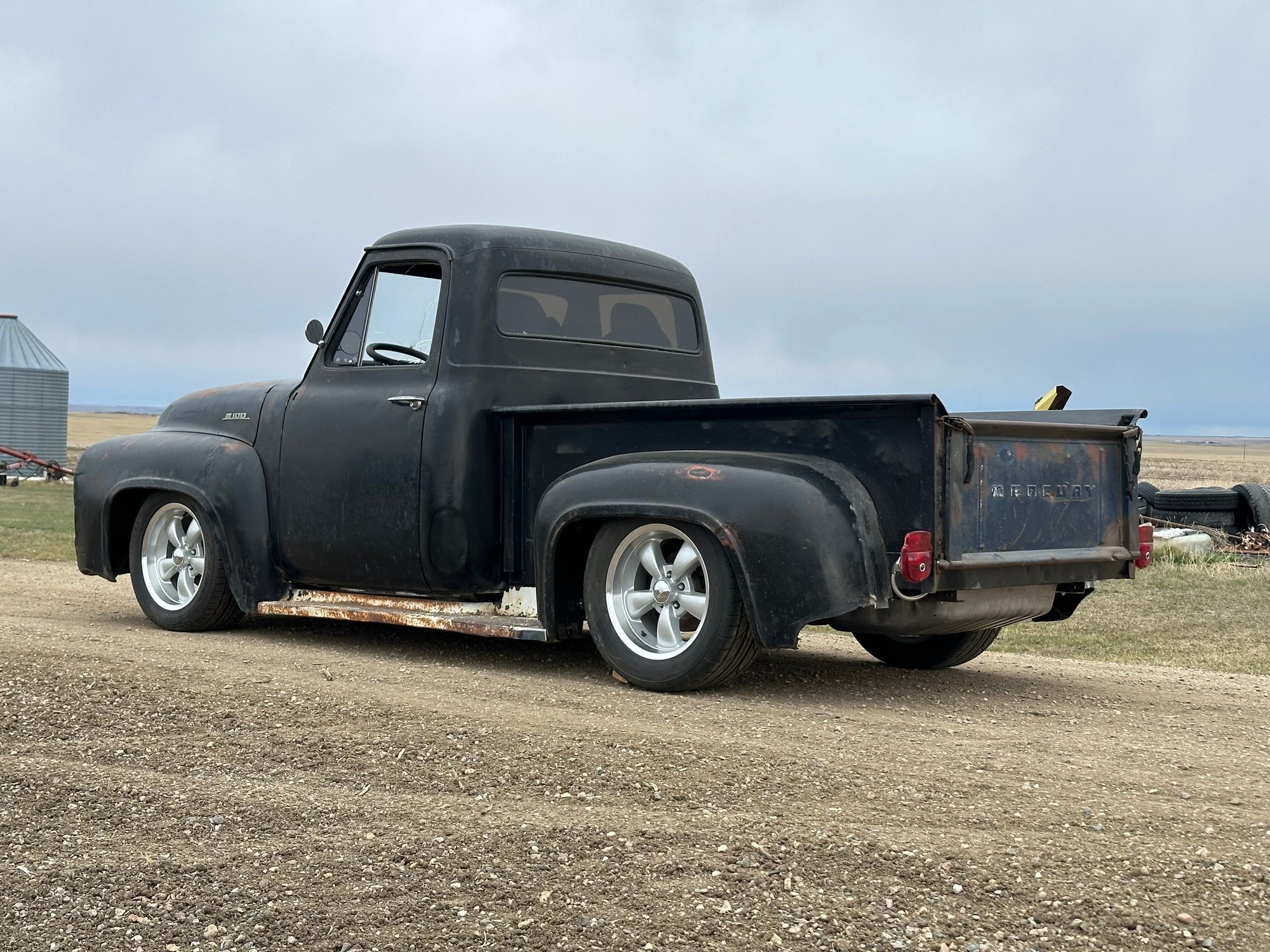

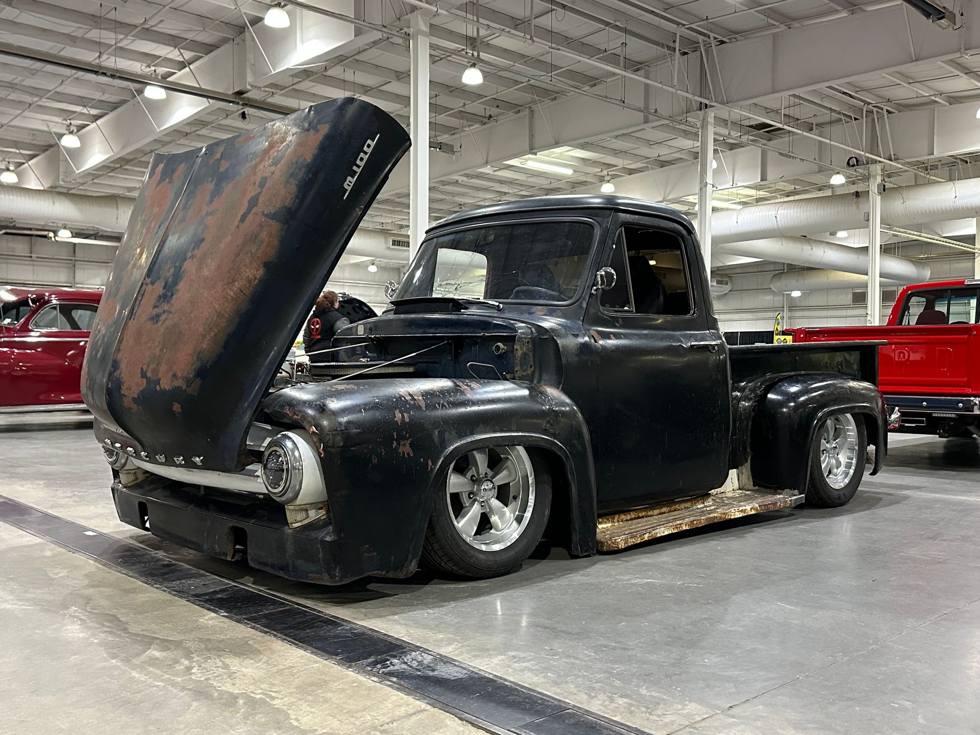

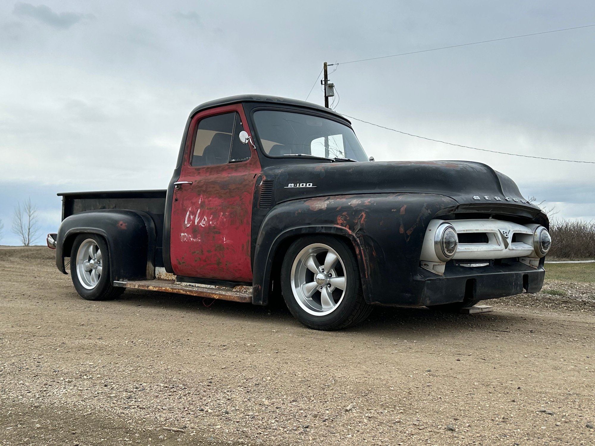

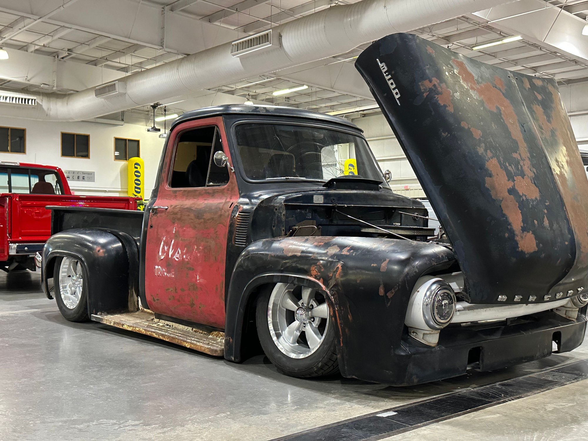

easter weekend I decided to load up and head to the city for the annual draggins rod and custom car show. Had a great time and lots of people interested in the truck. Now I’ve got to get it running. Still a ways to go that’s for sure. I’ve started to compile a list and it just keeps growing.

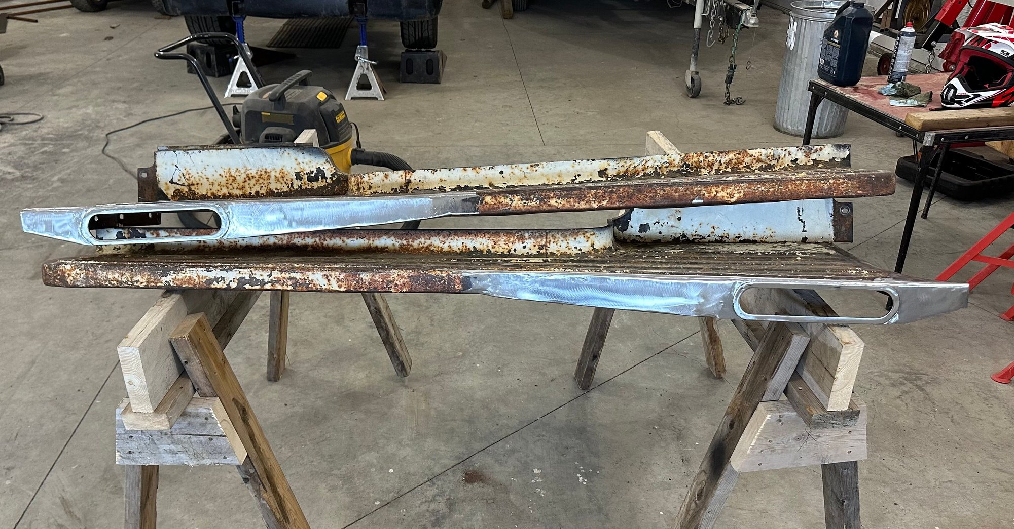

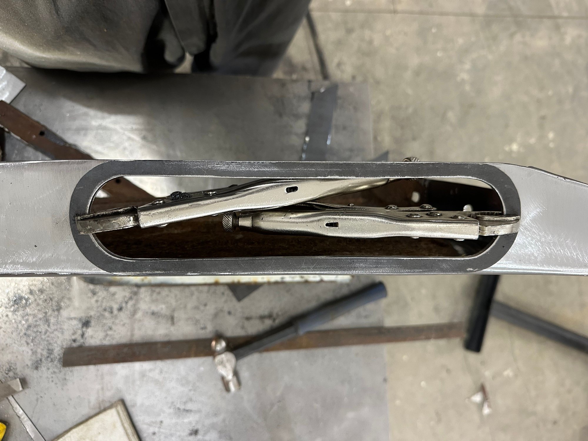

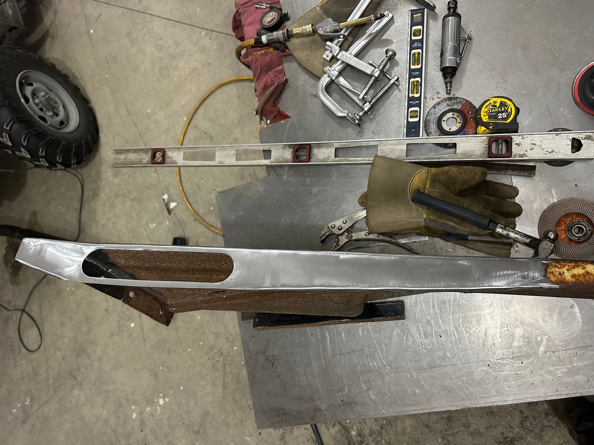

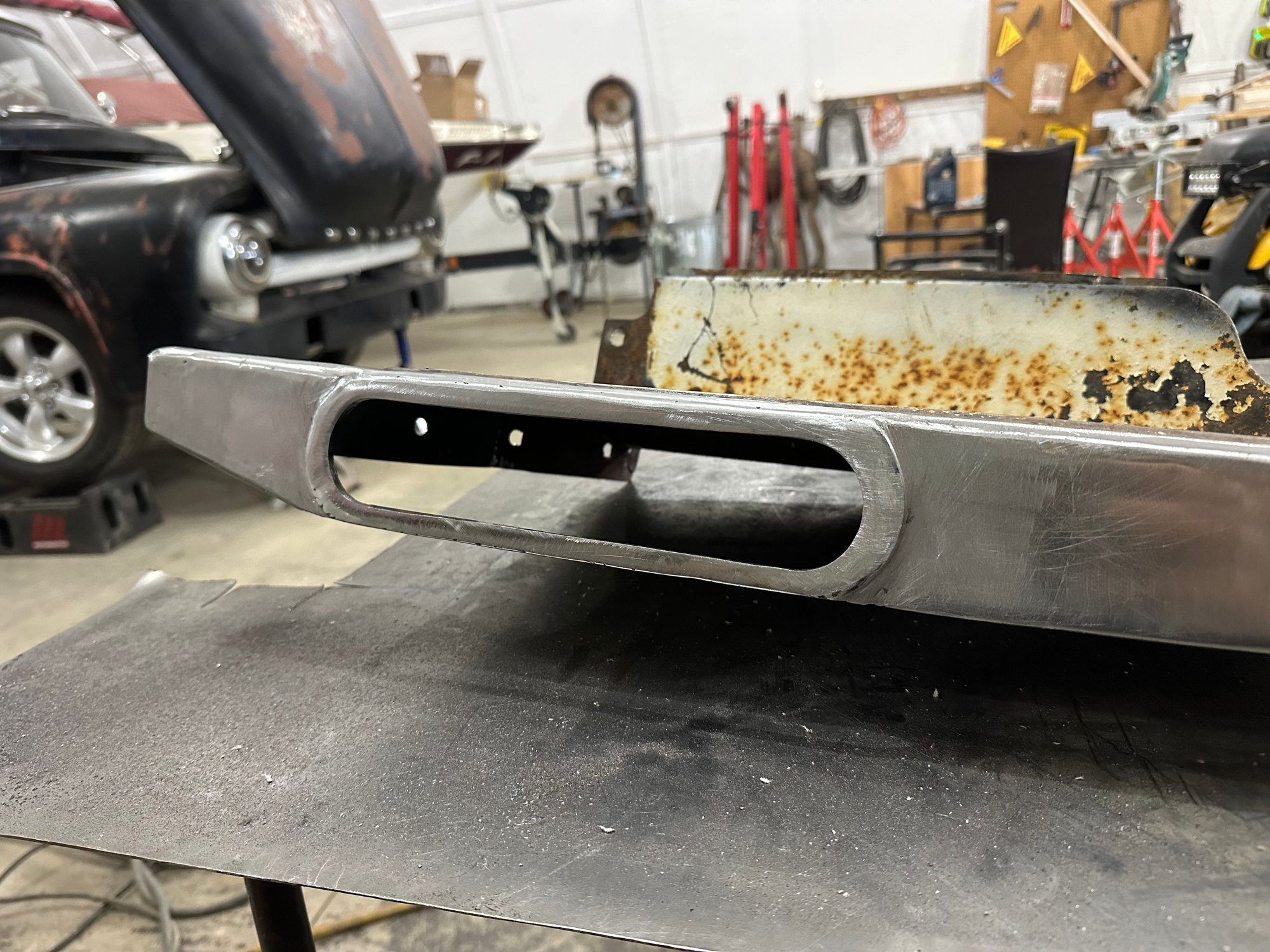

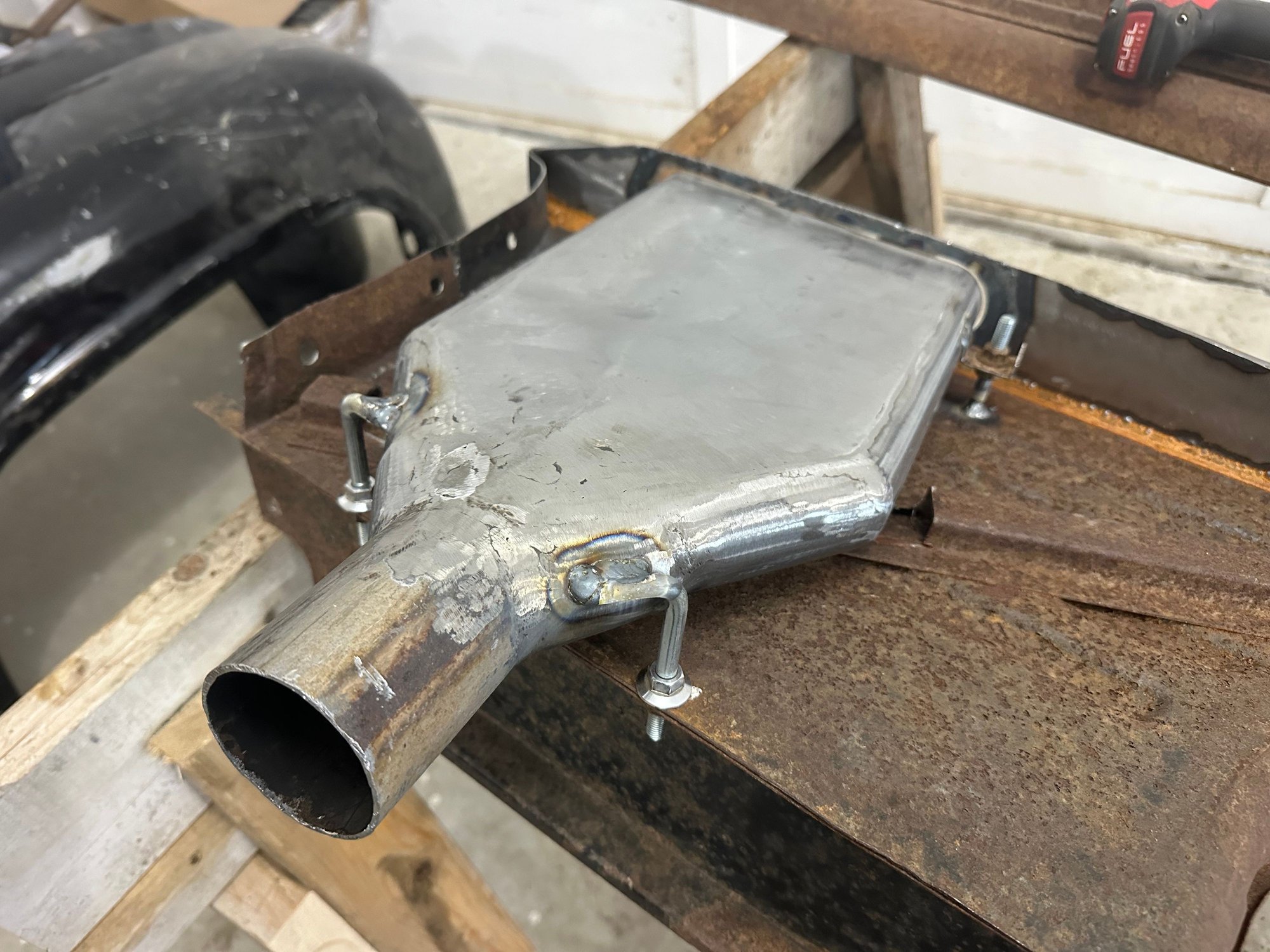

exhaust was next on my list and I wanted it to come out through the running board. I’ve seen a few others do this so this is my take. I’ll have to make my own exhaust tip

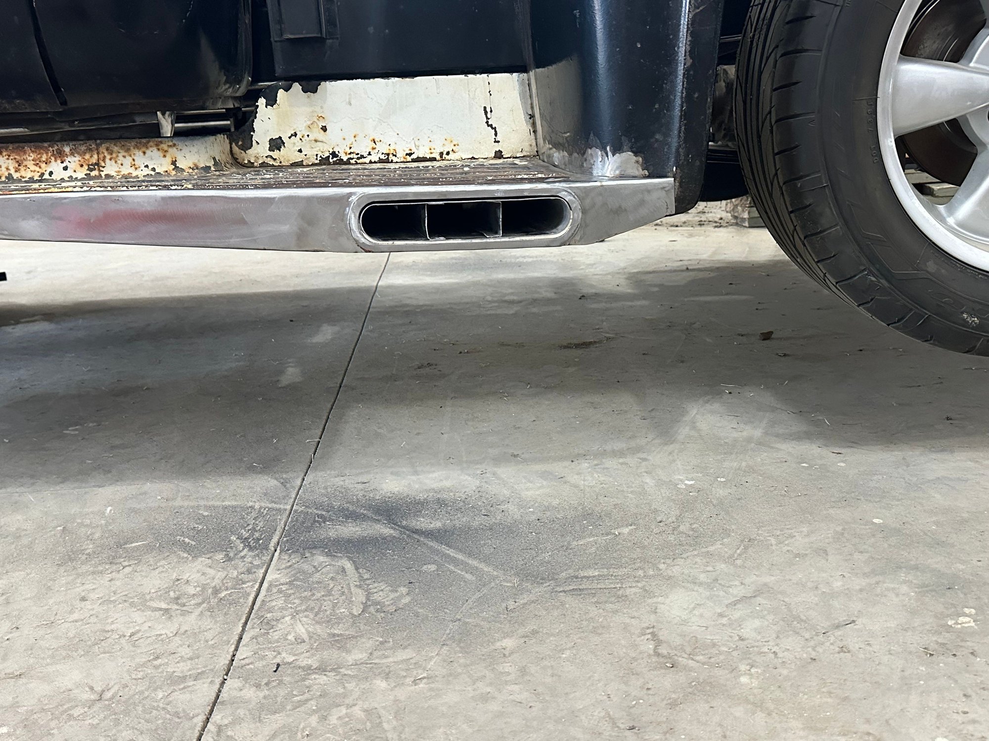

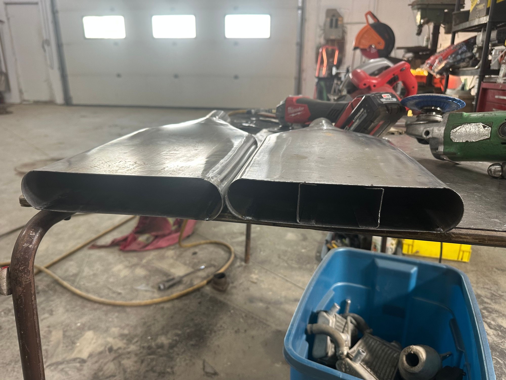

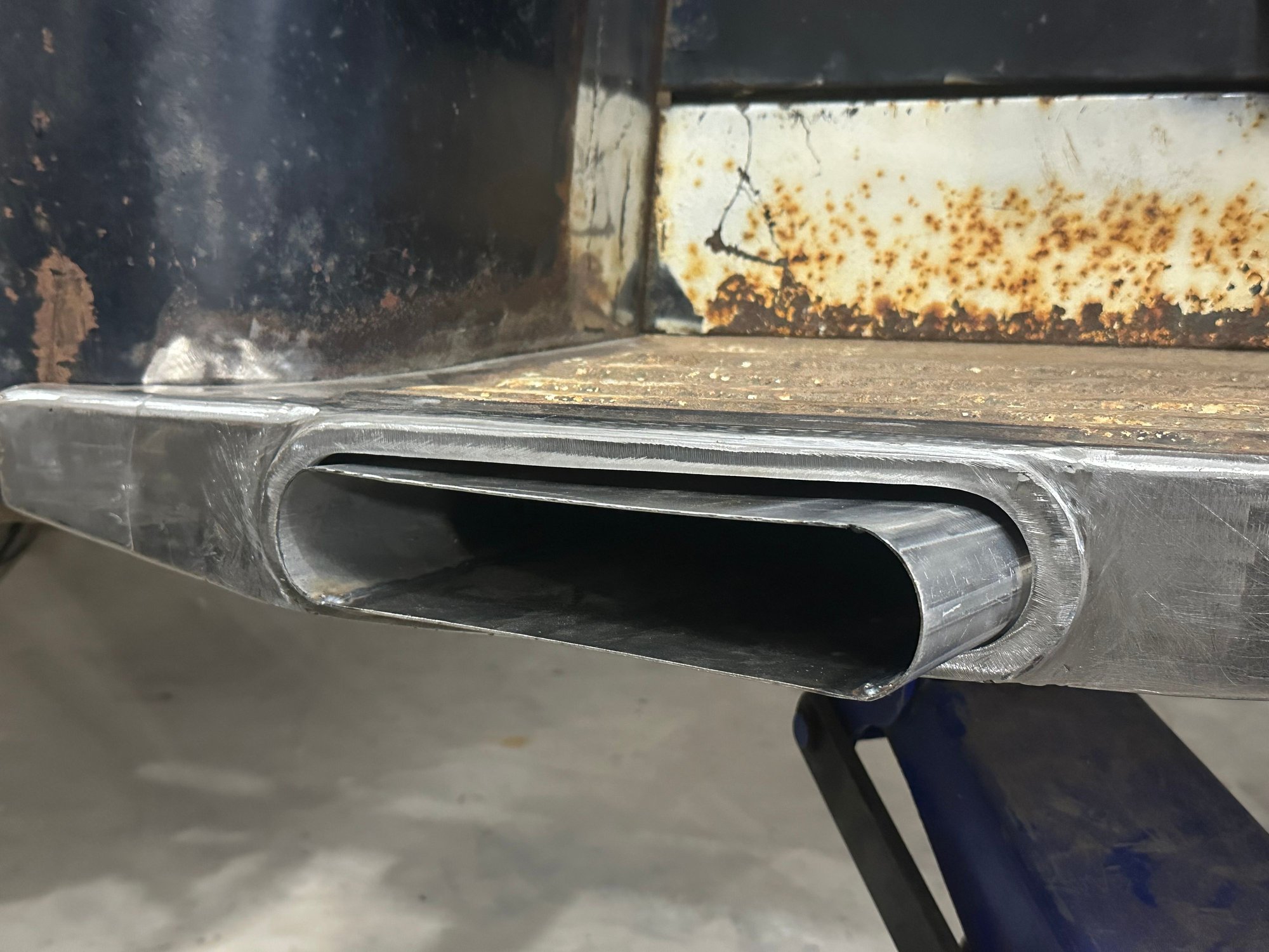

When you make custom exhaust cut out in your running boards, you also have to make custom exhaust tips to go through. I’m undecided if I like the open look or the divided look.
Old Jun 6, 2025 | 08:30 AM
  #277
56panelford's Avatar
56panelford
Posts: 283,968
Likes: 8,394
From: northwestern Ontario
I think it looks best with the divisions
Old Jun 6, 2025 | 03:08 PM
  #278
fullyford's Avatar
fullyford
Joined: Aug 2003
Posts: 427
Likes: 141
I am leaning towards the one with the dividers on it as well. I just need to figure out how to clean it up a little bit and not have the flat part looks so noticeable. I’m surprised how many people liked the open tip.

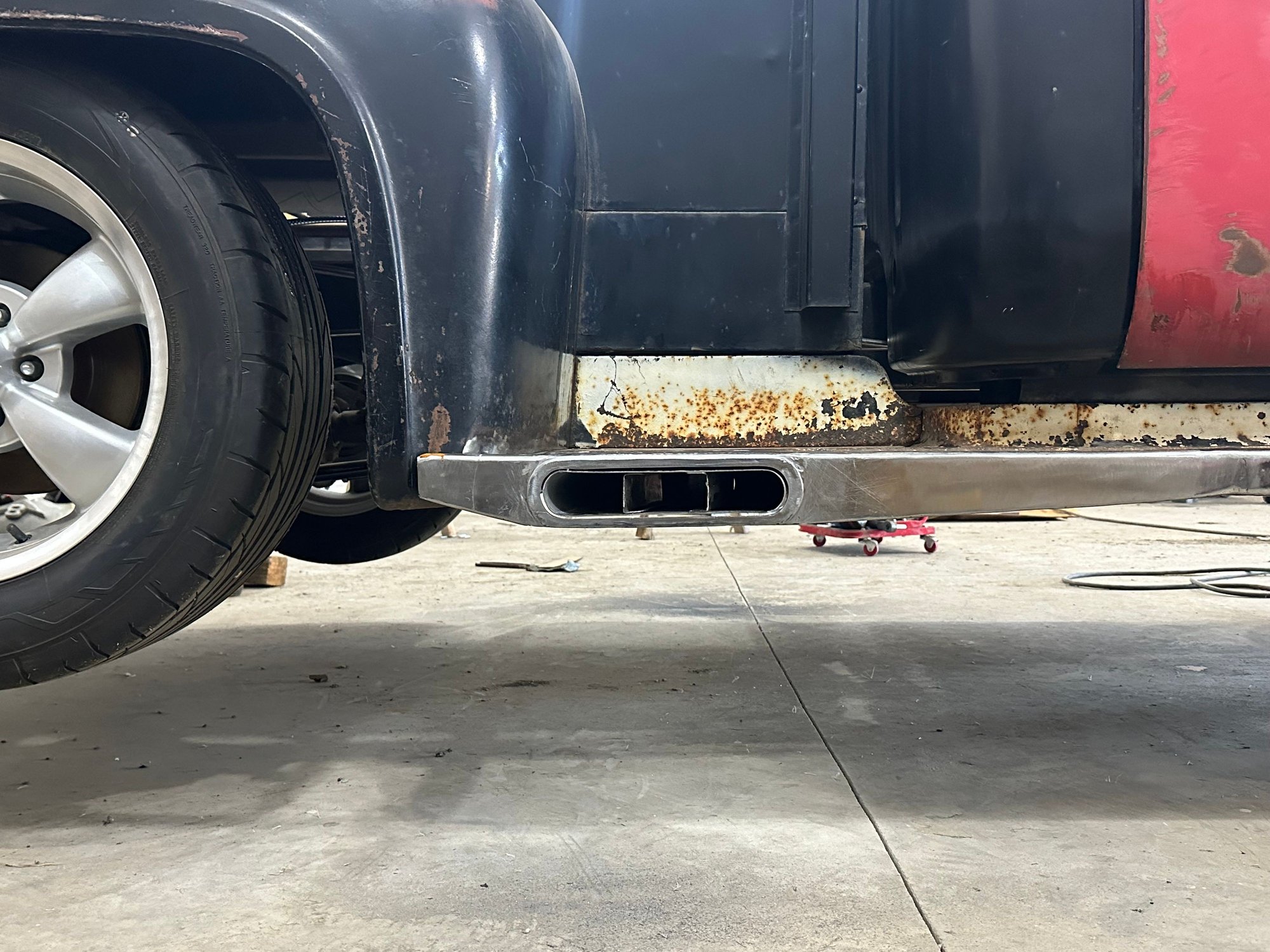

Old Jun 6, 2025 | 03:47 PM
  #279
MrSanford's Avatar
MrSanford
Joined: May 2024
Posts: 59
Likes: 66
Maybe trim it out with some round rod, something like 1/4" , both the perimeter and the dividers ?
Old Jun 6, 2025 | 04:49 PM
  #280
52 Merc's Avatar
52 Merc
Joined: Oct 2009
Posts: 16,198
Likes: 4,807
From: Burbank, WA
Perhaps angle cut or step back the ends of the mating surfaces so the ends aren't so prominent on the view edge?
Old Jun 6, 2025 | 05:31 PM
  #281
fullyford's Avatar
fullyford
Joined: Aug 2003
Posts: 427
Likes: 141
Yes, I was thinking about cutting them back on an angle so they wouldn’t be as noticeable. The entire tip needs to be cut down, but I am not gonna do that till the exhaust is done. I want them set on a bit of an angle.
Old Jun 6, 2025 | 09:01 PM
  #282
fullyford's Avatar
fullyford
Joined: Aug 2003
Posts: 427
Likes: 141
I was thinking about something like that but it would be tough to get the curve to fit snug.

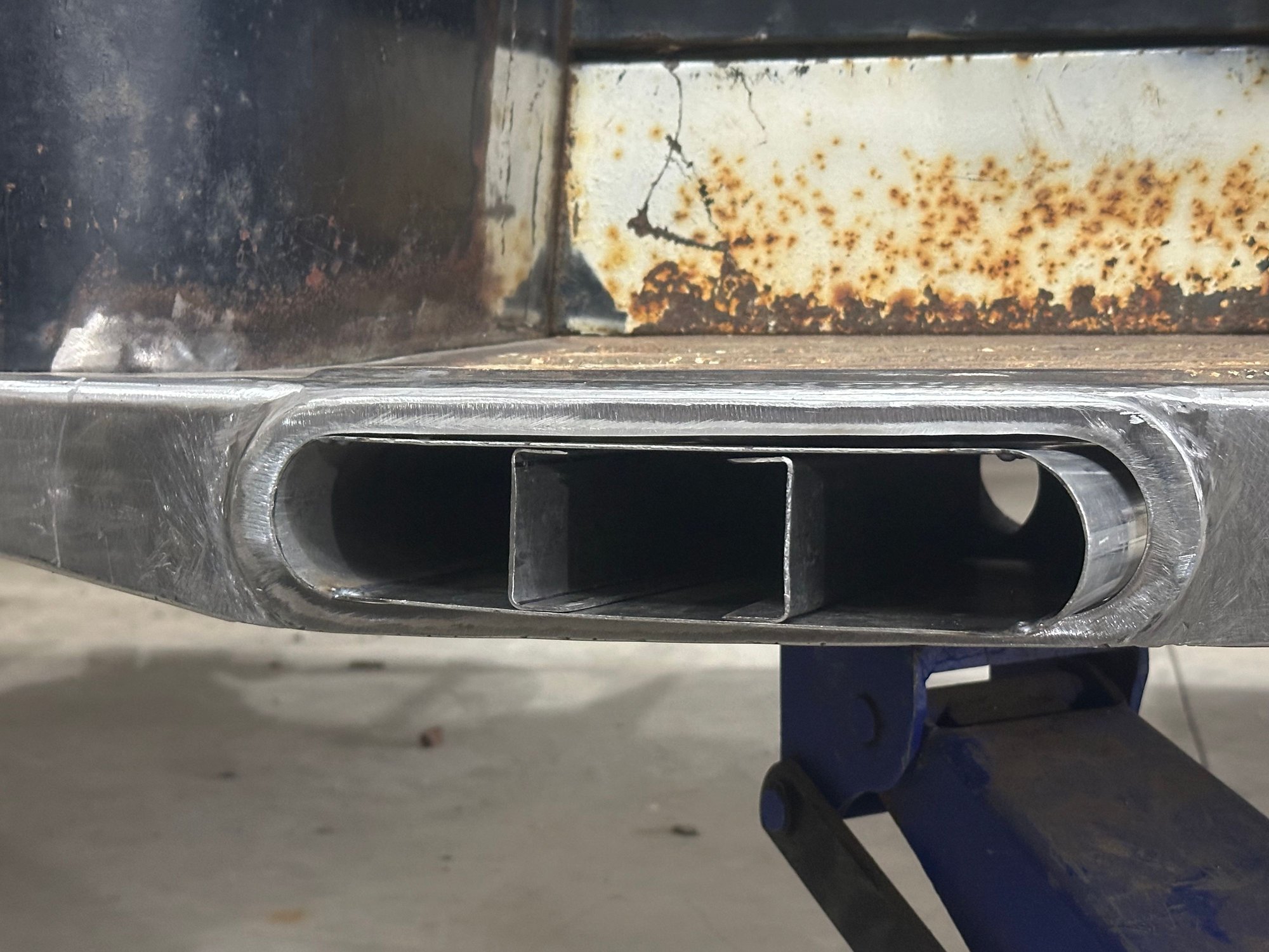

Old Jun 6, 2025 | 11:21 PM
  #283
EBEAR's Avatar
EBEAR
Joined: Jul 2016
Posts: 3,656
Likes: 819
Round partitions ?

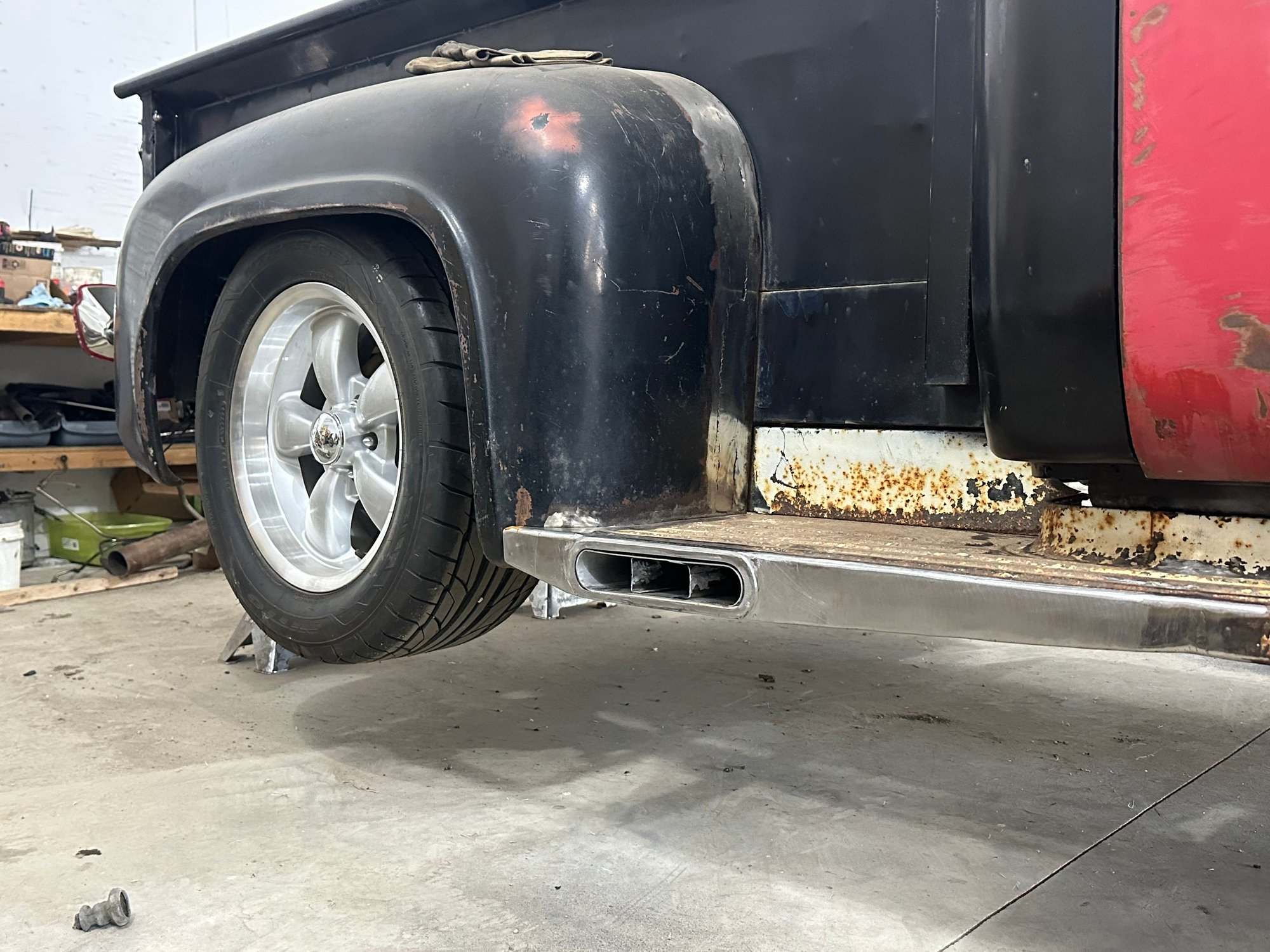

Old Jul 5, 2025 | 02:31 PM
  #284
fullyford's Avatar
fullyford
Joined: Aug 2003
Posts: 427
Likes: 141

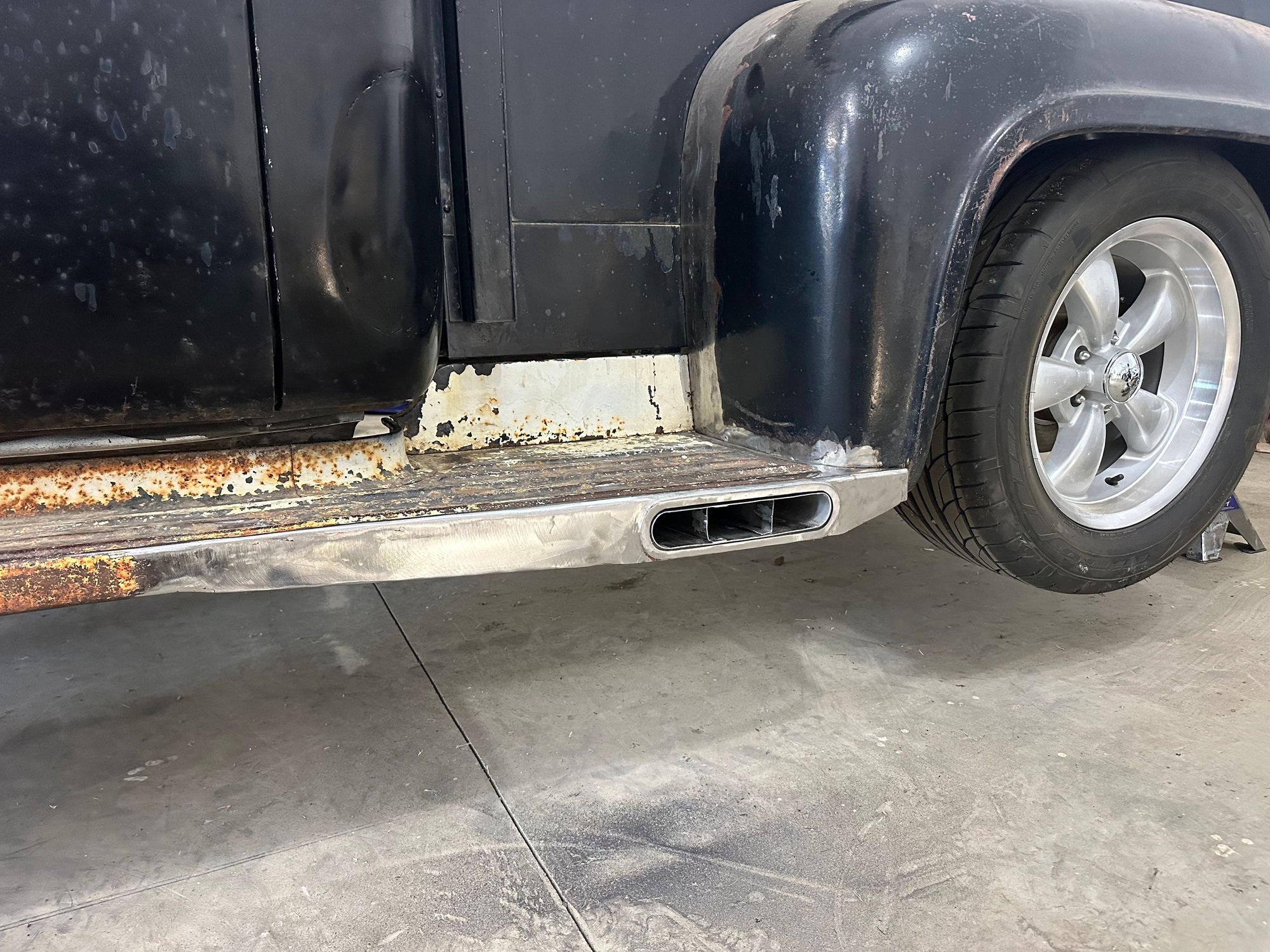

Well here’s the final take on the exhaust tips. I’ll have to run a flex pipe most likely. They turned out pretty good I think.
Old Jul 5, 2025 | 02:42 PM
  #285
Bvas's Avatar
Bvas
Joined: Nov 2024
Posts: 327
Likes: 267
Those look great.
Im assuming you will need to run at least a short section of flex to keep vibration from the exhaust from traveling thru the cab.
