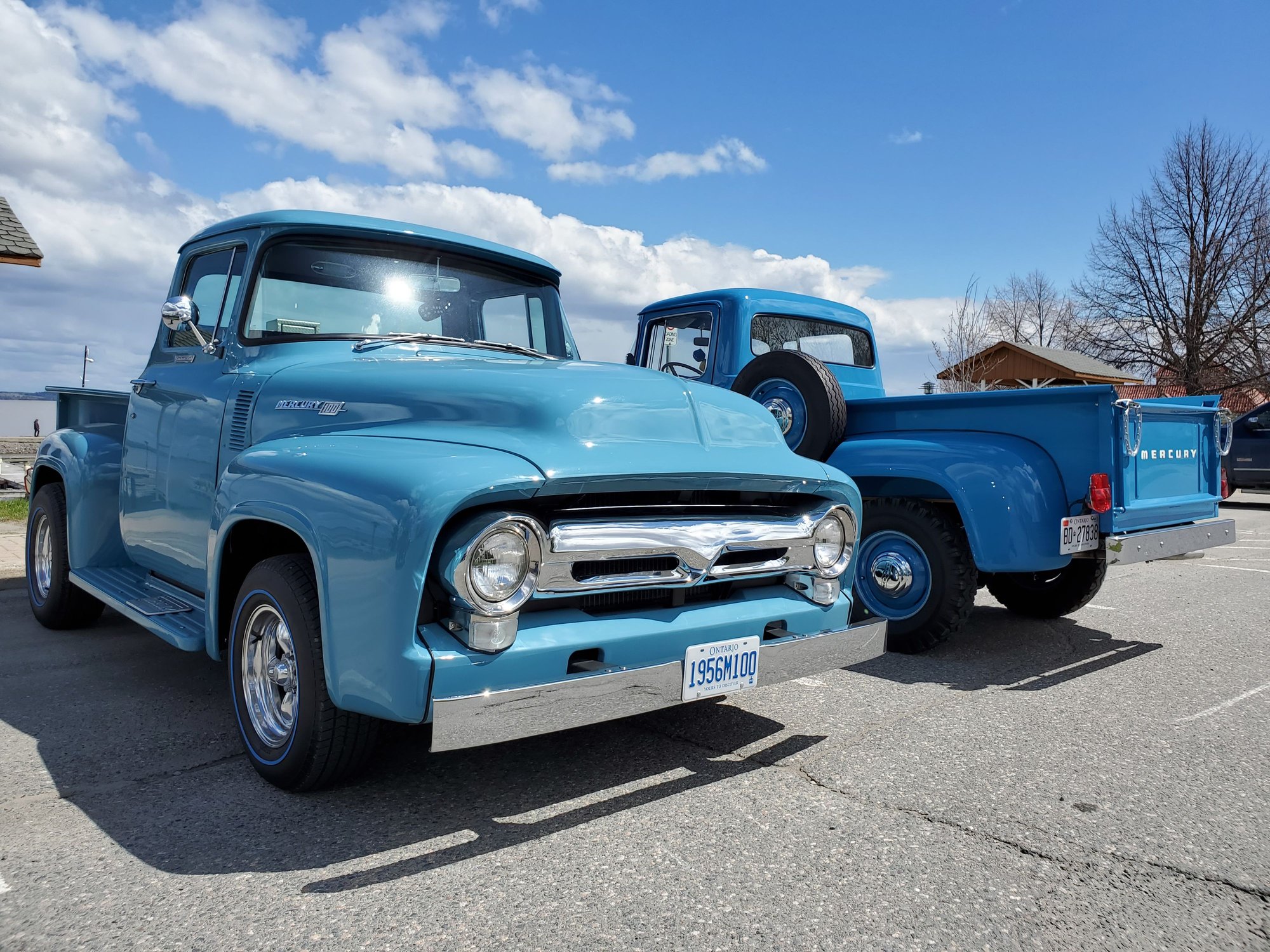

that’s cool. Most people have no idea where Saskatoon is let alone pronouncing the province write lol. Couple nice trucks. My dad’s 56 has now been handed down to my younger brother. So hopefully one day we will have a 53 and a 56 running together

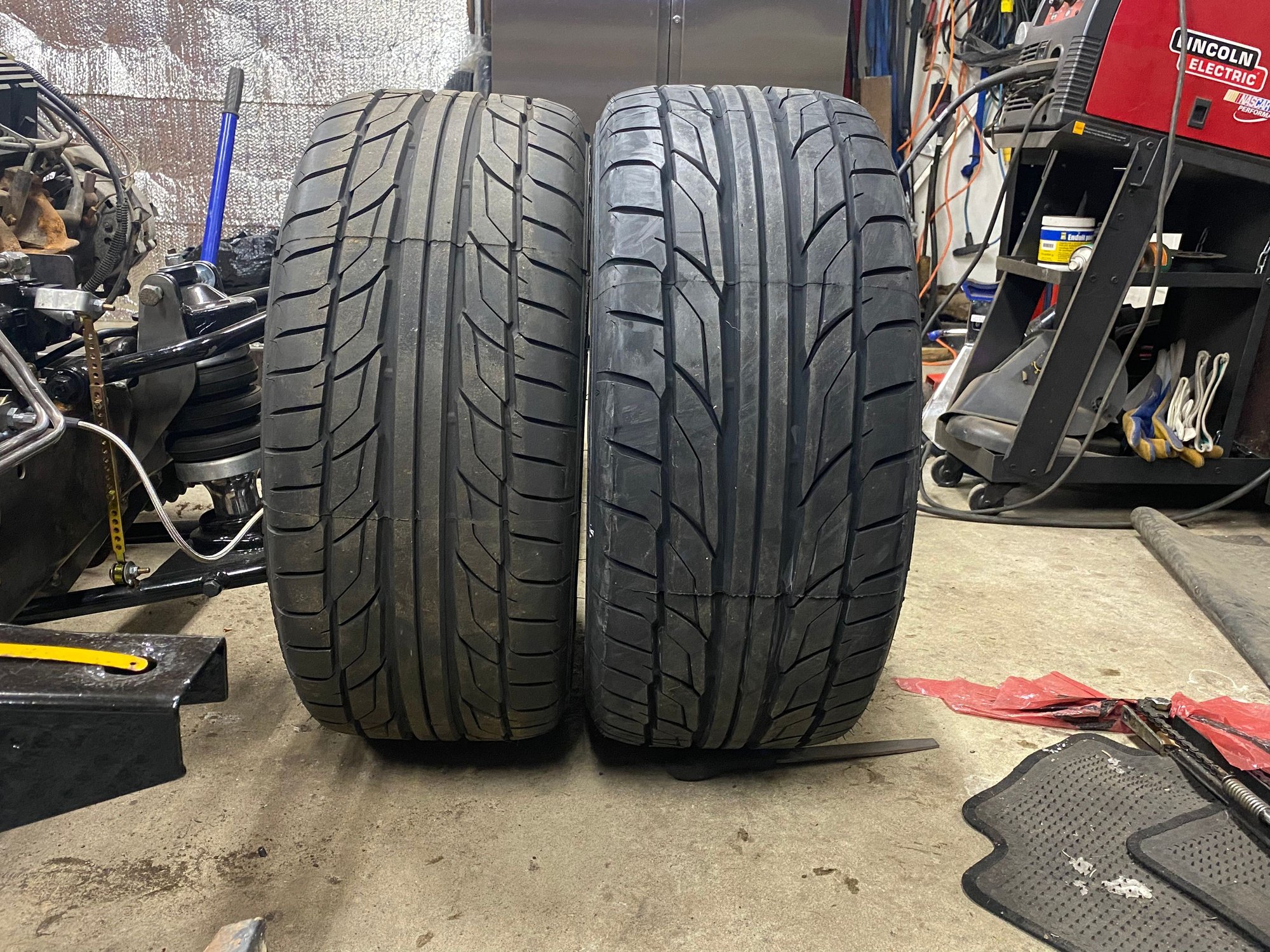

Extremely happy my rear tires finally showed up after 14 months, just a bit taller and wider than the fronts can’t wait to get them mounted.
255/50/10 on left(front) and 275/50/17 on right(rear)

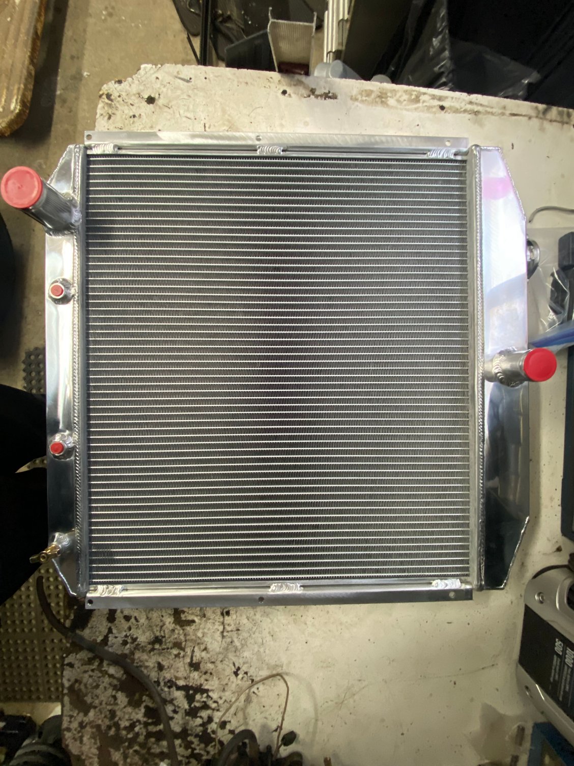

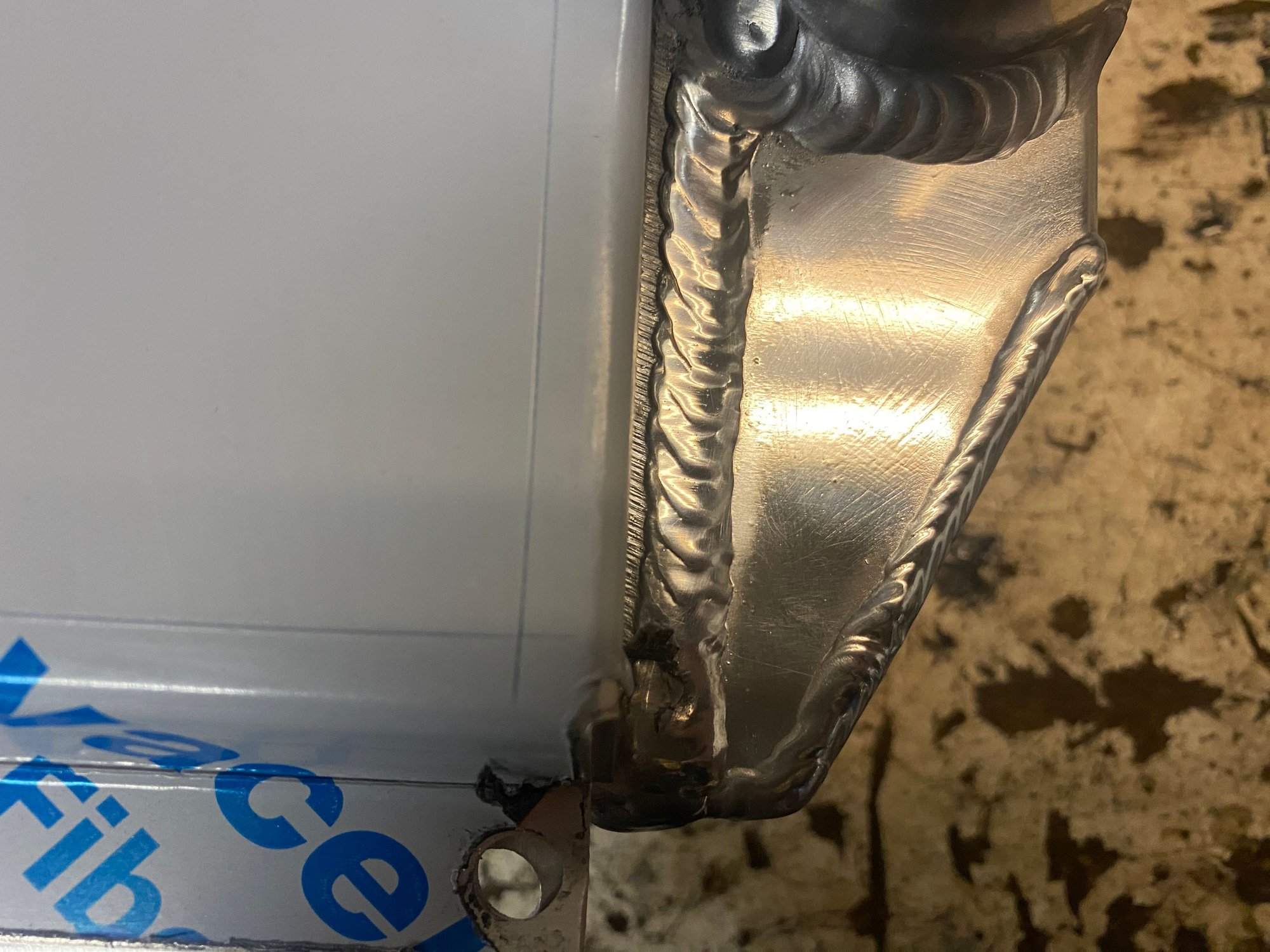

Also ordered a champion 3 row aluminum rad. But when it showed up the shroud holes are off by a 1/4”. Emailed them and they said that is normal as it’s all hand done and to Just drill the holes out. When you spend that kind of $$$ I’d expect things to line up properly.

I installed the same Champion eas a few years ago and had the same concern. My 56 Mer has a 302 and looks a little plain, was thinking of a CVF kit too, curious to see how yours looks

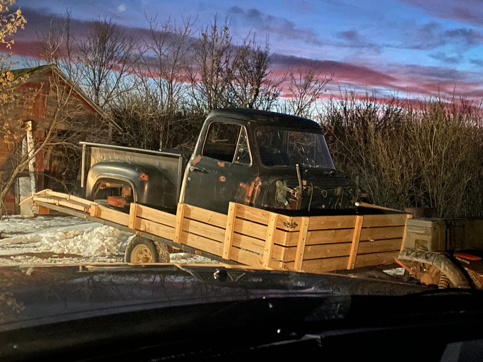

Decided to load this up and bring to my shop in the city from the farm.

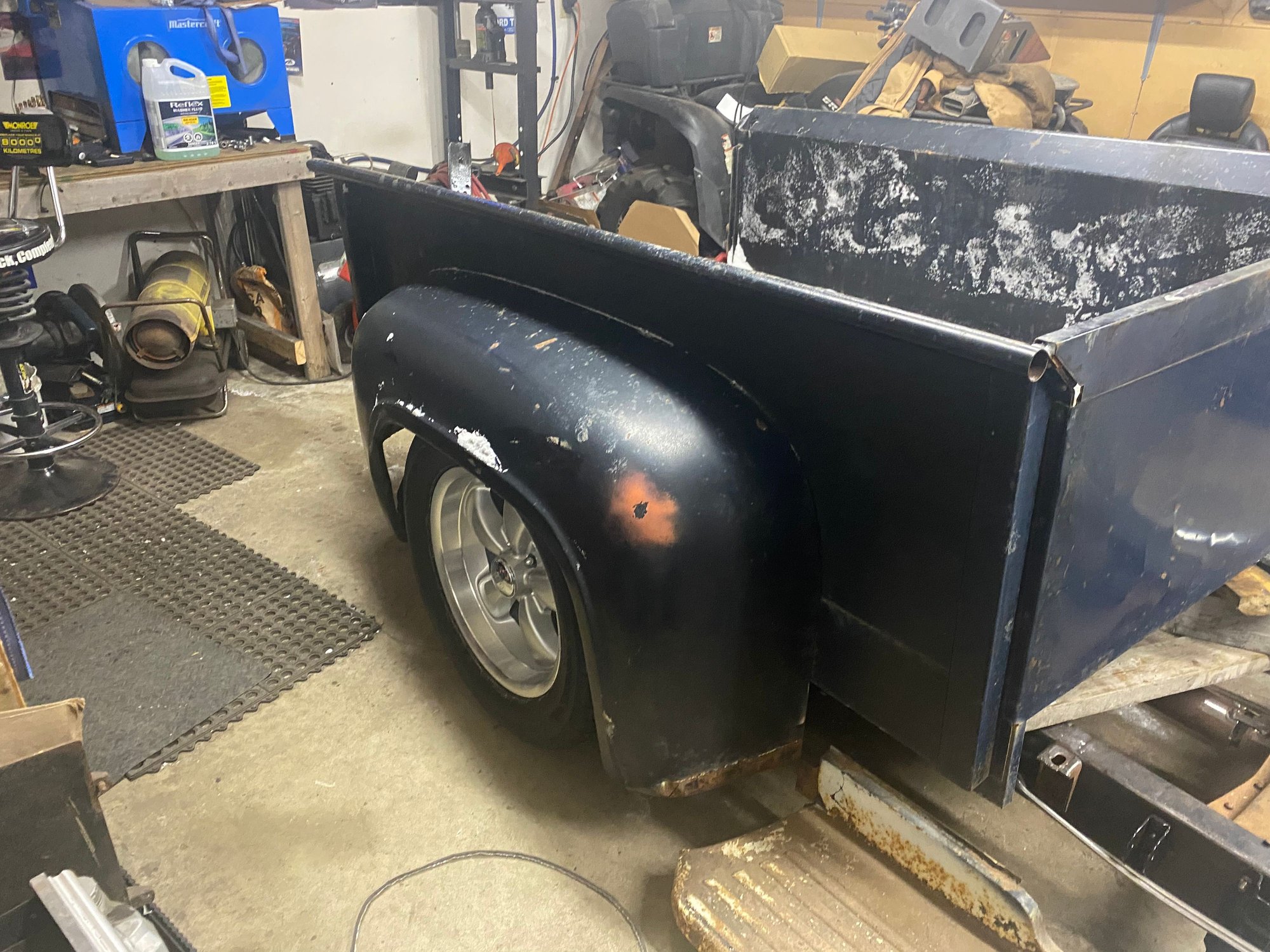

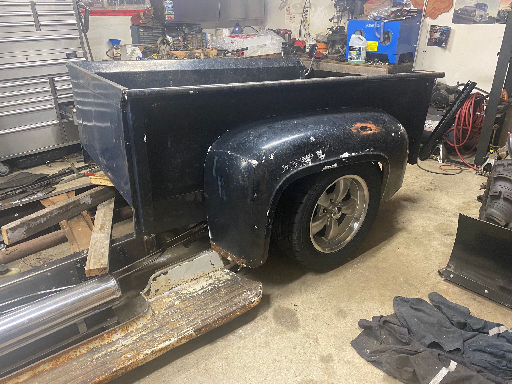

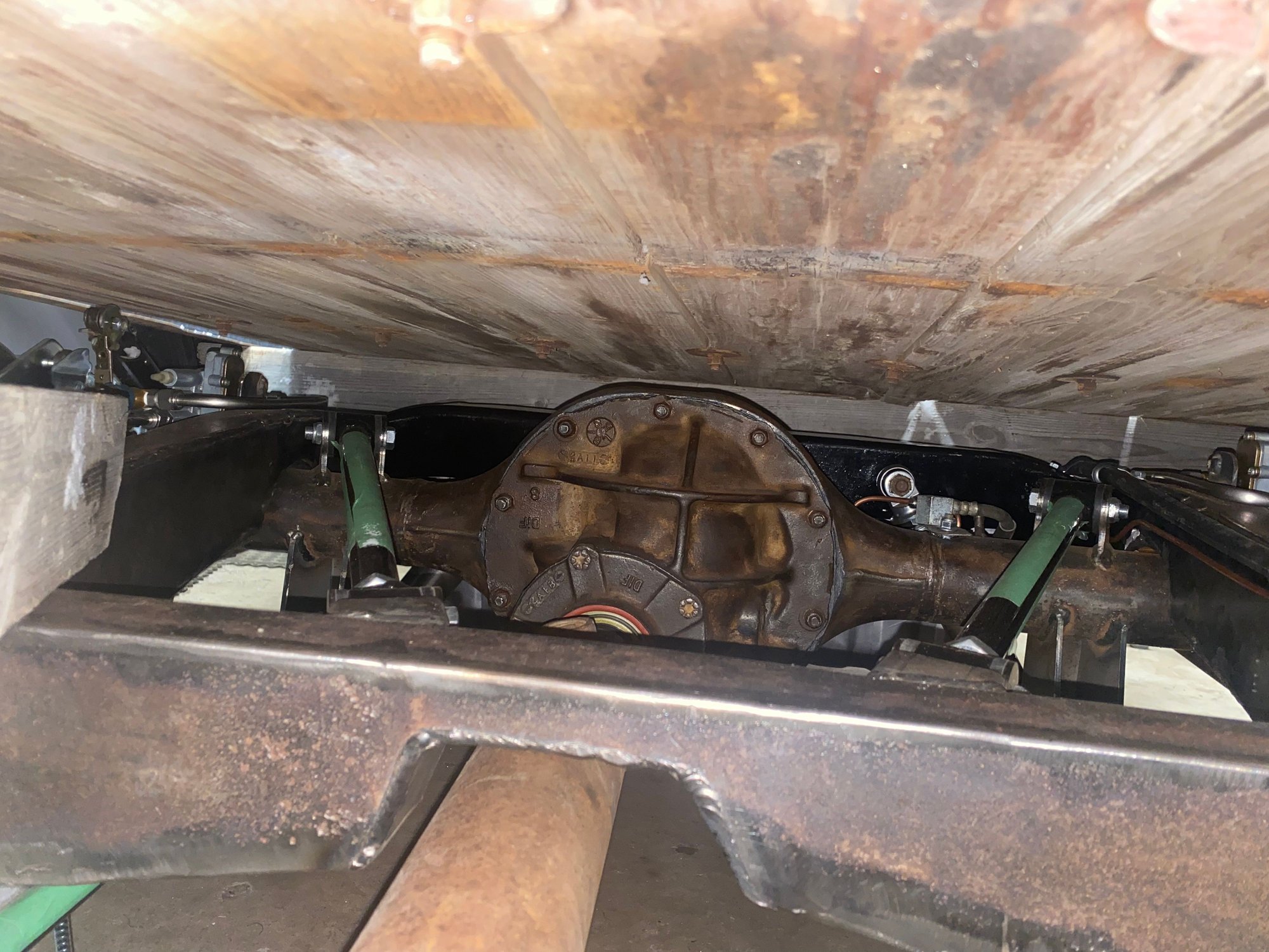

Figured what the hell let’s try and put the bed on. And it won’t fit. Floor has to be raised up which I knew. But the fenders aren’t liking the 275 rear tires. Might have to widen them.
I knew the diff was going to be in the floor but never thought about my leveling valves. They are even higher than the diff. I was thinking that they would be in the fender area. Oh well. Not a big deal. The fenders that’s a big deal, and will be a challenge. Would love to see how others have widen their fender.
Also how you mount the bed without the floor to get it to line up with running boards

The easy way out on the fenders is to get the fiberglass 3" wider sets available. There are people here who have successfully widened steel fenders, but it is a lot of work to get the contour right on the filler pieces. You may have the talent to pull it off. I know for all I can do, my metal shaping and welding expertise is not there for that challenge.
https://www.speedwaymotors.com/1953-...ders,1510.html
The bed crossmembers should fit across the frame rails, and the bedsides sit on the ends of the crossmembers. It can go together without floor boards.

I need new bed crossmembers. The ones I hard are roached. So you just need to account for the bed wood thickness to set the bed up properly then on the two middle crossmembers? And the front and rear of the bed actually sit on the frame then?
as far as fenders go. I have nothing to lose cutting and welding these fenders. They are in ok shape but someone decided back in the 70’s to cut the back of the off with a gas axe. Might to widen and repair them. Before buy buying repops
