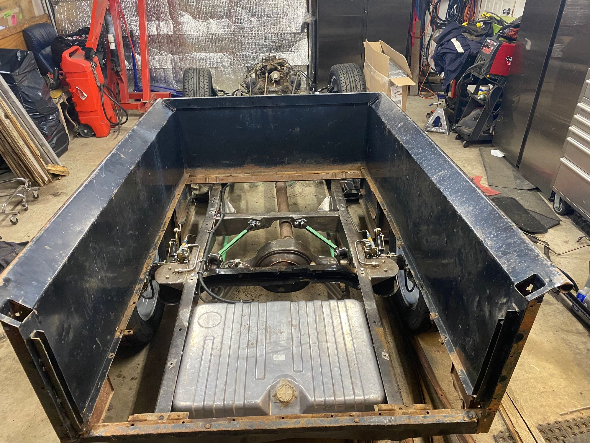

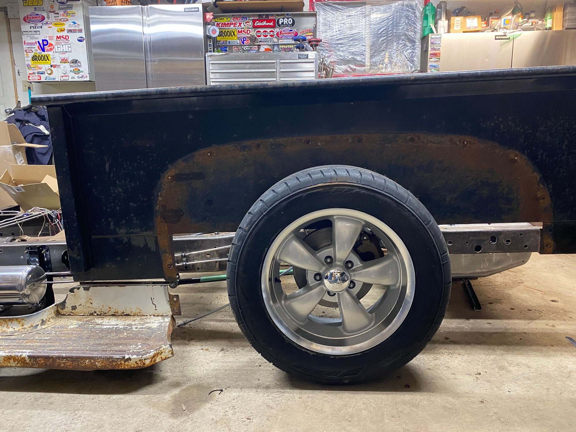

John I’m using a ford 9” out of a 68. New axles and disc conversion. The disc push the wheel out 1/4” I was told. Between the tire I had 50.5” I believe. Which is just barely enough to clear the inside of the bed. Wheels are 4.5” bs and 0 offset
pinto if I was as high as you I’d probably get away with it. But the edge of the fender to the bedside is basically the same width as the tires. Fenders aren’t narrowed. Just beat up. Lol

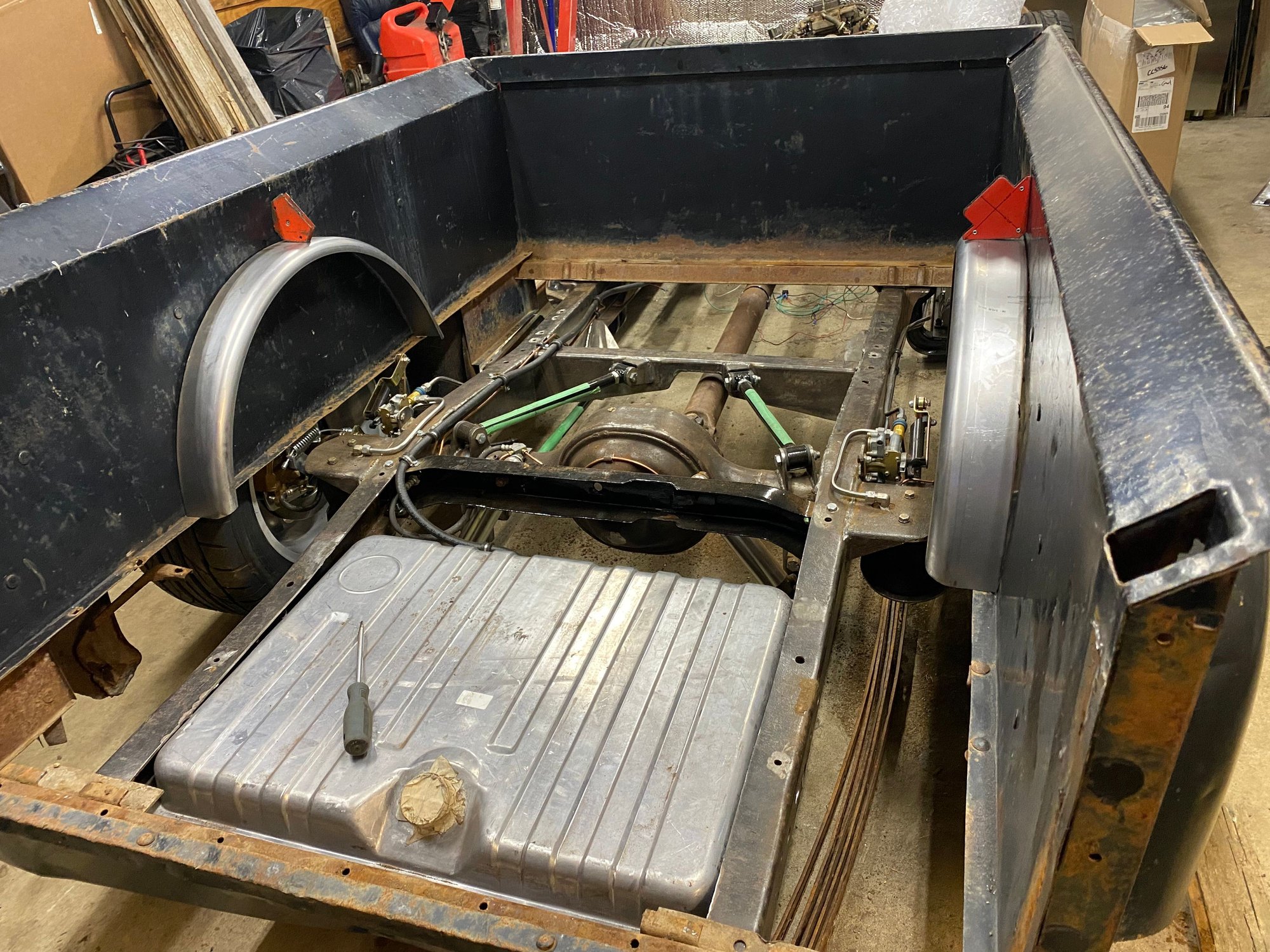

Got a bit done on the bed today. Got the floor removed. And laid it back down of the frame rails. Only to lift it again and pull fenders off. I have very little clearance between tire and bed side so I think I’ll do some mini tubs. Went a picked up a fender and trimmed it up. Not sure how to attach it.

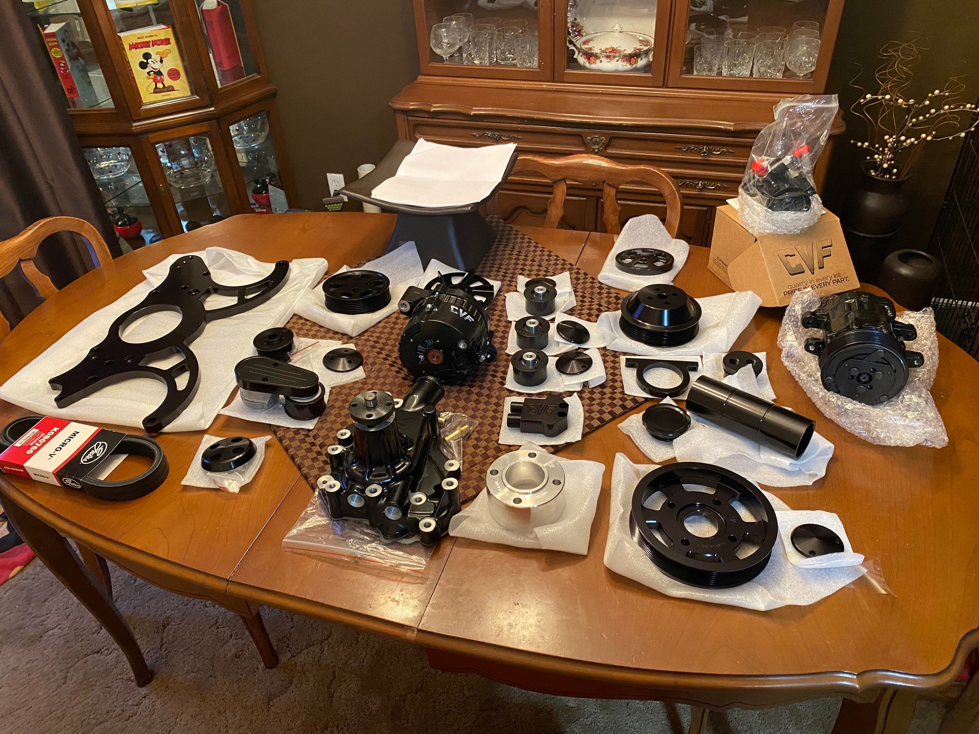

So I bought a serpentine kit from cvf. Showed up this afternoon. Figured I’d pull all the accessories off they came off super easy. Then onto the water pump and snapped 3 bolts. Now I have to pull off timing cover as well. Not sure how this is going to end up.
Old Dec 6, 2022 | 08:06 PM
  #147
fullyford's Avatar
fullyford
Joined: Aug 2003
Posts: 427
Likes: 141
I’d call today a win. Successfully removed the 3 broken bolts, and no damage to the timing cover. Gave it a good cleaning. Note I need to remove engine again and drop the pan and clean out any debris that fell in.
