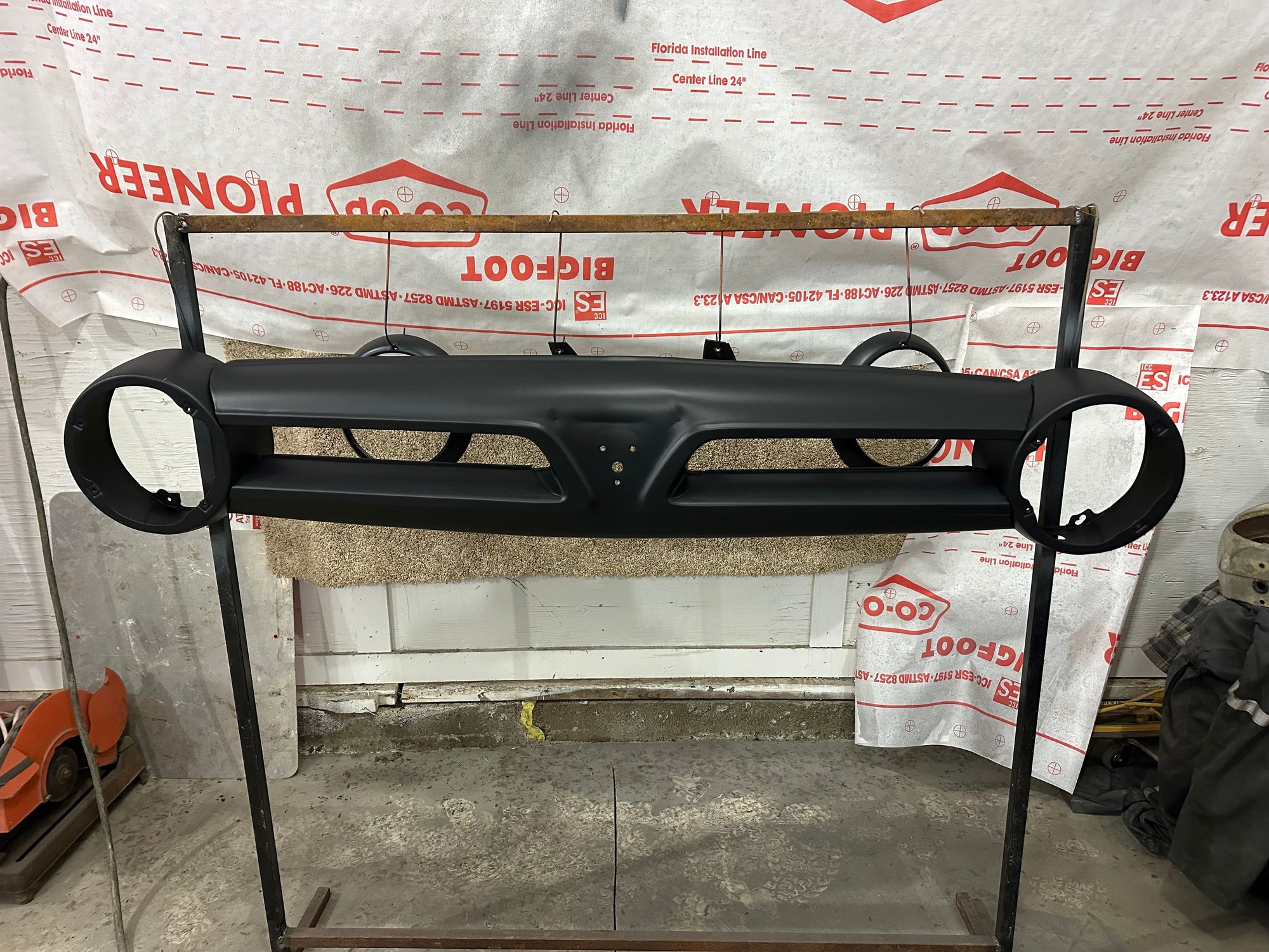

This is my pickup while still in primer..

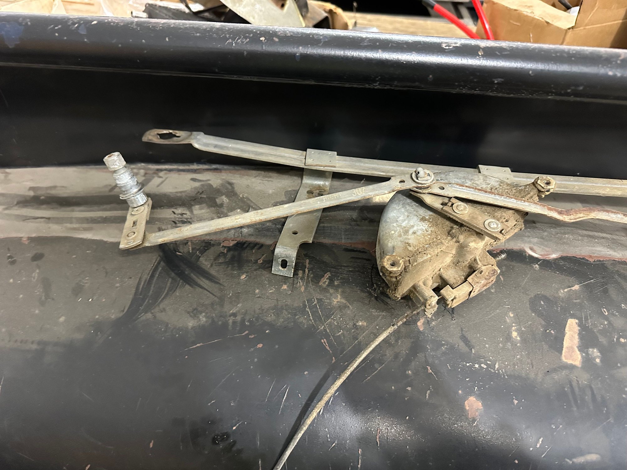

Pulled out the original vacuum wiper set up and made a bracket to mount an electric motor in its place. The passenger side outside nut was cross threaded on the wiper piece and I ended up destroying it to get it off. So I need to get a replacement piece for that. I’ve talked with Morris and sounds like he might have the part I need. Just need to get my but up there to his place
thought I had a picture of the bracket I made. Electric wiper motor is for a 87-95 jeep.

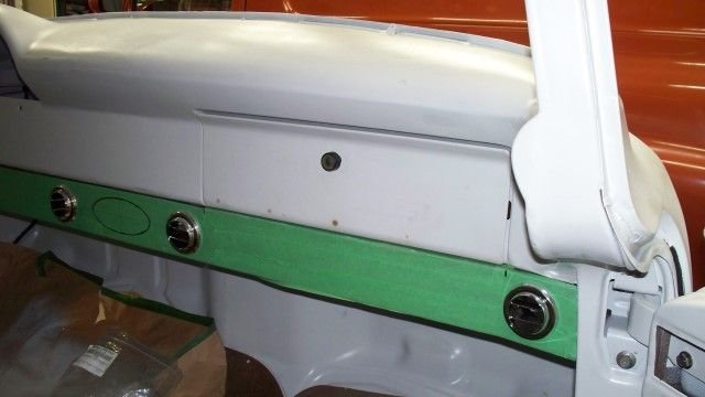

Pretty much done the mock up of the old air products heater and a/c. I’m going to have to change the cowl vent over to electric as the handle doesn’t close anymore with the dash extension.

all your trucks have the dash extension, what did you do for the vent cowl, I think I might do a 2” electric actuator so I can still use it if I want.

I closed all mine up and eliminated them altogether, I have a new gasket if you need one. I'm wondering if you could modify the existing handle in some way to extend it below the dash extension..cut the handle off then add a piece to drop the handle lower

I will check my stash to see if I have a gasket, I might have to take you up on it.
I was looking at it yesterday, it would have to be cut and welded back on at a 90° angle.
how difficult was it to weld the vent closed,

I used the actual lid but did cut off the screen before welding it , for the front edge I just made a filler piece. The gap around the cowl is about 3/16" but what I did was just tack welded side to side of the gap to close the gap. I did it over a couple days..

That definitely looks good. Might have to consider my options. I’m not worried about the welding part. It’s the making it look good for paint part.
