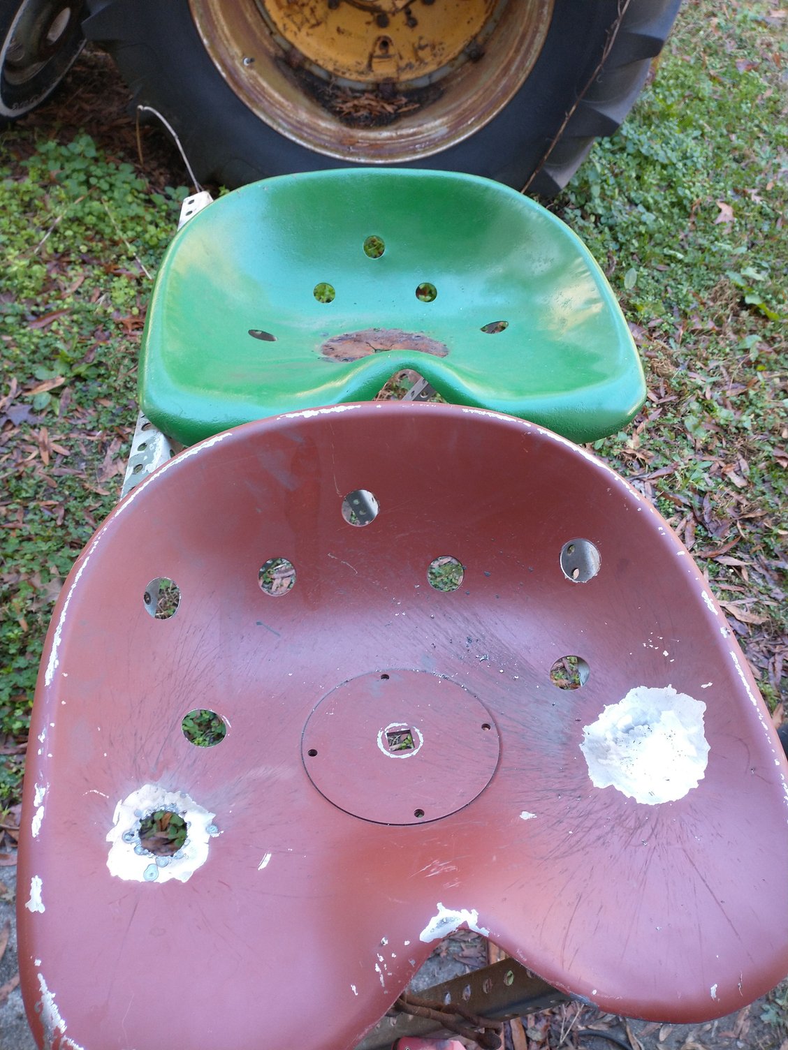

Tried to weld up some holes on a seat pan for my John Deere. It's a reproduction pan that's got 9 holes, original had 5. Tried using flux core to tack it in, burned holes and warped it. Just too much heat on 16 gauge. I decided to convert it to mig and hooked up a gas cylinder, put it on a cart, got it burned in much easier. It's practice for other projects.
It was good meeting your buddies tonight John. Tom won't half bad for a yankee, haha.
Cracked/ rusted old pan and new one
Flux core attempt

What gauge wire are you using with the MIG
I would need to check but 30 comes to mind on my MIG.

I used 030 wire, but I also have some 024 wire. I thought I was gonna have to buy another welder, talked to my buddy who I bought it from, told me it was already setup for mig too, had the gas solenoid, tubing,etc. Had to reverse polarity, screw in the hose and regulator. Overall I have probably 500 or so in everything. Apparently hobart is made by miller so it's not as big of a piece of junk as I thought it was.

My flux core welder, I use 030 or 035 - can't remember which I have in there now. I am like you, sometimes ok for sheet metal, other times I burn a hole. I have always heard using the gas makes it easier and also nicer welds compared to flux core.

I'm sure if I had used my copper welding spoon and worked slower, flux core was doable, but it's just alot of heat. Flux core is meant for deep penetration. I think the difference between the miller and hobart is theres much more fine tune adjustments on a miller. Basic parts are the same. I'd been watching a YouTube channel called fitzees fabrications, he's a old school bodyman who's really good at teaching, he's the only reason I've gotten more interested in welding lately.

Dusty89, I never heard that flux core was better for deep penetrating welds into thick metal, my only understanding was that the flux burning off is meant to replicate the protection that you would normally get from gas. I know 030 is better for sheet metal and 035 is better for thicker stuff. But I honestly couldn't tell you what I have in mine! lol

The thinner the MIG wire the better when welding sheet metal and using gas makes for a better weld.
Now for flux core wire and better welds on the thicker metal my take is you are most likely welding it outside with a little wind.
The wind blows the shielding gas away and the flux core dose not have that problem.
Now if you are welding inside or were there is no wind you can use gas and as long as you use the right size wire and turn up the amps it should weld the thicker metal. I used thin wire as that's what I had, to weld the tubes to the center section on my drag car axle. I also had to brace up the leaf spring mounts so they would not fold up on take offs.
