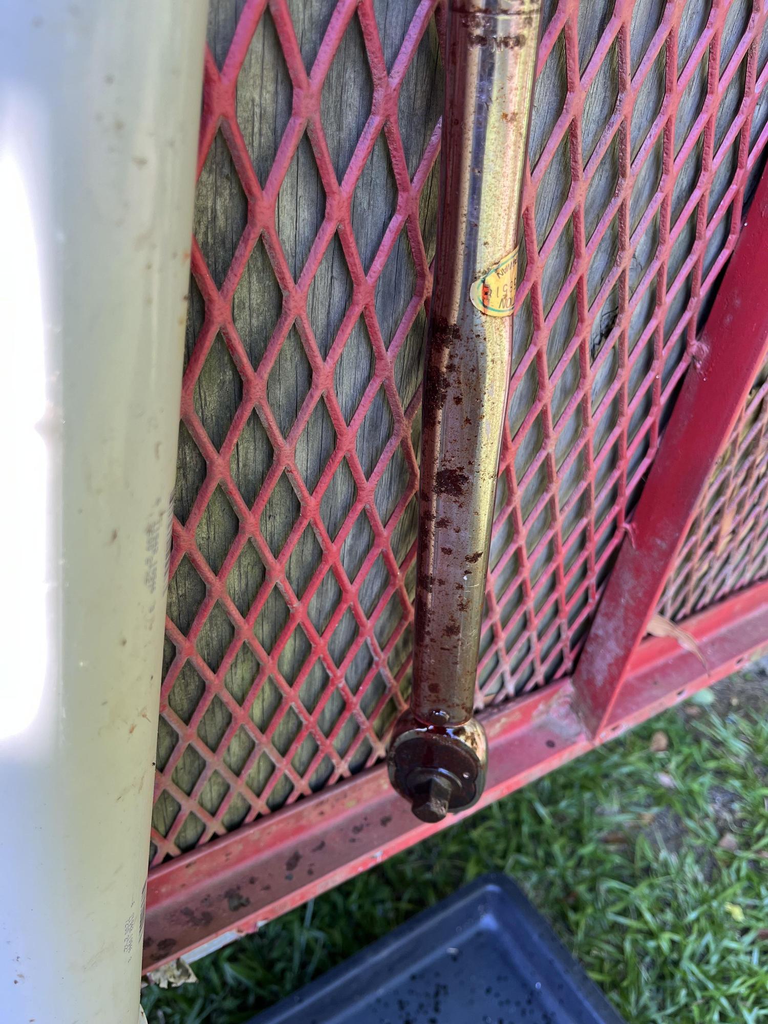

When I made this post back in May, I had intended to recheck after 1 month.
Original post was 5-18, so it looks like I forgot about it for 2 months.
It slipped my mind and I never remembered to check in June, but I remembered this week and pulled it out. So I can safely say that ATF by itself does not appear to eat or dissolve rust. Both sides of the torque wrench are still rusty.
I poured half of the ATF out and replaced it with kerosene. We'll see how well that does at loosening rust. And I guess ATF-acetone will be what I try next.

Vinegar might work.

Well considering it's just surface rust on the outside, I would be hesitant to let it soak in vinegar, because what if that was to damage the inner workings? Vinegar dissolves rust but it can also be harmful to rubber and can even damage some kinds of metals.

Maybe, and I don't know for sure, soak a cloth in vinegar and wrap it around the handle??

Yeah GLR soaking a rag in vinegar and wrapping the handle might do pretty good for that surface rust! For now though I am trying to sort out the internet myths about how much affect ATF and kerosene or acetone have on rust.

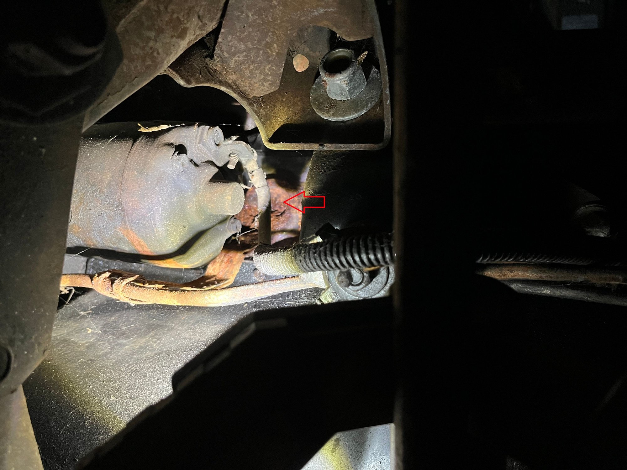

For the second time in exactly 2 months i just had to change the rack and pinion on my mustang because the boot seals started to leak on the new one. 2 months ago i had to change it because it failed internally making the boots balloon to watermelons. Now i gotta find someone to do the alignment because the place i usually take it to is back logged for the next 3 weeks. Cant wait that long.

Spark when the rack is replaced dose the upper or lower suspension undone to change settings or is it just toe that needs looking at?
usually just toe gets messed up. But causes some other fun issues too.

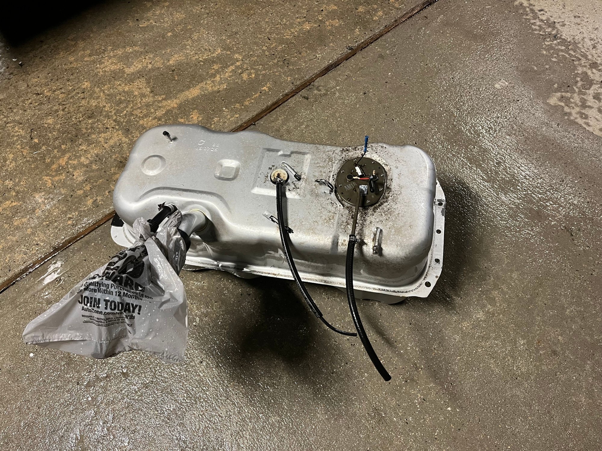

I went ahead and pulled the trigger and bought the little Mazda truck from my friend. I need another project like I need a hole in my head, but I digress. For the past few days I have been working to address the fuel delivery issues. Even putting my vacuum pump directly on the hose from tank would only get a tiny amount of gas to trickle through. So I knew I had to drop the tank to investigate further, which is a pain because one side of the exhaust system is jammed up pretty tightly against it (not directly touching the tank itself, but jammed up against the 1-1/2 inch wide rim that goes around the mid-point of the tank. The joys of cramming too much motor and trans into a small package!
The old tank was pretty rusted, so I put this one in back in 2014-2015. After washing the grime off, it still looks pretty new.
Back when I put this together initially, I had removed the (non-functioning) in-tank pump and replaced it with a section of fuel line and a screen pickup. I can see everything is still in place.

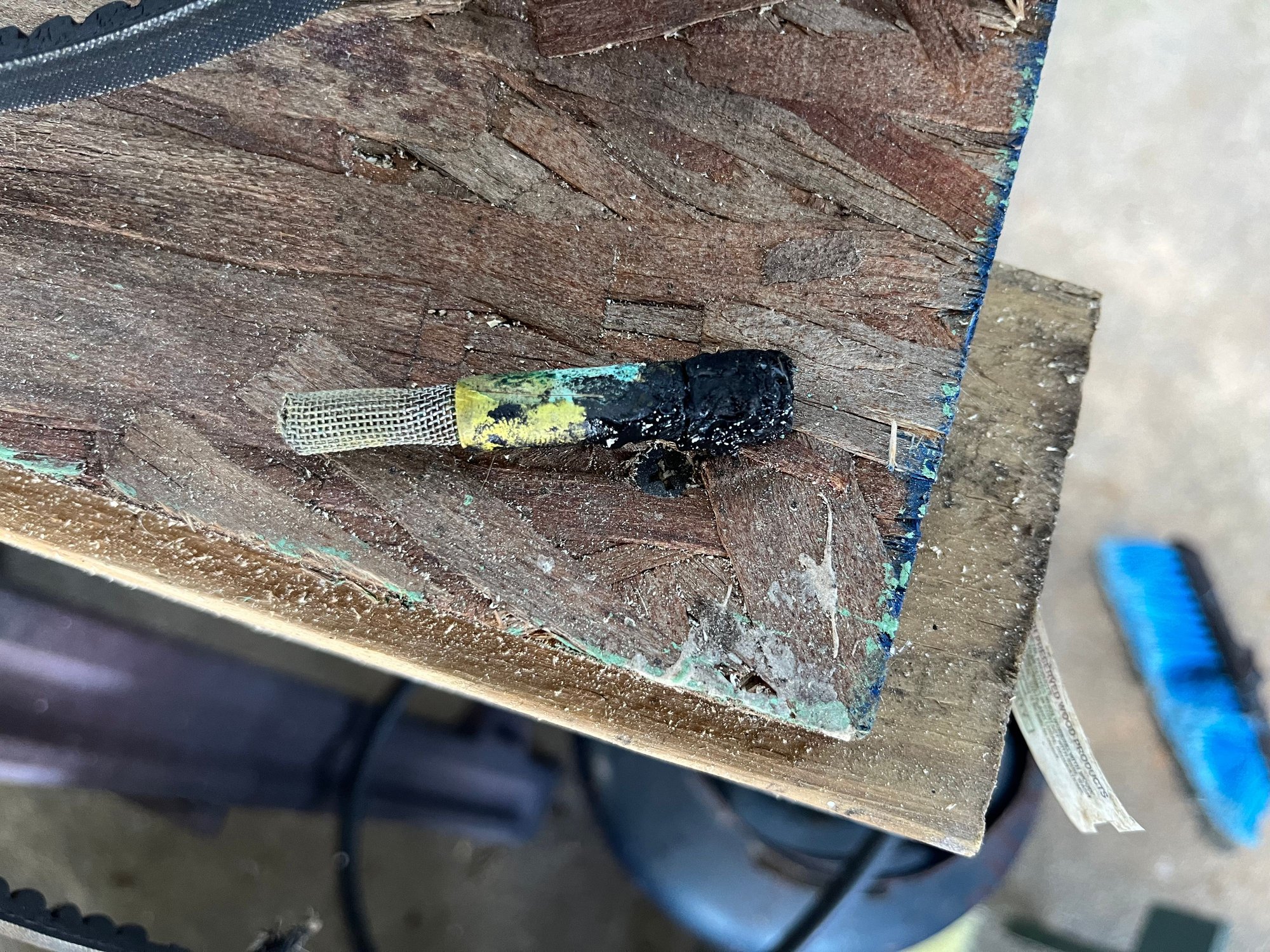

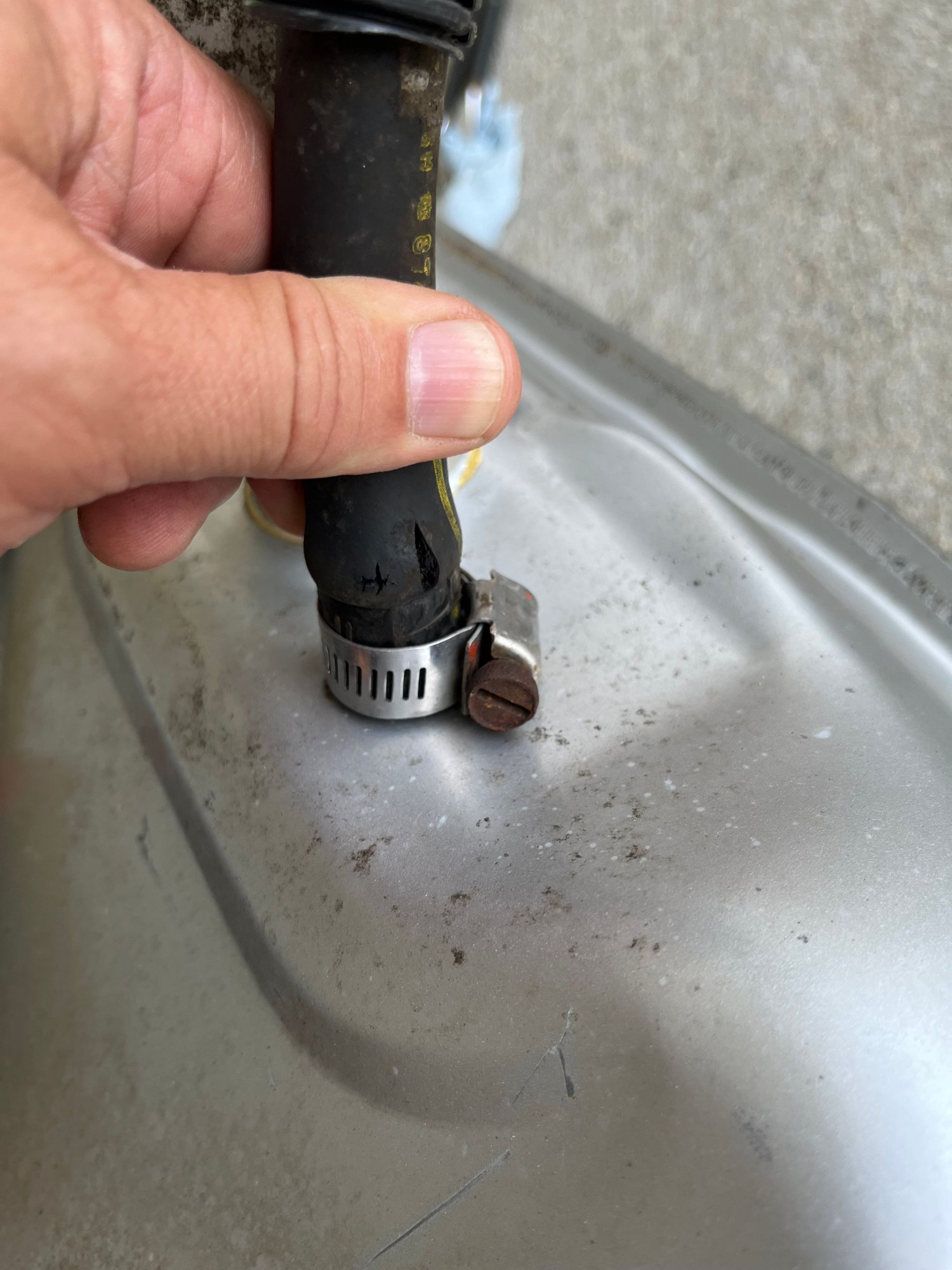

But trying to remove the hose reveals the problem, it is completely ruined by the fuel! The hose is very ooey-gooey and separates as you try to remove it.
Same with the screen filter, it is like black tar gummed on it where the fuel line was.
The vent hose on top is dry rotted (I only took a pic of the lower, the upper which goes to the filler neck is also rotted and cracked).

On the pickup fix I think I would get more tubing and a compression fitting (flares would work also) that fits the tube and run it down low in tank and see about getting a filter sock to fit the tube. You should be able to get the sock from the parts stores after they order it or on line.
This way you dont have to worry about that hose turning to goo again.

I do have a tubing bender and flaring tool, and a roll of 5/16 line, but I think I'm going to go with the submersible rubber fuel line. That way I don't need to be exact or even close to it, just leave it a little long and let the weight of the screen inlet keep it all the way down touching the bottom of the tank. Especially since I already spent the money for the submersible stuff.
